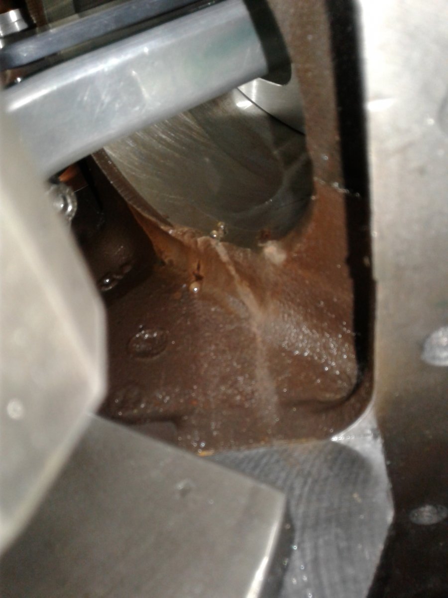

    That ****s. Was that a common problem with these blocks on fuel? Is your block filled at all?

  6. not filled. the common problem is they rust from the inside. gene adams told me if they are going to crack this is were it happens. it starts happening around 70 percent.

    I'm not a Hemi man but I would say that is not long for this world. Even with some block fill.

    No JB Weld I'd guess...

    That makes sense never thought about it rusting out.

    That block is a piece of history, good call not to run a p*** yesterday. Without water mmmmaybe but please fill it as a safety precaution. "It'll hold one more p***" the famous last words on a track...

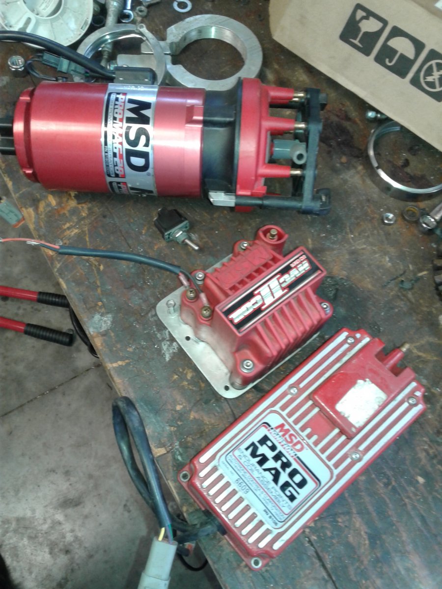

  29. Well so much for getting the gr*** mowed. I wanted to see if it would fit. Its alot bigger than the super mag. I still need to mount the box and coil. This mag makes so much spark i need to make grounds from each head to the box. If for some reason the mag doesnt fire the plug the spark could arc to the cylinder. The result will look like a cutting torch was used. I have seen cases were the entire wall seperating cylinders was removed. These mags have some big time power. They will fire the mixture regardless of cylinder pressure or load of fuel. They can only be timed with a light. A bux box wont work. In the world of cars that go boom this is the ultimate ignition. 20170915_173355.jpg 20170915_173345.jpg

    That's a good mag brian we use one in our Flatcad motor at bonneville and it will definitely burn a big load of nitro that's for sure
