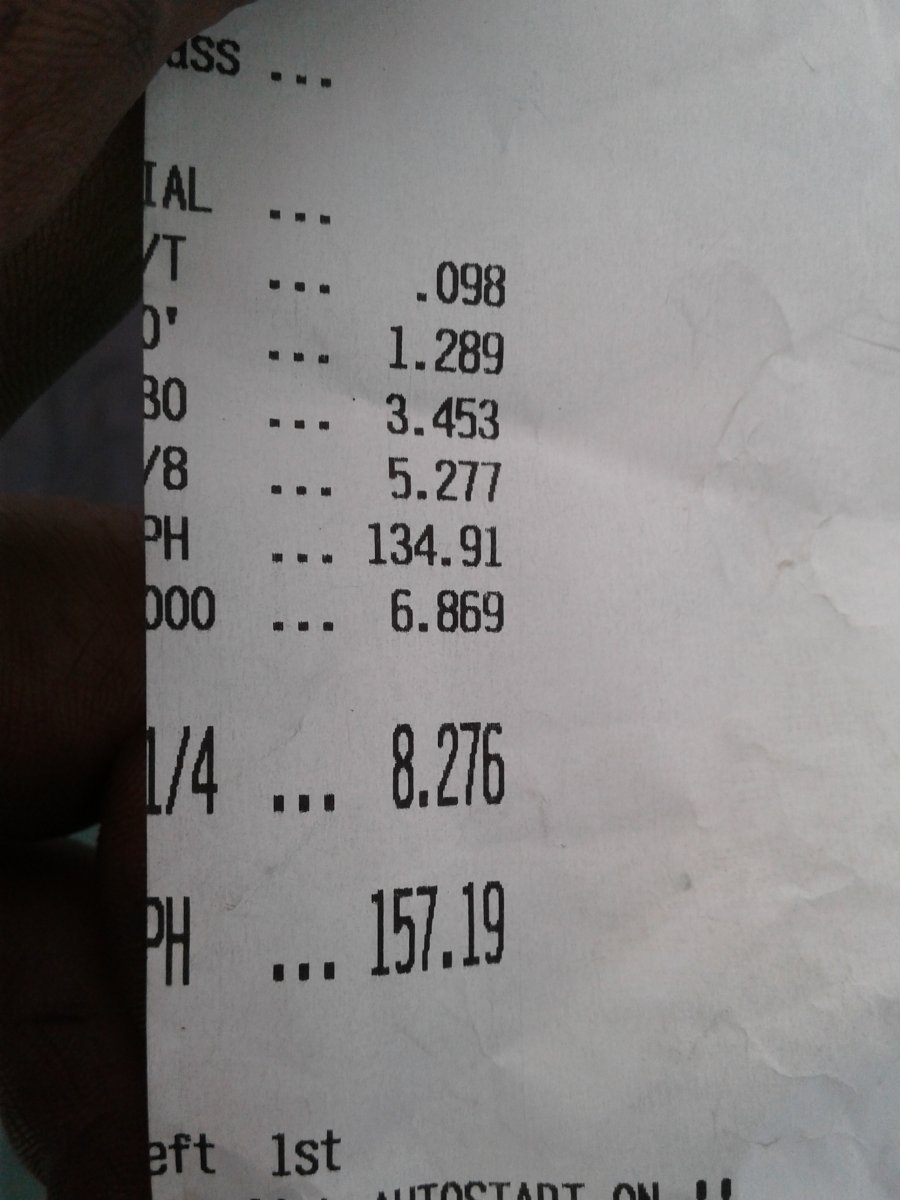

    Here's to hoping the block stays in one piece ! Was that a full p*** ?

    Man that's a good slip from reaction time all the way down.

  10. It was a full p*** kind of. The fuel pump is now going away and i dont have a spare. Its leaning out and shutting off then taking off. It did it three times on that run. When the video gets posted you might be able to hear it. The car is screwing with me and wont give me a seven second p***. I guess i know what to ask santa for this x mas. A enderle 1100 pump.

    NIce P*** Brian! I wish I coulda been there, but this is my daughters wedding weekend.
    How did it feel at 157, any aerodynamic issues? What MPH do you figure is your limit before you need a spoiler or wing or something?

  13. Joel it felt so stable it was perfect. I wont ever put a big ugly wing on it. I guess when it starts smoking the tires in the lights its as fast as it will ever go.

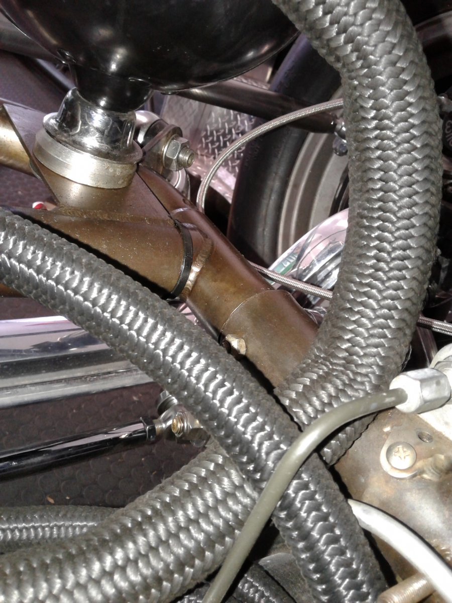

    We might have found the problem. I spoke to roger and gene adams today. They think the pump is fine although it should still be checked. They both think its ****ing air due to the g forces pushing the fuel away from the pickup. Moon tanks dont come baffled. I found some slight kinks in the hose going to the pump. So a new hose will be made and the tank will get a sump added to it with baffles. We might just make another hit after all. Im not opposed to travelling south for better weather either. 20171001_134146.jpg

    Wow, little things like that, that us normal folks would never even think about.
    Stay safe out there!

    I think it kinked in the crash. It wasnt like that before.

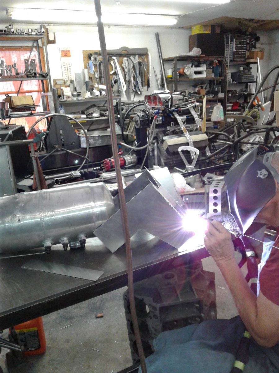

  25. With no time to waste i headed down to bob stephans shop this morning. We are making the necessary changes to the tank. Bob is a great fabricator with all of the right tools to do the job. 20171002_105352.jpg

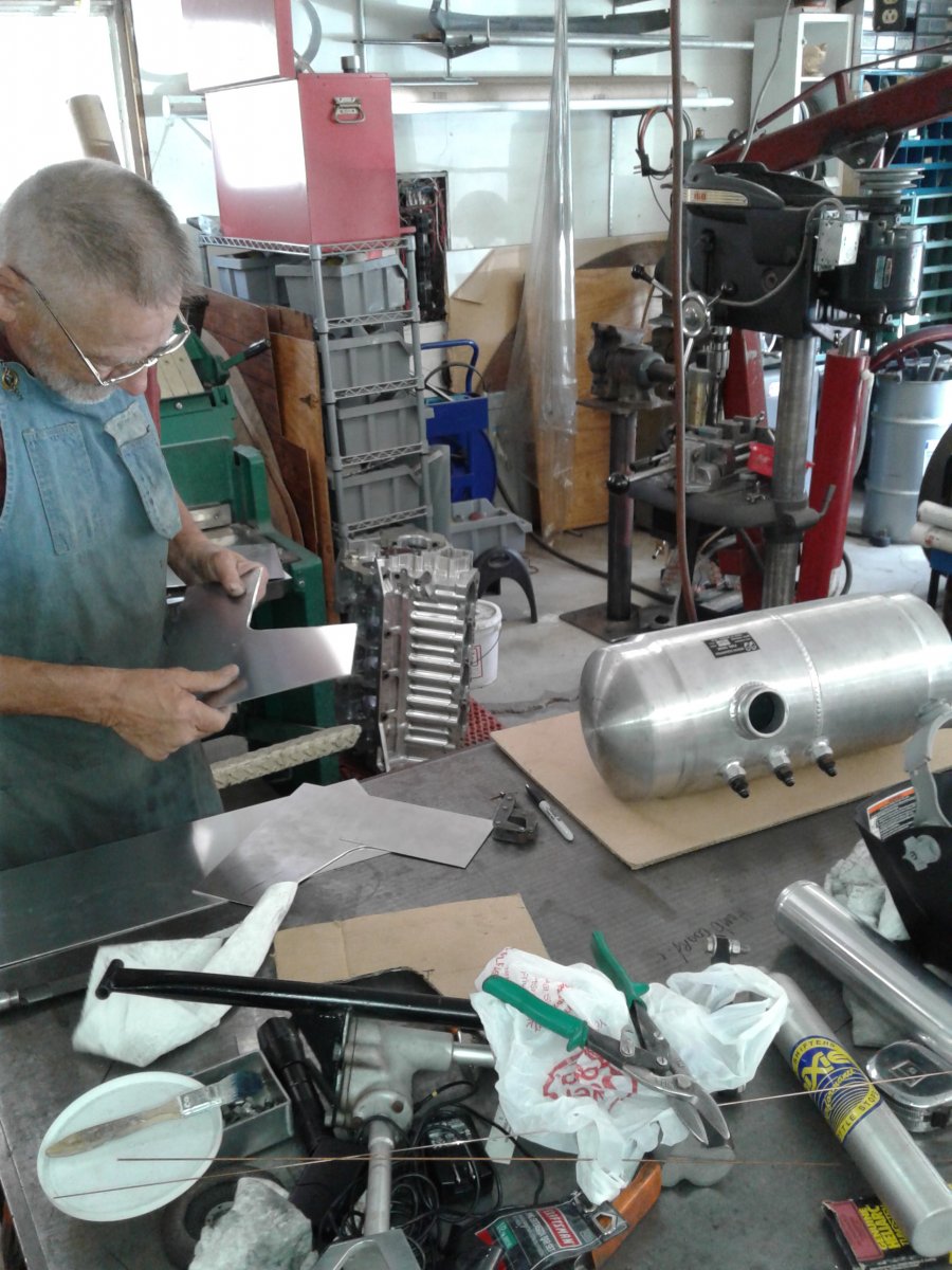

  26. I forgot to mention bob is a nitro guy. He got the sickness a long time ago. Being a racer himself he understands the situation and the limited time we have to get this done. 20171002_132908.jpg

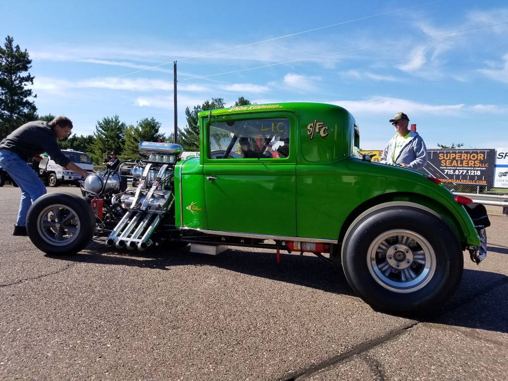

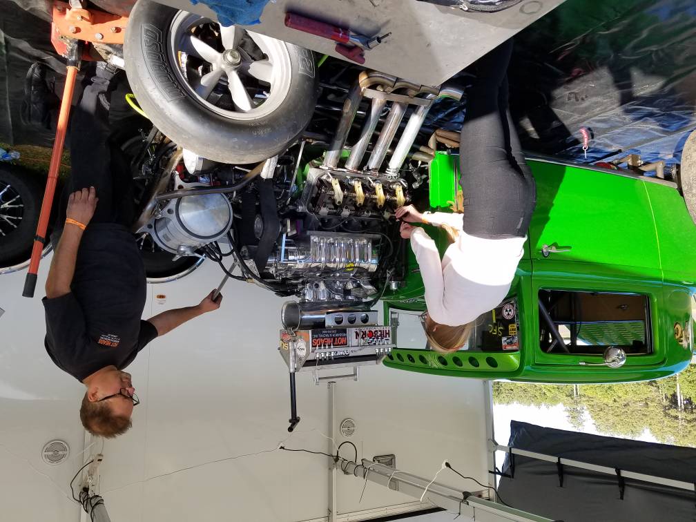

    We drove up to check out the Fall Out Drags in Wisconsin. Always a treat to witness a p***. I even got to help with the leak down test! Thanks forever Brian. Here are a few shots of the beast.
    20171002_215206.jpg 20170930_114123.jpg 20170930_113100.jpg 20170930_185916.jpg 20170930_162903.jpg
