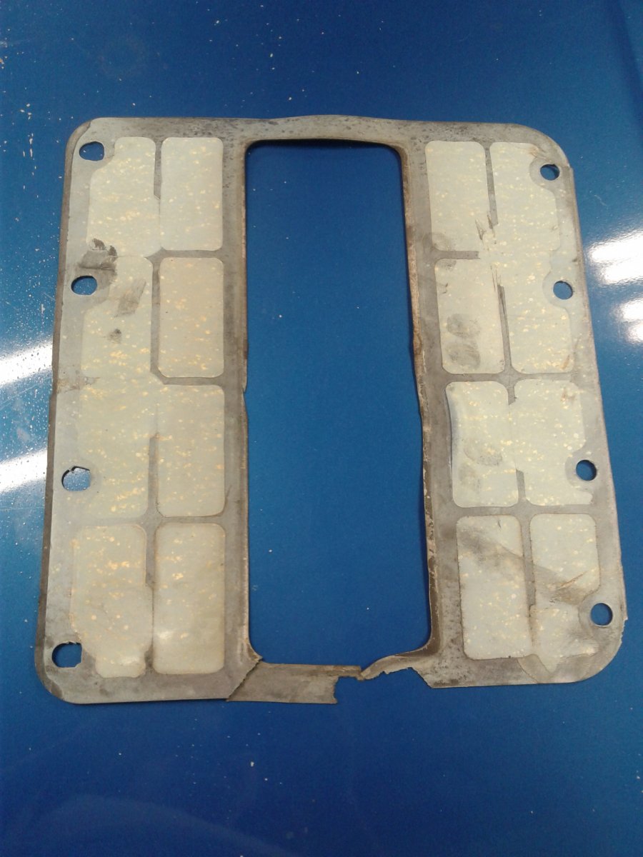

  17. thanks for posting pics and videos everyone. the second road pic looks so cool jim i don't have anything like that. the videos confirm what i was feeling in the car and thinking what was going on during the p***es. if you listen closely to salt flats videos the rpm changes can be heard. the rpm spikes then the engine shuts off then comes back to life. it sounds a little bit like i was pedaling the car but i wasn't. i can also hear the rpm while staging is too high. thats why the launch isn't all that great. the rpm is so high the converter won't flash resulting in a lazy launch. on the first p*** we blew the burst panel out. most likely from the lean condition. it must have also gotten after the gasket between the blower and manifold. it takes a lot of force to blow out a burst panel. it could have easily gotten a piece of the gasket. the engine was getting extra air from some where and a blown gasket there is a good place to look. we will pull the blower off and have a look. it all makes sense now. with all of this information the proper changes can be made. the engine is talking to us. we are all ears as we try to bring it all together for that perfect p***. we are getting close.

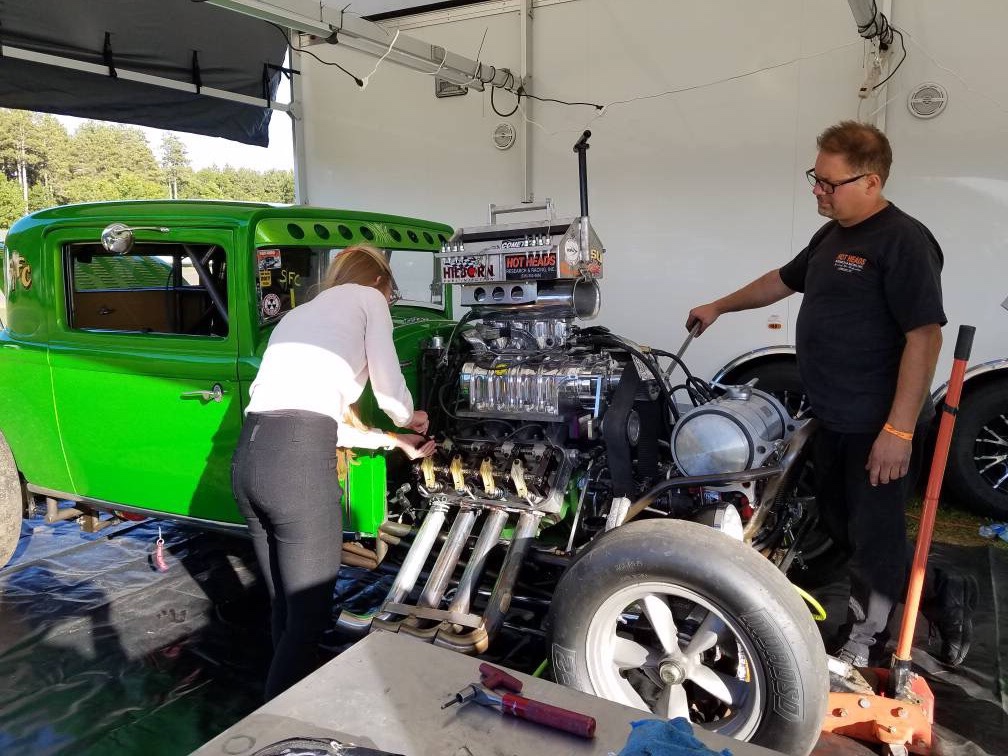

    If you get time Brian can you tell us exactly what your all doing there. I can see your touching the heads I'm ***uming to check for heat. I'm interested in why and what your spraying into the scoop.

  26. Im spraying alcohol into the engine. Iam feeling the heads for heat. Im also adjuating the fuel shut off to build heat faster. Basically leaning it out. When the fuel goes 100 percent open then i adjust the air valve on the scoop for the idle. We do this under a load. I signal to mark behind the wheel to activate the bruno break. This brings down the idle so i can see what it will be like on the line. Some teams warm up the car on alchohol only then switch over to nitro. Either way works. I just use a little bit more nitro doing it my way.
