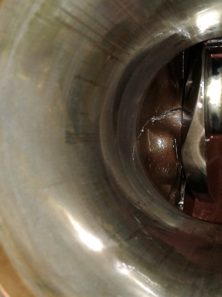

  3. It will be interesting to get the engine apart for a look inside. I dont think its been cracked that bad for very long. I did have water in it mid september during drag week. I think i made a good call to remove the water for the fall out race. We will be back next season stronger and faster. As far as a evaluation of the season goes there were many highs and only a few lows. We rebounded well from the byron mishap winning the yahoo cup. The time invested into specing out a trailer to fit our needs is paying off big time. The ch***is setup is working great on gas and nitro street or strip. We try something new everytime the car moves under its own power and it has paid off. The amount of small details that goes into this operation is crazy. There is so much that does not get posted here. We have shown the world you can dream big and with hard work make them come true. The car is getting more reliable as time goes on. Its fun to tweak the combination now to make it the best it can be.The 2018 season began this morning. All in all i think we did pretty good. Thanks everyone for following along stay tuned in there is alot more to come. Special thanks go out to several supporters of this project. Each one plays a special role in our success. We couldnt do the things we do without them.

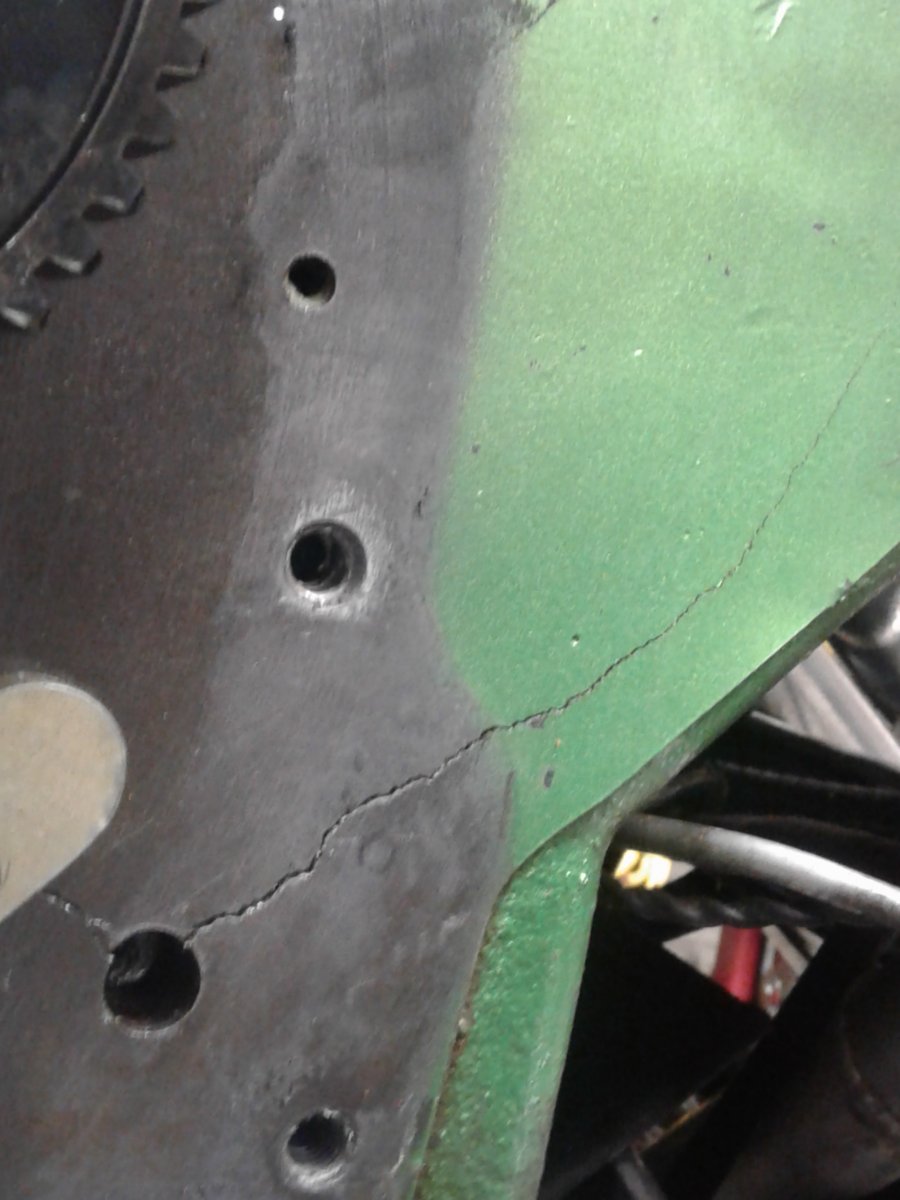

    That crack looks like it may be a result of a stress from all the external equipment running there in the front, rather than just the power of nitro? Or is that location common for old hemis with dynamite to go south? Not that any of this matters really but I was just thinking the possible reasoning.

  14. The accesories are not causing the problem. The block may have had a core shift or internal rust issue. There might have been a little water in it that froze. After its out and apart we will inspect everything. I will sonic test it in several areas for clues. If i cant afford the donovan this winter i will try to find a standard bore block. I will rock block it half way up. Look up rock block its a epoxy unlike the cement. We might also drop the compression more. Im currently running hot heads steel caps on the center three mains. I might step up and get the other two. All of these things will help. I have been beating on this block for several years.

    Your block reminds me of my 455 Pontiac that was leaking oil out the rear main. I pulled the engine for a new main seal, when I unbolted the main caps, three of them came off in pieces and the block was cracked from the crank to the cam on two journals. I was bracket racing it the night before and it was running just as good as it ever did. One more p*** might have really killed it, but it made it home without blowing it's guts on the track or most importantly, in front of other racers!

  27. I got the engine taken apart this weekend. To my surprise i found all of the small side bolts missing from the main caps on the p***enger side only. One of the nuts was almost off of the stud. One cap was lifted off the block. I couldnt turn the engine over until i first removed five pistons. Number 1 and 3 i cant get out. They made it as far as the deck i also had to remove three caps and loosen the other two just to get the crank to turn. With the pistons out i could see the main webs. They are all severely cracked. Everytime the pan comes off we check bearings and torque. This thing was a bomb waiting to go off. Nitro can be a rough deal. Anyone out there that has a block 392 or 354 im in need. I have checked all my sources and came up with nothing. 20171022_150447.jpg 20171022_154630.jpg 20171022_154544.jpg 20171022_154603.jpg
