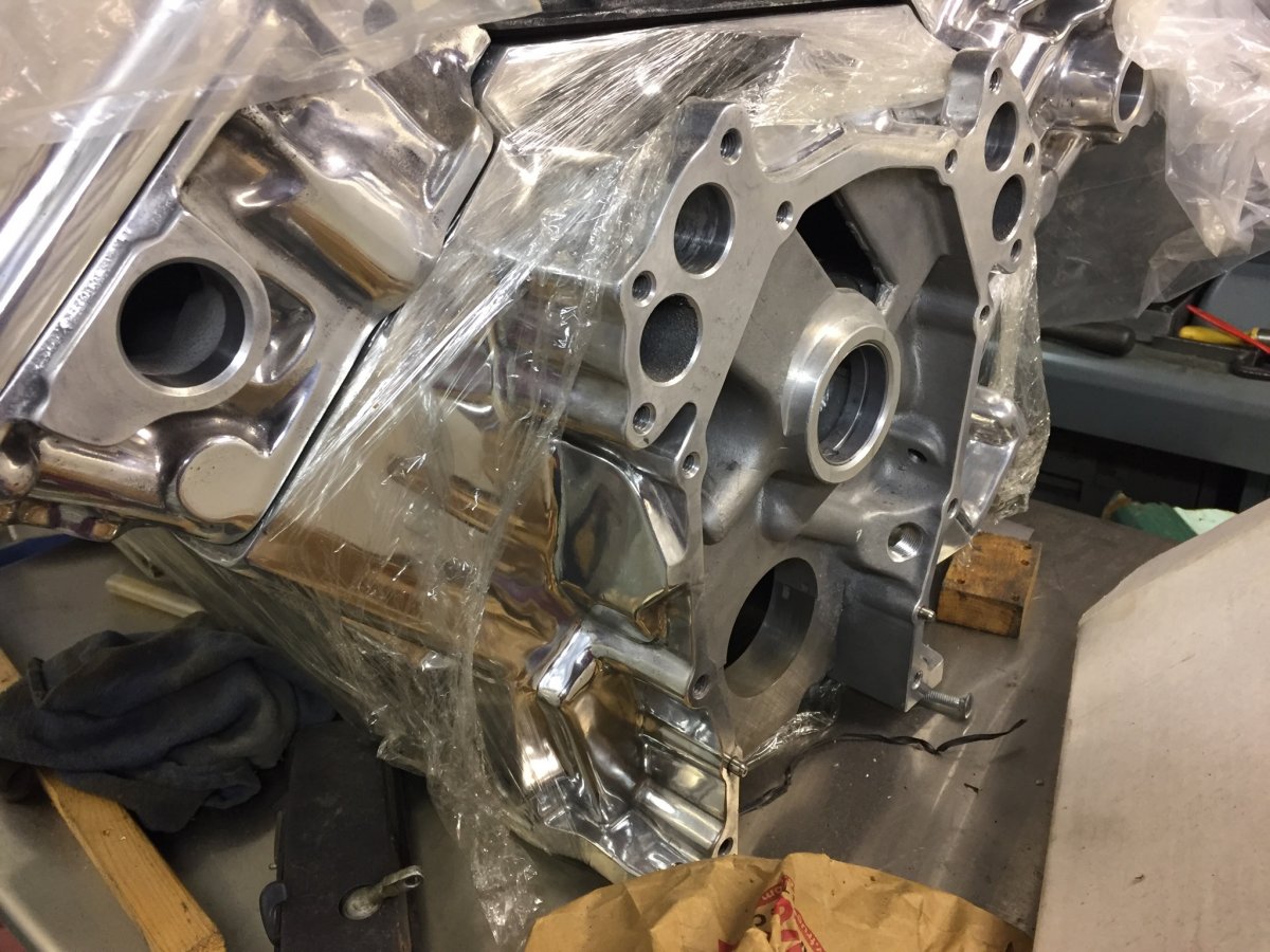

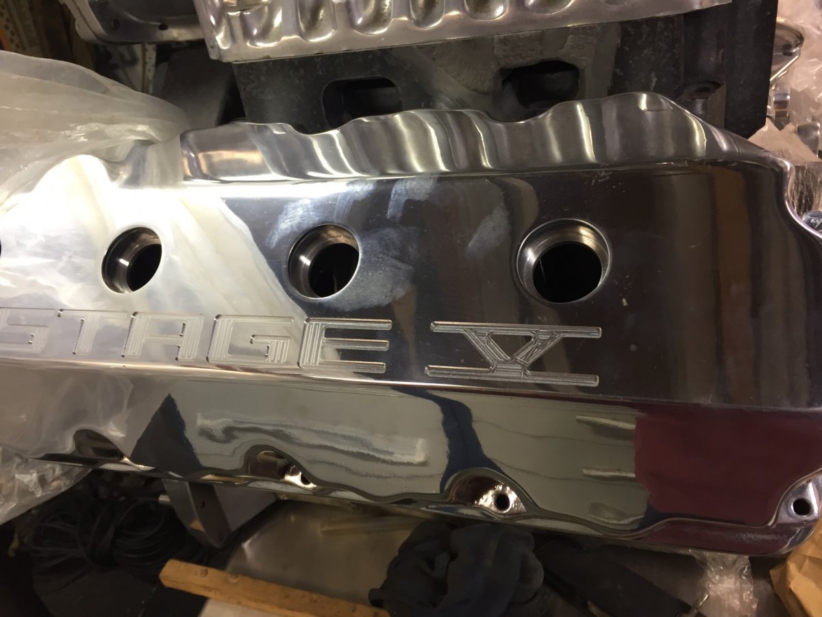

  7. Now that the dust has settled from last season its time to get busy for next year. There are some big changes coming next year. I loaded up the truck with a few hemis and ran over the to rogers. By the time i was done loading everything up i almost had no where to sit. Some local guys are currently using rogers services so i offered to run their parts over along with mine. Im including a few sneak pics 20171202_110823.jpg IMG_2361.jpg IMG_2362.jpg of whats to come.

    Don't show that to Jim Forbes!
    loudbang, squirrel and mad mikey like this.
  9. He already knows. Too bad there was not another one available. Its exactly the combination of parts he needs.

    Wow. Welp' ..... first order of business is to change that engraving to STAGE VVV. (555)

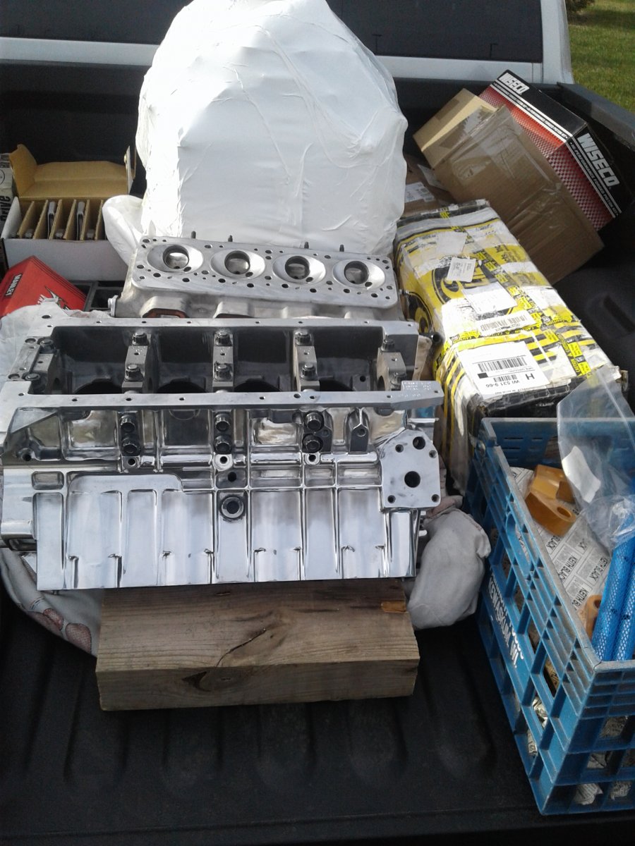

  12. Im a working guy just like most guys on here. I work a ton of over time to go racing. A kb engine was out of reach for me right now.
    Due to the untimely death of a friend i was able to aquire this complete engine. The estate reached out to me knowing not only that i could use it but also had the knowledge to put it together. They said some things are worth more than money and arranged for me to pick it up last sunday. Out of respect for the families wishes to remain anonymous no further information will be diclosed. I will how ever provide details about the engine.
    Brand new kb water block standard cam height standard deck height
    Polished
    4.5 bore
    4.5 stroke billet vallasco std chrysler rods and mains
    572 ci
    Stage five raised port heads fully ported by stage five.
    Complete stage five valve train
    Heads polished
    We are in the process of pulling sleeves to make it a 4 3/16 bore. This will allow us to use on the shelf pistons and shelf rods.
    I feel honored to aquire this engine and will do my best putting it together in memory of our friend.

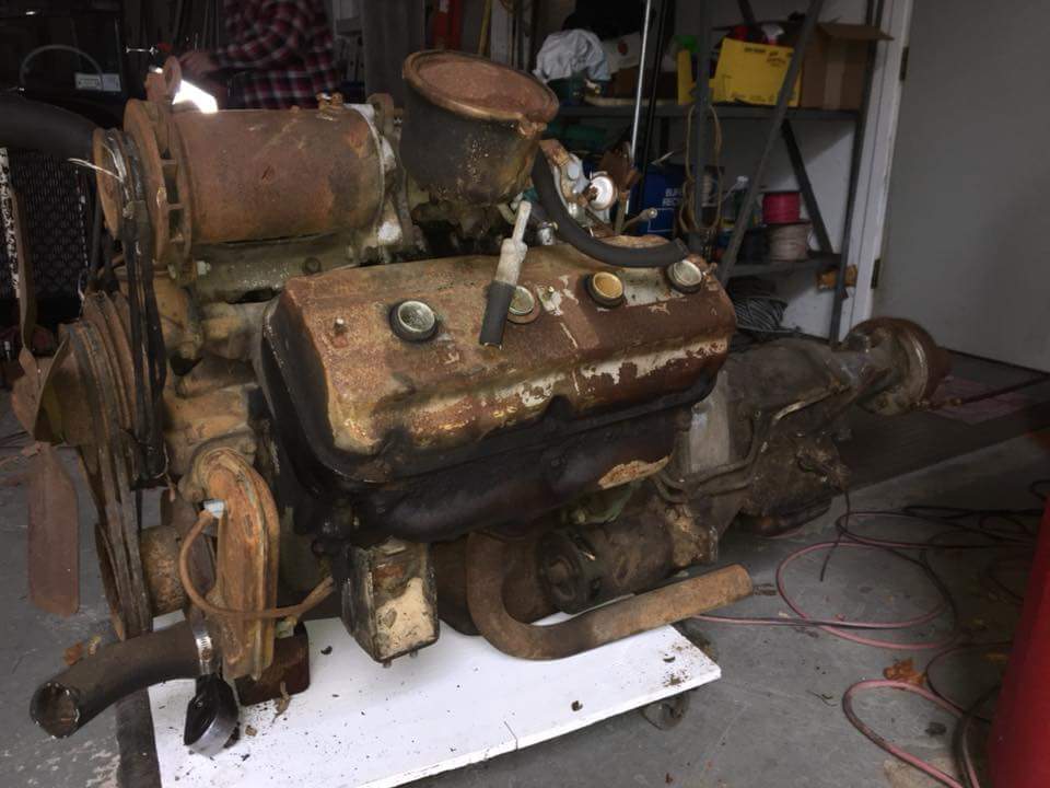

    My buddy is selling a complete 354 in the Buffalo N.Y. area for $2900 if youre still looking, he runs a green coupe in the 4.80's with a small hemi. FB_IMG_1512326832086.jpg FB_IMG_1512326865369.jpg FB_IMG_1512326883603.jpg FB_IMG_1512326875484.jpg
