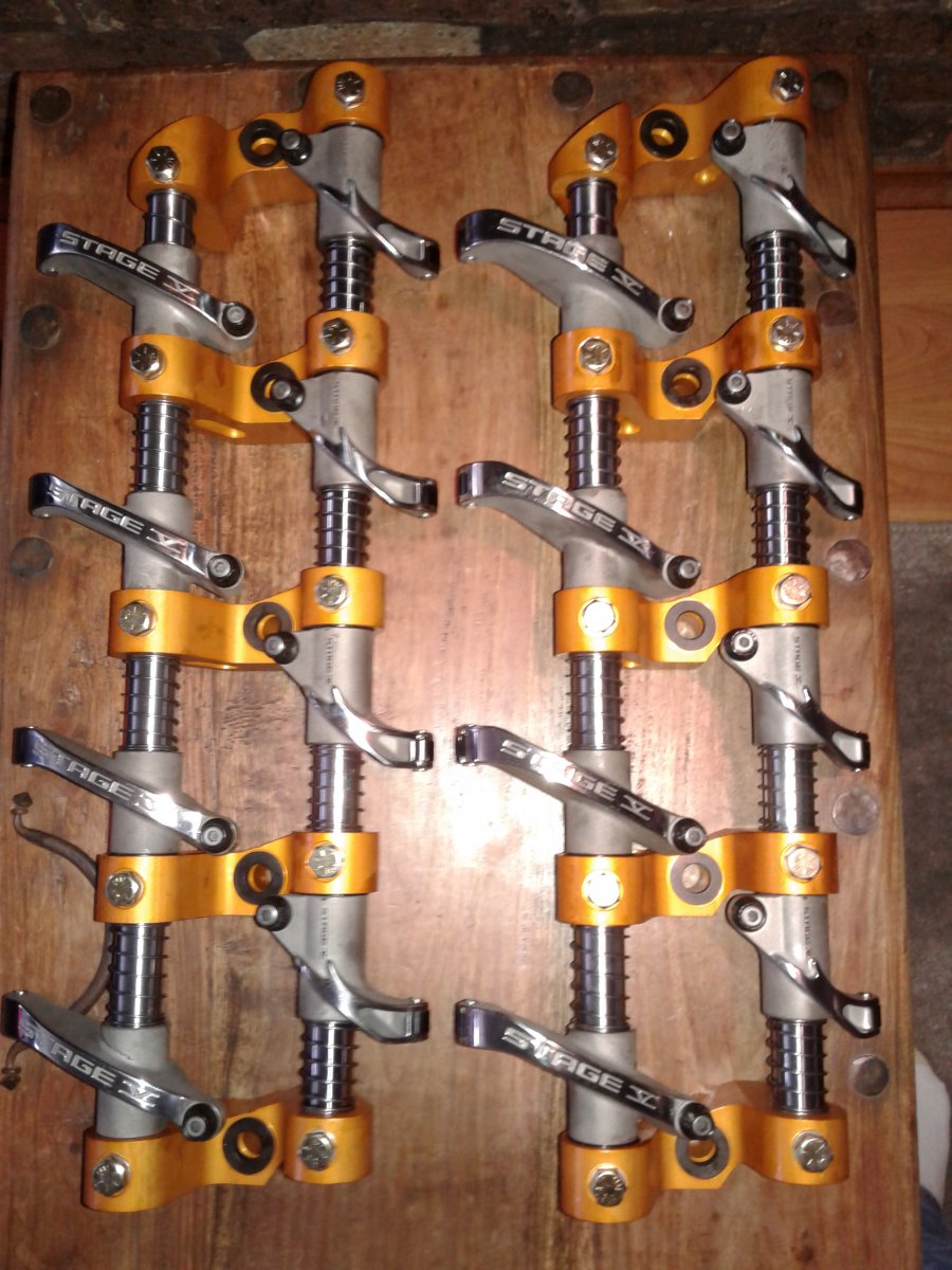

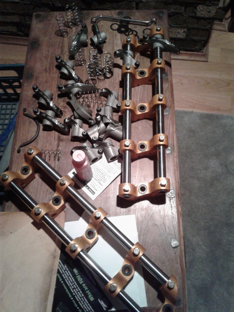

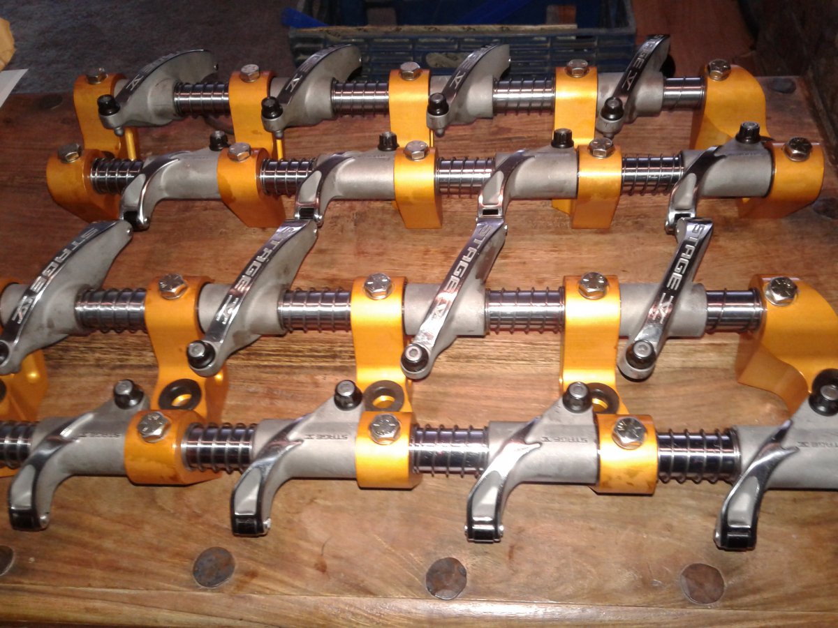

  3. I found a good way to spend the afternoon. The stage five rockers are all ***embled. The stands are keith black. They 20171204_213440.jpg 20171210_145355.jpg 20171210_145420.jpg are no longer available. The gold ones were the best ones they made due to the material used and the steel inserts placed were the studs come through. This keeps the stands from pinching the studs when the nuts are torqued making for a easier dis***emble. Not too many years ago this was top fuels best set up.

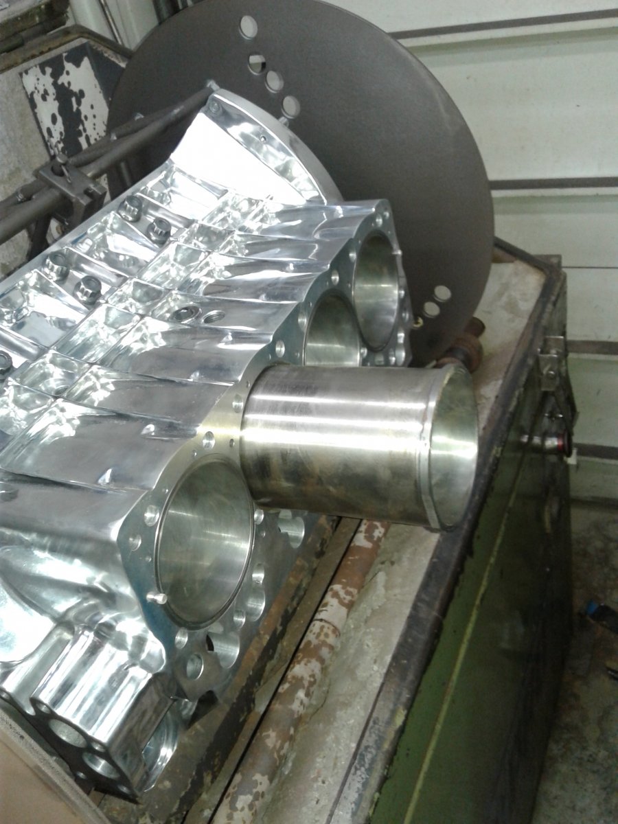

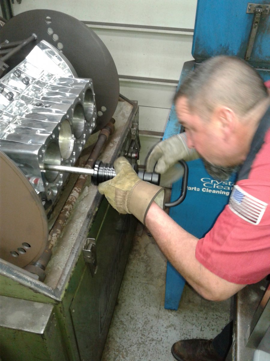

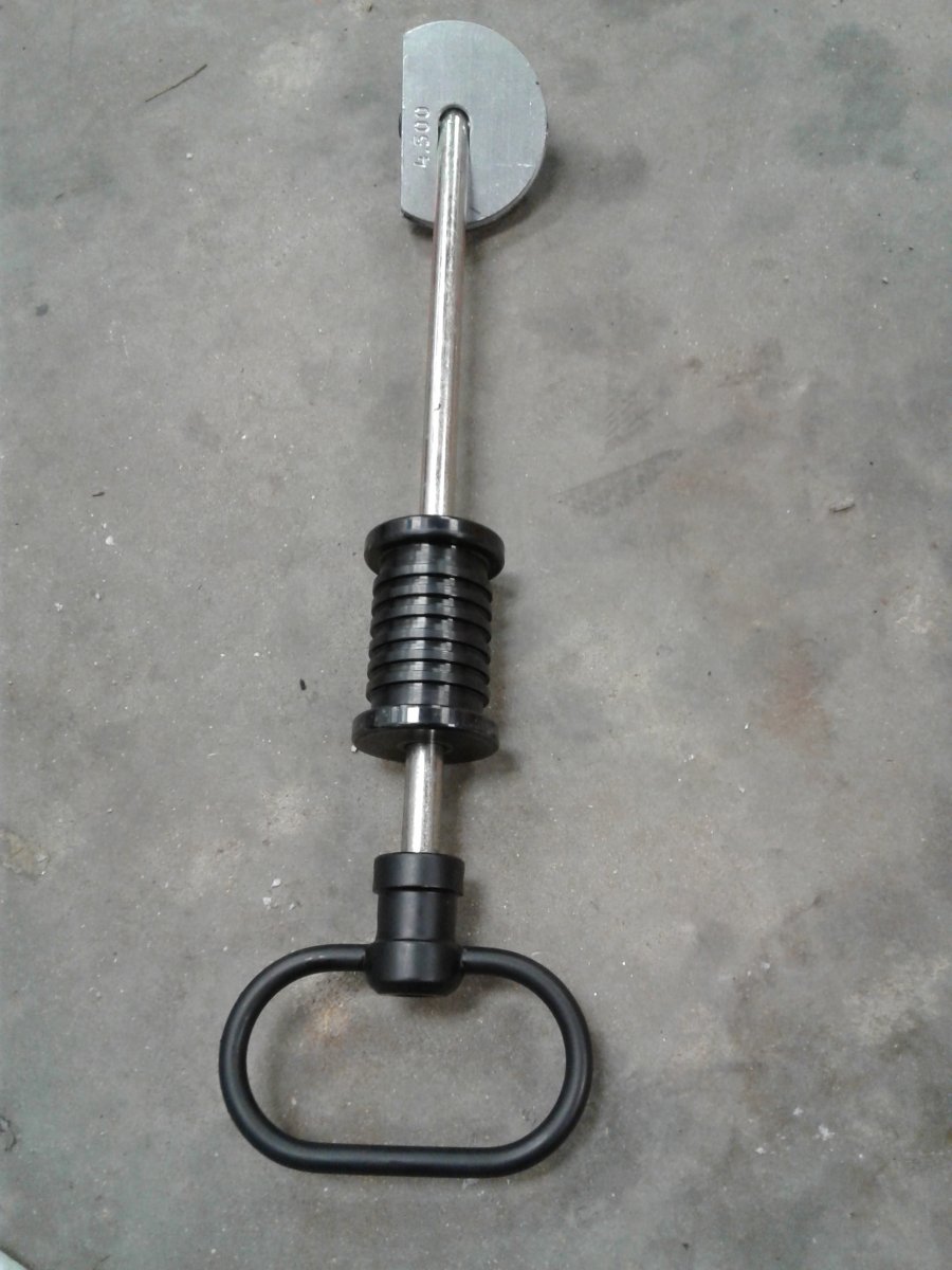

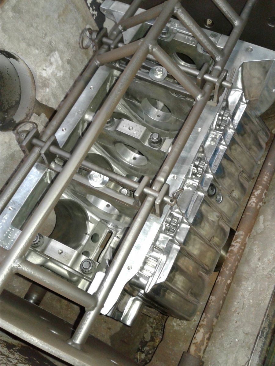

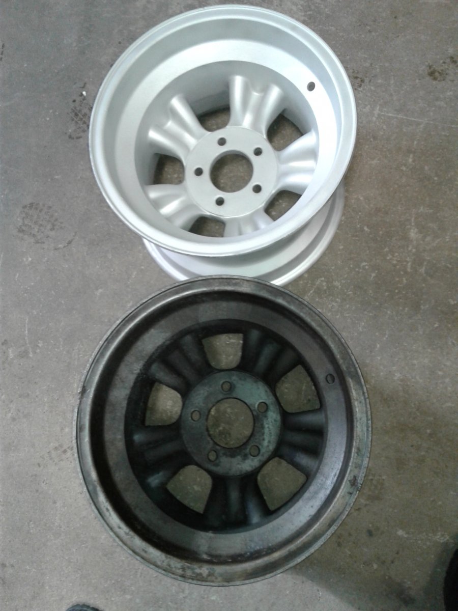

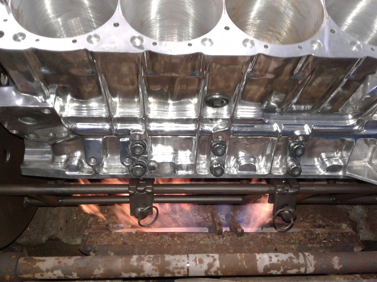

  4. 20171211_125943.jpg 20171211_152846.jpg 20171211_153658.jpg 20171211_175434.jpg 20171211_152955.jpg 20171211_152915.jpg The work never ends. Today i got the bear claws i purchased at the pri show gl*** beaded. Now i can have matching rims for the street tires and slicks. The other thing i did was getting the sleeves removed. The block is first put in a cage. The cage is then lowered into the furnace. Its slowly brought up to 225 degrees as the block is rotated. The block grows enough to allow the sleeves to be pulled out with the sleeve puller. The piece that grabs the sleeve is bore specific. To put in new sleeves the block is heated again and the sleeves go on ice. They will drop right in. At the track a quick tear down is important while the engine is still hot. If it cools too much it makes the job very difficult. Notice the area were the sleeves go in is solid. Not all blocks are solid. This block is designed to hold water.

    If the area where the sleeves are are solid, and the block is designed to hold water, where does the water go? Are there water p***ages in the cylinder area outside the sleeve area?

  9. After a p*** we leak down the cylinders. If there is a indication that something is wrong we pull the head. If the cyinder is scored we change the sleeve. If its a bent or burned valve we change those. I dont normally need to change sleeves but we are always ready.
    My block looks like a normal block when the sleeve is pulled. The sleeve is not in direct contact with any water. It goes in a bored and honed out hole. The water makes contact with the aluminum only. The block has water p***ages. The sleeves dont need o-rings or sealant. The wet blocks do have sleeves that have water in direct contact with them. There is a sleeve register top and bottom. The middle is hollow. This style block is hard to seal. I dont have a pic of this style block. Another positive coming from sleeving the block with a smaller bore is the cylinder walls become thicker. This promotes better ring seal.

  11. 4 3/16" this is the one of the most common bore sizes for a fuel car.

    Interesting, I wasn't aware that they went that small. That's smaller than a stock Hemi, which is 4-1/4".

    They need really thick sleeves, eh? Nitro is wicked stuff

    In the past a 5/8” stroker was typically used and when 3/4” cranks became the norm then the bores had to be reduced to stay in the 500 c.i. limit. The 3/4 crank loads the engine more resulting in more nitro burnt.
    More nitro= more power.

    So there’s enough residual heat in the block to take the sleeves out and get the new ones in? ***ume you keep the spares cold, just in case. But if you’re not fast enough, either they won’t come out, or the new ones won’t go in, and the weekend is over unless you can find or rig up a way to heat the block?

  21. if you have a experienced crew a sleeve swap can be done before the block cools. the first thing that is done to my car after a p*** is a leak down and plug inspection. this will give you a good idea of the health of the engine. to get a idea how much a aluminum block grows due to heat i set the cold lash at .016 because hot it becomes .026 a iron block won't do that. the sleeve bores also expand when hot. thats why the sleeves can get pulled out. the sleeve bores are honed to size. trying to remove them cold is not only hard on the crew but also hard on the block. the bores could be damaged. if a sleeve needs to be replaced its all hands on deck for a crazy well choreographed thrash.
