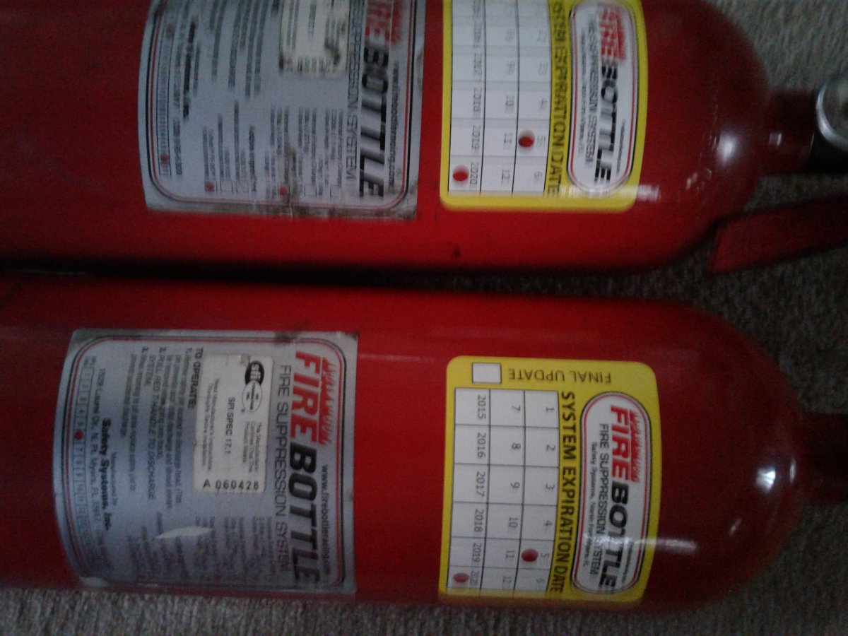

  1. I havent posted much in a while but that doesnt mean we are not busy working on the car. After the pri show work began taking advantage of all the good deals there. Rods; pistons; cam; tools; sleeves and safety equipment were ordered. Anticipating faster speeds and lower ets i ordered several things from dj safety. Two 12 foot parachutes will replace my single 10 footer. Two chutes are required over 200mph. Burn down tubes by sae will go on the valve covers to prevent a fire if a piston is burned. If a piston gets a hole in it the crank case pressure will push out gaskets. The resulting loss of oil can hit the headers starting a fire. The tubes allow the pressure to vent into what is called a puke tank. I got the fire bottles recertified. I also picked up some dj safety driving shoes; head sock and under wear. This will up my protection to 40-50 seconds before burns. Fires are a real threat to nitro drivers. A big pile of parts was ordered from john dunn racing. Bearings; rings; spark plugs; ignition wires etc were bought in large quan***ies. Its a million details that make this all work. 20171222_091641.jpg 20171222_091901.jpg 20171222_093225.jpg

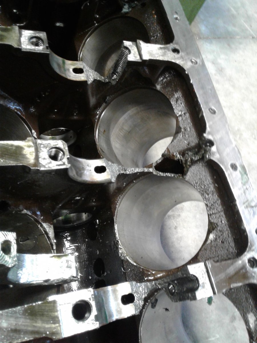

  6. I got the crank out and this is what i found. Three of the main caps webbing were completely broken. This is on top of all the other cracks posted previously. I was only a hit of the throttle away from re enacting the magic muffler car. This is why the kb block is a safer way to go for me. 20171222_102550.jpg

  7. squirrel
    Joined: Sep 23, 2004
    Posts: 59,983
    squirrel
    That block died with it's boots on!
  8. DDDenny
    Posts: 22,472
    Good gawd Brian, I think you won the lottery, really dodged the bullet on that one.
    You must be living right!
  9. I got lucky. Ussually this kind of damage is found after a on track incident. It gives me the chills to think about what could have happened.
    chryslerfan55, bobwop, Stogy and 2 others like this.
  10. David Gersic
    Joined: Feb 15, 2015
    Posts: 2,814
    David Gersic
    from DeKalb, IL
    Damn. Surprised that it was still running with all that disconnected metal. Lucky indeed that you didn’t try to make one more p***.
  11. saltflats
    Joined: Aug 14, 2007
    Posts: 13,601
    saltflats
    from Missouri
    Got your money worth out of that one.

  12. The pieces were all in place when the crank was in the block. When i removed the crank i pulled them out with my hand. Im surprised at how thin the casting is. I will save the block for a conversation piece.

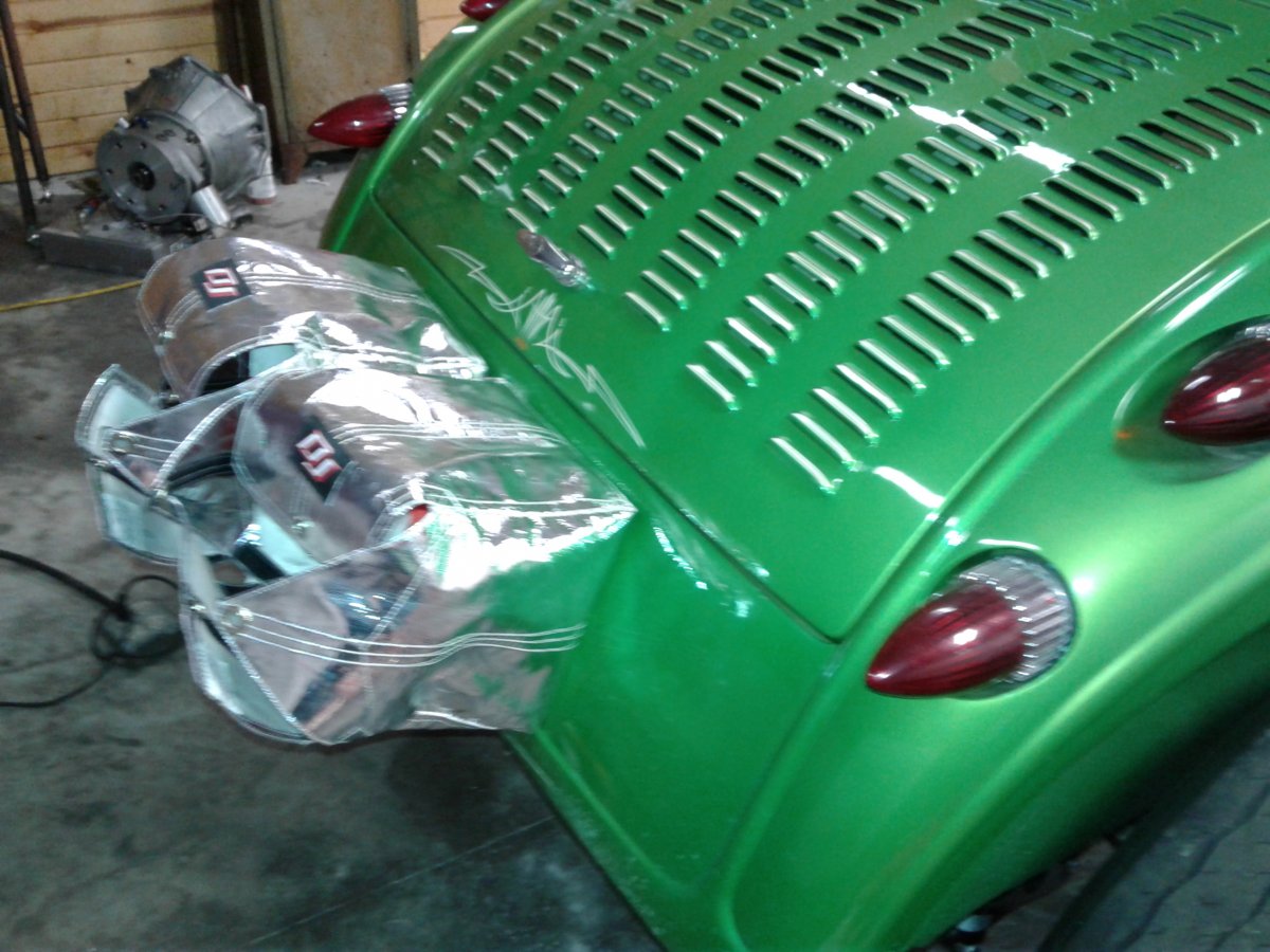

  14. I got the new chutes mounted today. I still need to add a second handle and cable. So do two chutes make my cars *** look big? 20171223_171310.jpg

    chryslerfan55, bobwop, Stogy and 3 others like this.
  15. saltflats
    Posts: 13,601
    saltflats
    from Missouri
    Yes it does.....**** that's OK. :D
