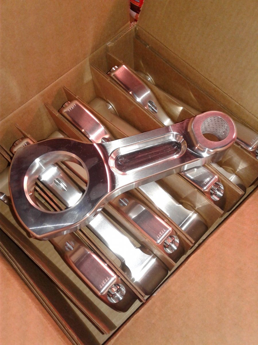

    Why does the small end have small holes drilled in it. Oil retention?
    chryslerfan55, mad mikey and Stogy like this.
  4. Im not sure why the pic turned out that way. Holding the rod in my hand i dont see the dots or feel them. Maybe it was a reflection of some sort due to the flash.

    Probably an interference artifact, from the pixels in the camera, and the hone marks on the pin bore.

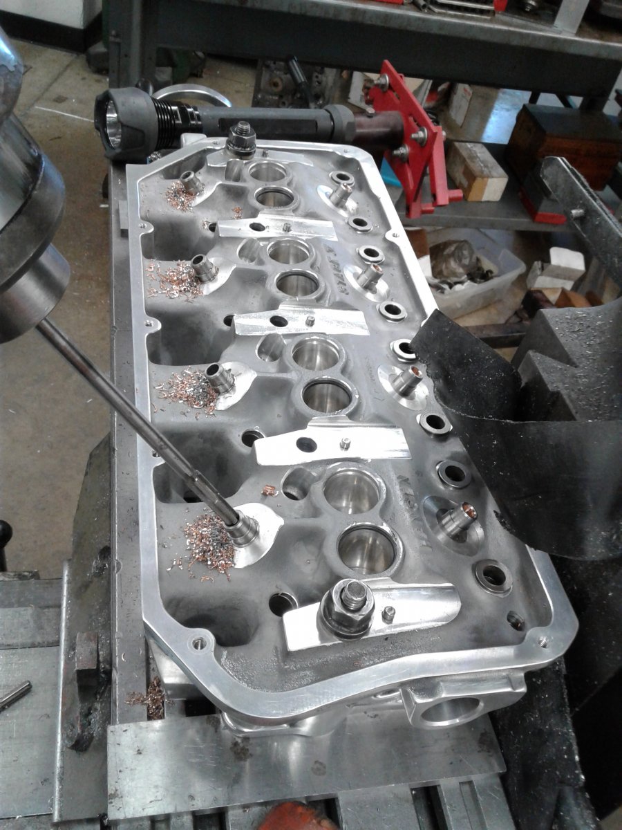

  20. 20180105_153210.jpg Another trip to iowa is in the books. I dropped off the 354 for tony and worked on some of my things. The stage five heads i have were set up with 5/16ths stem valves. This wont work with nitro. We wanted to use 3/8ths stem valves but that would have created a big mess due to the guides becoming too thin. So we went with 11/32 nd stems on the intake and exhaust. All the liners were drilled out then the guides were reamed. Each hole needed to be indicated first. After that new liners need to be installed. View attachment 3766048 It takes all day to do a set of heads but its worth it in the end. After that the installed heights were checked out and all of the valve train components were ordered. Going to rogers place is always alot of fun. There is always alot to learn. The place is a serious no b.s. machine shop. View attachment 3766048

    I ***ume you mean 11/32nds, not 11/16ths for the valve stem, its way closer to 3/8ths. What angle are you reaming them out at? It looks like you tip the mill head to do this. Thanks for dropping the block off.
  22. That was a typo. Just seeing if you are paying attention. I edited it. Im not sure what it was set at. Roger had it set up he did the first one before i got there. Each guide was set up so perfect a valve job wasnt needed. The seats were just lightly touched with a stone to make sure.

    Why not use the cones to center off the seat and bore the other direction? No K-Line Tooling for liners? Keeps more concentric to the seat and can do a full set of liners in about 30 minutes. Good choice with 11/32 stems more valve selection.
    chryslerfan55, racer-x and loudbang like this.
  24. I will p*** that along to roger. He just said he wants to do it in the mill. It would have been nice to get it done quicker.

    Here is how I do it. It goes really quick if you have their kit. I use three different broaches to help seat it against the walls really well, ream with a AV&V Carbide Reamer, and do a light hone with a diamond hone to dial in my clearance.
