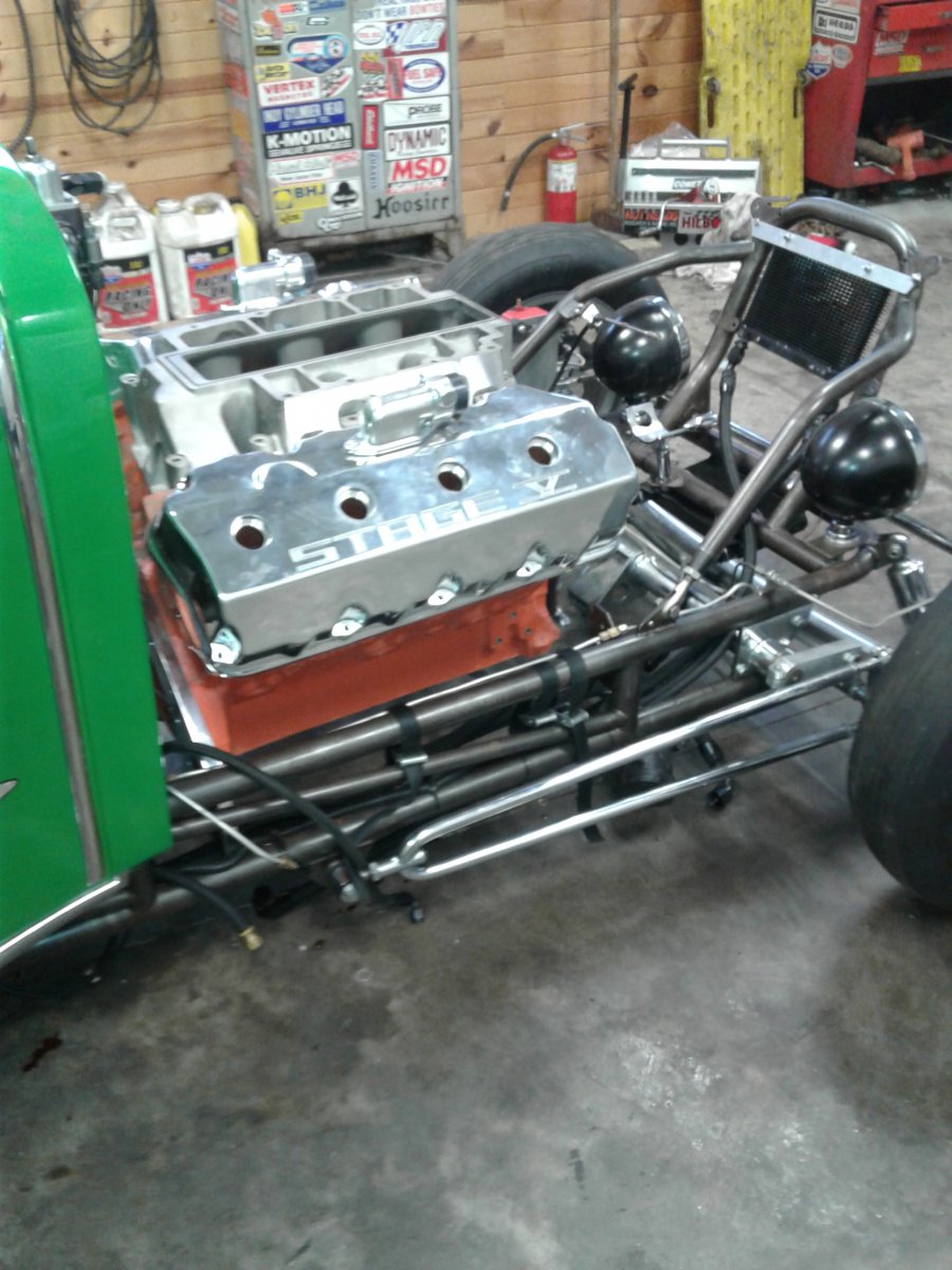

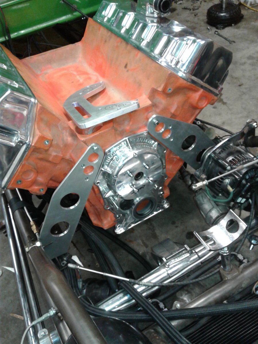

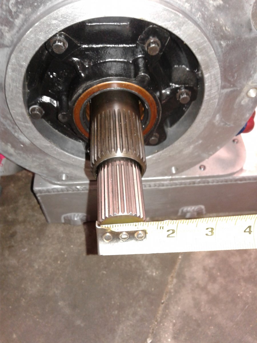

  12. The mid plate was finished last week. It was brought straight to the polishers taking only a day to finish. My drag week co pilot mark janecky lent me his mock up plastic block. Its much easier to use due to its light weight. Front motor plates need to be made along with headers. The block makes mock up alot easier. Other small items like alternator brackets and a filter mount will be done later. The bruno drive was brought down to brunos last week for updates. We changed the input shaft from one inch to a inch and a quarter. The old one could break with tire shake at 2000hp. The new one can handle 5000 plus. It wont break now. It also received a full tune up. A new pump and drum along with a new band were installed. Today i talked to my friends at cometic gasket. They are backing the car again this year taking care of all my gasket needs. They offer metal re enforced gaskets that wont blow out and can be re used several times. Just what a race car needs. Thanks guys. They are also a sponsor for drag week this year. They will have product available during the week. Check them out they make a top quality product. 20180122_111905.jpg 20180122_105809.jpg 20180122_115116.jpg 20180122_115059.jpg

  14. the blower is staying the same. i just got it back today from littlefield. its a 8-71 retro gas blower. we wanted to go hi helix but they said it won't work on the street due to the tight tolerances. being a 8-71 it will need a adaptor plate to cover the larger opening in the kb manifold. we will drive it harder to produce 25lbs up from last years 13lbs. the new block will be able to handle it without cracking. with all of this extra boost the fuel pump will change to a steel 20 gallon nostalgia funny car pump. we ran a enderle 1100 16.8 gallon pump the last few years. we will also be adding eight extra port nozzles. a new moon tank is on the way for more tank volume. running out of fuel with this combo will make things go boom. we are not taking any chances. its getting serious now.

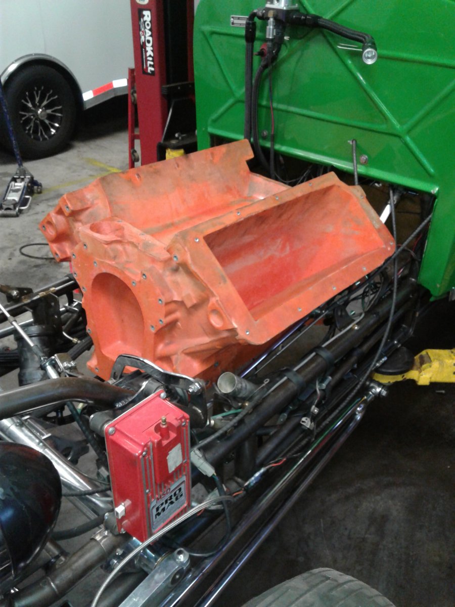

  17. Well thats enough for today. It felt good to be out in the shop again getting things done. The late model has the oil pump on the left side of the engine. The oil pump might cause problems with the steering shaft. I dont have the pump yet as its being made right now. I have about 4-5 inches to play with. The early hemis pump is inside the pan out of the way. The motor plates go to the polisher this week. Im into shiny stuff. 20180122_194936.jpg

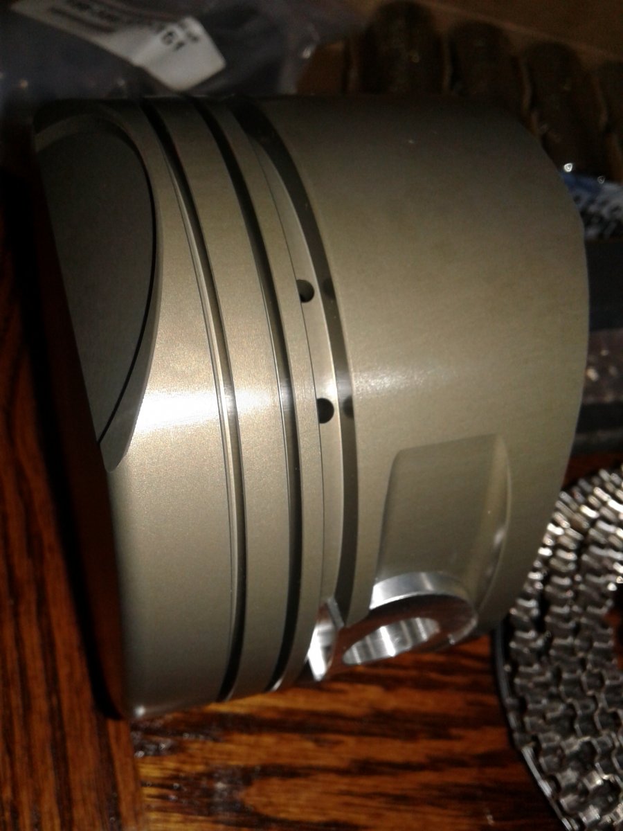

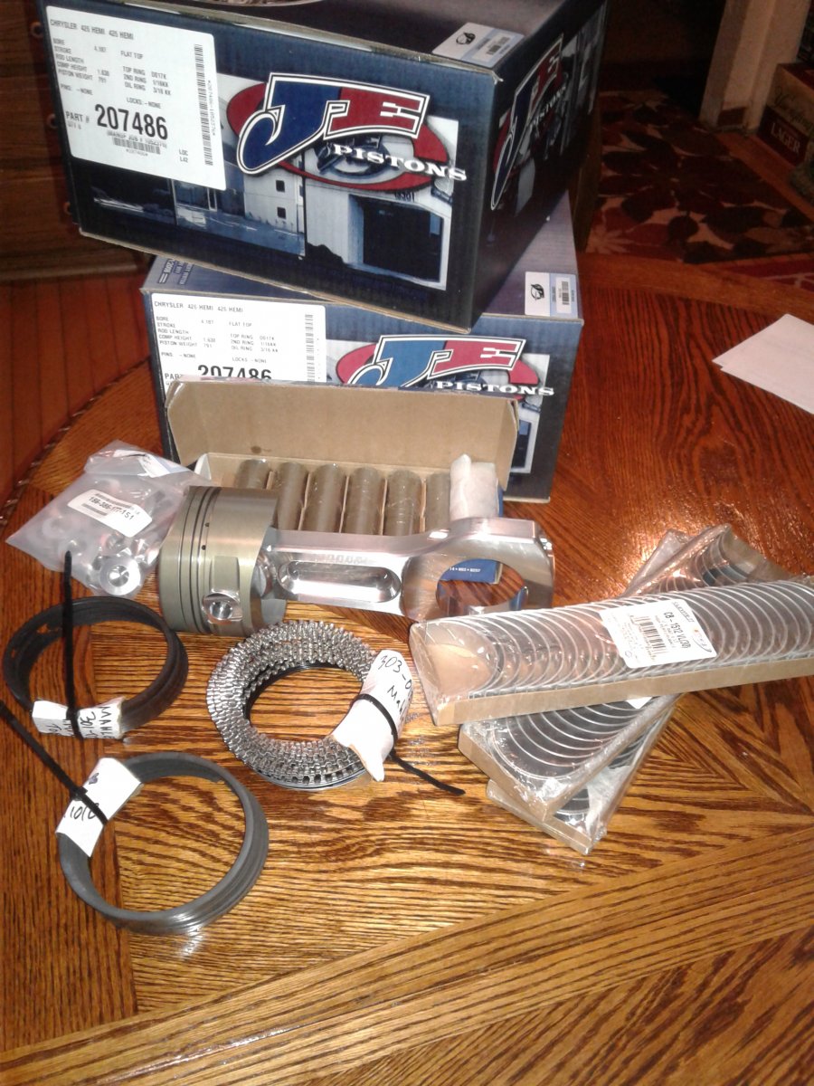

  23. 20180125_220358.jpg 20180125_203937.jpg 20180125_204014.jpg 20180125_204000.jpg 20180125_211803.jpg 20180125_211606.jpg For some out there this is nothing new. For others not familiar with a nitro engine this tech stuff is for you. The pistons showed up today. I will drop off the crank and one rod; piston; rod bearing set; ****ons; one set of rings so the crank can get balanced. Due to the volume of fuel thats burned the weight of the fuel is also figured into the balancing. The ****ons replace the spiro locks to hold the pin in place. The oil rings hold the ****ons in place. Thats why the ****ons are grooved. This is a lot safer way to hold the pin in place and alot faster to dis***emble when a piston needs to be replaced. Spiro locks and snap rings can become disloged ruining the bore. They are also a pain to work with. The pistons have a hard coating on them to prevent scuffing. Due to the low compression of a nitro engine the big hemi dome normally found is not needed. Its a flat top piston with a intake relief cut into it. The pin is the larger diameter and wall thickness. The pistons still only weigh 791 grams. Several sets of ****s rings were ordered. The ****s style ring is prefered for better sealing. The gap is increased not only to prevent ****ing it also lets pressure build up behind the ring for better sealing. I picked up a few sets of rod bearings. The top bearing takes the abuse. Therefore extra sleeves of top bearings were ordered. The tops dont have the dowel holes. When engine maintainance is performed the bearings are measured. If they are out of spec ussually smashed wider and thinner a new top shell is put in. The lowers can ussually be reused. Nitro cars are all about spares. This little pile is enough to get me going but not enough for a season. These parts while special are really bread and ****er for a nitro or alchohol engine.

  26. just 12 they aint cheap. i can get more in 5-7 days if needed. i figured if i burn more than four right away we have problems that are bigger than pistons. its just nice to have a few around. i don't intend on chasing the hp to the point its on the edge of burning pistons every p***. i will run fat and safe. i can't afford it other wise.

    Looks like aluminum ****ons must be the latest thinking. We used to use Teflon in gasoline strokers. First ones I ever saw were done by Gilly at Moldex crank. I sure miss that old guy.
  30. I was using aluminum and magnesium ****ons 20 years ago. Im not sure when the teflon ****ons went away.
