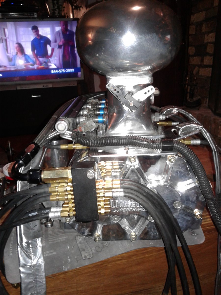

  6. We think the injector with 2 3/8 inch ****erflies will not be big enough. Driving the blower harder will require more air flow. These castings can also come 3 inches. The problem with the 3 inch bores is the tip in off idle. Now i have a bigger engine i can use the big 3 inch. A very slow action is required on the gas pedal to help with street driving. There is enough material to bore it out. A new shaft and ****erflies has been ordered. The casting is in the mill with a boring bar set to 3 inches. The final size will be 3.002 inches. We will finish hone to size. The dirt rings on the casting now will be around the size it will end up. From the bottom you can see how much needs to be removed. I think we can all see where this is heading. 20180201_212714.jpg 20180203_075742.jpg

    Can you move the injectors to help the tip in?

  11. The issue is the size of the ****erflies. As they start to open so much air is let in its like going 1/2 throttle on a carburated car. It becomes too much too fast. To cure this or at least reel it in some a few things can be done. A larger cube engine helps. A cam with 284 degrees duration at .050 helps. And a change to the timing map helps. Pulling timing at low rpms kills some low end power off idle. hilborn has a efi system that eliminates two ****erflies blocking them off for street driving. Im willing to compromise some to drive it on the street but not block off bores.. The mag is a whole story unto itself. Its locked in at 50 degrees or more. No tip in worries on nitro. Its instant full throttle.

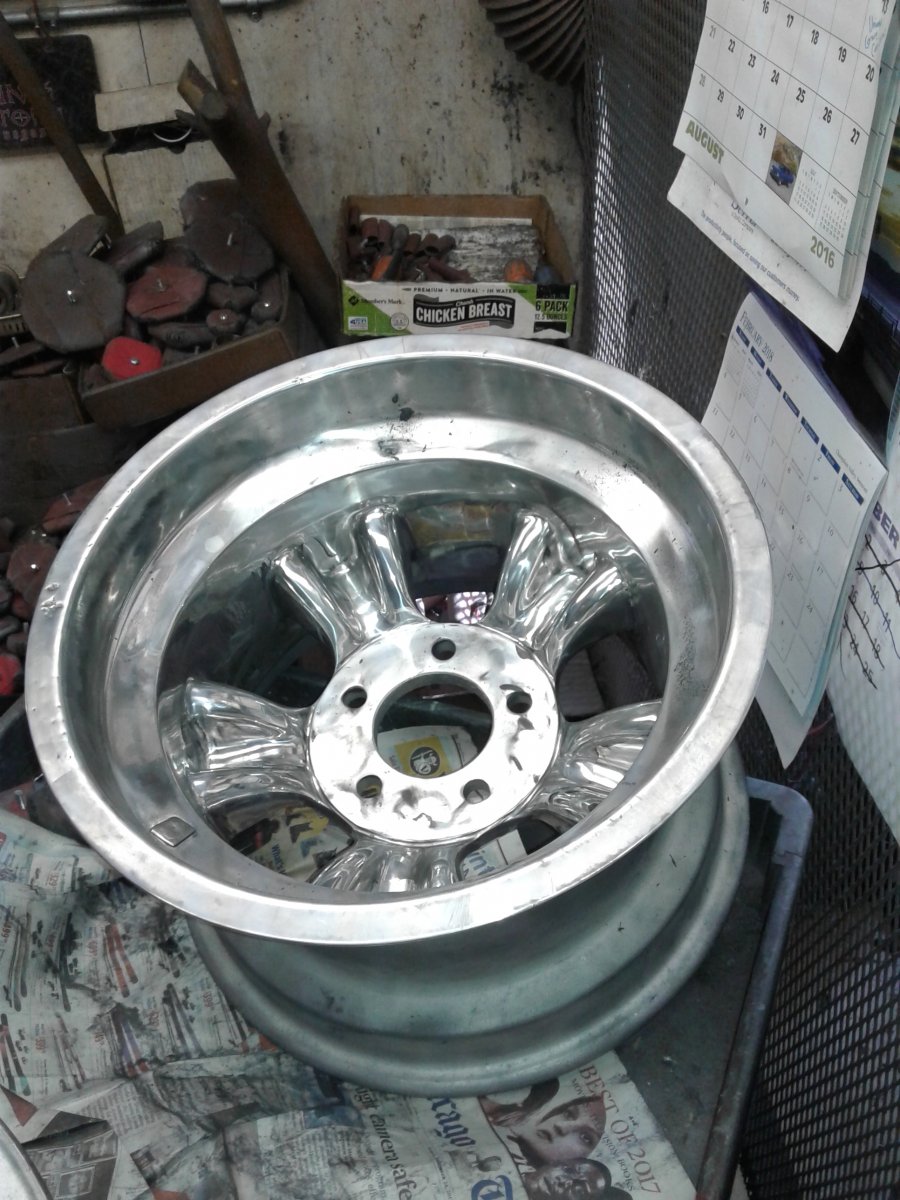

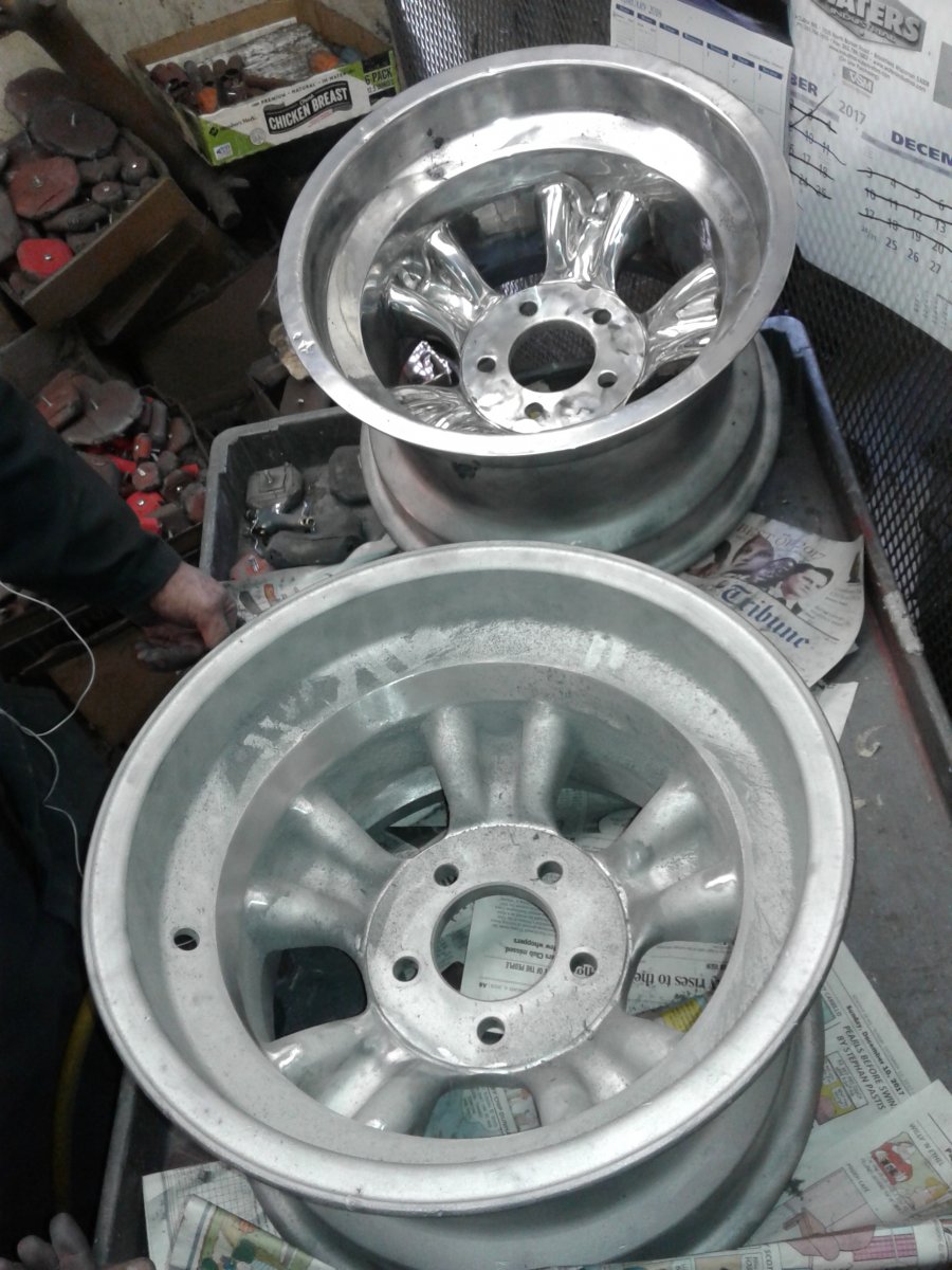

  13. 20180205_102453.jpg 20180205_102442.jpg I stopped by the polishers to get a progress report on the rims. One should be done on wednesday the other one in two weeks. These rims will have the street tires mounted to them. It may be a little over the top for the street but im ok with that. It kind of fits the theme of everything else i have done to to the car.

  15. It took a few years to find another set that i could afford. The sad thing is most guys dont even know what they are or how rare they are. I just think they are cool and the right wheel for my car.

  17. I found this pair on hot heads swap meet page. The guy that had them was going to be at the pri show. I met him in a parking garage and we swung a deal. It just some how was meant to be. The longer i stared at them the more i knew they had to be polished. They take on a completely different look polished.

  22. I haven't gotten the bill yet. it really depends on what kind of condition the wheels are in to start with. All 50 year old magnesium wheels have some corrosion. If the pits are deep it takes more time. Other price factors are how much do you want polished. The outer edge can be done. The outer edge and the first hoop polished. Or the front face of the wheel. Then there is the back side. On the front wheels i do the back because its seen. On the rears i have the areas that can be seen between the windows done. The cost is based on time. The magnesium is also a big dirty mess so i give them a tip. Starting cost for a pair would be around 300 dollars. The whole wheel costs more of coursse. One wheel is the way i got it the other after it was gl*** beaded. I blast them myself to save money. Its hard to believe these are the same wheels that are being polished. 20171211_125943.jpg

  26. IMG_0054.jpg This is why i like polished magnesium. One down one to go. Not all wheels look good polished. Bear claws certainly do.
    The deed is done on the injector. It now has a 3 inch bore. The engine cant make big power if it cant breathe. I flat out refuse to put a bird catcher or a big ugly on the car so the three incher must do. IMG_0053.jpg 20180207_173256.jpg
