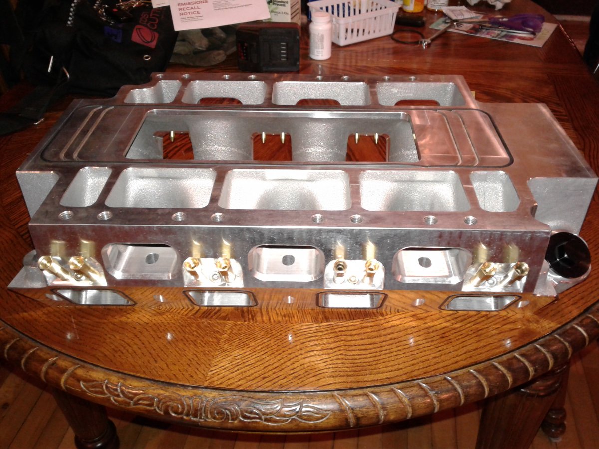

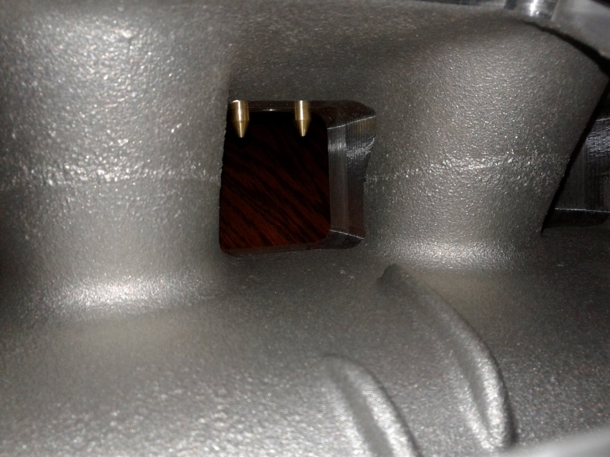

  2. 20180219_200901.jpg 20180219_200939.jpg 20180219_200952.jpg 20180219_201015.jpg 20180219_201038.jpg 20180219_201131.jpg The stage five intake showed up today. I ordered it back in december to my specs. I wanted a manifold with a double drilled deck so i can put the blower were i want. Huge hp gains can be made with the blower position. It can really balance out the fuel distribution. I wanted the ability to have up to three port nozzles. They still have the records on the heads intake port size on file. I had them cnc match the manifold ports to my heads. The manifold has two burst panels. one on each end. If there should be a back fire on nitro the panels blow out. That way the manifold wont break and the blower wont go flying. I also wanted o-rings around the intake ports and blower surface. Maintainance is much easier without traditional gaskets. The last thing is the deck surface. Compare the new stage five manifold to the old keith black manifold. The opening on the kb is designed for a 14-71 blower. I run a 8-71 blower. To make the kb work a adaptor plate must be used. It not a huge deal and i have used them before im just trying to make this as easy to work on as possible. The stage five has as smaller opening and multiple o-ring grooves for different size blowers and their position. This eliminates the need for the adaptor plate. the kb would also need the adaptor plate if i wanted to move the blower. This manifold gives me safety and the flexibility i need for my engine. Race cars dont run in the rain but street cars do. I will put a small bead of silicone between the ports o-rings in case i get caught in the rain. I think water could get in the engine if i dont. This manifold is a serious piece. Im very impressed the way it turned out.

    Can you explain the double drilled deck (what does this mean?) and blower positioning (where and why?)

  4. good question. the roots blower by its design puts more air into the front cylinders. to get the air fuel ratio correct the front cylinders need richer nozzles. moving the blower back helps correct the imbalance. this way the cylinders are more evenly matched and making equal power. my friend roger was the first to experiment with moving the blower back on the dragster engine years ago. after the car was kicking everyones *** guys started asking who are these guys from iowa. it took a while for them to figure out what was going on. someone from john forces team eventually figured it out. two weeks later force had his blower back. soon everyone was moving the blower back. look at todays big show cars and were they have the blower mounted. the children of the corn really pulled one over on every one for years.

  6. i might drill a third set of holes in the deck and move it back more. with a 426 i don't have the distributor in the way.

    Which way is the front on the manifold? I thought the black plug was on the front, but after reading your explanation and seeing that you can only go in one direction to move the blower back I think it's the other way.
    When you move it that much, doesn't it open up a gap on the front side?

    The oil fill plug is at the rear of the manifold. Look at the spacing between the two sets of blower stud locations--the shift is not that great and as Brian notes the opening is a lot shorter than the one for the 14 on the original manifold.
    Roo
  10. when I pulled it out of the box I had to look at it twice to figure it out. i think the second burst panel at the rear is causing the confusion. the back of this manifold doesn't resemble any thing I have ever seen. if the oil plug was at the front it would interfere with the distributor. only very current intakes made for racing have a solid deck that allows for custom blower placement. if you look back at the kb intake its cast in a way that there is no material to add extra holes. normally a intake manifold is not much to talk about. I thought I would include a couple of pics and a explanation because this is kind of unique to whats normally seen on the hamb. this kind of new technology is fairly standard for todays blown engines. im continually trying to blend my nitro experience with my street car experiences to come up with a combination that's a true street and strip car. we tend to think a little out side of the box to reach our goals. to me that's true hot rodding.
