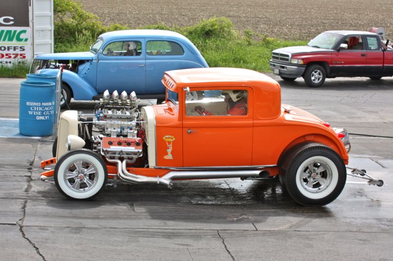

    Here is a pic of your neat coupe from Union Grove in 2013, lining up with a "fierce compe***or.";)

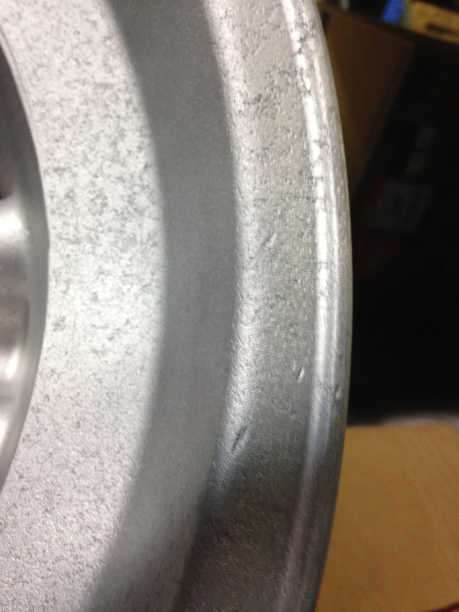

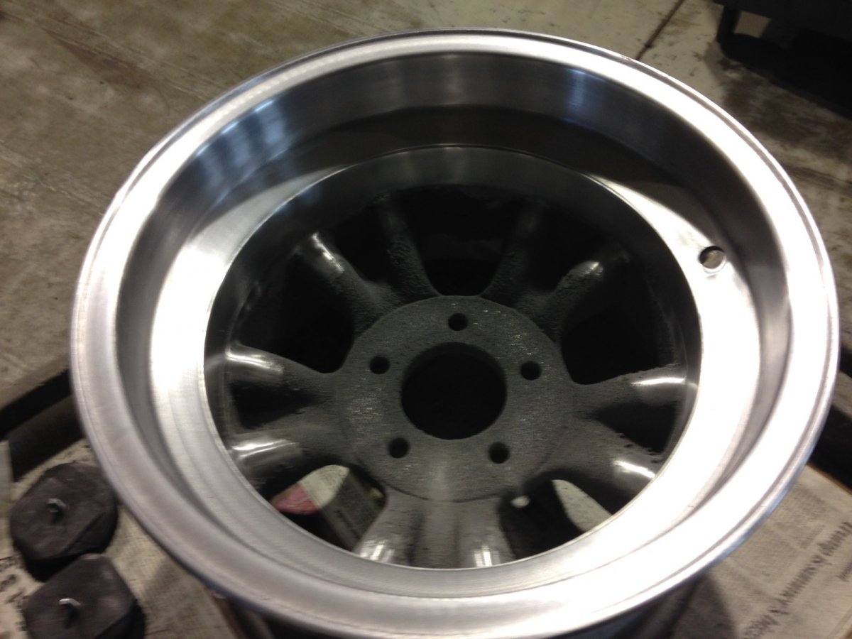

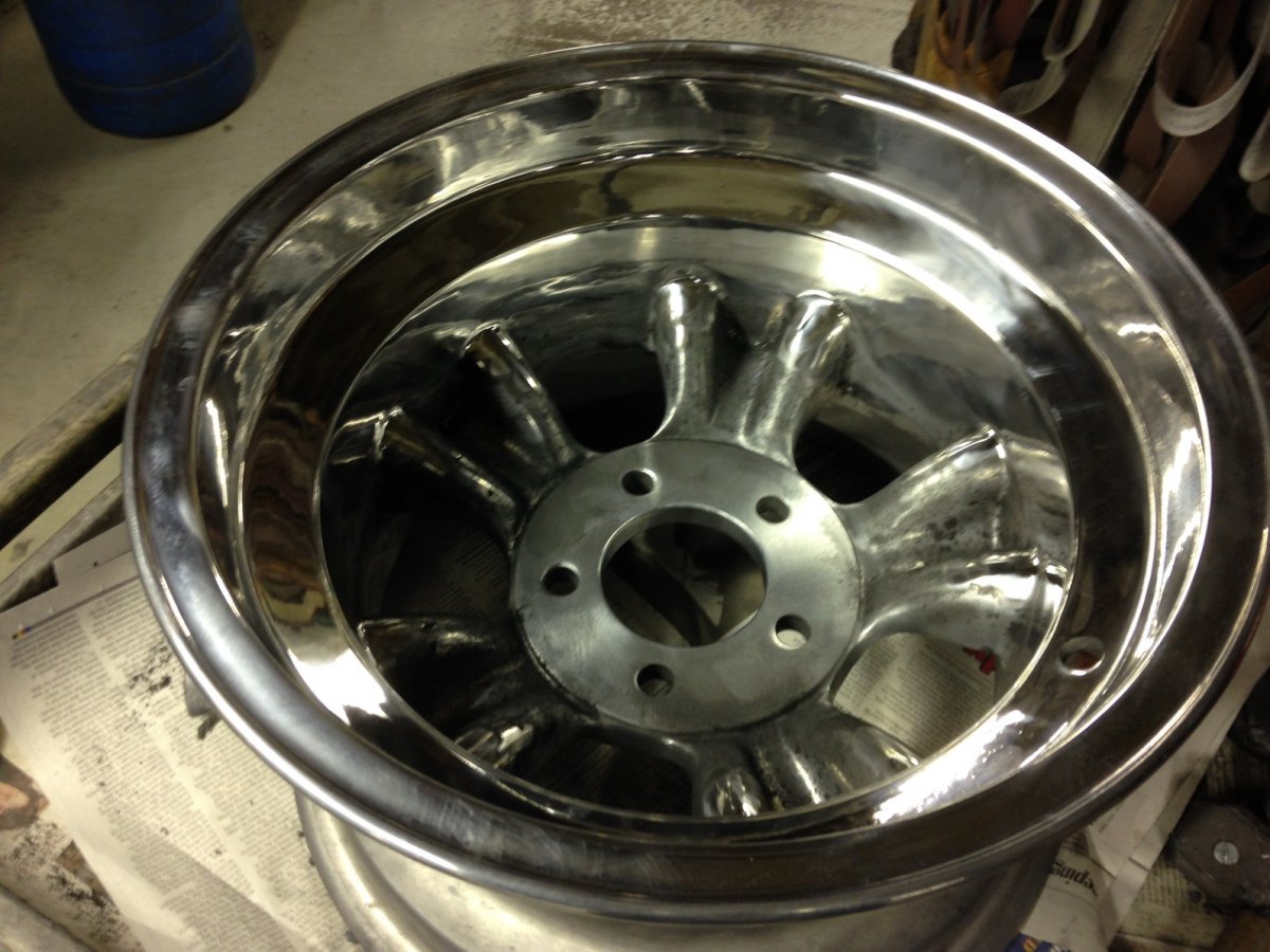

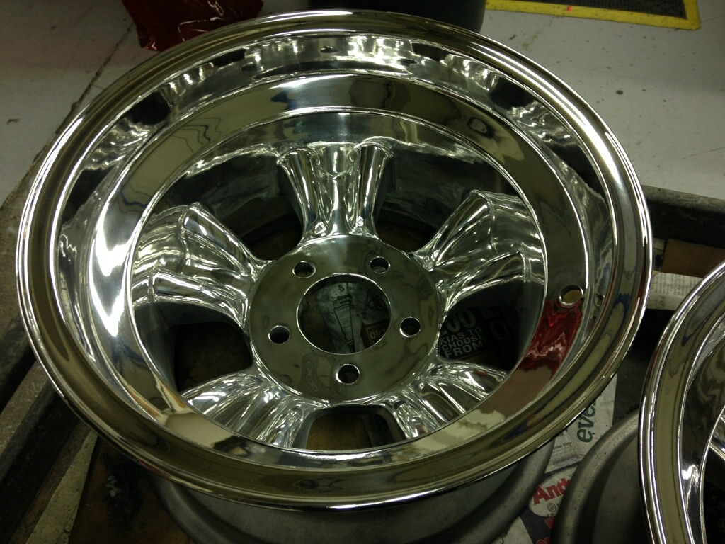

  6. 20150904_145812.jpg I was introducing my polisher this morning. I have not talked to him in two weeks. This afternoon he sent a bunch of pics showing the progress. They still need a little polishing in a few areas but you will get the idea why mike gets the call when i need something done. as purchased
    els likes this.
  7. imagejpeg_0.jpg it amazes me mike was able to sand out all the pits and bring these back to life. i should get the fronts back this week. i will trade rims with mike and get the tires mounted. for being into this rebuild only two months i feel I'm making good progress.

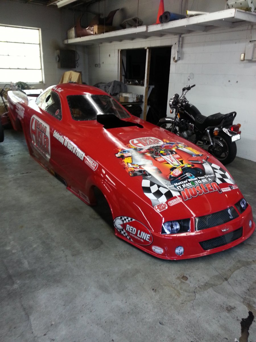

  8. I keep saying its all about the people in this rebuild. i will introduce another friend that has played a big part in this car recently. The lenco came from andy boehl. I have known andy for several years. He lives about five minutes away. I stopped by his shop today to exchange reverse levers. i took a minute to shoot a few pics of his car. If you attended the us nationals at indy this year then you saw andy win alchohol funny car. congrats andy thats hard to do. 20151018_125027.jpg 20151018_125046.jpg

  14. all four of them were diamonds in the rough. i feel like I'm building the car around the engine and wheels. nothing says fuel car like these wheels. i think they will match the new theme of the car perfectly.
    els likes this.

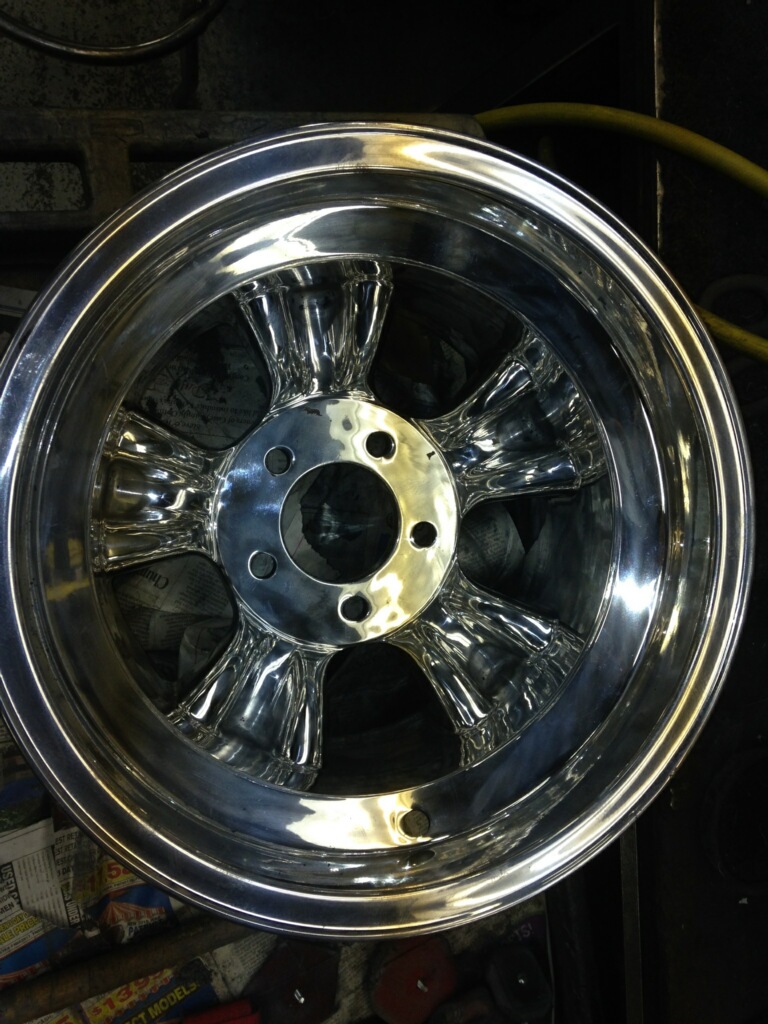

  17. Im picking up the wheels after work. now they are done. Mike sent these pics today.unbelievable imagejpeg_0.jpg
    Frasse1234, camcrusher, els and 6 others like this.
