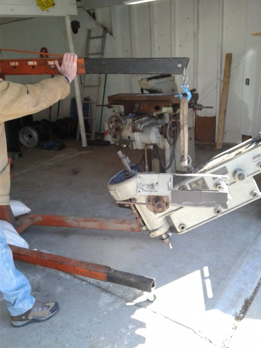

  1. Todays fun included moving my mill from the rental house in town to my current place in the country. The mill is a old gorton made in racine, wi. Its a big heavy old thing but it works good until i can get a bridgeport. We had to take it apart to move it. Luckily no one lost any body parts moving these heavy pieces. 20180225_132034.jpg 20180225_153430.jpg

    I Thought the silo was part of the mill at a glance lol
    Glad the move went well

  4. I i should be able to wrap up this job monday. I need to move the car and enclosed trailer out of the shop first. I can then use the car lift to get the mill off the trailer. I will use pipes under the mill to roll it into place. The hoist will be used to put the motor and spindle back on. It will be worth it in the end.

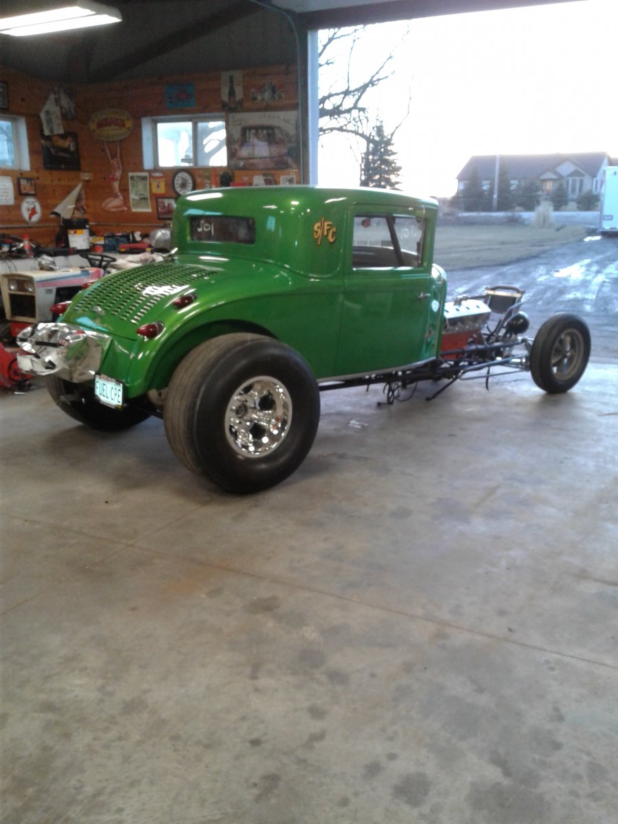

  5. 20180226_172933.jpg View attachment 3820322 20180226_180225.jpg The street bear claws were picked up today. I quickly ran them over to get the tires mounted. Im happy with the look of the street tires. now the fronts can be done. The entire shop needed to be rearranged to get the mill off the trailer and in place. I used the car lift to pick up the mill from the trailer. I then pulled it across the shop using a strap and my truck. We used a engine hoist for the final positioning. Im glad that job is done.

    I didn’t mention when I saw the lip on the bear claws at the polishers for fear of being annoying but I’m not going to leave alone this detail. Nice hub caps on the trailer! You are a loyalist aren’t ya.
    Oh and nothing shines like polished mag as the roller ch***is pic shows.

    The wheels look great on the car. Do you use mothers polish to keep them looking good? I have a lot of stuff for polishing stuff and have thought of polishing mine completely. What does your shop use to mount them, other that soap and water, that will eat the mag? Is your mill 3phase, if it is let me know. I bought a $150 vfd, and Mark had it wired up and rpm matched in about a hour with a beer break. Way easier than setting up amother electric motor for the 3rd leg. I did mine that way the first time, and never again.

  9. tony I mount the wheels dry. the motor is three phase. I use a phase converter box that's matched to the motors hp level. if you and mark plan on any road trips south stop by I will buy lunch and beer to get it wired back up. that alone gives you good reason to come get the dana 60. I use a lot of mothers to keep them looking nice. they are a lot of work but worth it to me.

  11. i got the mill 15 years ago for free. a friend was no longer using it in his machine shop. its a old tracer machine built for the war effort. it still has the government tags on it. the tracer parts have been removed. the machine has been sitting at the old house for the last seven years. we are selling the place so I was forced into moving it. I pick up tooling when I can find it cheap. I don't do anything too complicated so I don't need very much. its nice to have around when you need to make a part to get to the track and its 3am. with a lathe and a mill a lot of stuff can be made. the machines take up a lot of room but they are nice to have around when needed.
