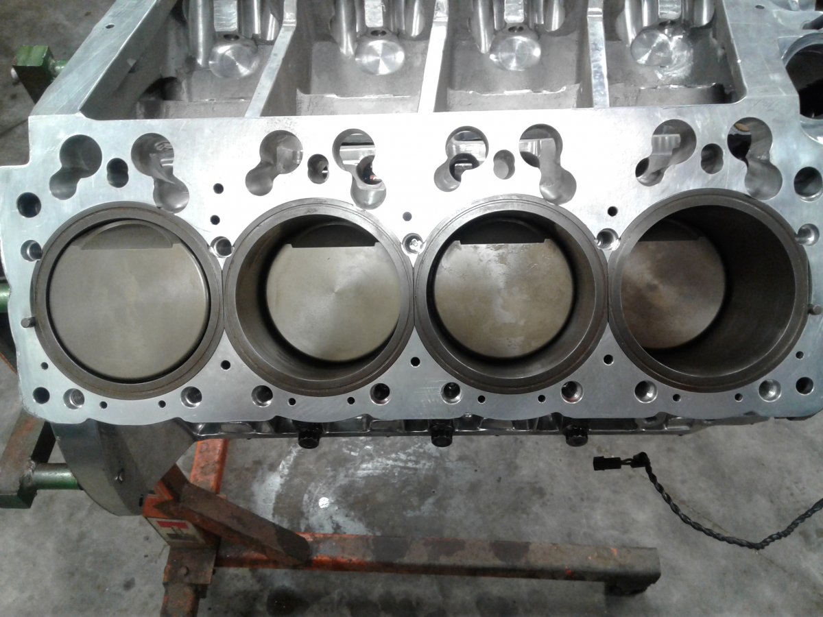

  1. 20180330_193632.jpg 20180330_193733.jpg 20180330_203712.jpg The short block is ready to go in the car. it was a lot of work getting everything to fit just right. Im going to get .100 longer rods next time to move the piston away from the counter weights. I can then use a thicker gasket to drop the compression. This will save alot of time in the future. The engine needs to go in the car so i can check the converter to fly wheel clearance. Im suspecting im going to have to remove material off the back side of the mid plate.
    of course you will .
  3. due to the differences between the 426 style engine and the older 354 the fly wheel moves forward. if i remove material off the back of the mid plate it will move the bruno and converter forward. my estimate is around .250 the rear trans support is a ring that slides over the end of the trans so i won't need to make a new one.

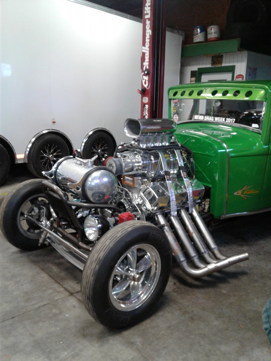

  4. The day was spent mocking up everything. I needed to see if the drive snout was going to be the correct length. I needed to check the belt alignment for the alternator. Most things look like they will work. A few things need some tweaking. All the modifications that were performed over the winter work. This is the first time all the pieces were put on the car at the same time. With the big late model in it looks cool. It looks like it retained the proper proportions. I cant wait to turn it loose. 20180331_173737.jpg 20180331_173642.jpg 20180331_173606.jpg 20180331_173545.jpg

    Wowzers. That motor with all the shiny stuff looks great. Does that “broken belt retainer” thing get extended, or is it the correct length?
    Could you put in a slightly wider fuel tank up front if you needed to? It looks like the frame for the front cooler could be tweaked a little to allow that (?)
    chryslerfan55, loudbang and Stogy like this.
  6. Btc you are correct. The belt guard will need to be extended. The blower is set up on the rear holes for set back right now. Added to this i had to space the upper pulley forward to get the correct alignment with the lower pulley. I have a ***ortment of pulley spacers of various thicknesses to dial it in. Now i know how its going to be i can make longer pieces on the lathe. 20180331_180528.jpg
