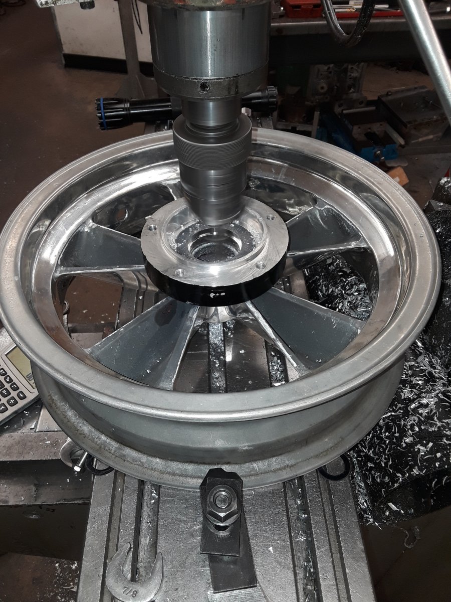

    Im in iowa today machining a five spoke wheel. It has Anglia bearings in it. We are modifying it for Ford's. This was the drivers front from the crash. It was already polished so it's going back on. We couldn't get it done last year. now every thing will match.

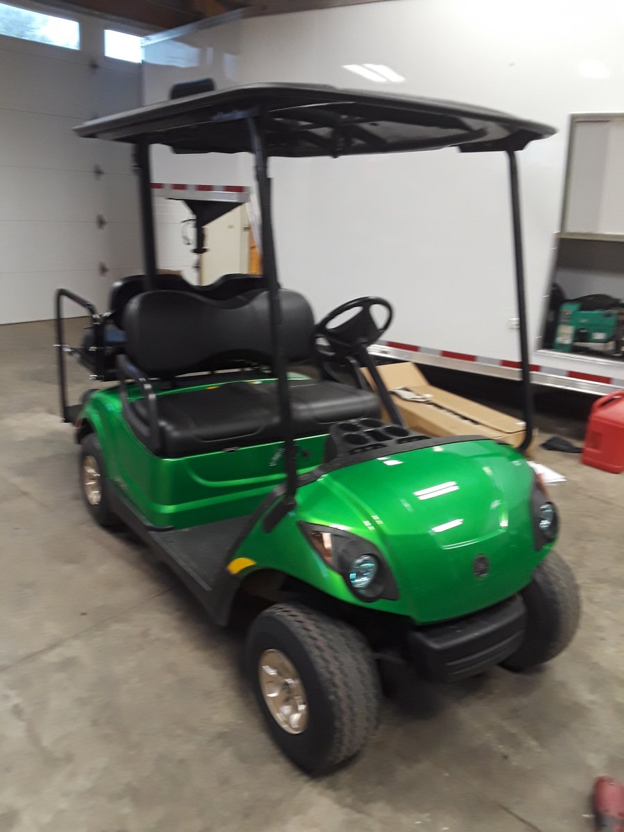

    I also stopped at harris golf cars in Dubuque and bought a yamaha gas cart. Its painted the same color as the coupe. It needs some gold leaf.

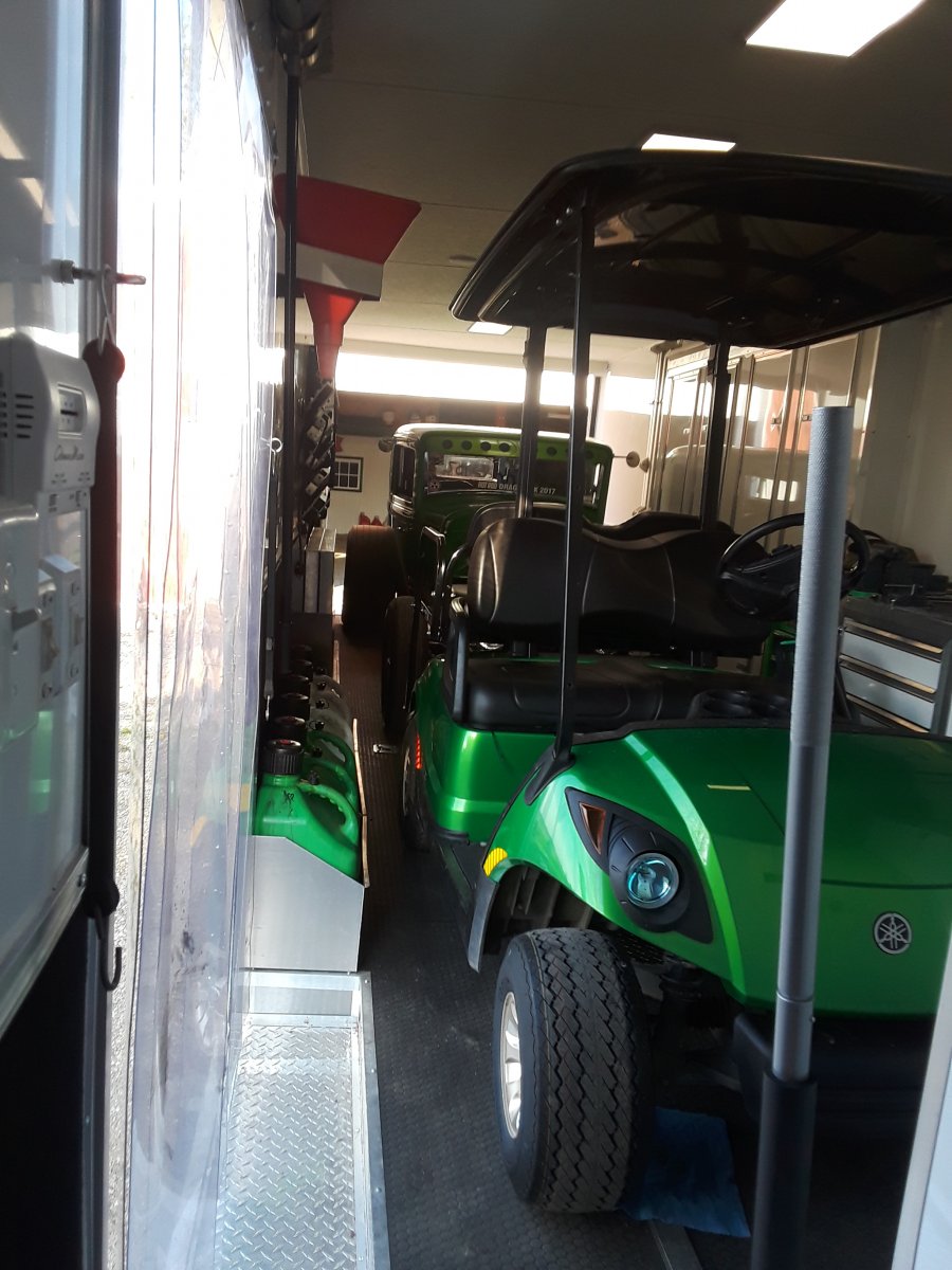

  10. I bought a used Yamaha Drive golf cart on friday. No more pushing the car in the pits or disconnecting the truck from the trailer. When it's on nitro you don't put around the pits. It was a white two seater when i got it. I located a brand new body that's the color of the car. I put that on along with the black seats and roof. The rear seat flips down to haul just about anything I want. I buy and sell a lot of parts so it will be handy at the swap meets. To make it useful at night I put on headlights and taillights. I might letter it in gold leaf with the car number. I had to readjust the governor to my specs. I tried it in the trailer to see how it all fit. I had to modify the trap door that covers the winch. The door stuck up too high and hit the tire. Now I can close it and pull the car in. 20180519_192620.jpg 20180519_192633.jpg 20180520_183423.jpg

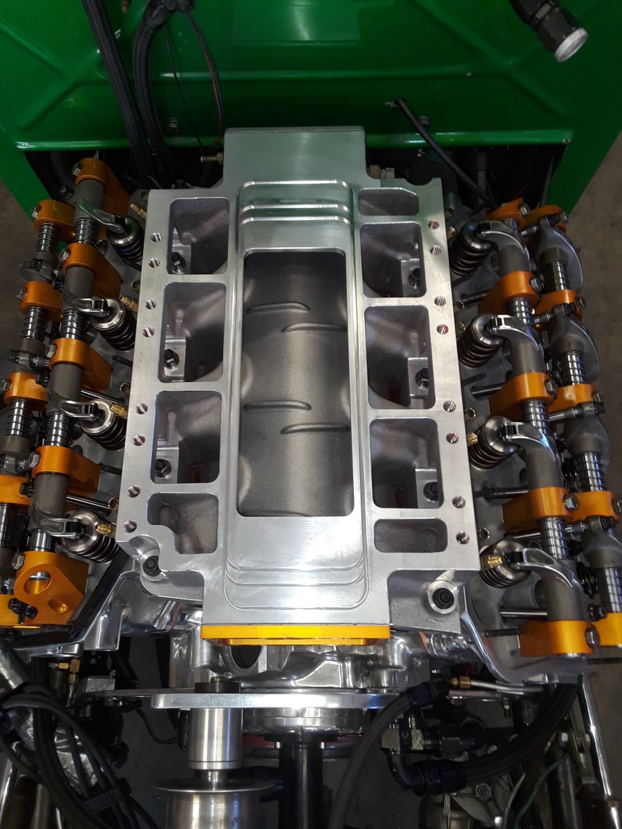

  16. 20180520_163151.jpg 20180520_162955.jpg 20180520_163045.jpg The push rods showed up so it's time to get the heads on. The angle of the valves on a hemi combined with bigger valves and a reduced bore can cause intake valve/ sleeve interference. I have a set of gaskets with a slightly smaller bore than what's required. I put them on and torqued the head. I turned the engine over and felt the valve hit the gasket. With the correct gasket there are no issues. Next I pulled one intake valve and changed the spring to a light checker spring. The head was set in place with no gasket this time. With finger pressure i could feel the valve hit the bore. So this tells me the clearance is too tight. To solve this the cylinder is packed with paper towel. A half round file is used to remove the sleeves edge at 12 o'clock. Not very much needs to be removed. The gasket moves the valve away from the bores edge increasing the clearance. After I'm done filing I vacuum the cylinder to be extra safe to get all the filings. Because I'm using water with a copper gasket a very light smearing of silicone is placed on both sides of the gasket. The new lifters were placed in oil for a few days to lube the axle. No secret info here just normal engine building procedures. Roo and I had a conversation about this topic recently.

  21. Now that the top of the engine is on all 20 fuel lines for the nitro can be connected. When I was in Detroit for the autorama I stopped by kinsler fuel injection. I brought the manifold and blower with me. They can make custom length fuel lines while you wait. It was nice to have it sitting there all set to go on. The fuel tank and line was hooked up after some modificatios. The new 7 gallon tank needed new mounts. It sits just a little bit higher than the old one. The new position makes the feed lines angles much better from the tank to the pump. The line won't be able to restrict the flow due to small kinks. A lot of little things were connected regarding the efi setup.With any luck we should be making noise at bowling green. 20180526_222123.jpg 20180526_222010.jpg View attachment 3912351

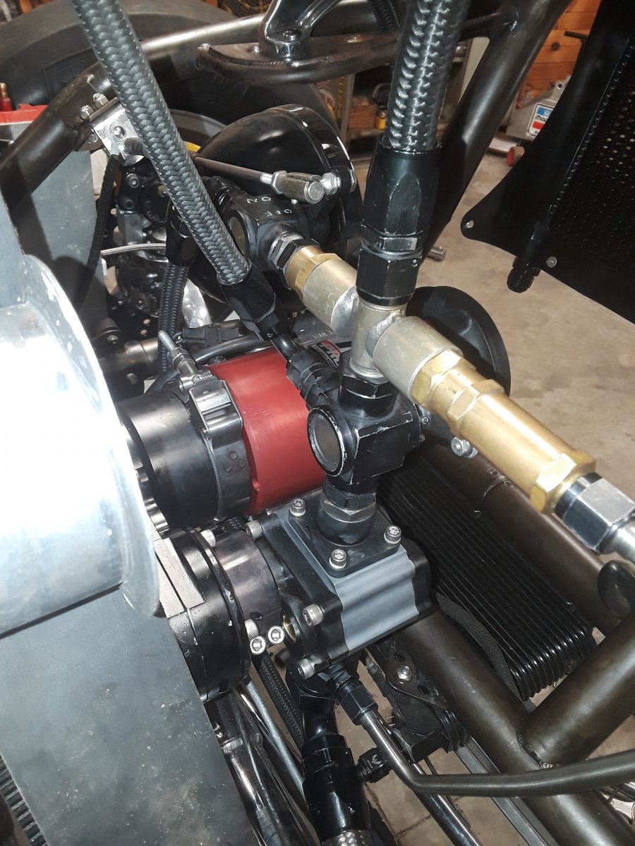

  29. Tonight I will discuss the fuel system. Last year I ran a 12 nozzle system. It idled off four nozzles above the blower. As the rpm went up and fuel pressure exceeded 15 lbs a valve located at the rear of the blower opened sending fuel to the port nozzles. See pic one.
    The valve has a spring and poppet inside. The spring can be shimmed to vary the opening rate. See pic two.
    The barrel valve located at the front of the injector has a spool inside. The spool has a groove cut into it called a ramp. The ramps groove is machined based on engine size; fuel used; or blown. The idle is set using the throttle blades and barrel valve. The barrel valve is set by the leak down percentage using a leak down gauge. Pic 3 shows what the fuel sees at idle. The hole returns fuel to the tank. At 6 o'clock the beginning of the ramp can be seen. Pic 4 is full throttle. A big area is exposed at 6 o'clock. We set our leak around 80 percent on the gauge. When the car starts up fine adjustments can be made by turning the hex shaft. The pipes should look mostly dry with a little moisture on the ends. Too much fuel pollutes the oil and the engine does not build heat. There is also the chance of dropping a cylinder. Too little fuel causes a stumble on take off and the engine builds too much heat while staging. Getting the correct balance is key.
