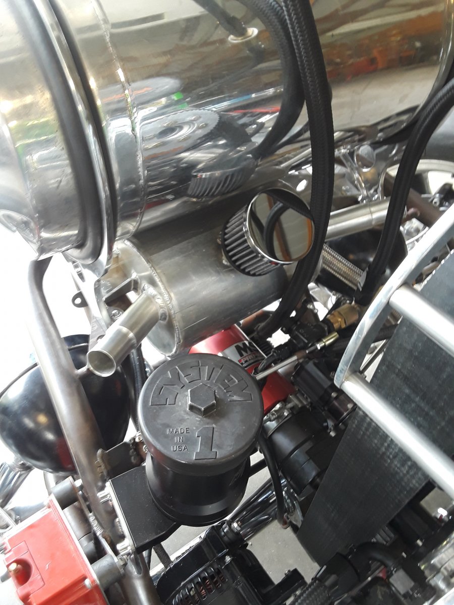

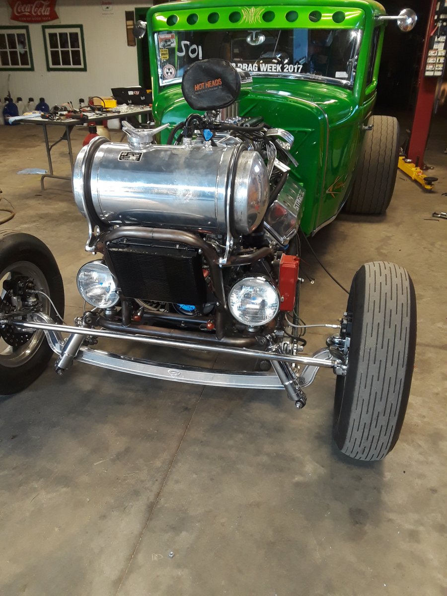

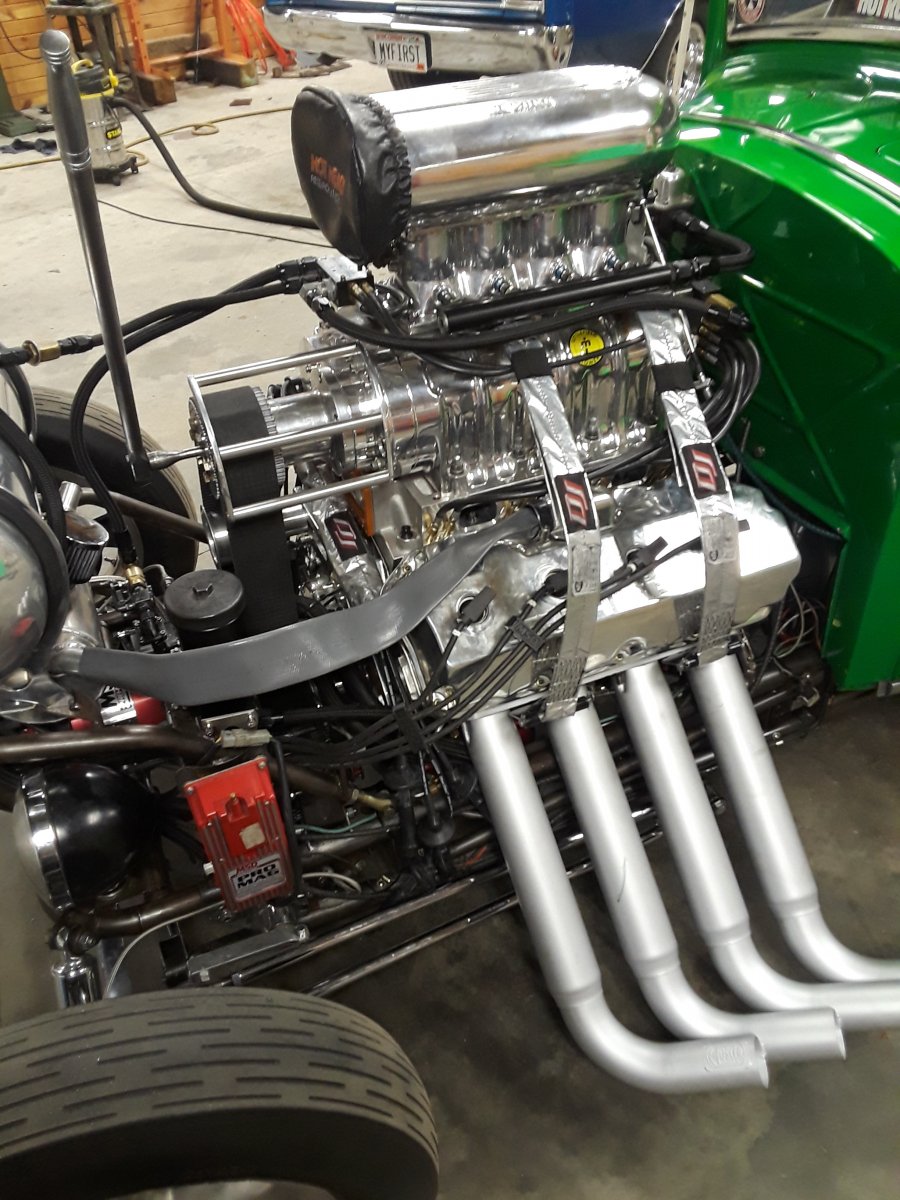

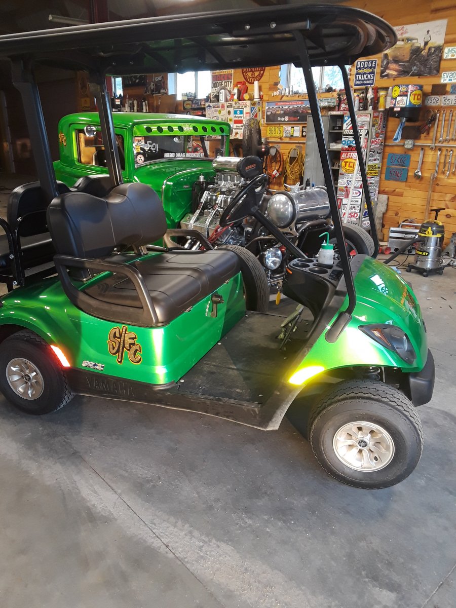

  8. Here's some of the details that I needed to get done. The only big things that remain are the water tube mods and the alternator brackets welded to the ch***is. The puke tanks also need to be made. The two chute mounts were welded on. The system one oil filter was mounted. It was mounted with the cap facing up. That way when it's serviced oil isn't pouring all over. The kill switch was moved closer to the steering wheel. It was placed close to the fuel shut offs. With one push of my hand I will be able to turn off the fuel and ignition. After last summer's mess this was high on the priority list. The steering shaft needed to be moved. To make it work and clear the oil pump a double u joint needed to be added. The oil cooler is larger this year by three inches. I'm still able to get my hand on the mag to set the timing. The golf cart was sent to John shepards for a little bling. He laid down some real gold leaf to match the car along with some pin striping. I think it's just enough to set it off. Another weekend of work should get me real close to firing it up and driving it. 20180601_195159.jpg 20180601_195216.jpg 20180601_195234.jpg 20180601_195259.jpg 20180601_195325.jpg 20180601_195623.jpg 20180601_195639.jpg

  22. 20180608_094935.jpg I picked up the car this morning. The puke tank is done. It's 1.04 gallons just over the Nhra minimum.it. has a vent and a drain. I'm not thrilled with the look of the Nhra approved grey hose. I might find another style. The alternator is mounted so we can start street driving it. The water tube was shortened about 3 feet. A an fitting was welded to the end. A y-block with fittings was made to connect it all. The block is mounted to the frame. A second frame clamp was added for support. To clear a water fitting .050 was removed from the idler pulleys diameter on the inside belt guide. All i need to do is mount the oil pump and make a pair of oil lines. I will add water to the radiator and fire it up. Bg here we come. I cant wait to hear the car on a big nitro load. 20180608_094712.jpg 20180608_094726.jpg 20180608_094742.jpg 20180608_094801.jpg 20180608_094831.jpg View attachment 3926139

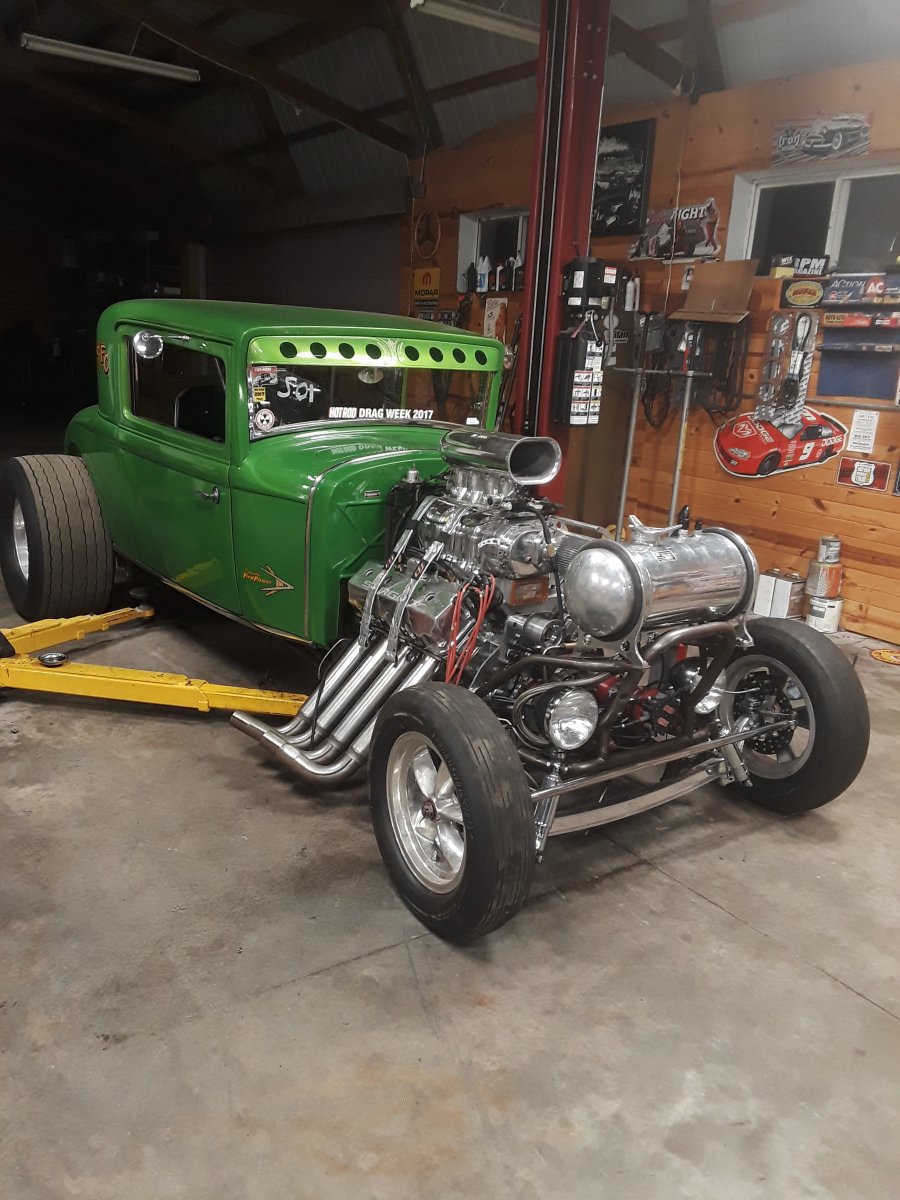

  28. I'm a dirty mess. The car is a dirty mess. The shop is mess. That's ok because the car is ready to go. It's been pre lubed. It's full of water. It timed. It lashed. It's set. I can clean the car when I get there and I can clean the shop when I get back home. Anyone that's going to bowling green stop by to say hey. 20180611_224116.jpg 20180611_224105.jpg
