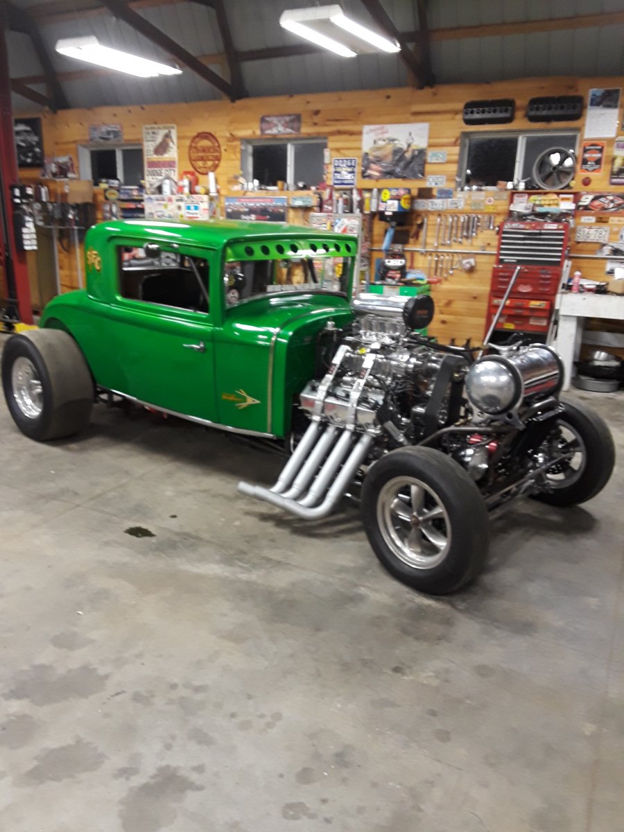

    Is the overflow grey hose missing a clamp on the catch can?
    Good luck, have a great time.

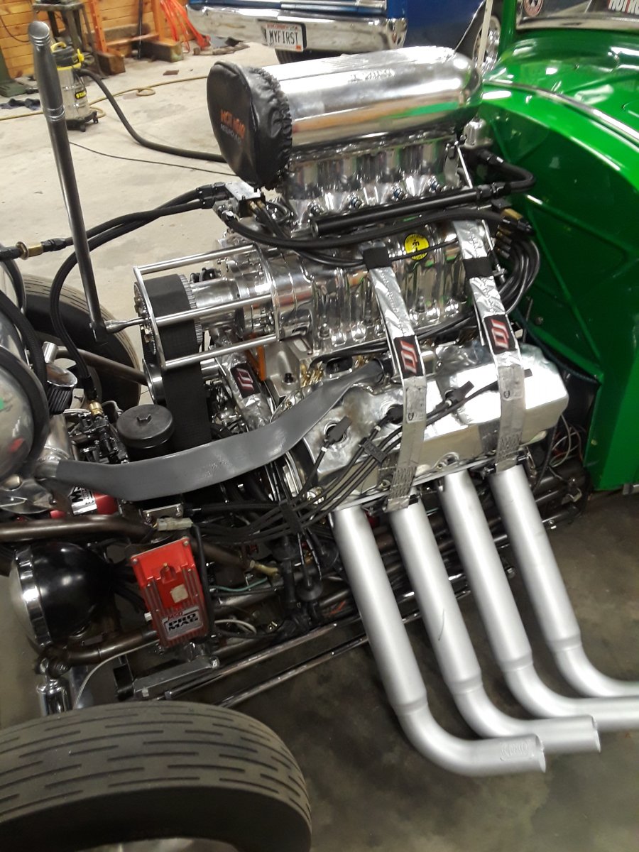

  3. It is. I will take care of that and a few other things at the track. Roger is showing up Friday so it will fire up on that day.

  26. We fired the car today on alcohol. We did it off the bottle. That way if anything goes wrong you just stop squirting fuel into the engine and it shut off. Simple. We verified the timing and oil pressure. The new missile pump was at 125lbs at idle. That may sound like alot but the dragster runs at 200. When we put it on the fuel pump it wouldn't pump fuel. This created a big mess. The new pump can't be rotated like the old one. We had to swap mag and pump positions do to the offset of the pump. They doth turn counter clockwise. This opened a big can of worms. The high low bracket needed to be removed. It was in the way. It will be repositioned next week. The p***enger side oil cooler line is in the way of the mag cap screws. The lower mag support needs to be moved over now. We worked through it all in the heat. Its ready for nitro tomorrow.
