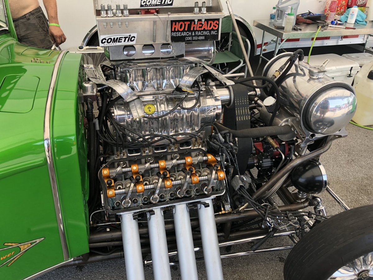

  1. Lots of guys that follow this thread are stopping by. It's nice to meet them all in person. A guy with me took some video. We don't have WiFi here so it's taking a long time to transfer to u tube. The car sounds good. We followed these steps in order.
    Verify timing.
    Set air valve and barrel valve.
    Setting the high low valve.
    Made changes to the main pill.
    The water is in the block and we ran the pump. It was started several times as adjustments were made. Steve from missle was helping. He has alot of nitro experience. We came up with our tune up plan with exact changes we wanted to make each time the car was started. We have it set safe but close to were it should be. Not only is it running better it's consuming alot less fuel. After it picked up some temperature the valve covers were pulled. The heads were retorqued. The lash reset. The filter checked.
    The lash is set cold at .016 hot .026 that's how much the heads and block grow. The blower belt is also reset do to this growth.

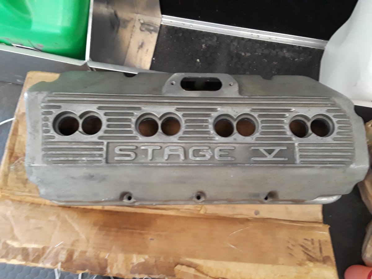

  2. 20180616_100045.jpg I found these stage five dual plug magnesium covers in the swap meet. They are new in the box. You can see were this is headed if you have been following this thread.

    Wow those look so much more period to your car than the current new ones, some times the stars align, this is your year man!

    Brian, you are for sure sitting at the "kool kids" table now, those rocker covers are neat.
    Hoping you're not going to have them polished but something tells me you will.

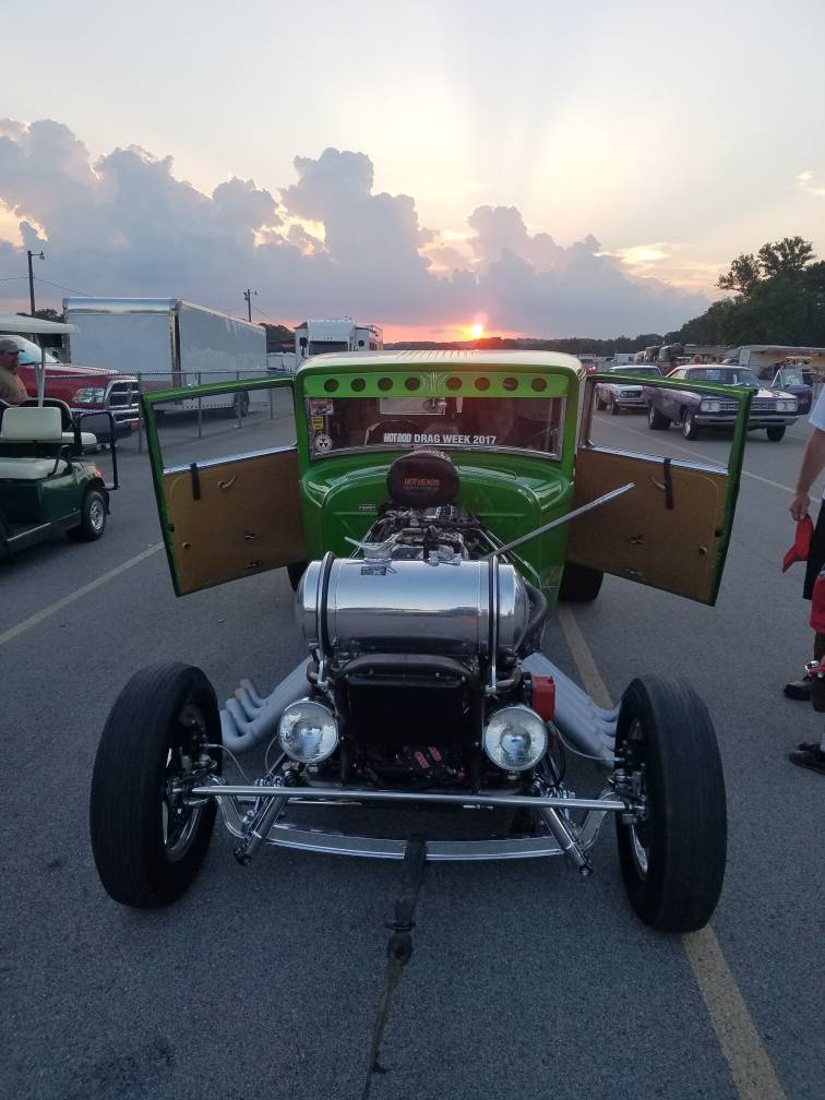

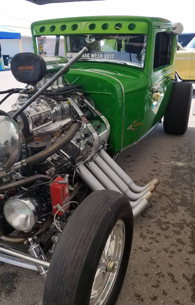

    3EEDB421-8CDD-4E7C-ACB2-68005E5F3681.jpeg 5A85AC87-7D5E-4162-9D27-3502CE4AD0B0.jpeg DC7E8353-7DC4-41C1-AF90-497408A96A47.jpeg D791F8E3-DF38-4A5C-A946-410A249EE982.jpeg 87EFF288-9A3B-4CAB-9FBA-501F424D923E.jpeg 28D45FC5-8C10-4036-97DF-74A5E2CDE12F.jpeg
    We had fun as always

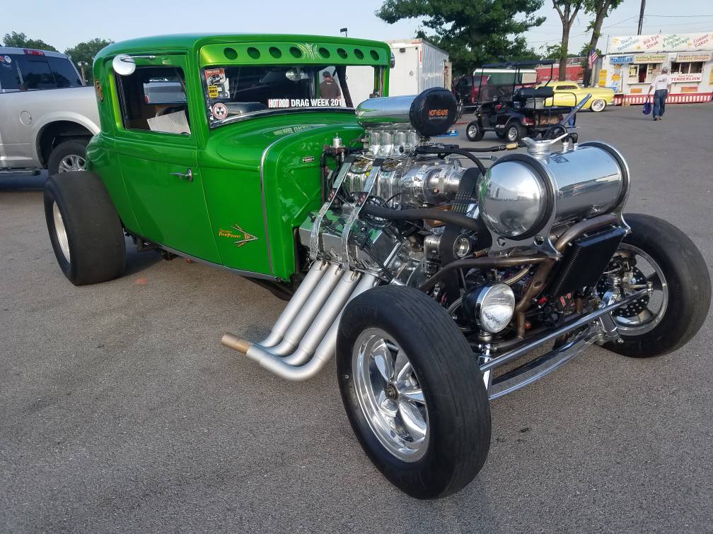

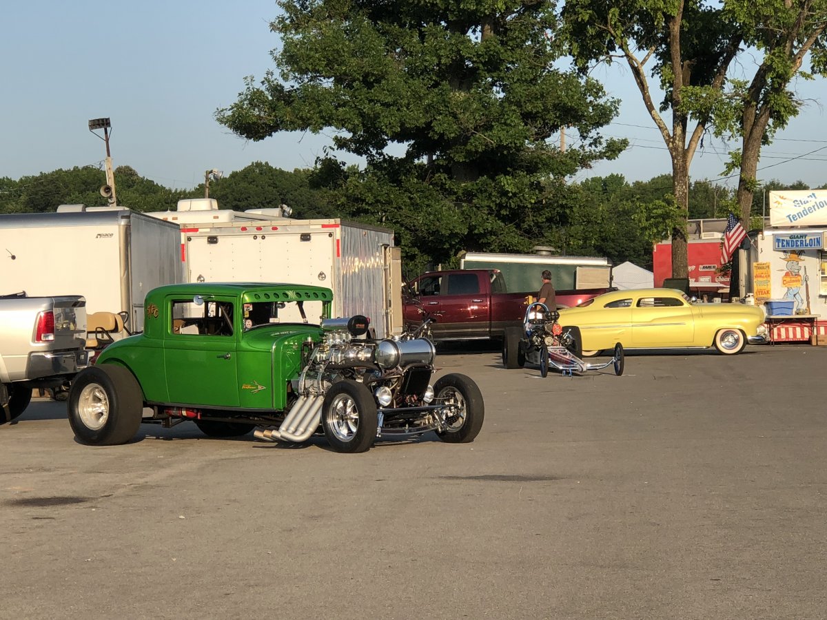

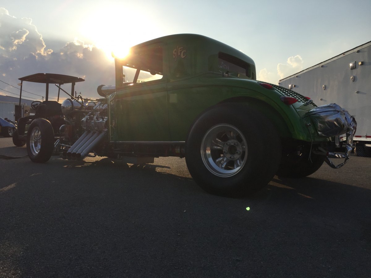

    Not every day I get to sit next to a street fuel coupe! We had a fun weekend hanging out. Thanks for extending your pit pad to us. Arlo was right at home with all of your big and little kid toys. I especially loved hearing it on 80%. 20180616_195228.jpeg 20180616_182322.jpeg 20180616_182523.jpeg 20180616_182306.jpeg 20180616_164904.jpeg 20180616_112708.jpeg 20180615_145138.jpeg 20180618_004039.jpeg
