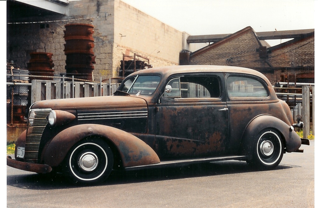

    Here's one of the old build pics, prior to the grill being painted.
    It looks pretty clean to me. I have some other pics after it was done, when it was all purple, with the grill chrome. Later, the top got painted silver, and the grill purple.
    Looks like it had bumper guards back then, too.

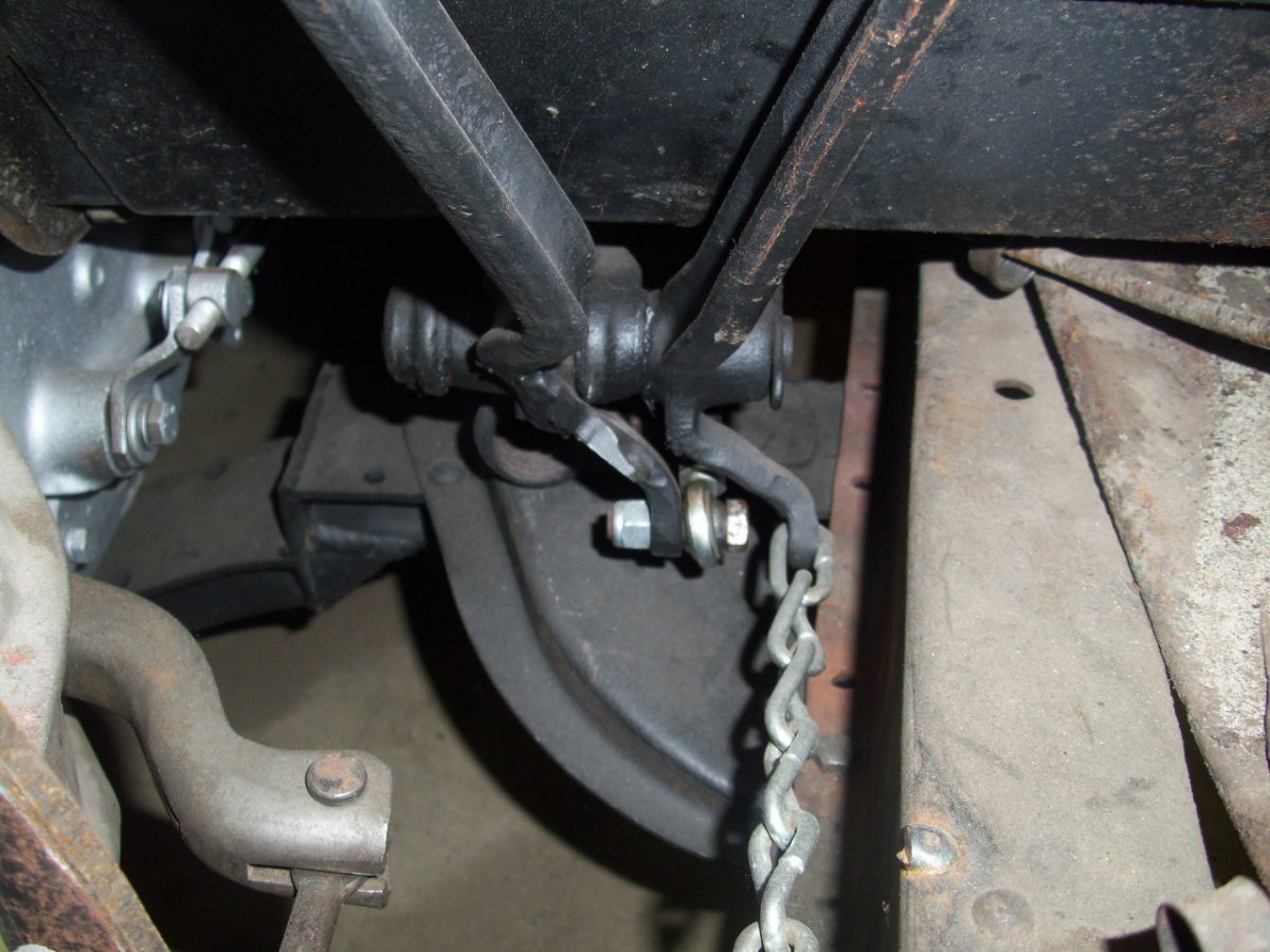

    One small victory today: I fixed the wipers. They have a Newport motor, and would sort of work, intermittently. Seller thought maybe it needed a new motor (people always blame the expensive and complicated parts first). Looking under the dash, I could see the drivers side transmission tower was wonky, the linkage was binding on it, not moving it. It looked like the tower might be damaged, the bottom gear was wobbling around, and the chain wasn't moving.
    Today I decided to have a closer look. Maybe it can be fixed. If not, at least I'd know what to start looking for.
    Getting out was a bit of a challenge, I'm not sure my arm is supposed to bend that way. But I got the mounting bolt out, and the shaft off the motor crank, and pulled the tower free from the top side.
    Cheapest fix ever: the nut holding the lower wheel was loose. Tightened it up, hit it with a little spray oil, and it seems to be fine. Reinstalled, and put the shaft back on, and now I have working wipers.
    I hope not to need them, at least not often. I don't know how effective they'll be in actual rain, but at least now they work.
