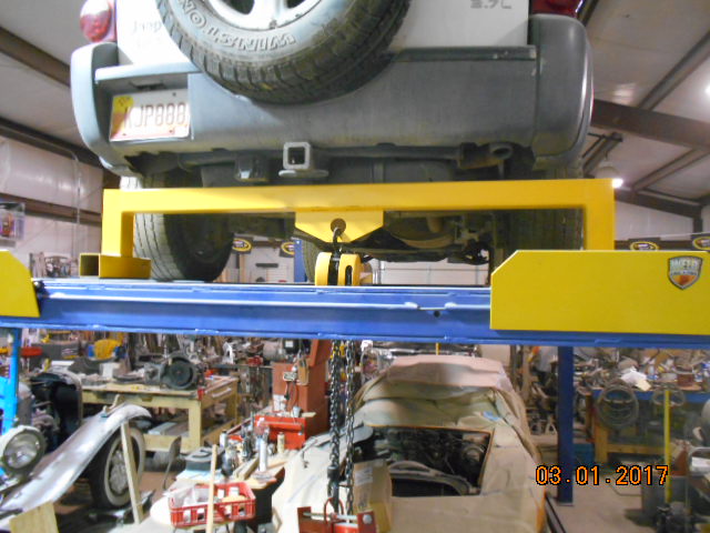

  9. I actually bought the 4 post as a means to have more storage space, plus access trans repairs, etc. the RJ-45 jack just makes it handier for front end work, brakes, etc. I've got an OT corvette in here, and those things are a pain to get the engine out of with a cherry picker so I built a sort of gantry to go on the hoist, using a 1 ton chain fall, made it a breeze. The hoist is a 9K model. DSCN2034.JPG
