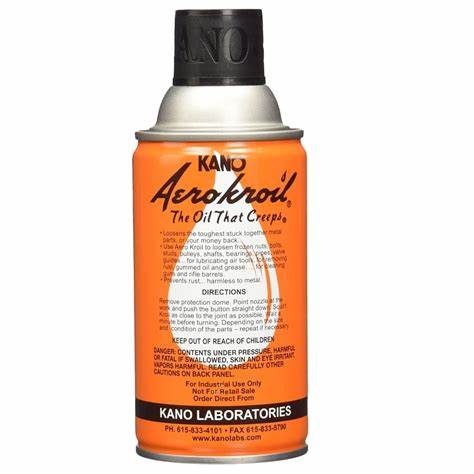

    OIP (3).jpg Next step is to buy a can of Kroil and soak the threads really well before trying to unscrew the covers. Bob [​IMG]

    Should be interesting to see how heating both sides of something will somehow loosen things.
