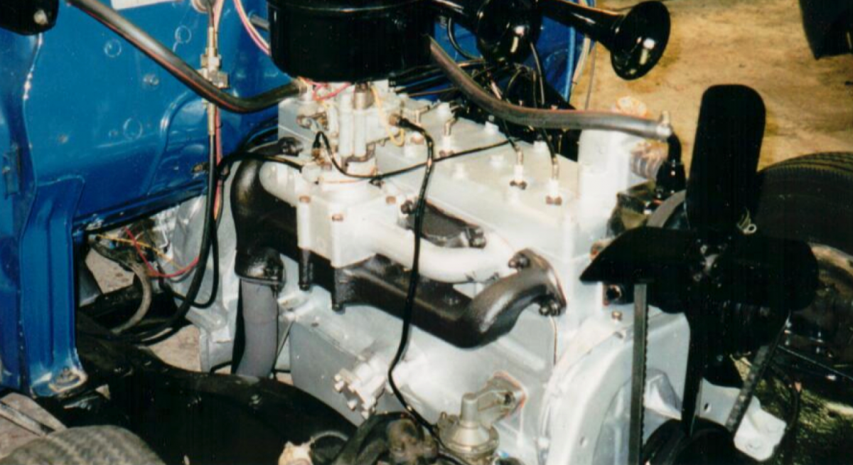

    In between your getting high-centered and today, I redid the motor in my '49. Here's a photo:
    BTW, did you ever sort out your rear main bearing cap dilemma?

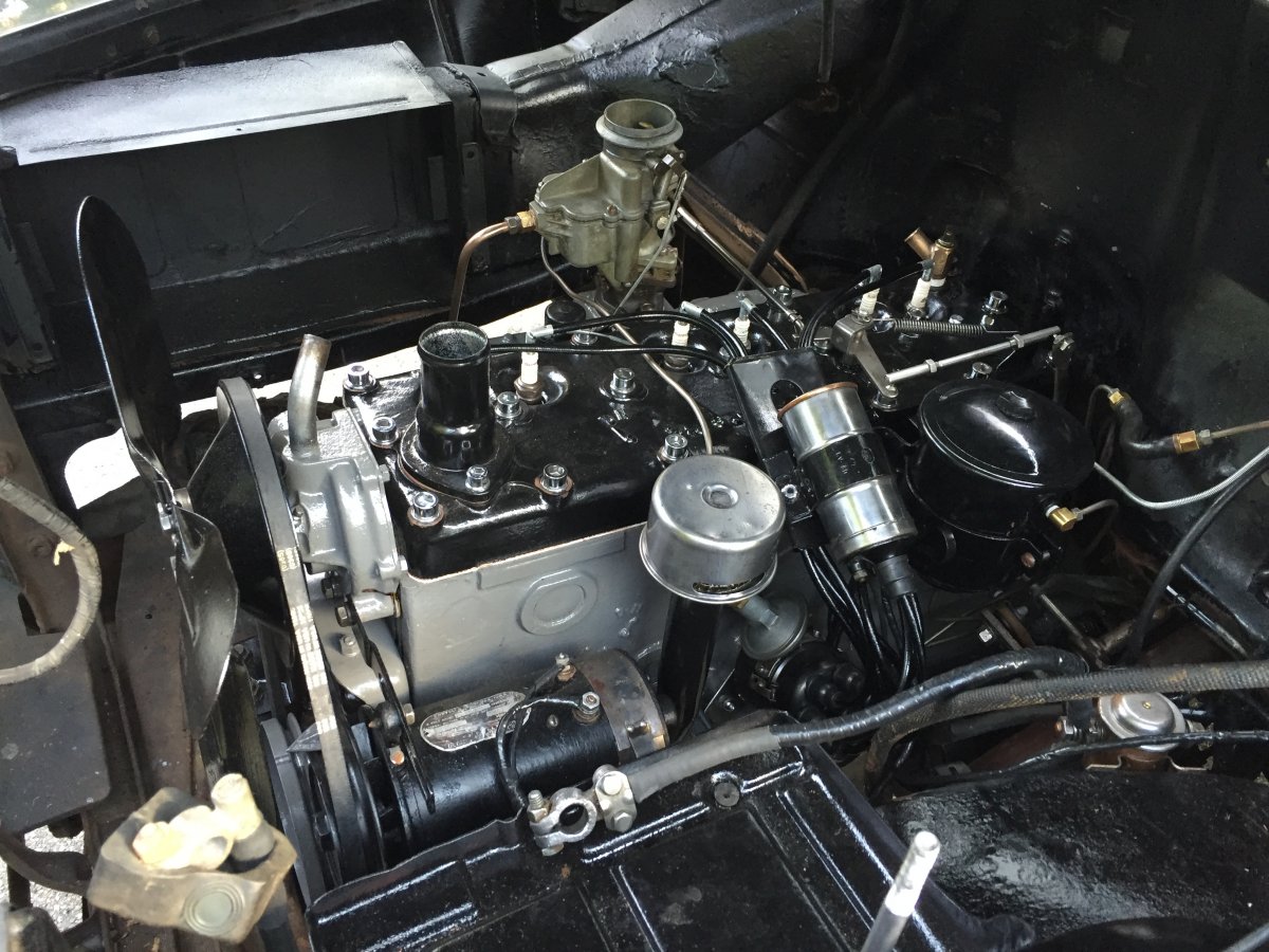

    I'm restoring a 42 Dodge D22 Custom at Brazil and need a little help with engine color. Searching on web I found some engines with a grey color and realize that is the right color. Today I found this rebuild projeto and saw that the color =StreamlineDeco= painted is near of what I have (below picture). Whats the right factory color? Or they have a different color according with the year?
    Thanks and sorry for my poor english.

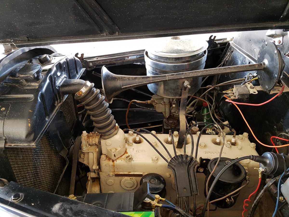

    Hi Gabriel, don't worry about your english, you are doing fine. To the best of my knowledge the factory painted the engines silver like in the attached picture. What I found doing research was,
    "Aluminum Silver - Mopar P4529148.
    • Most 1940s to early 1960 engines, including most of the early Hemis and 1950s Poly engines were painted this color. Silver was also used on all the flathead 6's except that the performance option in the 30's included a high compression head that was painted bright red."
    • Hope that helps.

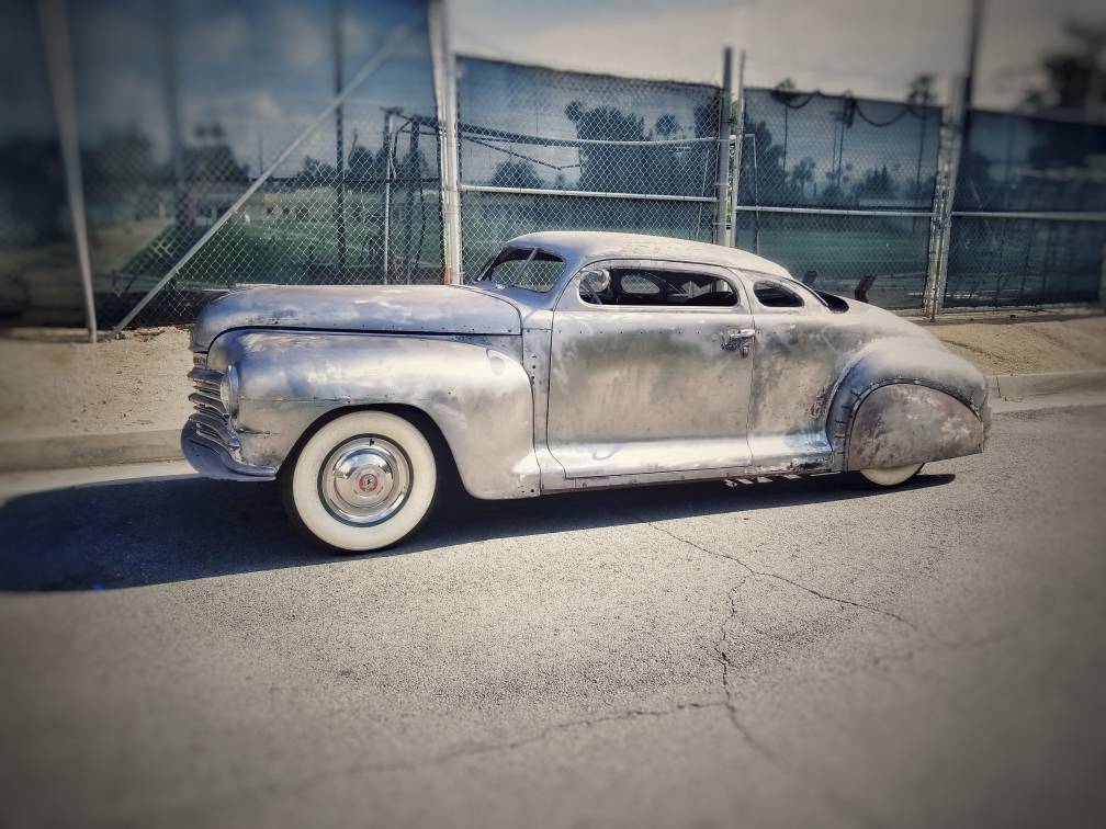

  26. =StreamlineDeco=
    Joined: Oct 21, 2006
    Posts: 181
    =StreamlineDeco=
    Hi everyone, haven't posted here in ages but wanted to let you know I still have the flathead. The project was put on hold forna few years and I have gone through a few projects in the meanwhile. Sold some bought some and got myself another Plymouth. This one will get the transplant as I'm still working on the flathead motor. Currently relocating and will begin ***embly as soon as the shop is in order. These days I don't have as much free time as I used to. Since then I got married and we have a 2 year old - future kustomizer :) so my posting time is limited. If anyone is still interested, I have my project on social media. My instagram handle is: streamlinedeco46. Hope to see everyone there. Here is a shot of the new project: '46 Plymouth Special Deluxe Coupé.
    Sent from my SM-G955U using The H.A.M.B. mobile app

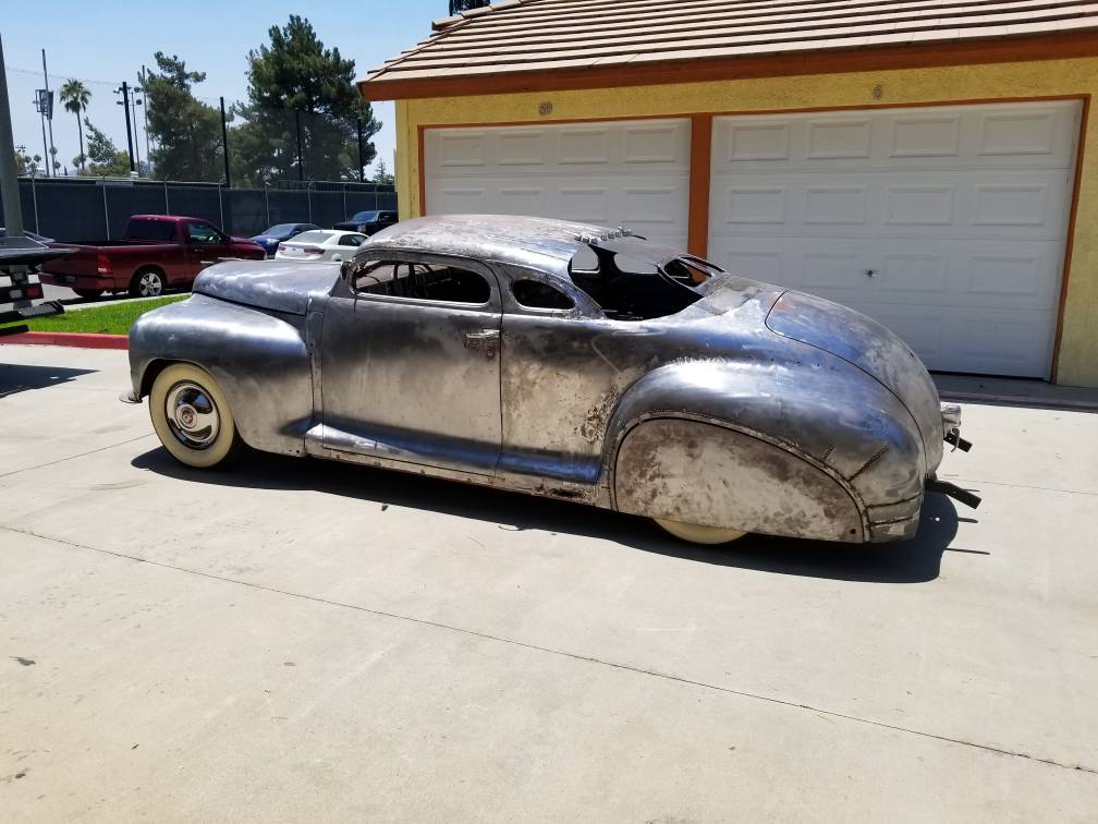

  27. =StreamlineDeco=
    Posts: 181
    =StreamlineDeco=
