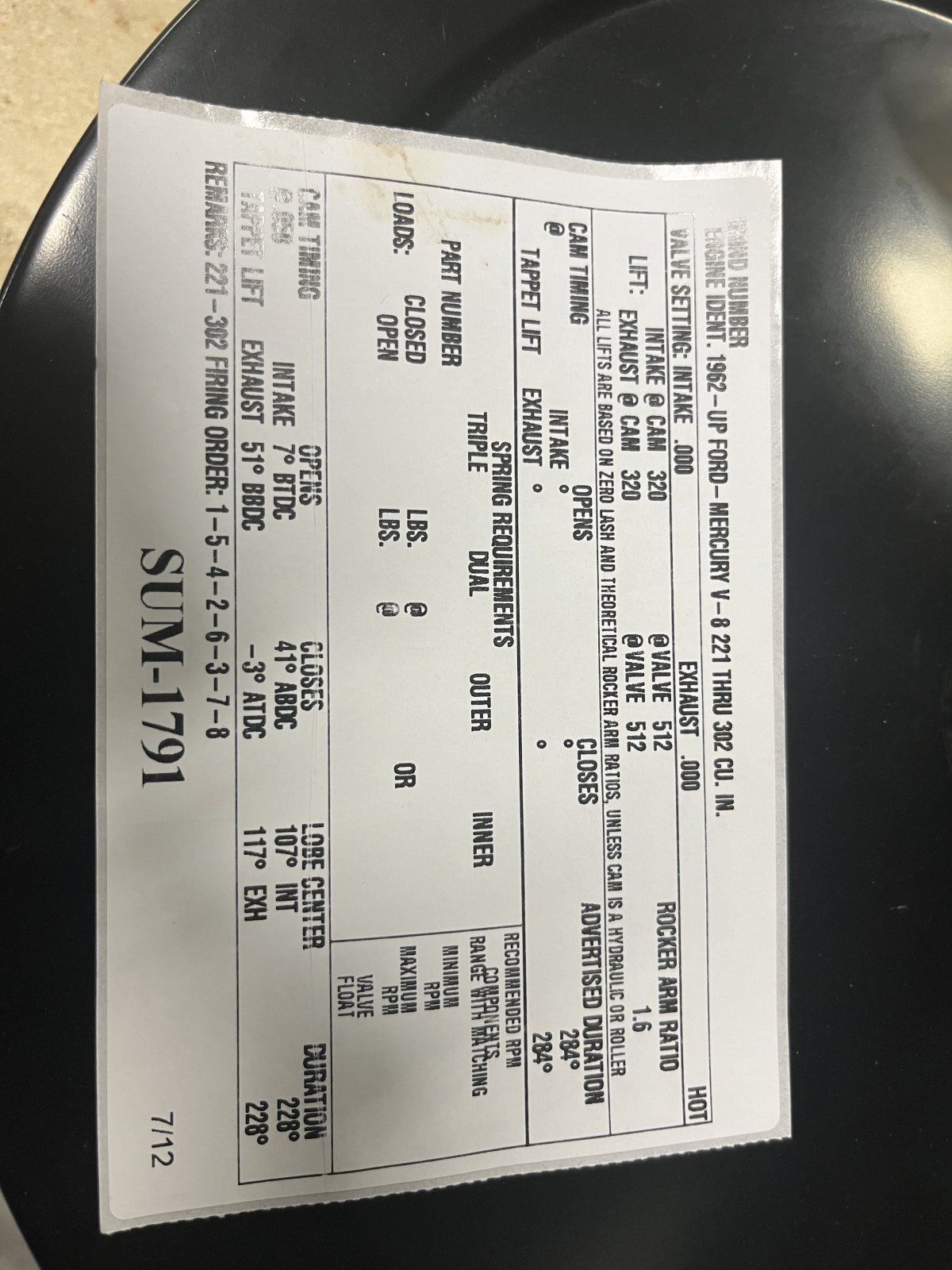

    Even a stock ignition curve can make a modded engine be a little soggy off idle, especially with a performance camshaft. What camshaft is in it, exactly?

  9. Brandon141
    Joined: Aug 25, 2021
    Posts: 67
    Brandon141

  12. RmK57
    Joined: Dec 31, 2008
    Posts: 3,227
    RmK57
    Camshaft Manufacturers Description:
    Rough idle, wide midrange power band. Requires 2,500+ stall, 9.5:1 and higher compression, and gearing. Bracket race cam.
    Do you have all these requirements? Like I said converter, gear all come into play here.
  13. Kevin Ardinger
    Joined: Aug 31, 2019
    Posts: 1,050
    Kevin Ardinger
    That cam card is not legible on my end anyway

  16. Kevin Ardinger
    Posts: 1,050
    Kevin Ardinger
    Do you have it wired per that camshaft? Or did you wire it like an 89 F150 if I’m not mistaken they are different firing orders. 89 F150 is 18436572, that camshaft is 15426378.

    It wouldn’t even start with a mis-matched firing order.

    That’s a pretty big cam for a little 302 I ran a cam with 10 degrees less at .050 in SBC 305 and it was soft on the bottom end. Does the engine respond at 2500 - 3000 rpm does it pull good once it’s wound up? Like was mentioned above Gears and Higher stall converter, was the cam set straight up?
