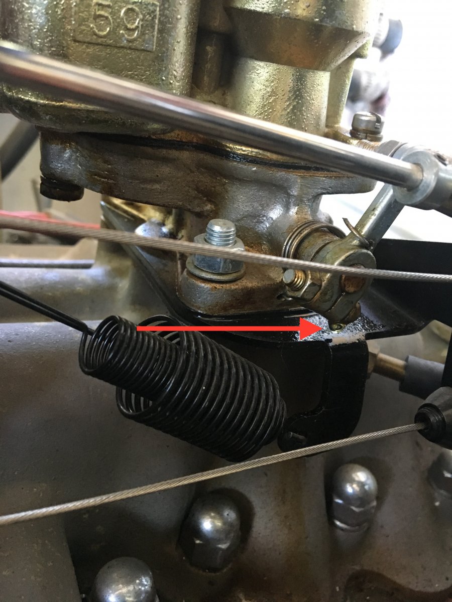

    Sorry to resurrect a long-dead thread, but I want to be true to my word and the HAMB and update this post since I have some new information.
    Can't believe it's been almost a year, but I think I finally discovered the source of this carburetor leak. I don't know if it's gotten worse or I was just too dense to figure out where the leak was coming from a year ago, but the other day as I was redoing some wiring terminals under the hood, I noticed that when the key was turned to the on position so that the fuel pump is running but the engine is not, gas was badly leaking from what I believe is the throttle body on the secondary carb.
    You can see the drop at the end of the arrow in the attached picture, and I made a short video that you can see here if you are so inclined. So, now that I know that, what steps do I need to take to fix it? Given the location, seems pretty likely I am going to need to remove and perhaps rebuild? Just a reminder: I am still pretty dang new to carbs and old cars in general so I have a lot to learn--don't take it for granted that I already anything! Appreciate anything constructive or helpful that anyone has to offer and anyone who took the time to read--thanks!
    kidcampbell71 likes this.
  27. Petejoe
    Joined: Nov 27, 2002
    Posts: 12,617
    Petejoe
    from Zoar, Ohio
    Check your pump pressure.
    Should be no more than 2-1/2 lbs.
    Desoto291Hemi likes this.
  28. blakejr57
    Joined: Mar 7, 2017
    Posts: 40
    blakejr57
    from Austin, TX
    Pressure holds steady right at 3....And, strangely the primary doesn't seem to leak
  29. Petejoe
    Posts: 12,617
    Petejoe
    from Zoar, Ohio
    The Holleys are designed to withstand 2-1/2.
    I wouldn’t look elsewhere until I got to that number.
    You are leaking at the throttle shaft hole. That’s a normal wear area.
    The fix (if needed) would be to ream out the hole and install a next size shaft to replace it. These can be obtained.
    But........
    Get the pressure corrected beforehand by installing a regulator.
    It just may not leak at the correct pressure.
