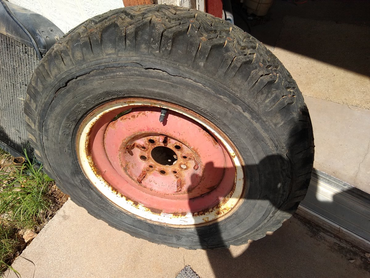

    This one was still holding air....how old is it?

    Seen a few like that in 35 years!
    Retreaders are required by theDOT to imprint a label with their ID code (R***) and the Julian date (WKYR i.e, 3519). Not saying it's on that old dog, but if it is, it should be branded or molded in the sidewall close to the new tire mfg DOT number. That old, the date would be three digits. On mold caps it's usually made with a metal label, embossed in reverse, and screwed to the mold.

    My guess is the tire is about 40-50 years old.
