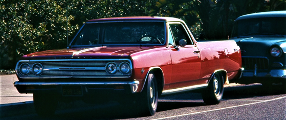

    By the time 1965 rolled around, the industry had changed technology and the some of the popular tires were actually recaps. I wanted wide tires for my 1965 El Camino and the only place with good ones was Inglewood Tire Co. in Inglewood, CA. The local tire company stores had recap tires that looked new, but they did not have wide tires. Inglewood had come out with their fancy Redline wide tires called “Posatraction” tires.
    I purchased a set, but not before the dealer said to bring in my old/new Firestone tires. When asked why, the answer was they were going to use my fairly new carc***es for recap, base tires. The application of recapping tires was so much better than the old days, so the new Inglewood Posatraction Red Line Tires fit the bill for our 65 El Camino.
    Jnaki
    No more getting stuck in soft sand near the beach or the deep desert dirt in the Mojave area. It just rolled over the soft stuff. On the streets, the wide tires made the El Camino handle like a sports car. That was a plus.
    But, when it rained or there was a slight mist, several things happened. In the mist, the brakes had to be gingerly tapped as a panic pedal would make the wide tires just float around and skid. The rainy weather? The term hydroplaning was made for this wide tire. I had to be extra cautious in driving the El Camino in the rain. The car just lifted on the surface of the water on the road and floated down to street. So, I had to immediately let off the gas and normal control came back.
    My wife did not like driving the El Camino in the rain, but, learned how to handle the slippery tires for safe driving. I got stuck driving her 1962 Corvair in the rain. No slipping and sliding in the rain for that Corvair. It took corners quite well and handled itself in those conditions. It was the "pouring water" coming in the lower vents that would flood the interior in deep puddles. That is another sad GM story and kind of a cool car.

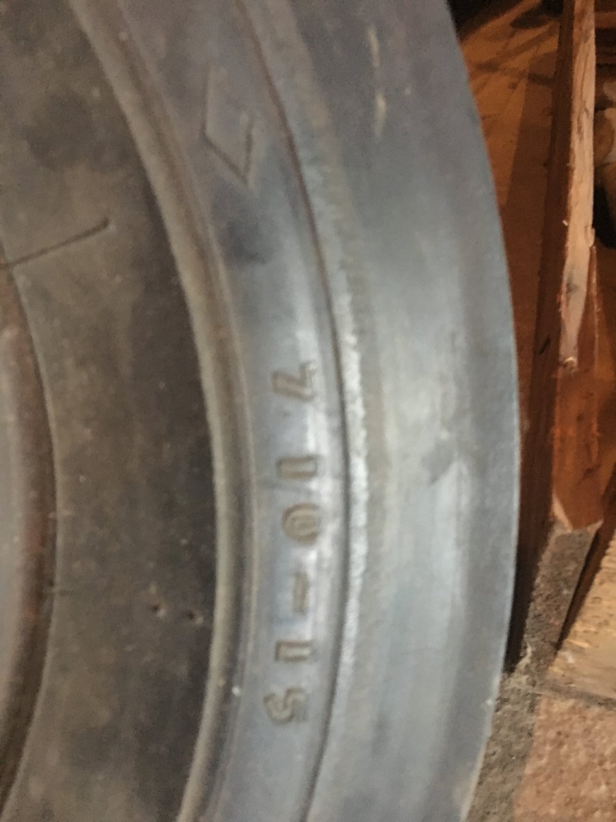

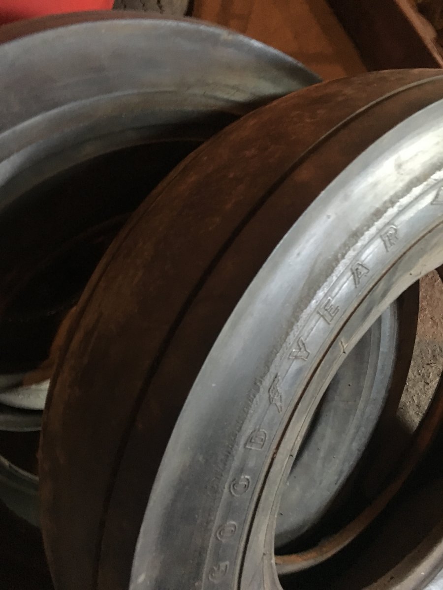

    60’s recap cheater slicks : 449B8A4C-5549-476C-A855-87AB374645D4.jpeg F29D394B-C818-45F3-B70C-30EDA755053C.jpeg
