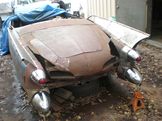

    Jim ,Consider this constructive criticism To me the front looks good.Im not feeling the rear( no pun intended) ,Its like theres to MUCH going on.
  4. Funny how we people are...I really like what is going on at the back end. I`m sure there will be more changes before you are done ! Keep it up !
  5. belair
    Joined: Jul 10, 2006
    Posts: 9,036
    belair
    WAY too much.

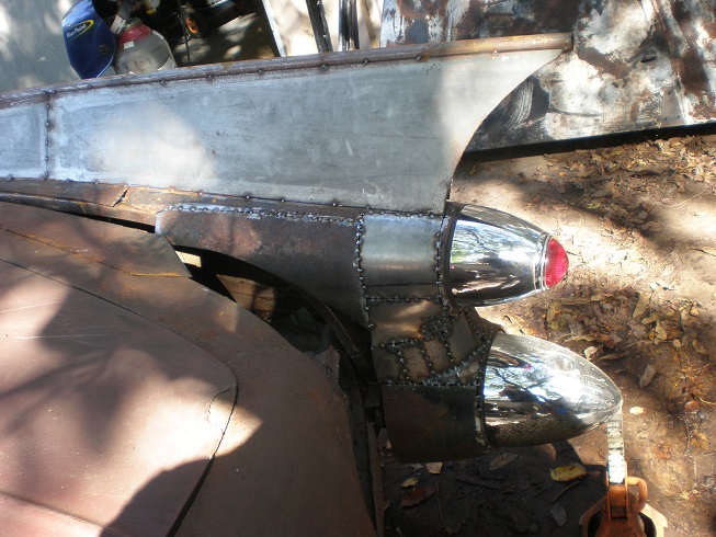

    a couple more hours on the rear... ;)

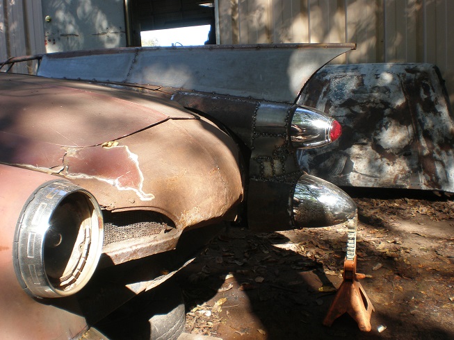

    a little more.............

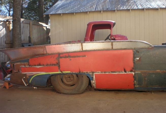

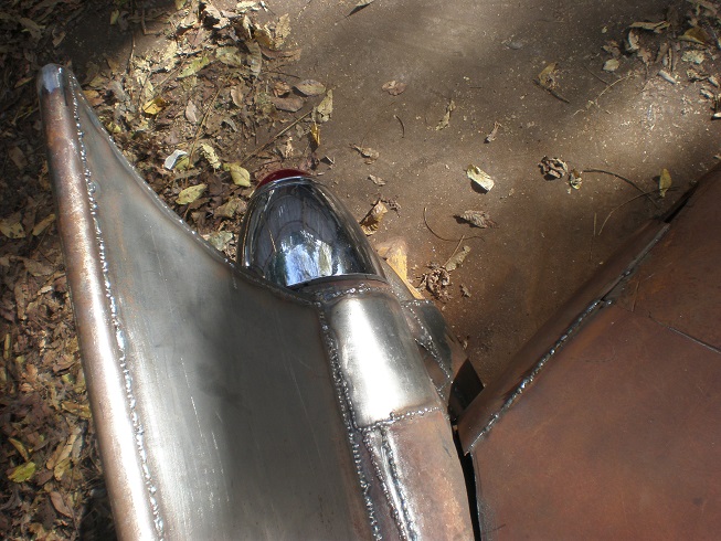

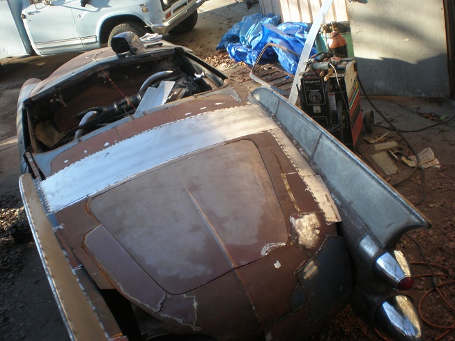

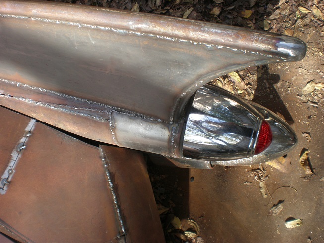

    welded one of the fins solid.....since i don't have an english wheel, i began creating one of the rear corners from compound curves i have cut from donor cars...it's always worked for me before,,,sort of like ***embling a big jigsaw puzzle,,,,,it still needs a lot more work, but the basic shape is established....

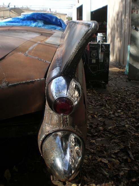

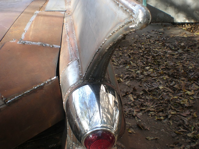

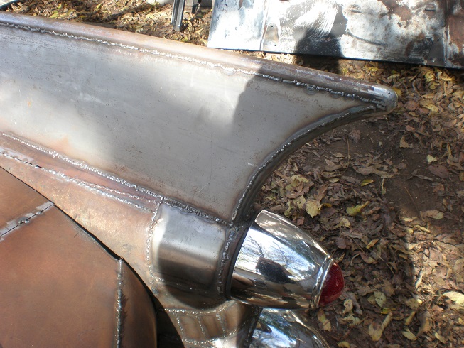

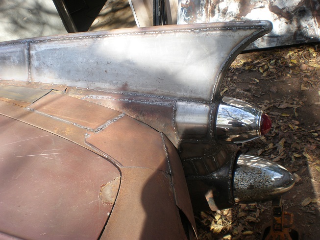

    a little more progress....capped off the end of the fin and got some more welding done on her..... ;)

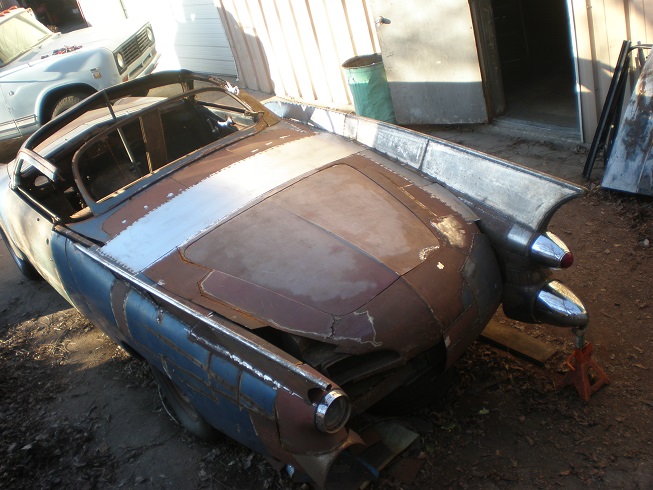

    double checking symmetry via photoshop....yep. seems to be on the $$$! ;)

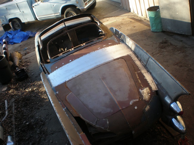

    filling in more gaps and working on the rear pan........

    I like the new fin length, but will you be able to open the doors? Will they get a door gap cut into them, or?

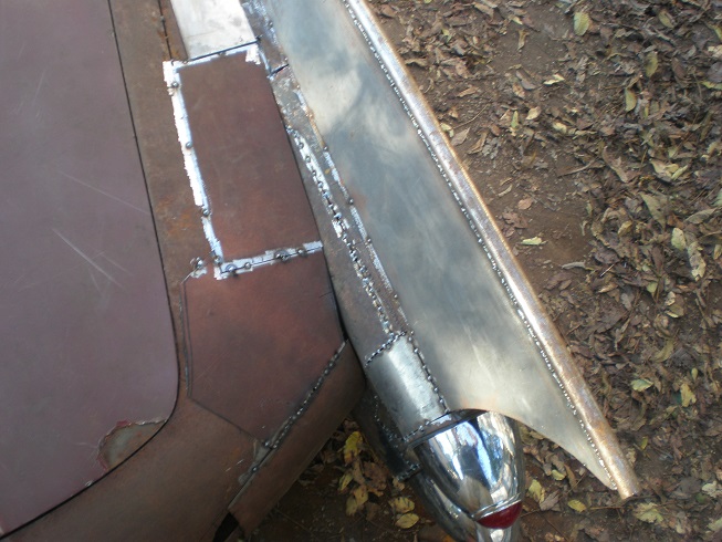

    p***enger side fin and most of the quarter (except for the rear area) welded up solid.... 008.JPG
