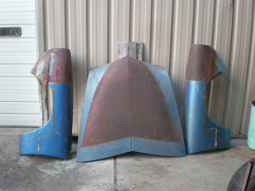

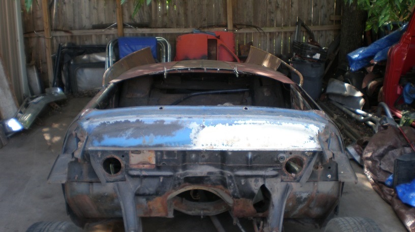

    bubbletop is a no-go.....too complex (and expensive)....found a solution which may be the best thing yet.......i did a photo rendering of the car as a roadster ......a day or two later i came across this amazing boat windshield that is nearly IDENTICAL to my rendering....also been working away on the car..when i originally sectioned it, i had never welded up the firewall, so i got that done, and while i was at it, i filled all the firewall holes as well, and relocated the body braces...also reshaped my door and shortened the fins to match my rendering,,,,,on a big time roll now!! onward!!!

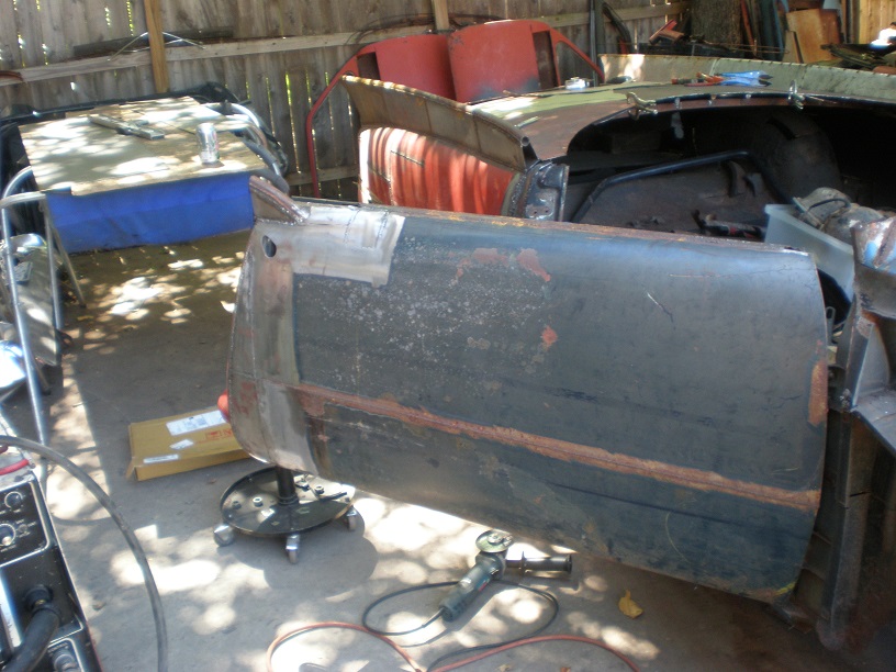

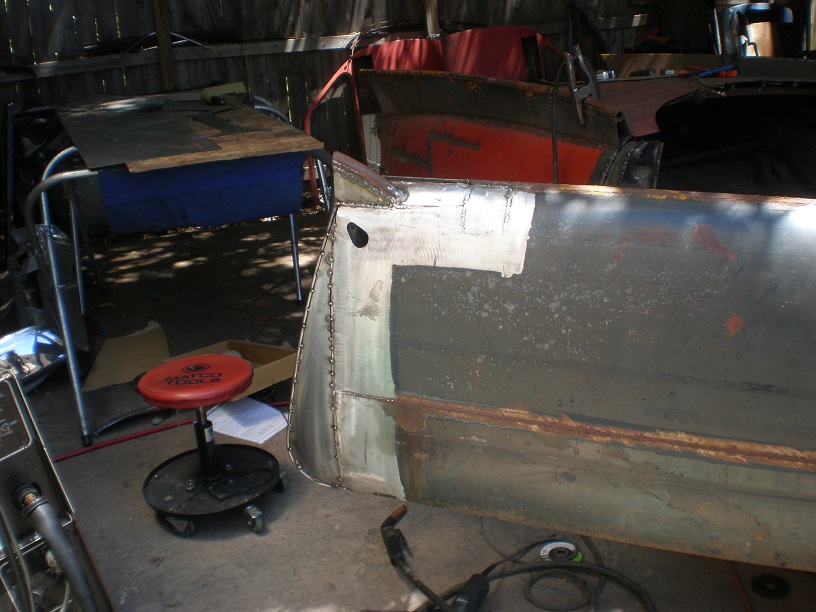

    A few more photos of door progress.......

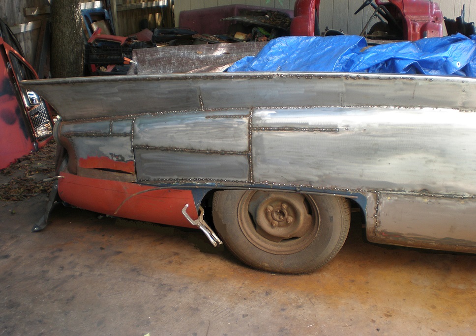

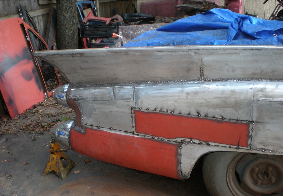

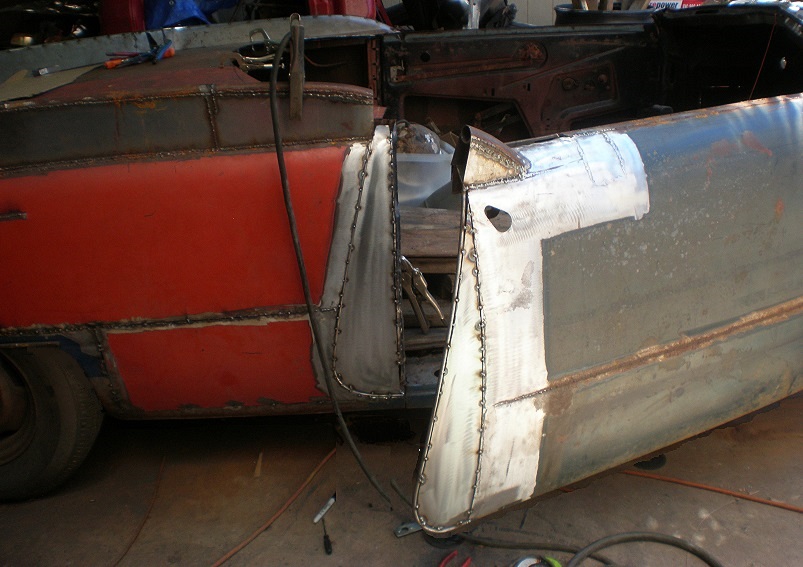

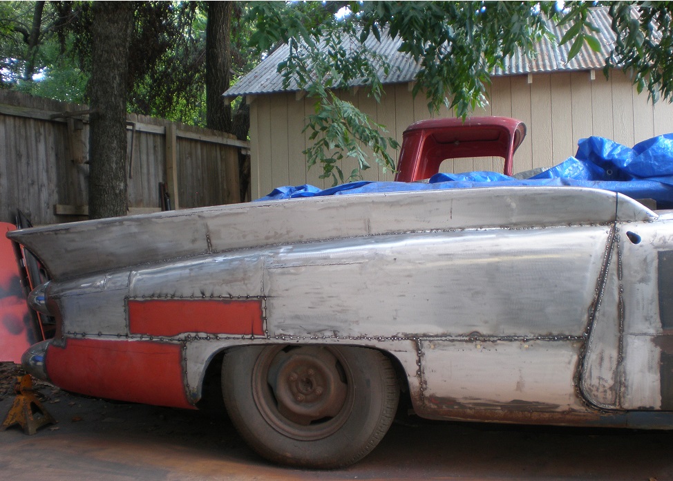

    a little more.....made that piece on the lower rear quarter from a shoebox ford fender,,,it fits very well....also replaced a panel that had gotten warped from welding (the other red piece)..ground down all the welds along the top side of the fin...need to go back and weld up some pinholes,,but making some decent progress on the quarter..

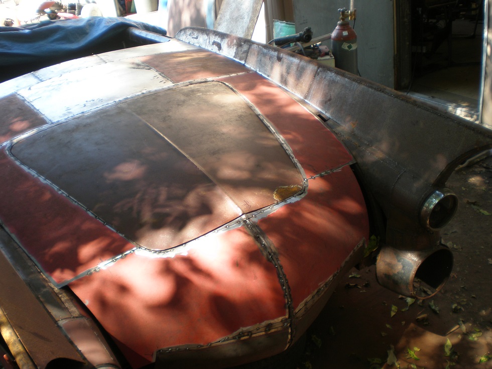

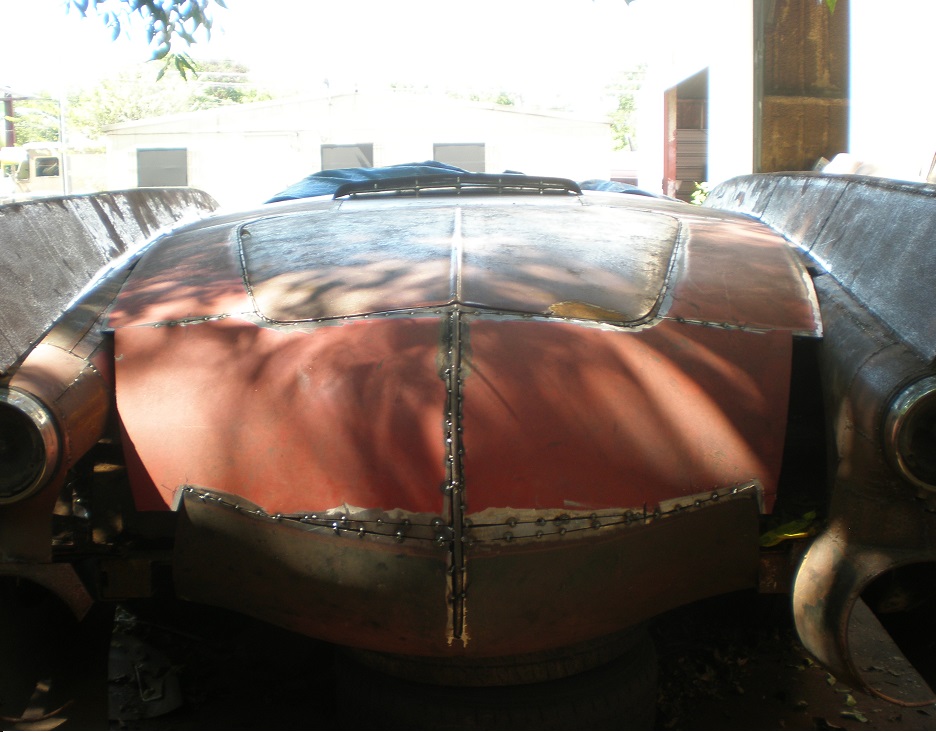

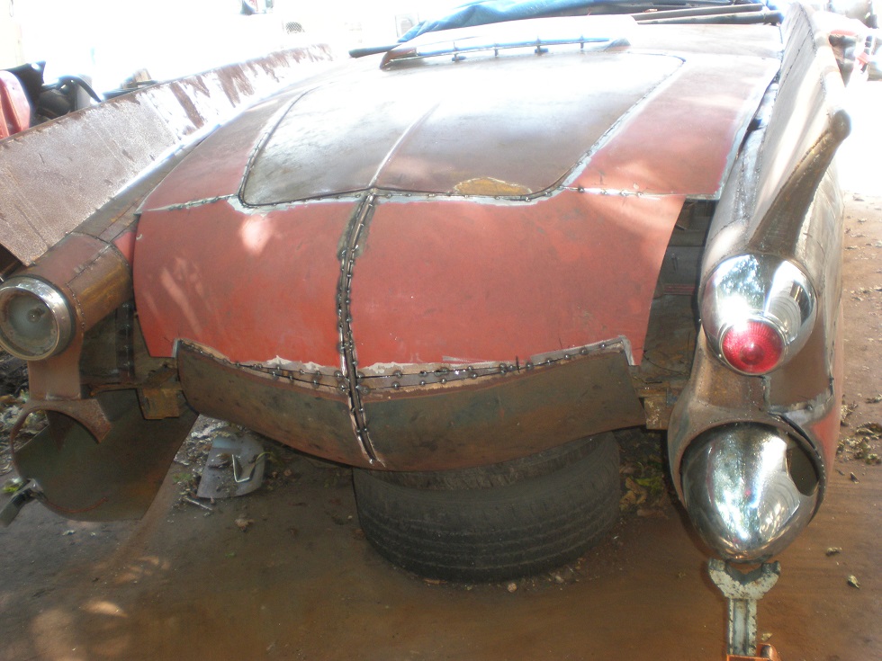

    playing around with an idea i had for a deck scoop...still on the fence about it,,,,also added more metal to fill in the area all the way up to the ****pit area...

    Jim ,Did you use round rod on the door edges or did you hem flange them.Looks GOOD!
