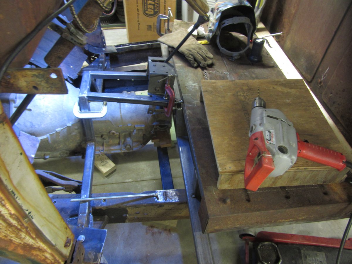

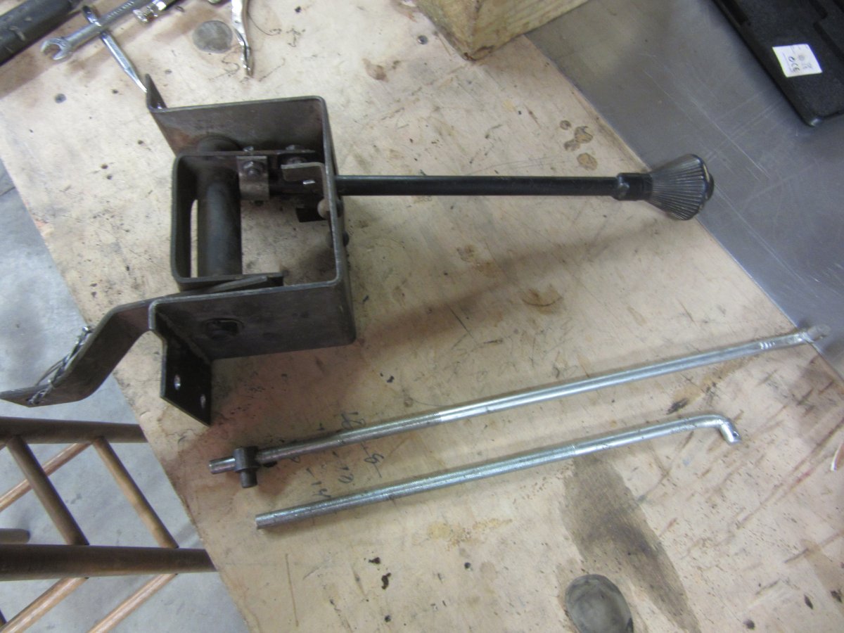

    I am planning on using this shifter on a truck I am building. It uses a push ****on to move the lever. It has a nice metal gate for the detents . I plan on using a shifter rod to operate the trans instead of a cable. Came out of a old Postal jeep. IMG_3516.JPG IMG_3514.JPG
    1Nimrod and loudbang like this.

    Thanks for that info. I was wondering how they bolted down, couldn't find instructions or anything on net, but I think I'll manage. Fortunately, my car has perfectly flat plywood floors, so it should be straightforward.

    I have the same shifter in my "collection", only the stick is chromed, and does't have a ****on; it also came out of a 70's postal Jeep.
    I am Butch/56sedandelivery.
    1Nimrod, TA DAD and loudbang like this.
