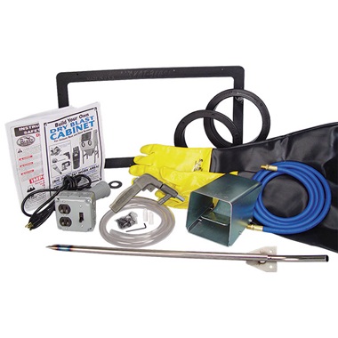

    https://www.tptools.com/Skat-Blast-...-45-XL-Lens,7196.html?b=s*Build+your+own+trim
    Then on top of that I need a dust deputy, a shop vac, vacuum hose and fittings, a trap door for the bottom, hinges, handles and latches, gaskets. Some sheet metal and my fab time. I’ll end up with a pretty nice sized cabinet but over my budget plus I’ll have to figure out where to cut the time from.
