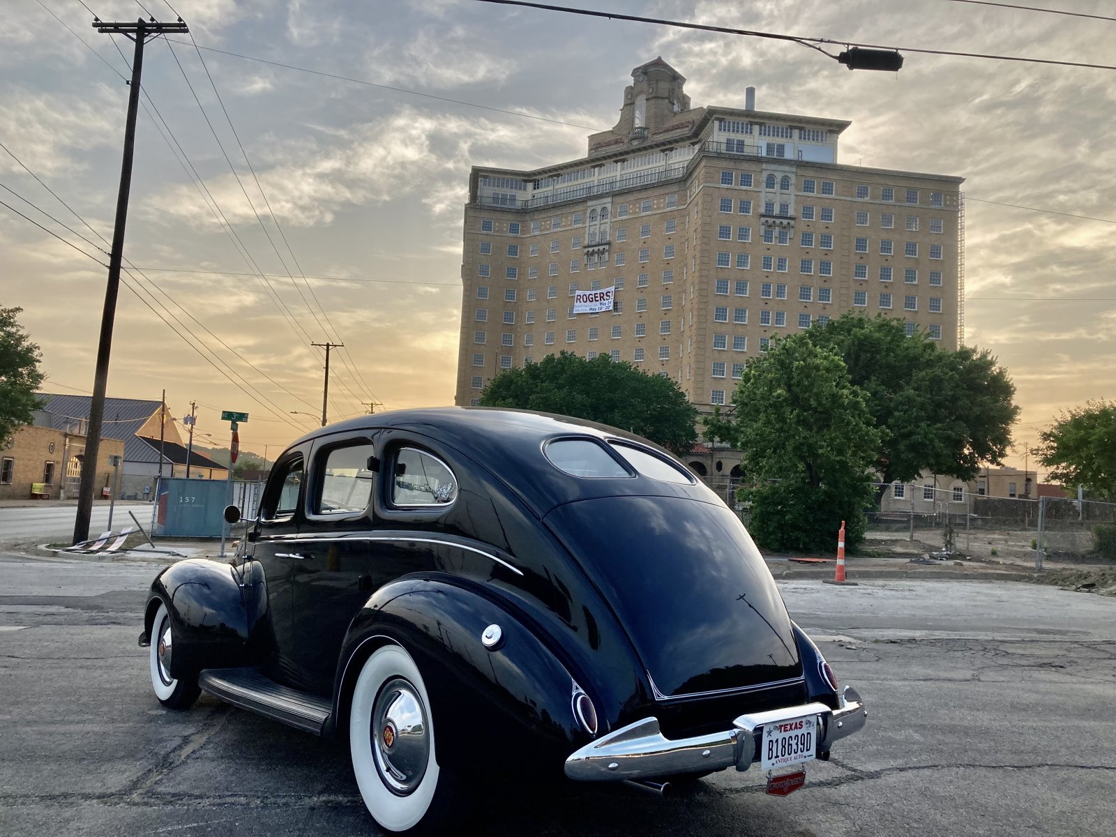

    These are DiamondBack Auburn 7:00x16 on the rear of my '40. The fronts are 5:50x16. I'm running the later 42-48 style rims that are 4.5 wide.
    lothiandon1940 and CME1 like this.

    Zax, I like the rake , I****uming you still have the stock springs and stock axle. What is like taking the rear tire off , I will probably have more clearance to the fender on my 47.
    Flathead47
    lothiandon1940 likes this.
