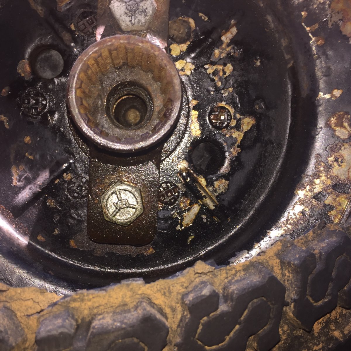

    I'll bet it is for a crank driven water pump like a McGurk. It looks like there are hose connections at the water pump inlets in the block. I ran a McGurk crank driven pump on my sprint car. The drive was a bit different, but I didn't run a damper or any pulleys. The pump bolted to the Hilborn timing cover.

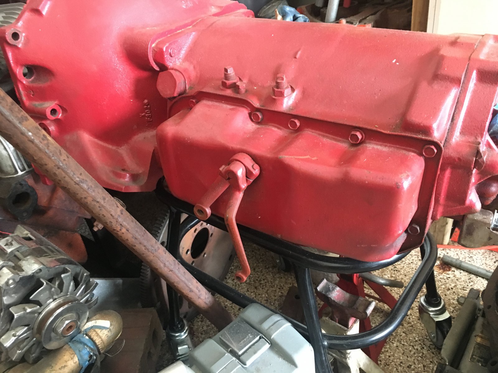

    Hello Butch, you seem to have very much knowledge about the hydro transmissions. I have one for my fathers coupe he built up yrs back and I ha e not got it going yet. my question, will I be able to use the starter that bolts to the bell housing? I’m not sure it’s a hydro starter could have been from a power glide I was not aware of that. I hope I can get this thing going. It has a 56 corvette engine with factory corvette dual WCFB carbs. also I’m trying to figure out the linkages for this thing. I know they will burn up if they are not. the valve linkage is important. Any ideas on how to hook this hydro up to the progressive carbs.

    I am not an expert on these; but worked with one that came with a unfinished project and was replaced by a 4 speed. You need the hydro starter; it is like no other. This had part of the stock linkage; bell crank and rods; but it stopped there and was never hooked to the carb. If you look at some older motor manuals; they have some pretty detailed instruction on the linkage adjustment. Probably could cook up the parts from the picture; but an actual truck manual (if such a thing exists) may be better.

    Those WB bolts on the pulley are correct for the era.

    I hope I’m not too late on this. The trans pressure arm on the C&O stick hydro I had behind a carbureted and Rochester FI SBC pulled the same direction as the the throttle arm. It did not connect to the lower hole below the throttle plate like the power glide. I am not sure if there was cross link bell crank on the trans to engine mount as this was done in 1965-6.
  20. busyhornet
    Joined: Aug 7, 2013
    Posts: 38
    busyhornet
    Thank you for the reply. I do believe it use the bell crank like you mentioned.
