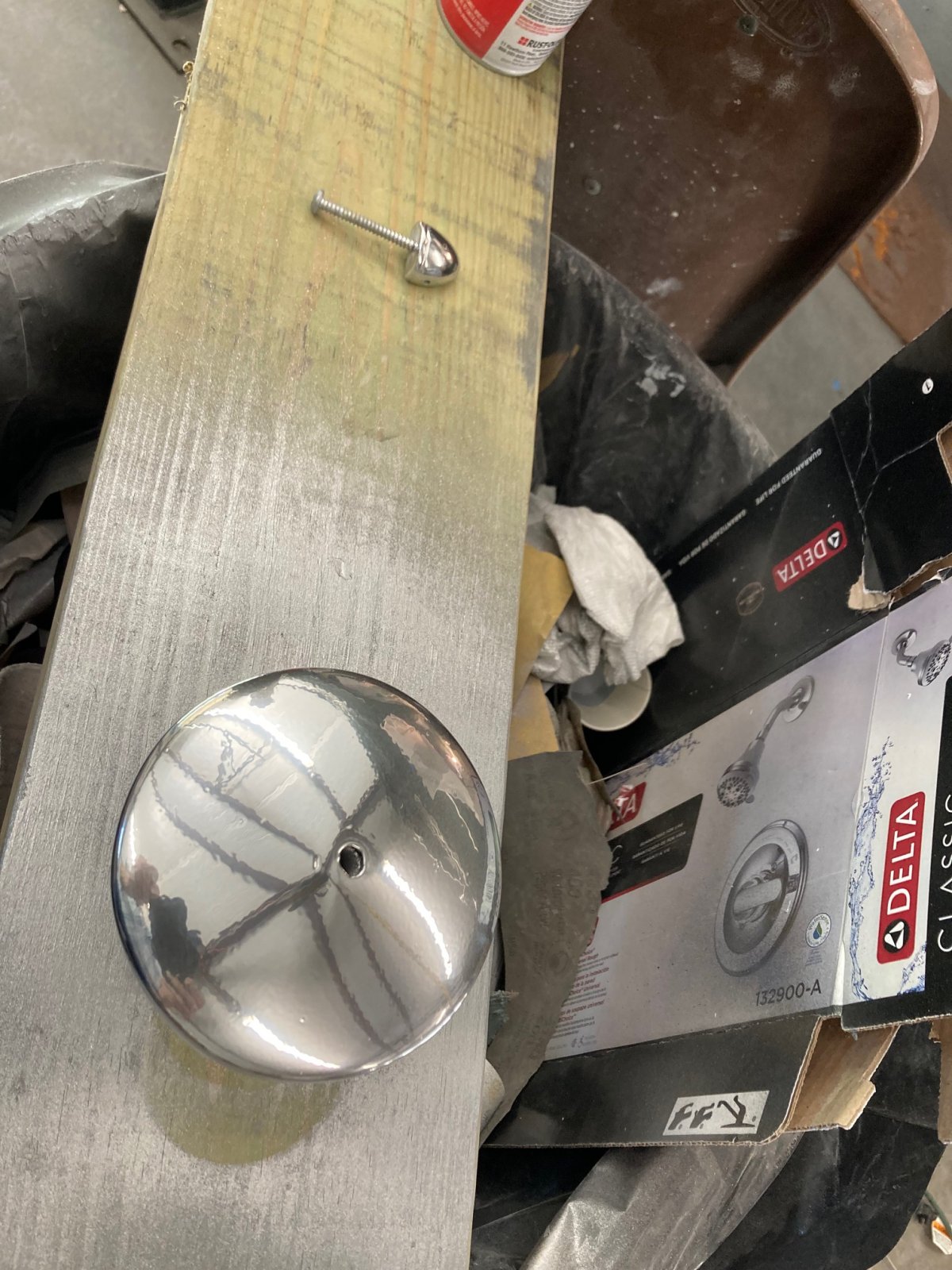

    drdave
    Wow! That turned out great!!!! Did you paint it on with the pen or get the paint out and spray it?

    jivin jer
    Hey Doc, thanks for checking in. Whenever I dive into something I've never done before the process is usually the same. I find out what not to do first. I started out with Alclad chrome to find out it wasn't satisfactory. I had an airbrush setup that I had never used before, so I started out on my discovery path.
    What I learned was that the surface of the object has to have the same prep/build up as any quality custom paint job, 400/600 wet sanded surface. The air brush won't supply the volume needed to get the quan***y/volume of product onto the surface, to look right.
    I used my regular Sata paint gun turned way down to apply the chrome stuff. You'll see the results shortly. Oh, and thanks again for the help.

    Having trouble uploading some of these pics. The chrome looks excellent right after application. It will dull a little after flash off. thumbnail.jpg
