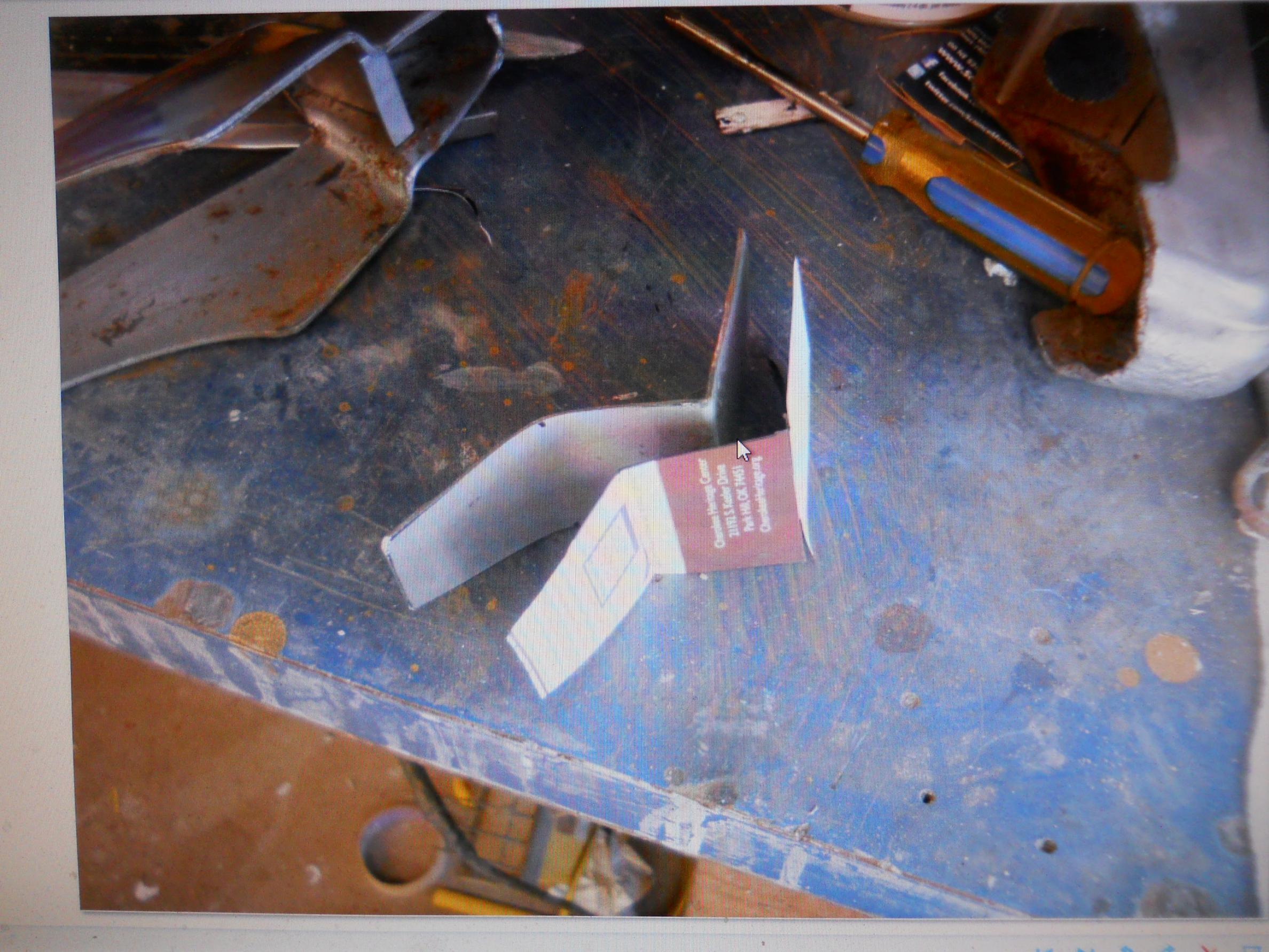

    OK, lets get back at it in a frozen shop. We lose our fastener because of the need to make the lens big like the picture.
  13. jivin jer
    Joined: Sep 14, 2008
    Posts: 3,535
    jivin jer
    These lights are actually pretty good sized for this car.

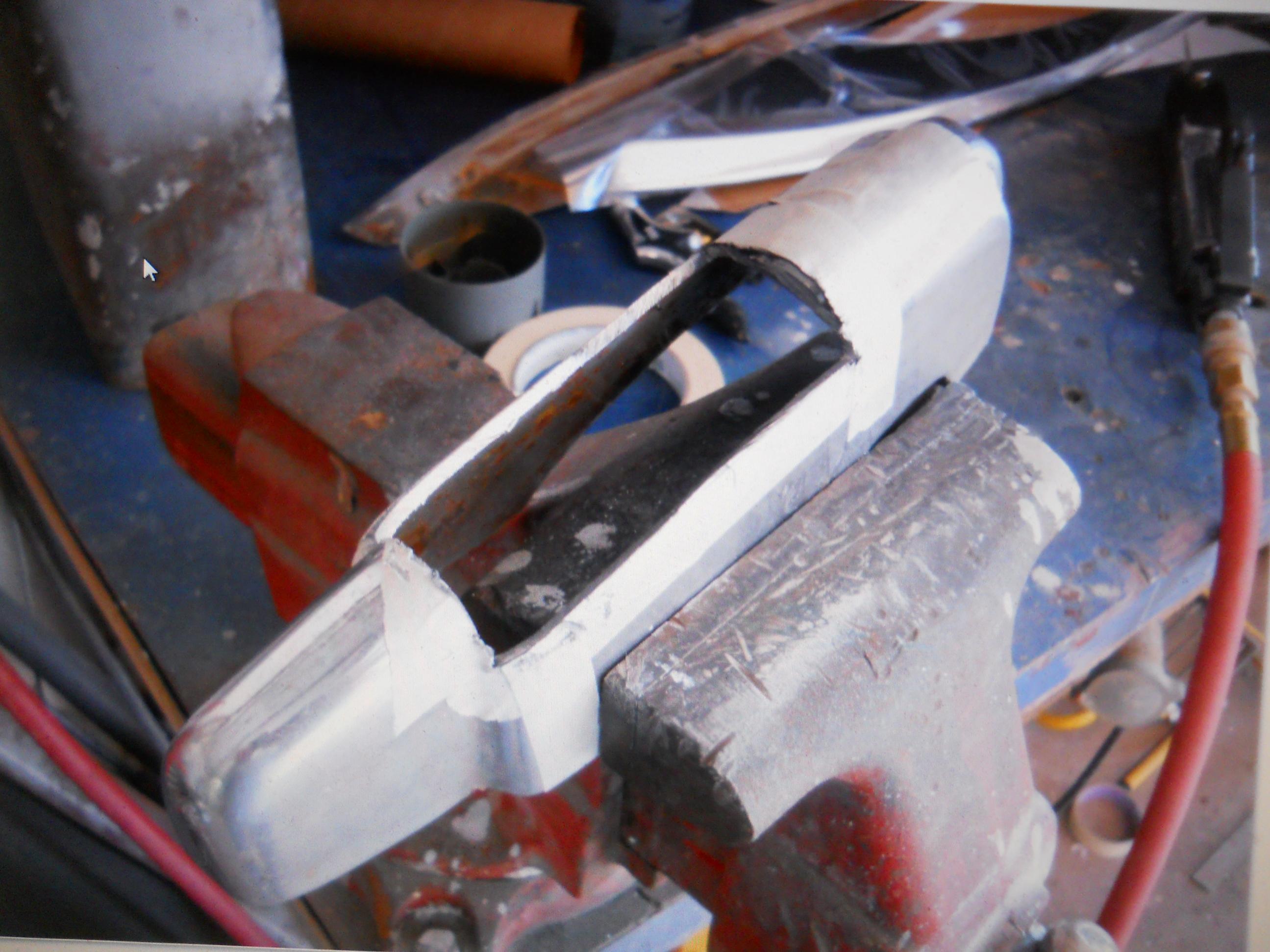

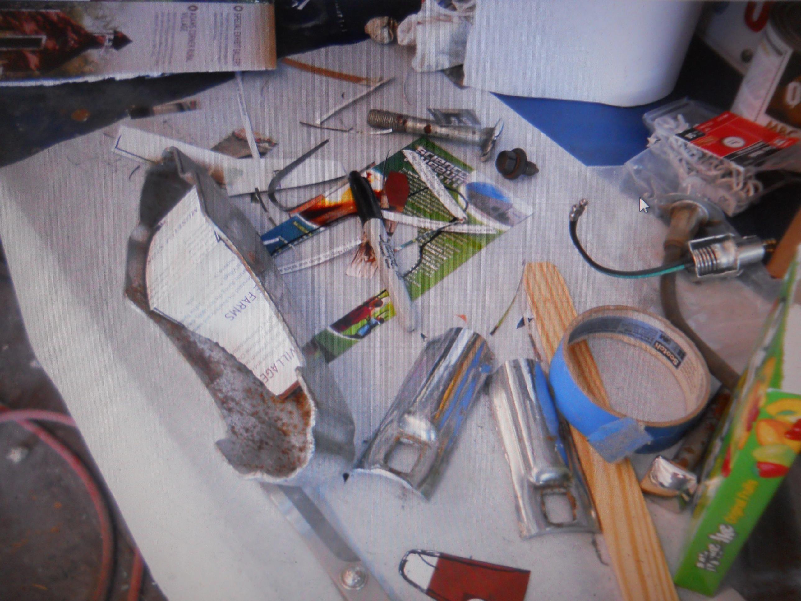

    Cut, fit, cut, fit, repeat.

  17. pimpin paint
    Joined: May 31, 2005
    Posts: 4,937
    pimpin paint
    from so cal
    Hey jer, can ya cut those back bits from a sheet of stainless, and once cut out, polish them with sucessive grades of wet & dry paper to serve as reflectors for the taillamp bulbs? They'll never tarnish or pit and always reflect good light!
  18. jivin jer
    Posts: 3,535
    jivin jer
    Of course! Just like "the guy's" did it.

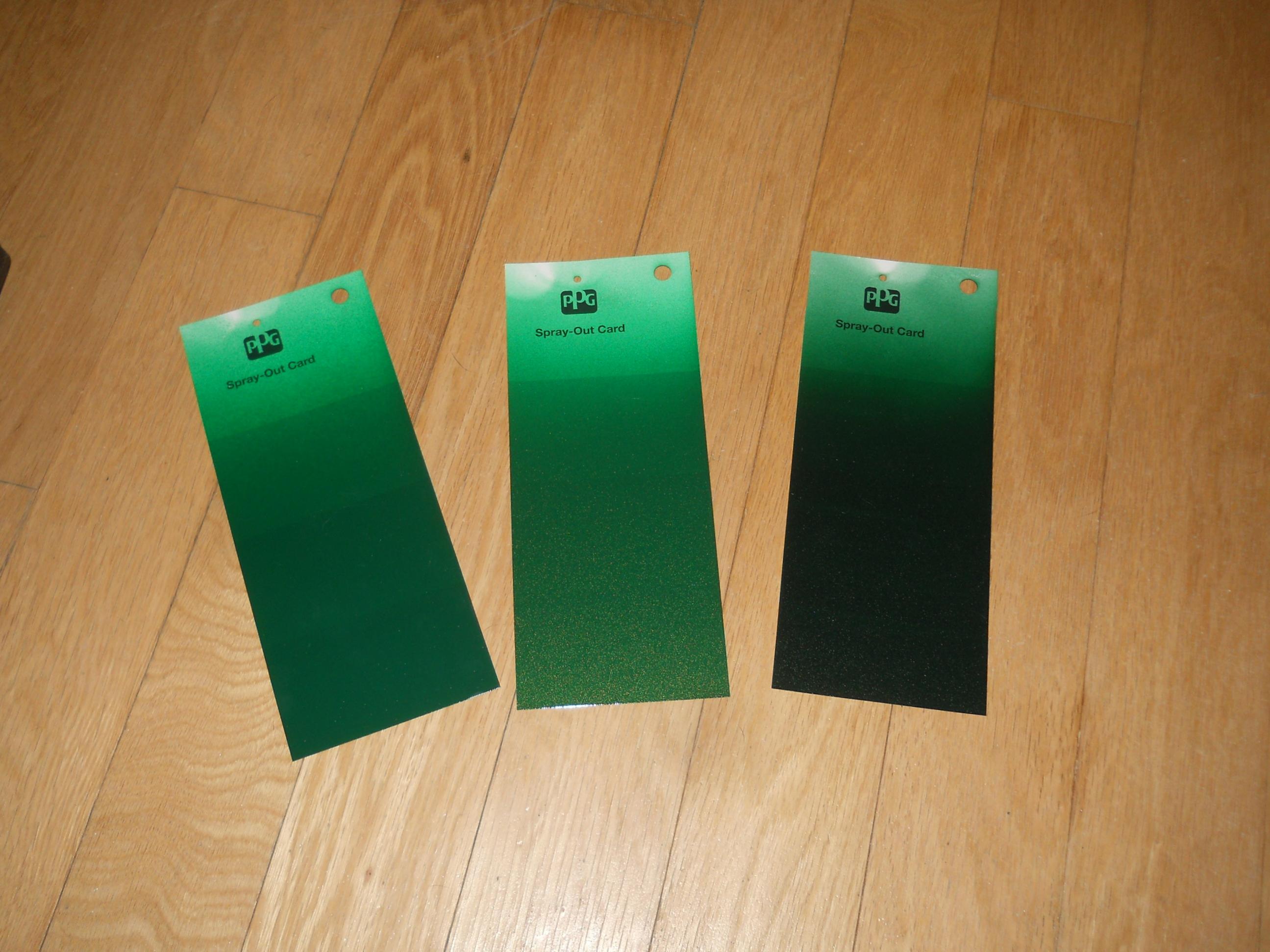

    Just for the record, this is the third round of, too light?, too dark?, too green?, too sparkley?, etc.. I CAN walk AND chew gum at the same time.
  21. pimpin paint
    Posts: 4,937
    pimpin paint
    from so cal
    Hey jer, I got ya, and I'll shut up now;) But on the subject of paint draw down cards......there's a big difference between seein a colour on a card, and seein that same colour on a panel the size of a hood or roof! Always best to do a full spray out on a much larger panel than a card:)
  22. jivin jer
    Posts: 3,535
    jivin jer
    Well, the back and forth with Jesse is about $75.00 a pop now. Would the best method on a hood or roof be Greyhound? Seriously, when we get close I can do a glove box door or something.

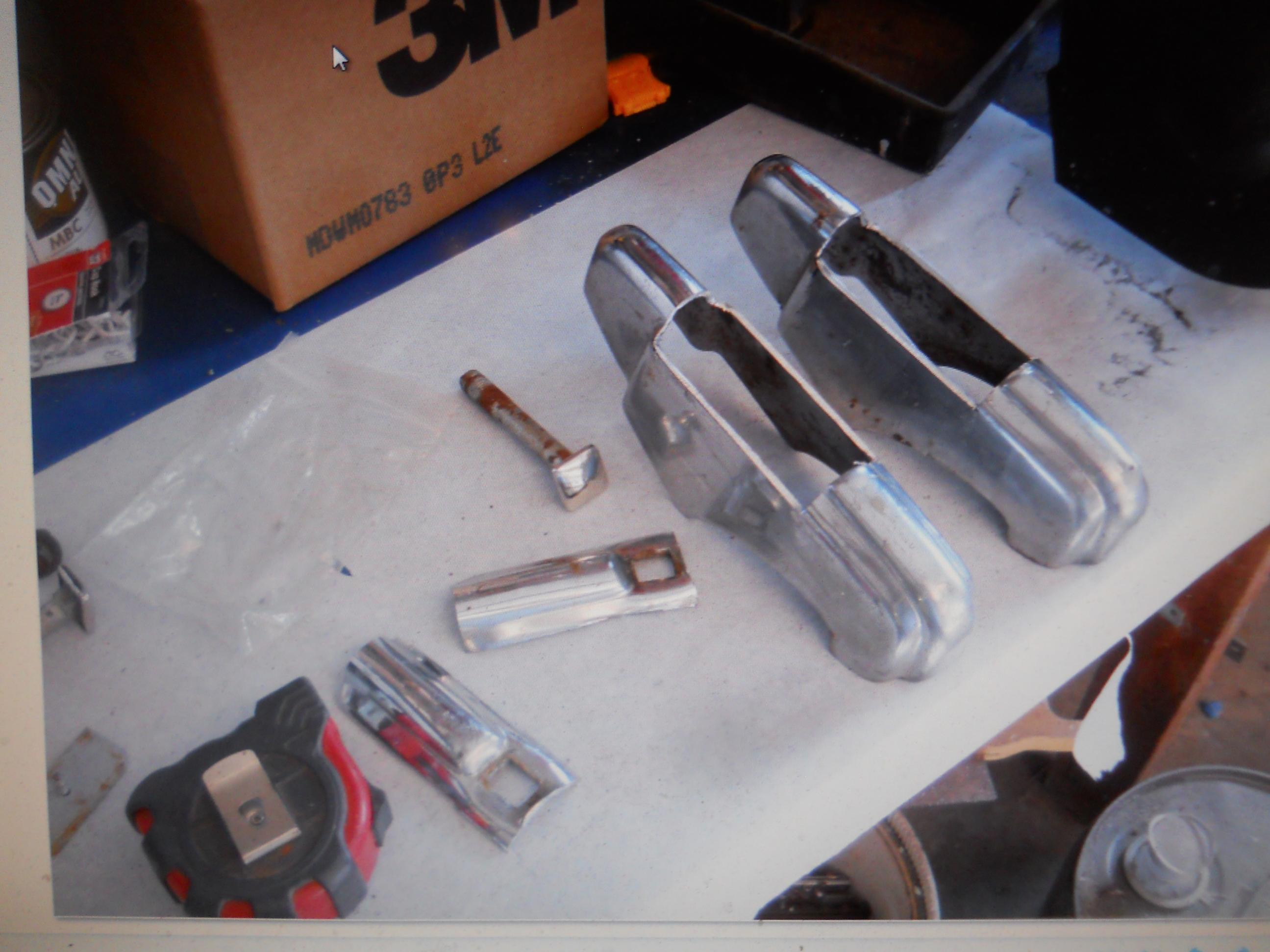

    OK, let's get back to these tail lights.
