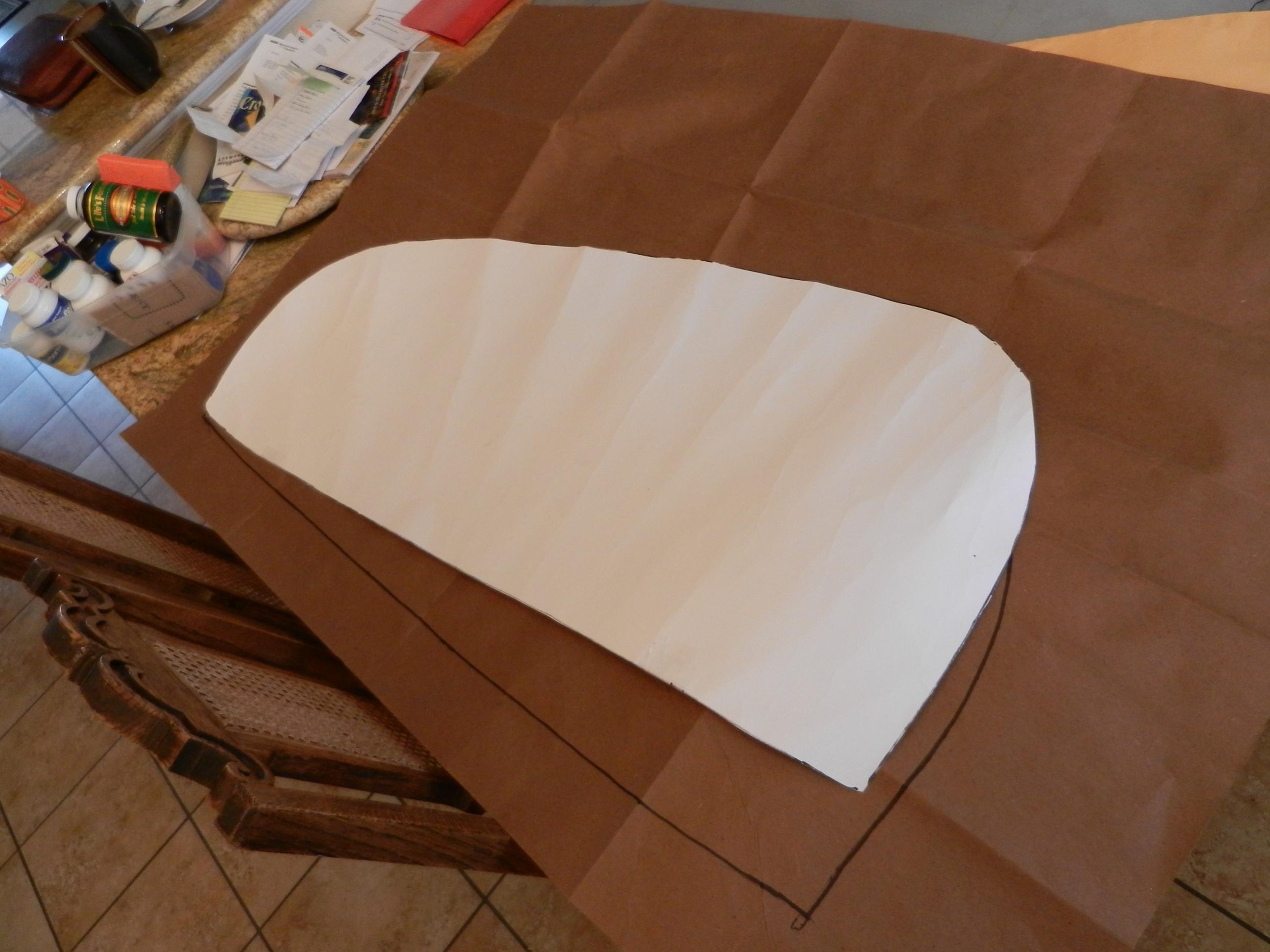

    I just recieved Palle's template for the skirt. It is different than the skirts I have. Iv'e contacted Gordon at Agape and told him to not fill any order's until he gets this template. He is waiting to recieve the template in the mail which will go out today
    Gordon has recieved some orders but nothing has been made yet. WE MADE IT!

    what was wrong with the skirts? I ordered some for my project 41 , but they havent been shipped yet.......

    Well they do say that a picture is worth a thousand words. In place of the pics wer'e stuck with the words. So when the pics do come it will be easy, until then all we got is, they're different, on both accounts.

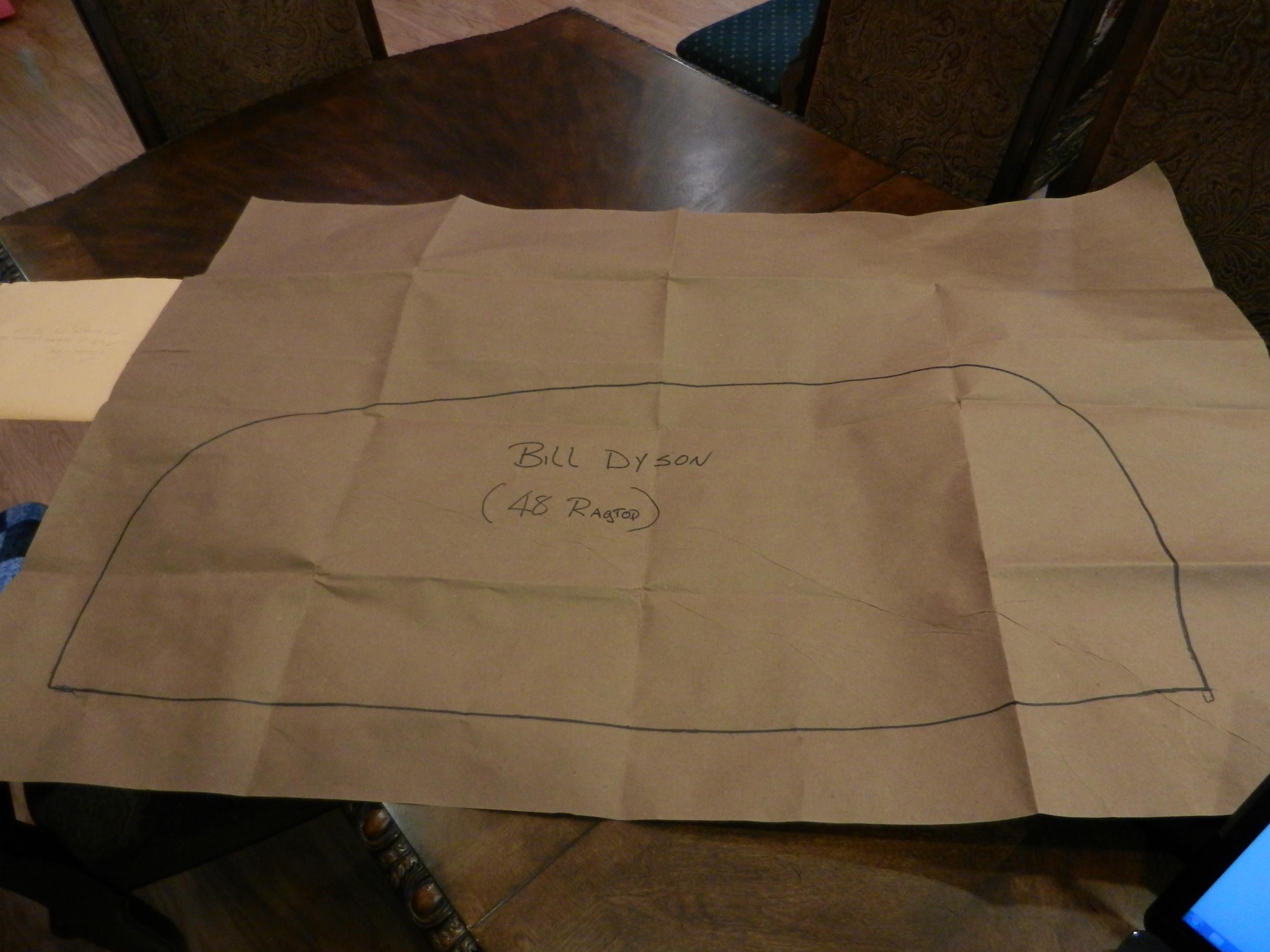

    OK, DAMN THE TORPEDO'S AND FULL STEAM AHEAD! The service center has received the parts to fix my hard drive. I have no idea when it might be fixed or faith in the process. I've procured a lap top and I will try to see how far I can get in this configuration. I can't print out but I can post pic's (so far). So here we go.
    Palle PM'd me awhile back to tell me that the template had slipped through the cracks and had been missed on the first attempt at mailing. I replied that it wasn't a problem and thanked him again for his help. While I'm waiting for this template another one comes in the mail. As I'm trying to figure out where this one came from I notice that it's post marked Burleson Tx. The only person I know from Burleson is Bill Dyson (48 Ragtop). My wife and I met Bill and Jean at the 2011 GNRS. They invited us down to their summer bash (the thing). We went summer before last. Lots of cool cars, friends and food. We had a great time and I got to look over Bill's playpen (shop). I got a chance to kinda take an inventory of what I could see. Lots and lots of cool stuff. I called Bill and sure enough he had seen the skirt posts and decided to surprise me and mail HIS template. Now I'm beginning to think that Bill has at least one of everything (except supercharger's). Thanks Bill, we can't have too much confirmation.
    This is a look at what the template's show. Both template's are the same. So, as someone has said previously (somewhere), life is a period of adjustments.
