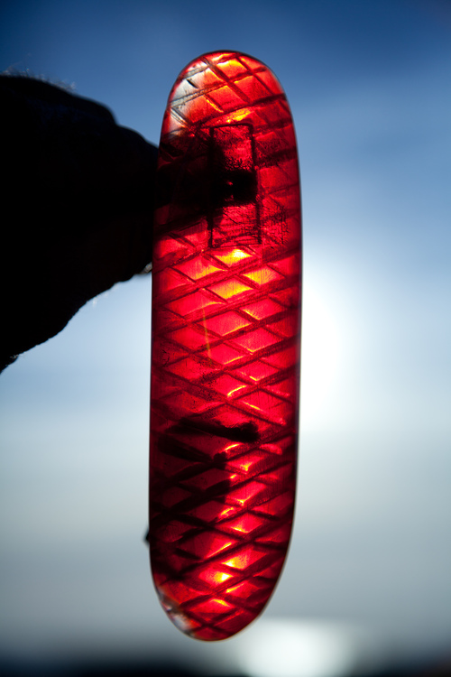

    Now we file in the period perfect light diffusers using Riks excellant new book for a referance.
      368.7 KB
      852

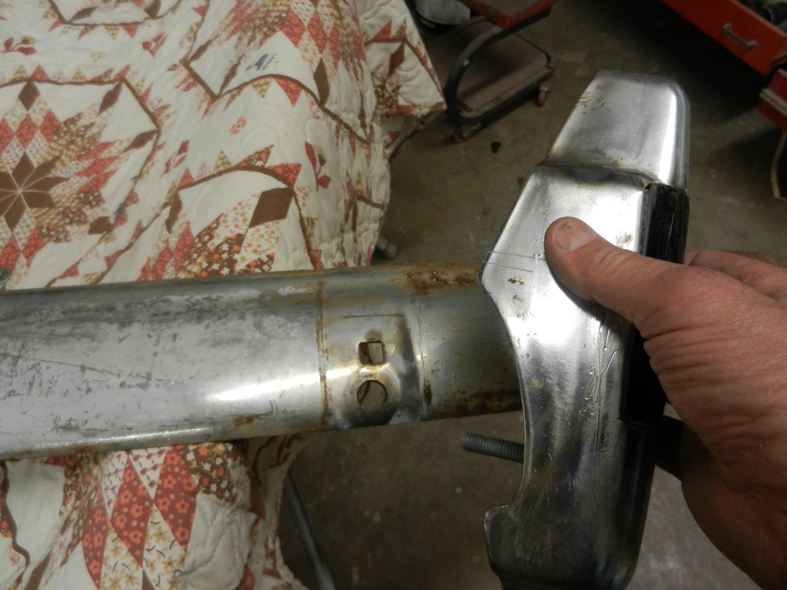

    New fastener in gaurd.
      295.9 KB
      695

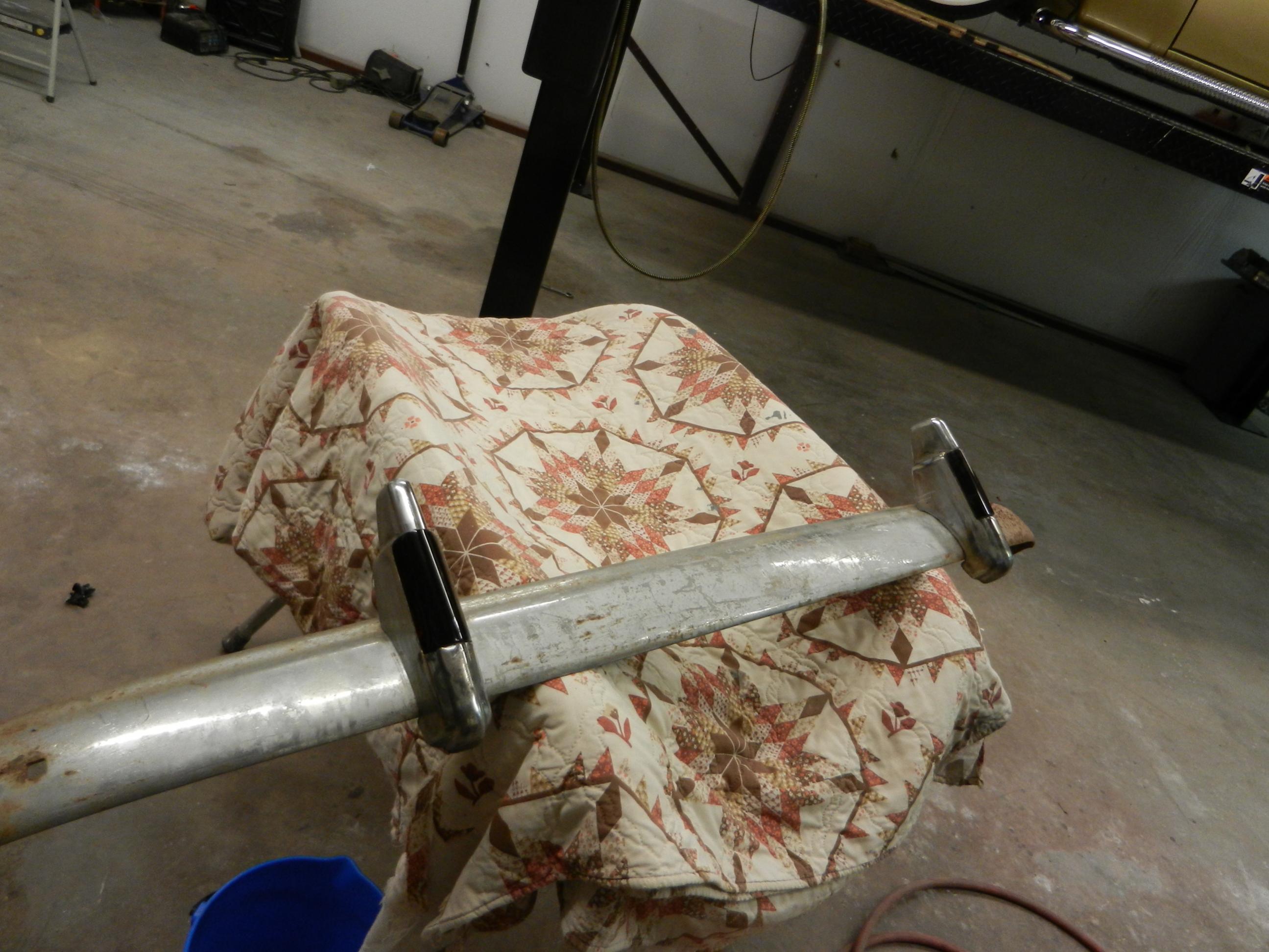

  7. jivin jer
    Joined: Sep 14, 2008
    Posts: 3,535
    jivin jer

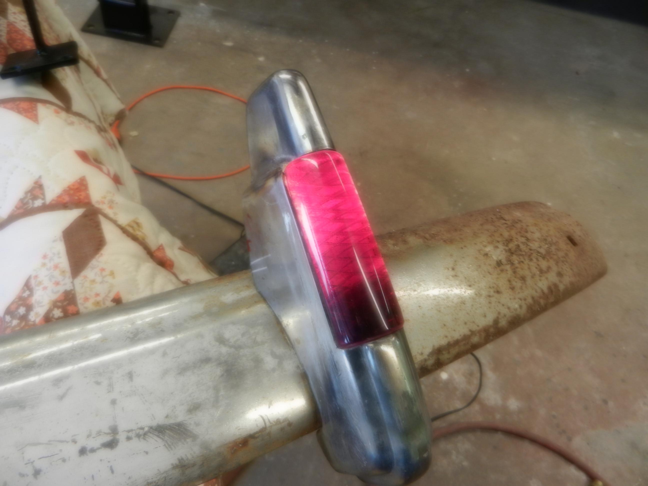

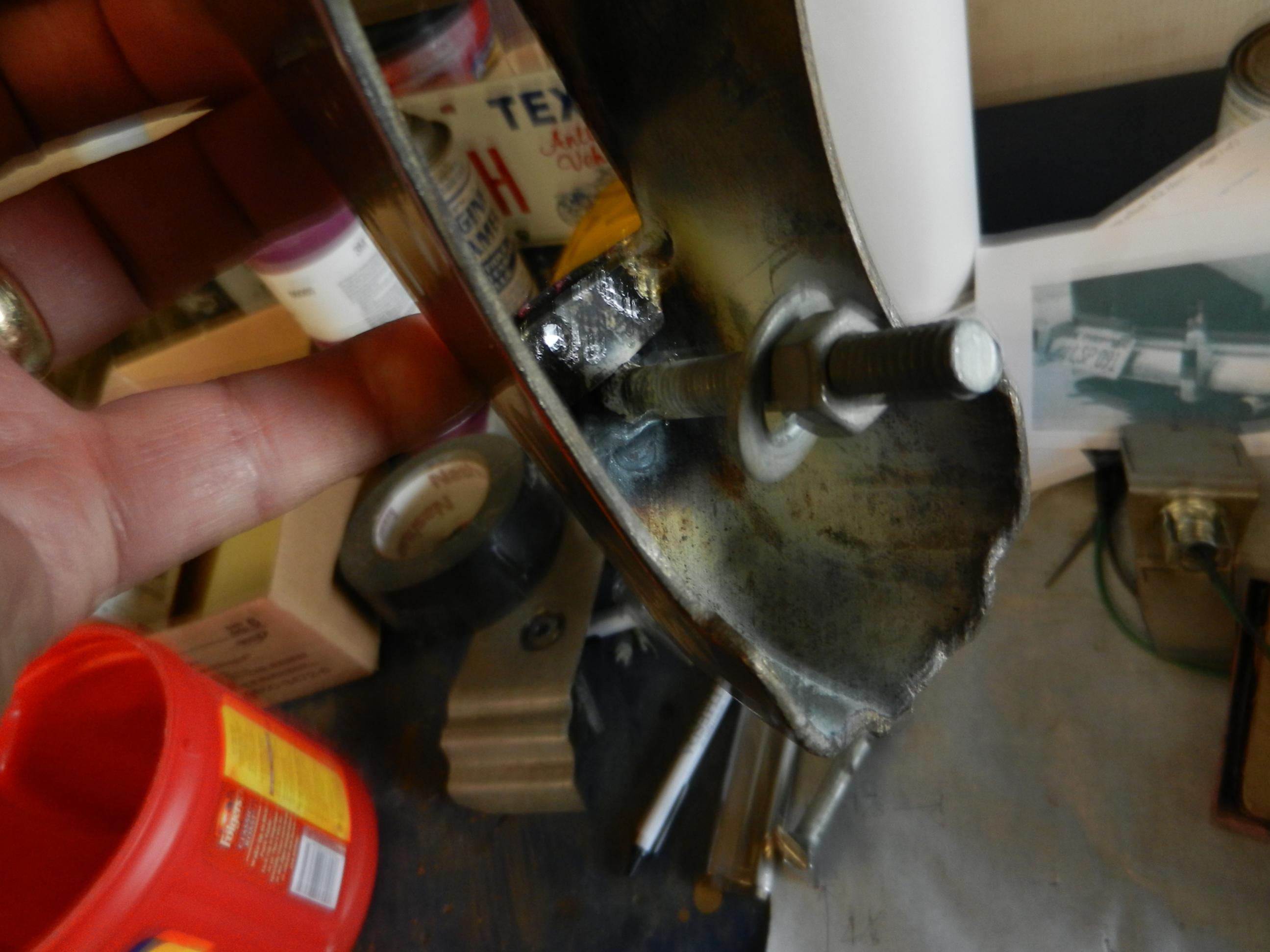

    We need a new hole in the bumper.
      382.6 KB
      589

  10. jivin jer
    Posts: 3,535
    jivin jer

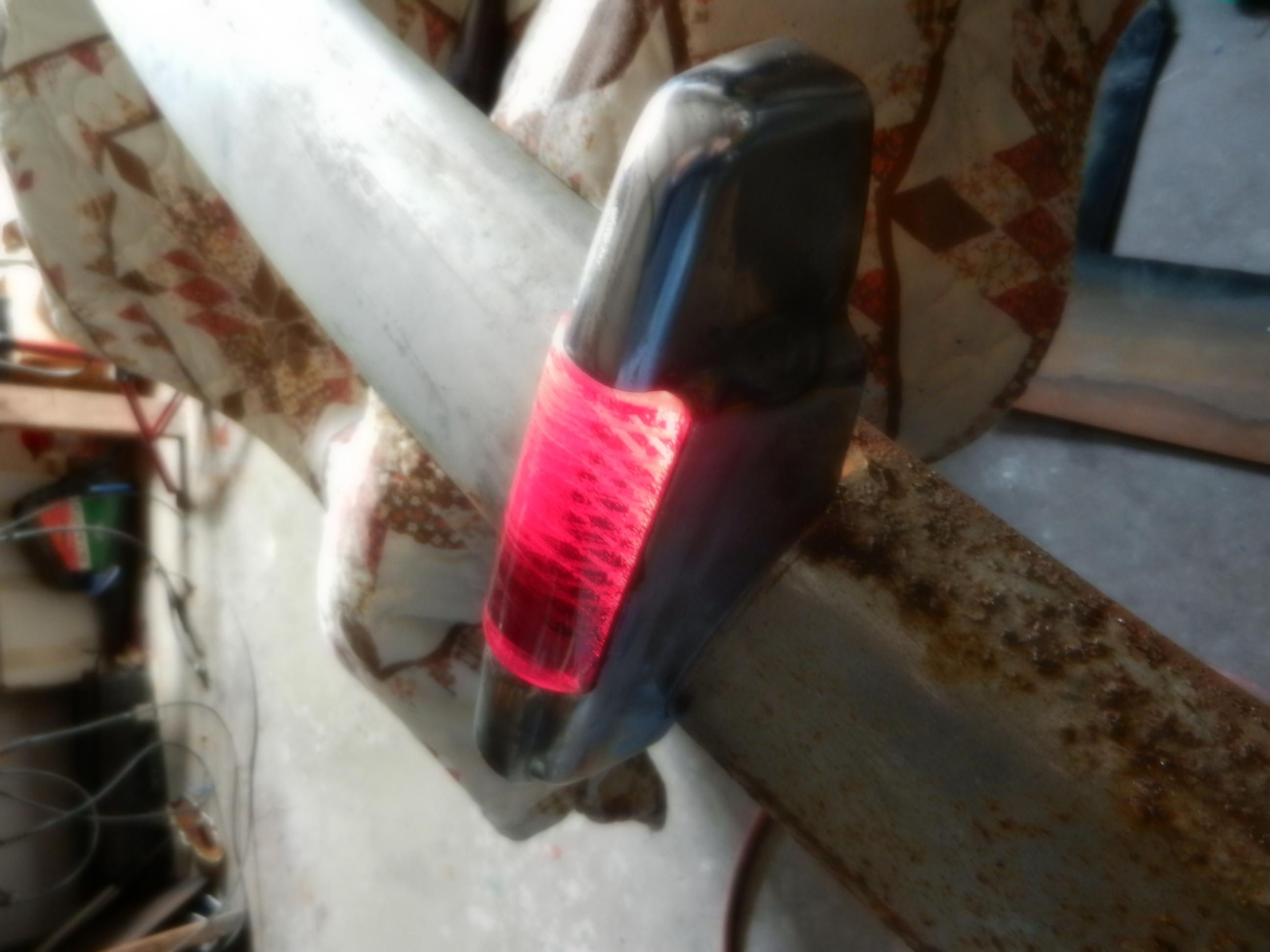

    The len's will be glued in after the plating.
      312.1 KB
      626

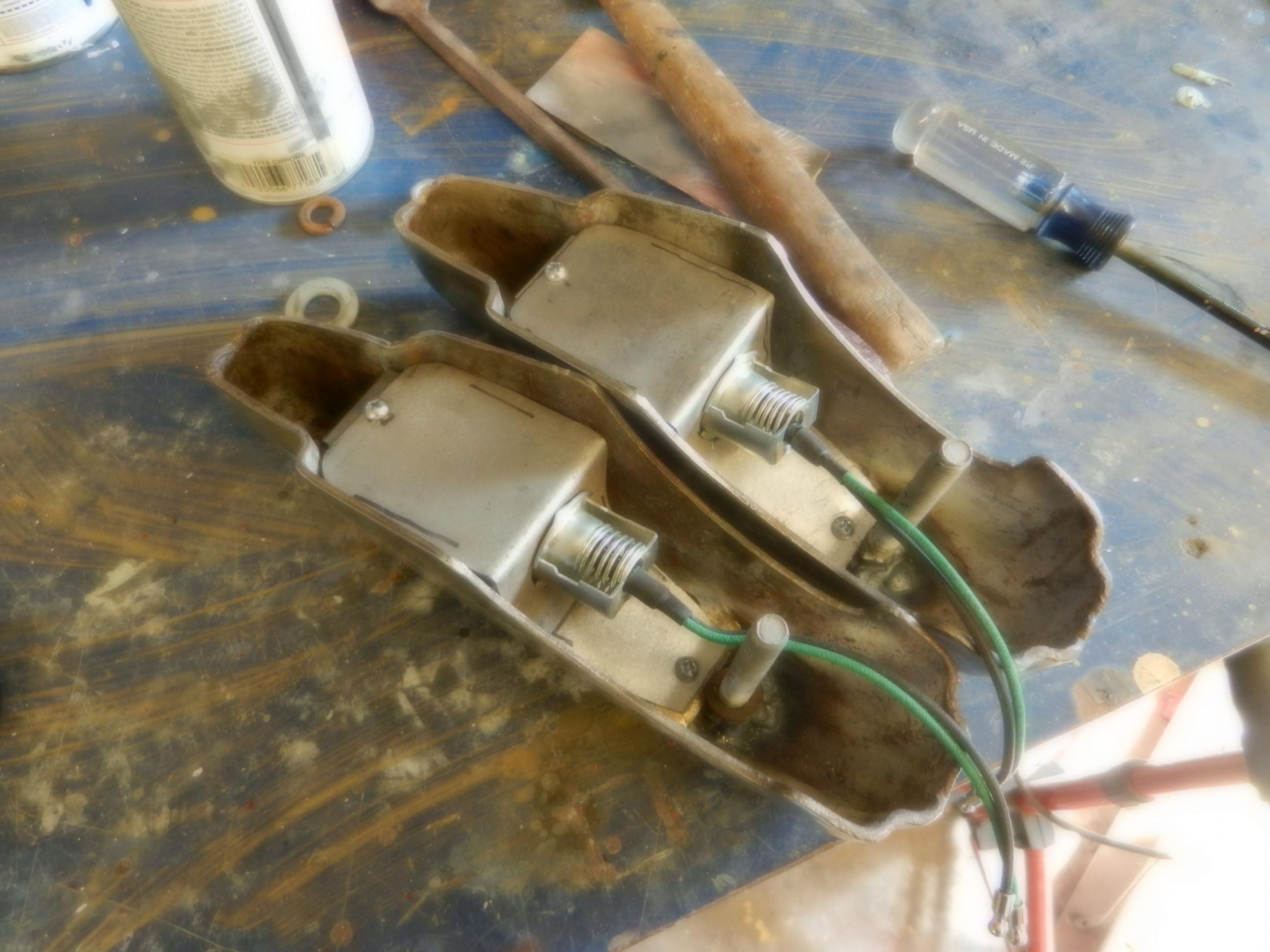

    Sockets installed.
  13. jivin jer
    Posts: 3,535
    jivin jer
    New wiring through the old bumper gaurd hole.

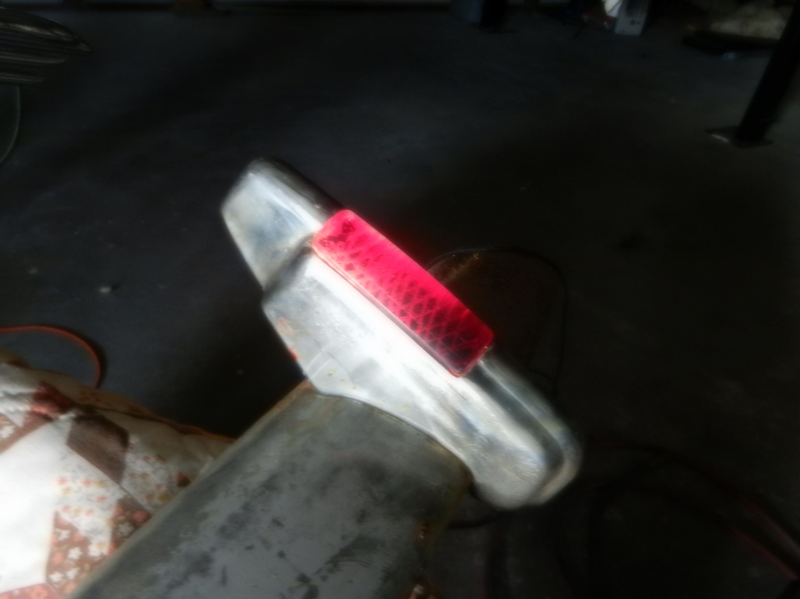

  14. jivin jer
    Posts: 3,535
    jivin jer
    I think wer'e done.
      437.1 KB
      679

  15. clean cut creations
    Joined: Feb 8, 2005
    Posts: 1,352
    clean cut creations
    Lights look awsome!
    Filament bulb or led style?

    Following your build since first post. Love the way you built these plastic lens gl***es.
    I have a question.
    Why did you have to move the hole in the bumper? Couldn't you have made a bracket with a threaded hole or a welded bolt (like you did) in the original position?
  20. jivin jer
    Posts: 3,535
    jivin jer
    I couldn't duplicate the correct appearance any other way. The tight space didn't present any alternative's. Comparing the available pic's to the object that needs modification is always the key to getting started.

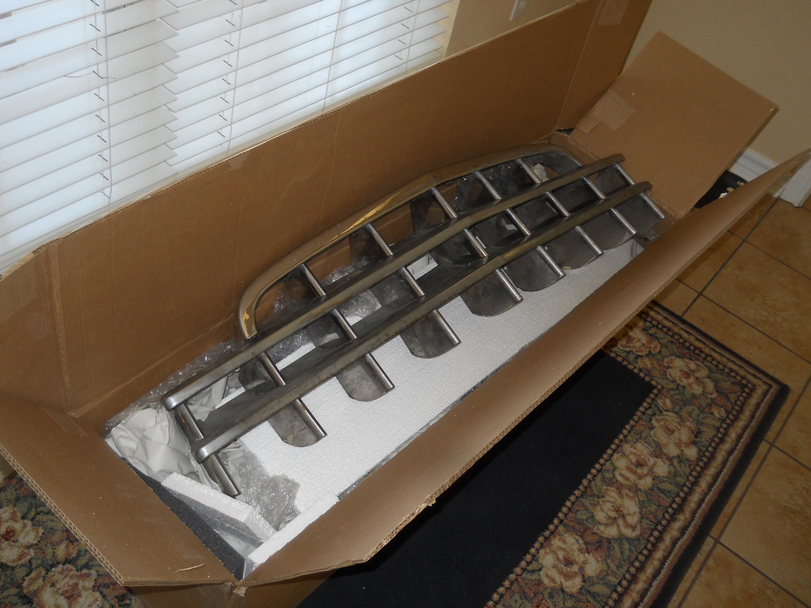

  24. jivin jer
    Posts: 3,535
    jivin jer

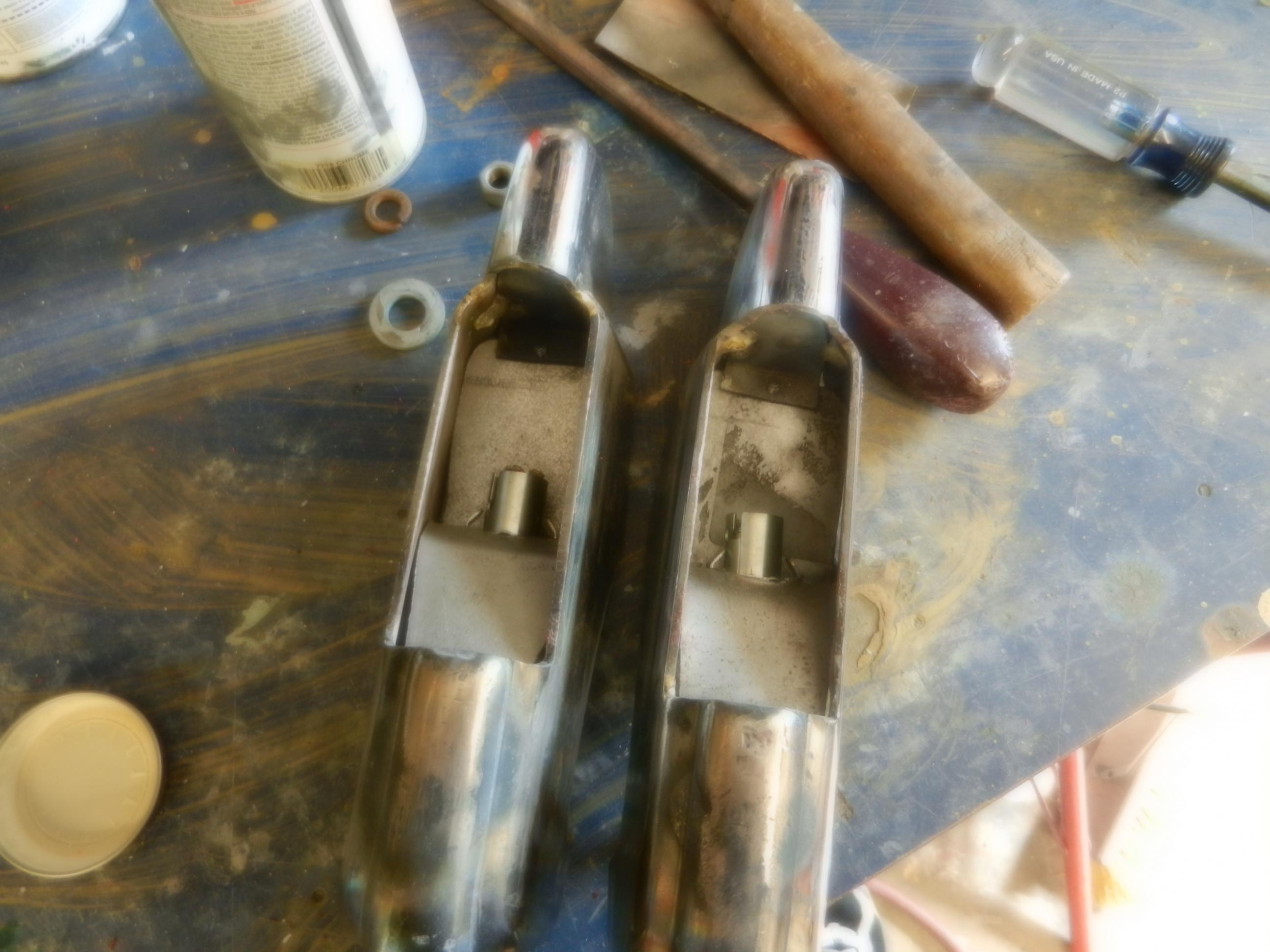

    I was looking for a rear gravel shield when I found an ad for some '46-'48 Ford parts in Arizona. On the other end of the phone was a very nice guy named George Beluscsak, a custom metal guy that I'd heard of before. As we talked about what I needed and what I was doing he mentioned that he too was going to do a Jesse Lopez coupe and had the grille that I needed. We agreed that most everybody was going to do Jesse's car at one time or the other and there were probably a few grille's out there that were stashed for this purpose. Anyway, we agreed on a price and the mailman brought this nice, clean grille. Thank's George, it looks like you where right about where this grille was going to end up.
      409.7 KB
      578

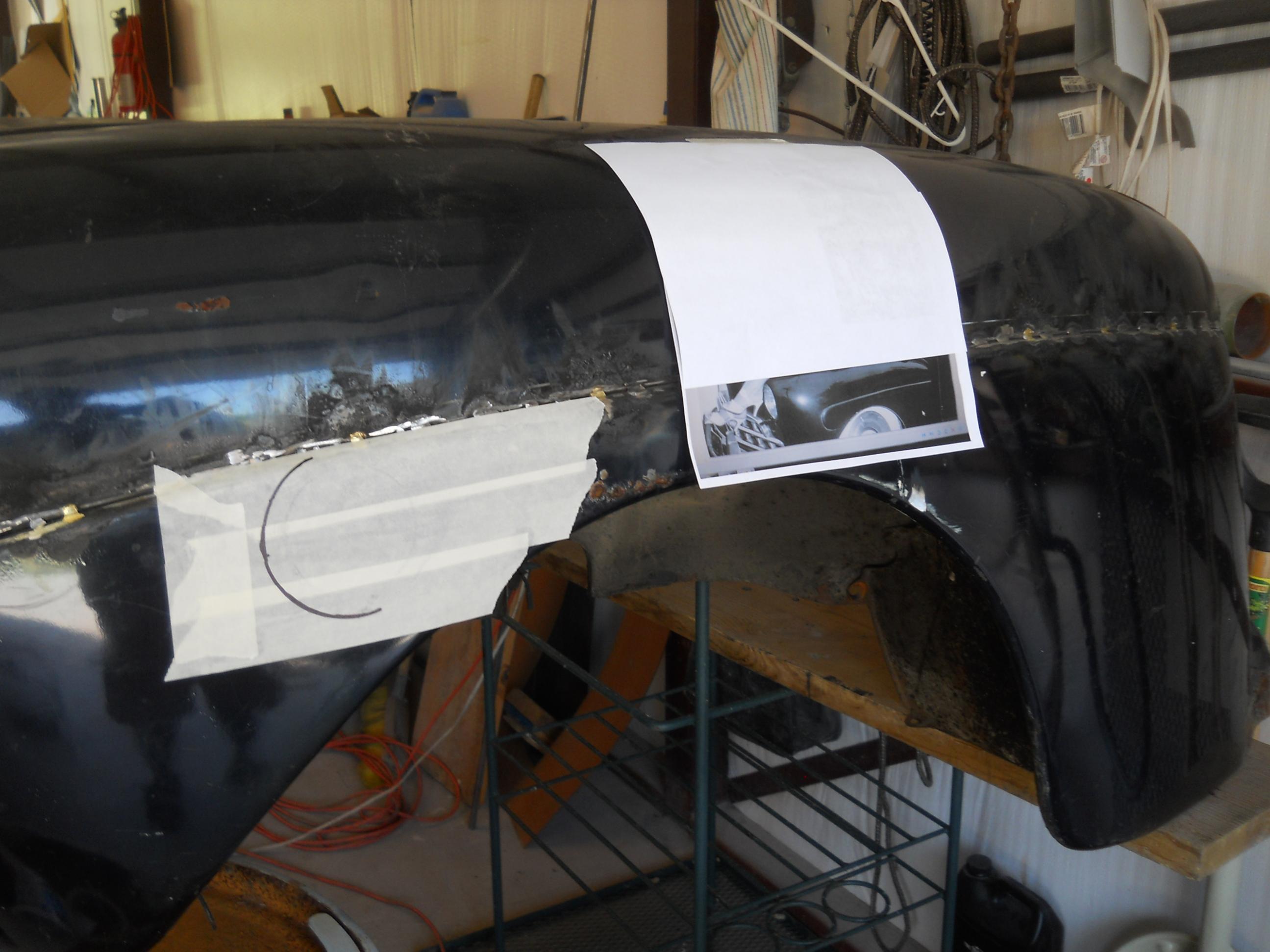

  26. jivin jer
    Posts: 3,535
    jivin jer

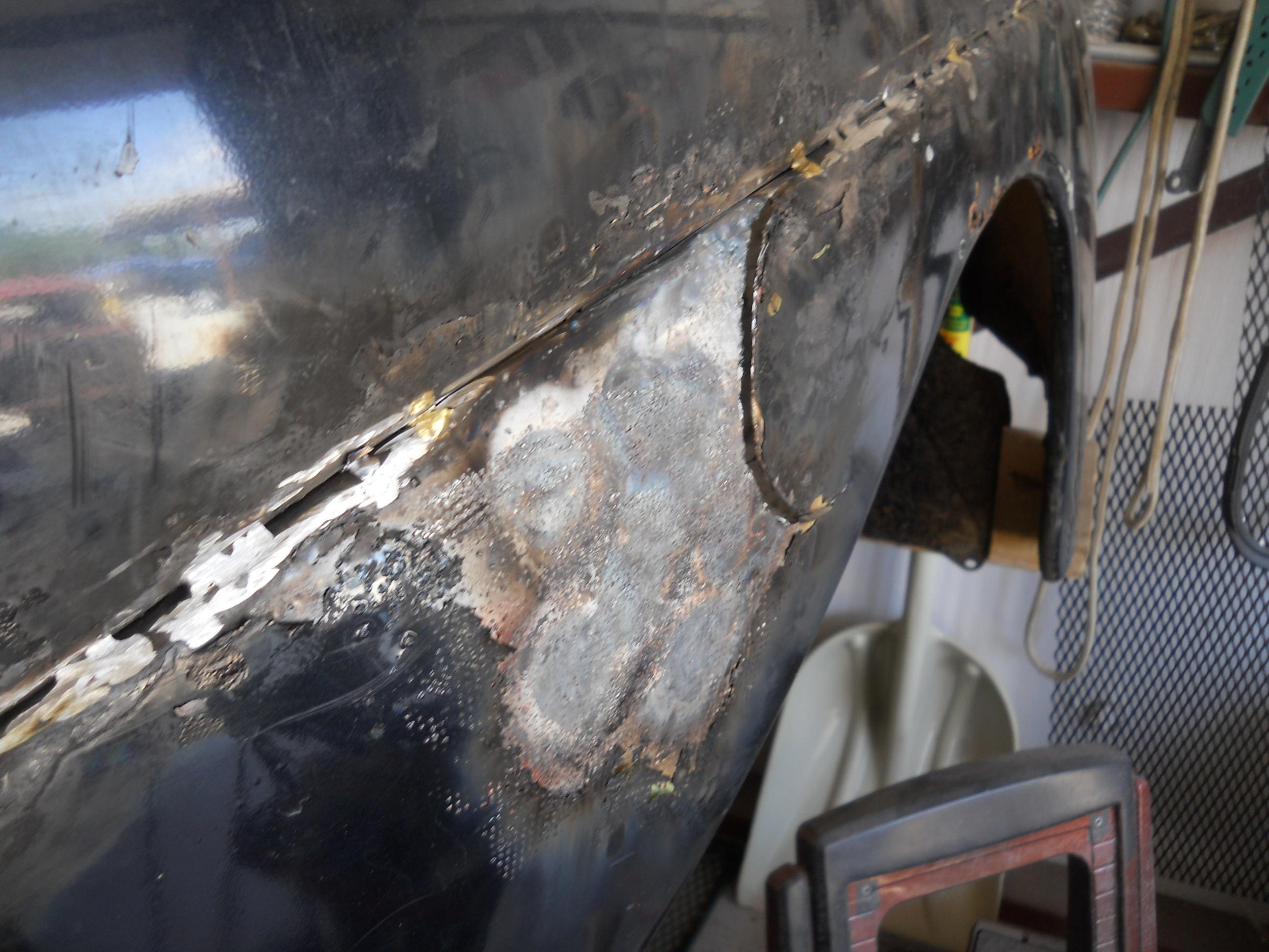

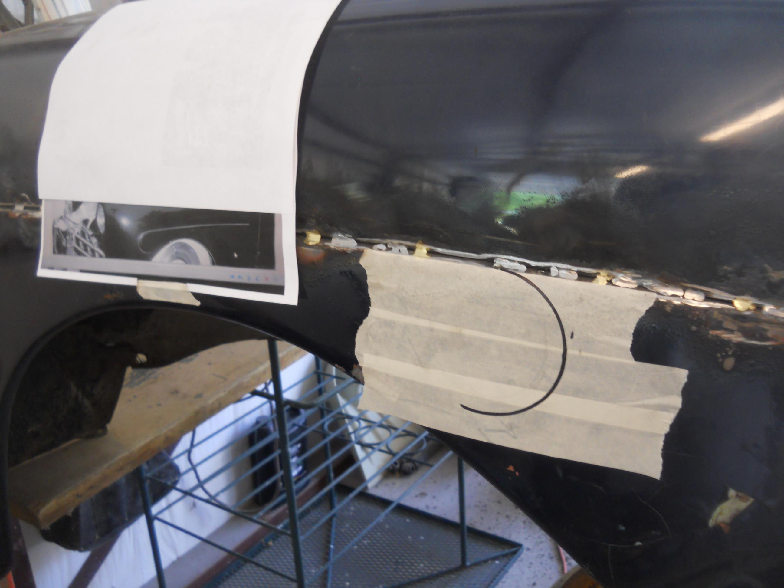

    Let's do the stylelines on the fenders. There's some confusion about '46-'48 fender's being used. We'll deal with that now.
  27. chrisman
    Joined: Jun 13, 2002
    Posts: 721
    chrisman
    This will be interesting! To me it's clear that Jesse's car used '41 fenders, but I haven't figured out whether it had that part from a '46-'48 welded in, or if it was hand-formed. My guess is welded in.
  28. jivin jer
    Posts: 3,535
    jivin jer
    The '46-'48 fender has an almost laser straight line with a long slender end. The '41 fender has a gently curved line. Jesse designed the look and Sam did it in lead. Jesse's styleline is fatter and shorter than the '46-'48 fender.
