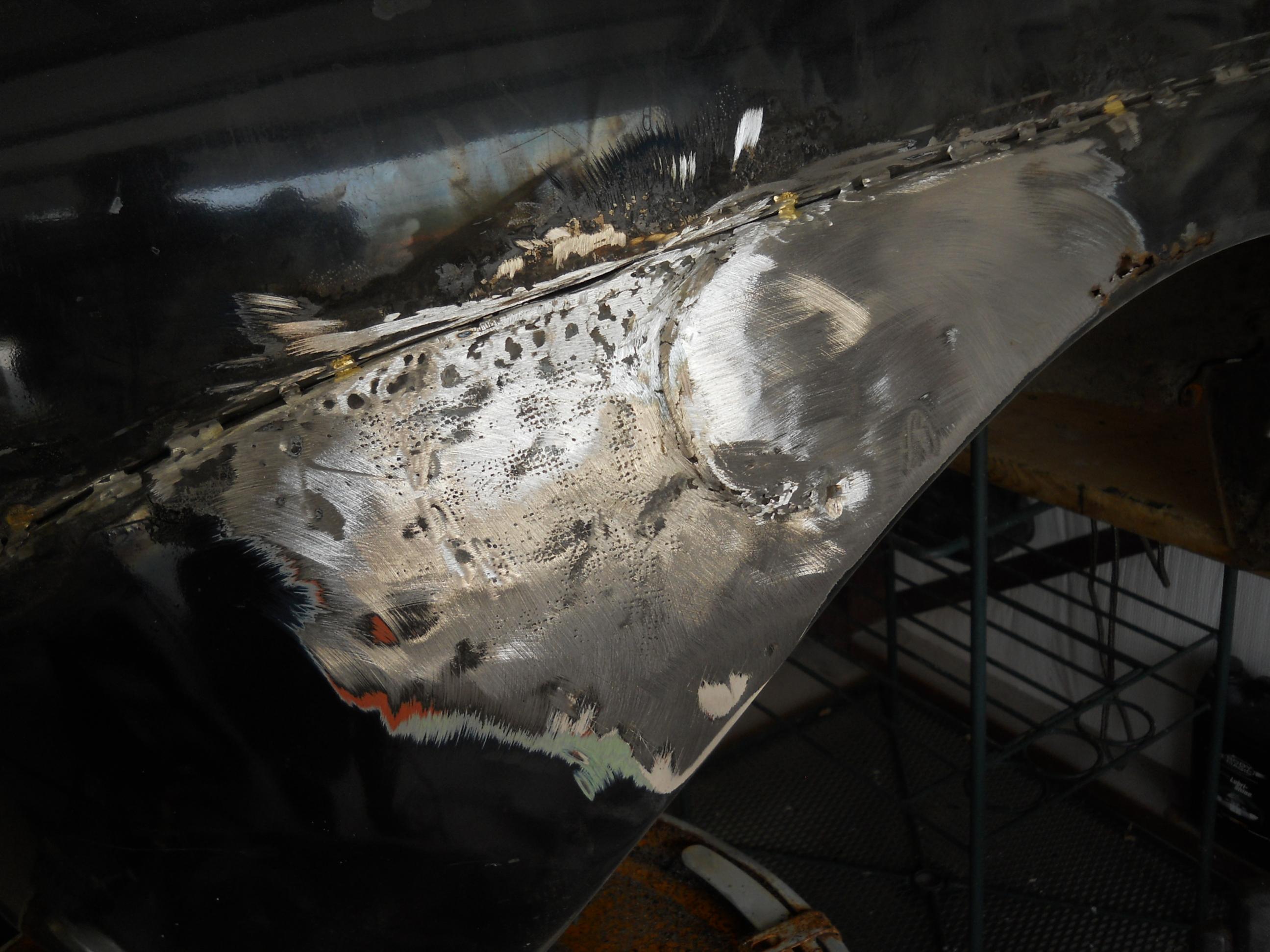

    I have really enjoyed this post, I too am building a 41 , but i am not cloning any certain car, but trying to build it as traditional as possible.I must say it is refreshing to see someone who knows the proper way to shrink metal, as you did on the front fender. nice work.

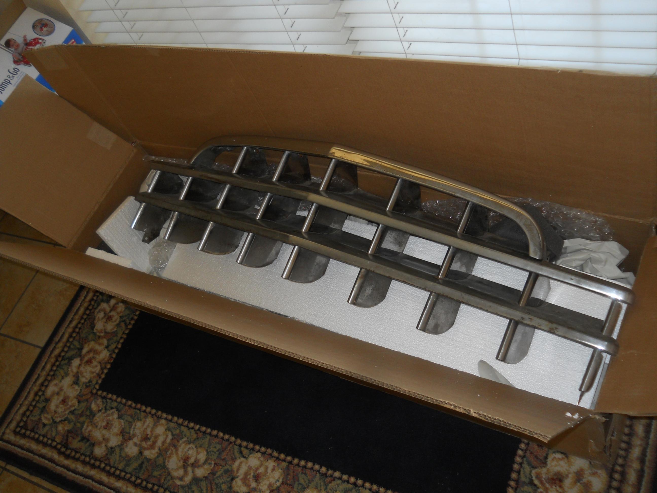

    OK, after that impulsive leap to the fender's let's get back to the grille.
  14. BrerHair
    Joined: Jan 30, 2007
    Posts: 5,137
    BrerHair
    I just find it so cool that George had the exact grille you need. Serendipity.
  15. rob-redm
    Joined: Nov 15, 2005
    Posts: 6,760
    rob-redm
    That's one sweet grille Jer !
  16. koolkemp
    Joined: May 7, 2004
    Posts: 6,006
    koolkemp
    Grille jewelery ,nice!!

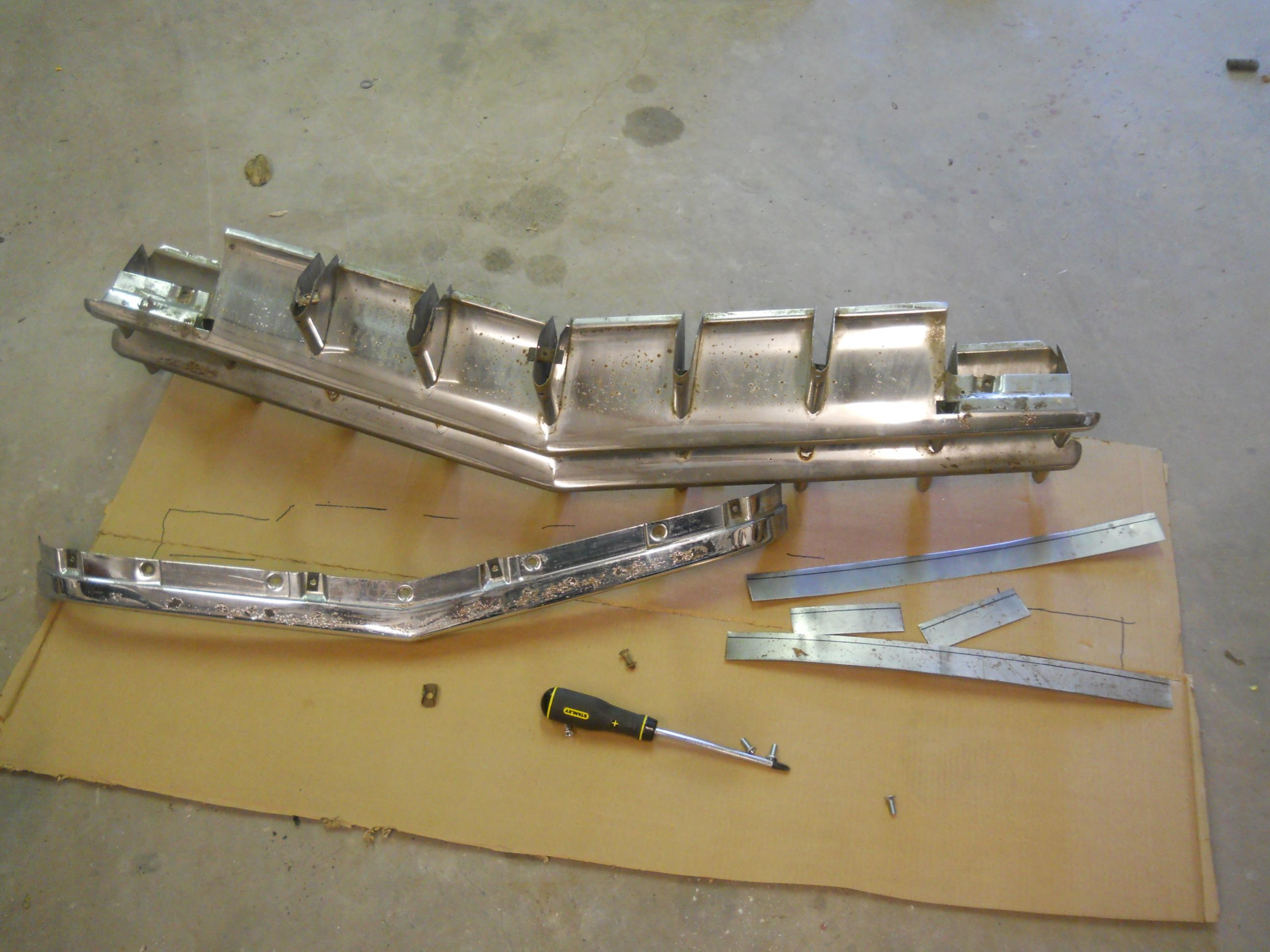

  17. jivin jer
    Joined: Sep 14, 2008
    Posts: 3,535
    jivin jer

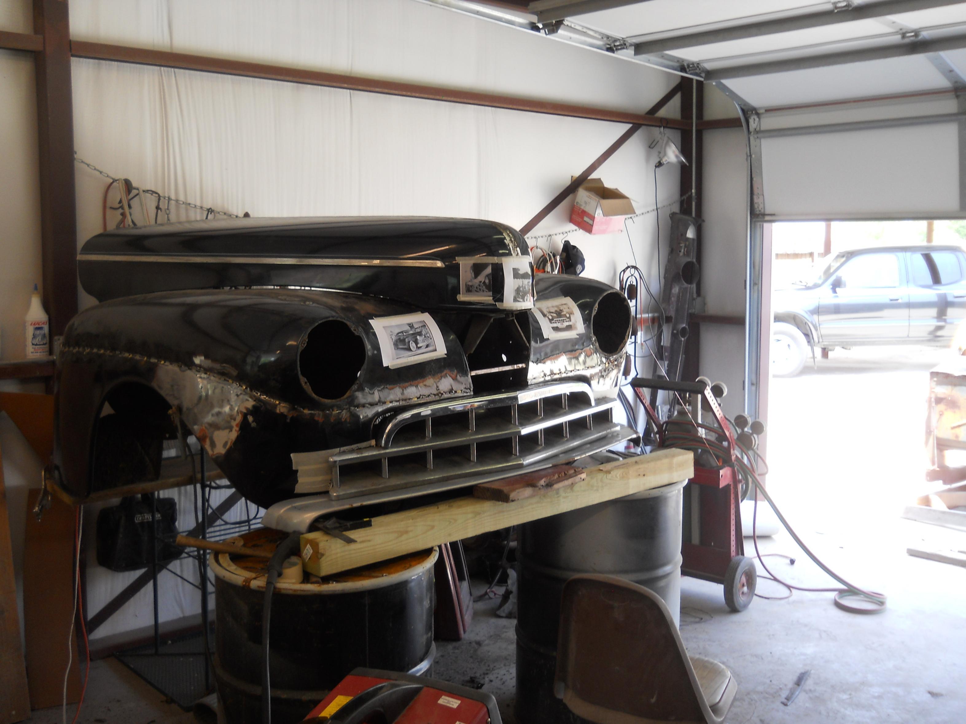

    The lower portion of the grille needs to go.
      463.8 KB
      444
      493.1 KB
      460
  18. jivin jer
    Posts: 3,535
    jivin jer
    Let's see how this is gonna' work.
      475.1 KB
      665
  19. jivin jer
    Posts: 3,535
    jivin jer
    Now I can see a little better what it want's. Easy does it, I don't want to make more work for myself than is needed.

  20. 51wagon
    Joined: Oct 1, 2008
    Posts: 169
    51wagon
    from northwoods
    I like your drum-bench. It's a great idea to get things closer to eye-level in order to work on them and this is a clever use of objects found in the garage to make an elevated work space.
    ______________________
    No good deed goes unpunished.

  22. jivin jer
    Posts: 3,535
    jivin jer
    For some strange reason this type of arrangement is becomeing more important as time p***es. Some thing is going on.

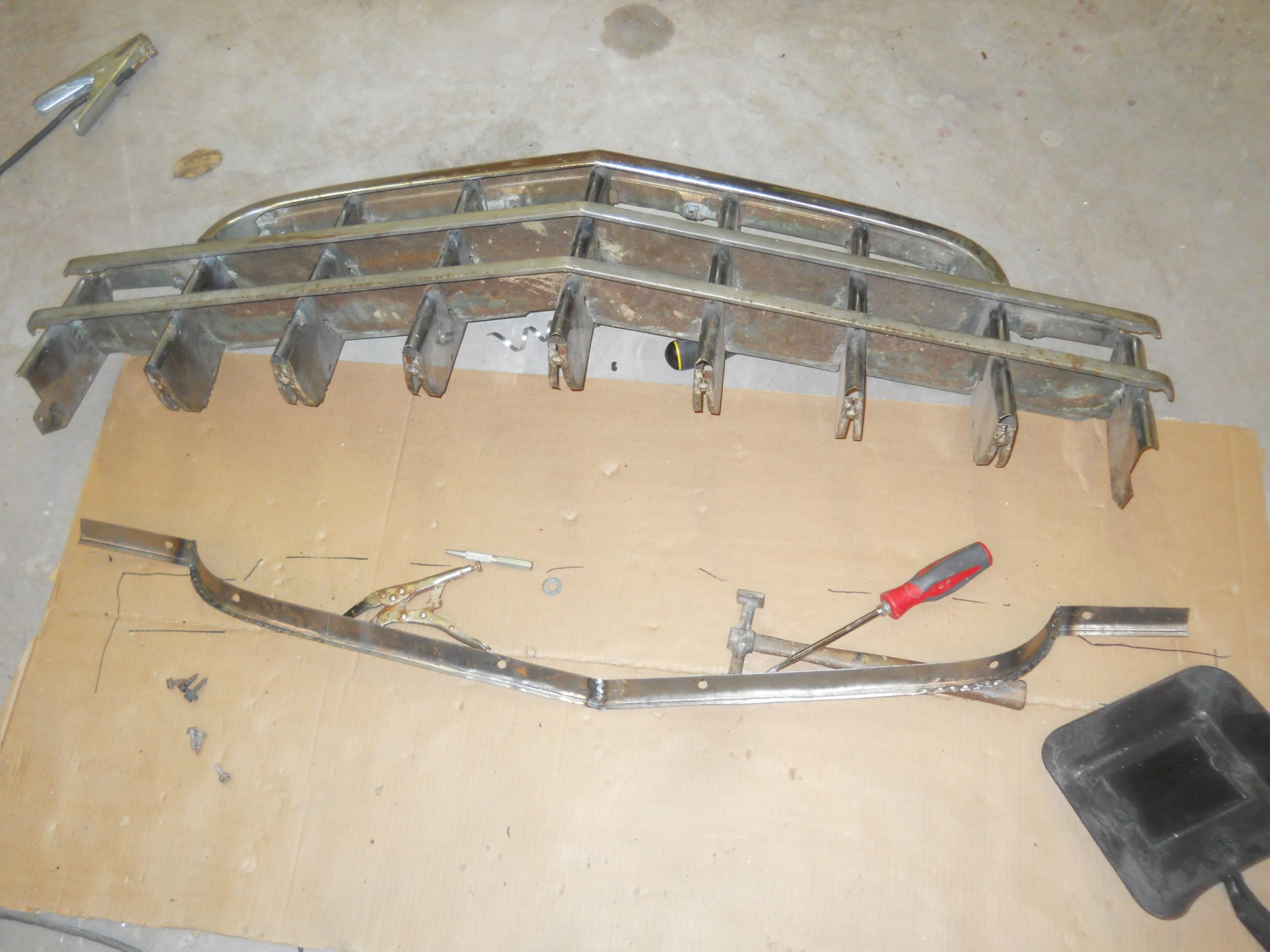

  25. jivin jer
    Posts: 3,535
    jivin jer
    I'm going to have make a frame that mimic's the shape of the grille opening. Today we would call it a header panel lip.
  26. MERRELL
    Joined: Nov 17, 2007
    Posts: 381
    MERRELL
    I'll be following this one!

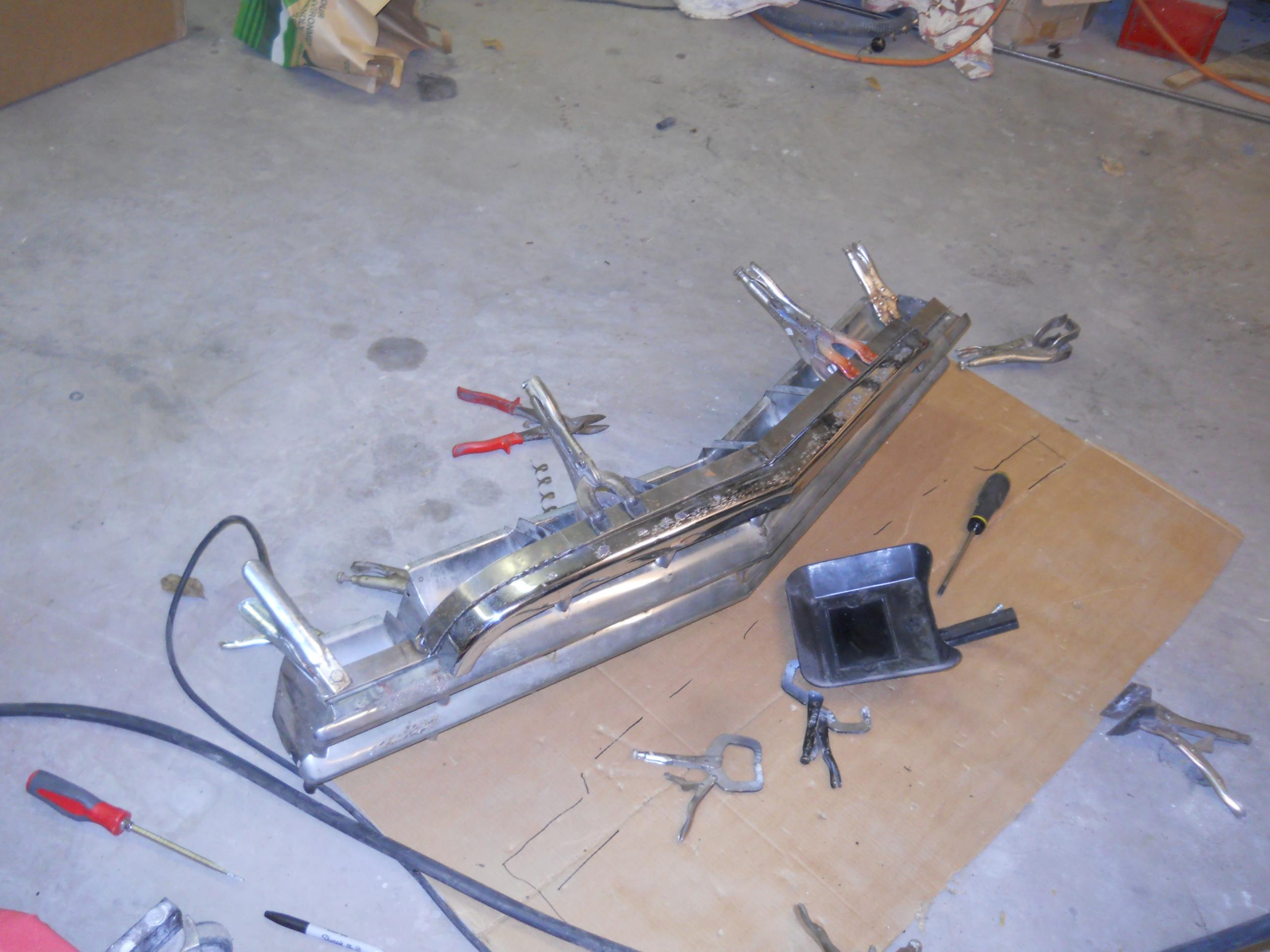

  27. jivin jer
    Posts: 3,535
    jivin jer
    Clamped and welded.
  28. James D
    Joined: Feb 8, 2007
    Posts: 5,133
    James D
    THis is getting good.

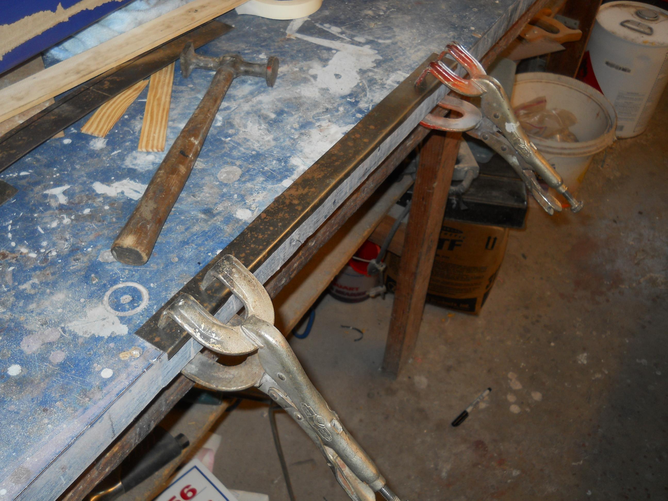

  29. jivin jer
    Posts: 3,535
    jivin jer
    Here are the piece's being formed in the vice and on the bench. Here is the completed lip. It will be welded to the metal that surround's the grille to form the grille opening.
