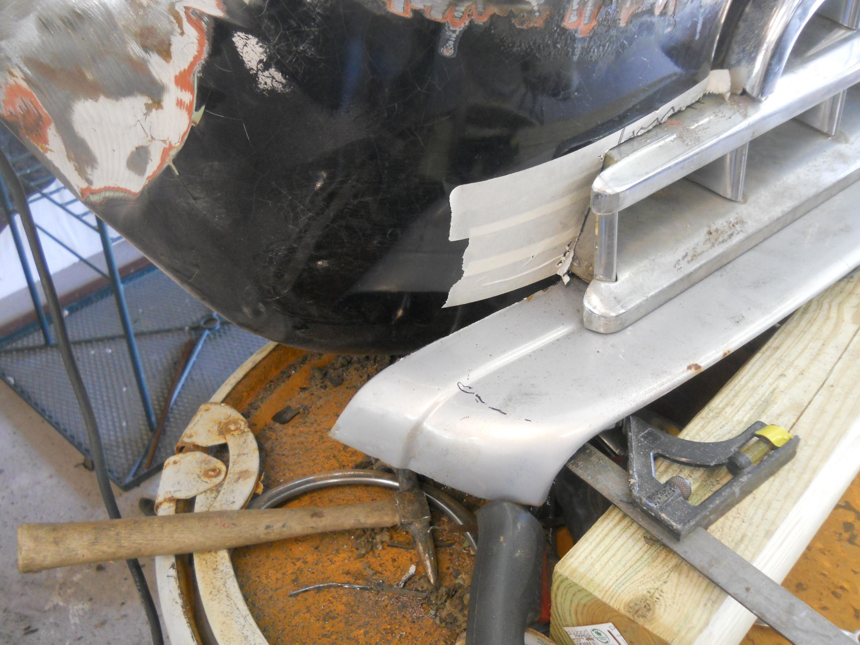

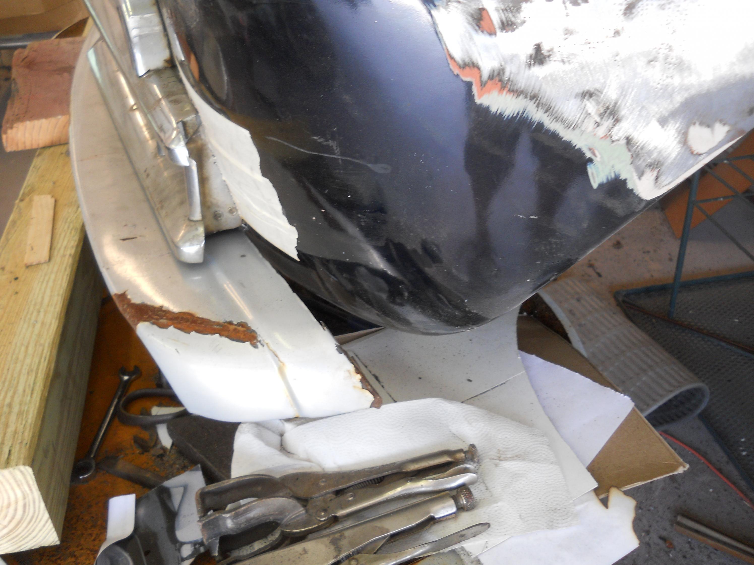

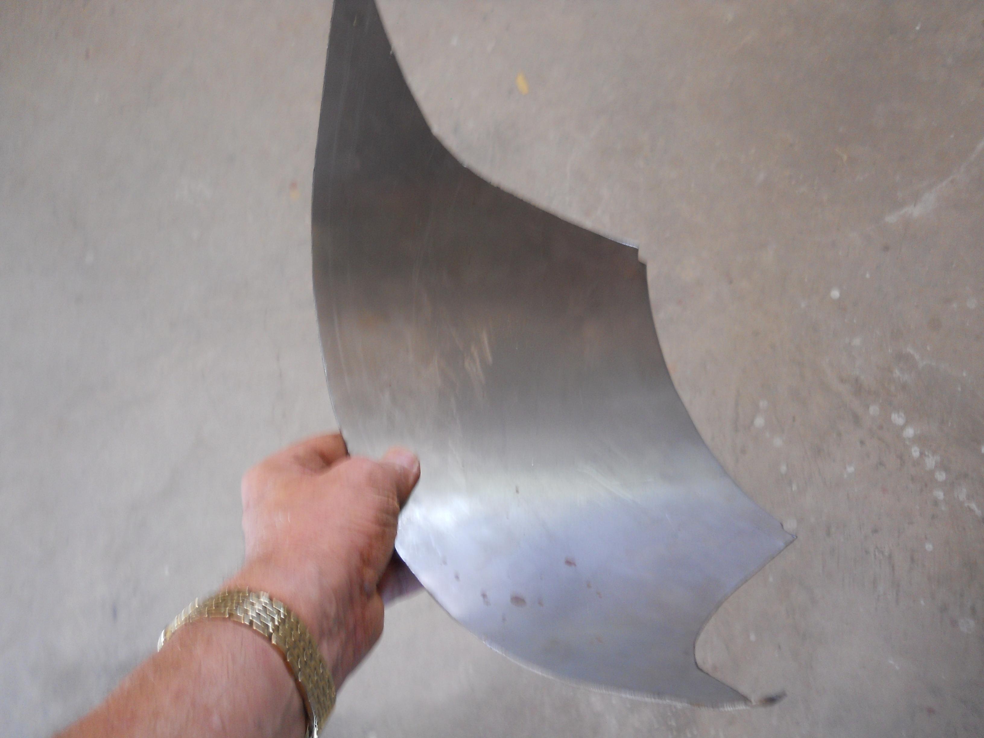

    The '48 nose has fenders that are more straight (vertical) than the '41. You can really see this when you attempt to install the front gravel deflector. It's really hangin' out/flappin' in the breeze when you hold it up where you want it to be.
    The '41 is a transition design between '40 and '42-'48 as well as on the way to the '49-'51 model's. The Ford designers are always thinking a couple of models ahead all the time.
    Anyway I had a pic of the gravel deflector fitted into the slot that I had cut in the lower fenders that I now can't find (don't tell Gramma about this). So, this is the one showing that I had to narrow it down to be more compatible to those round fenders. Later you'll see it in that slot.

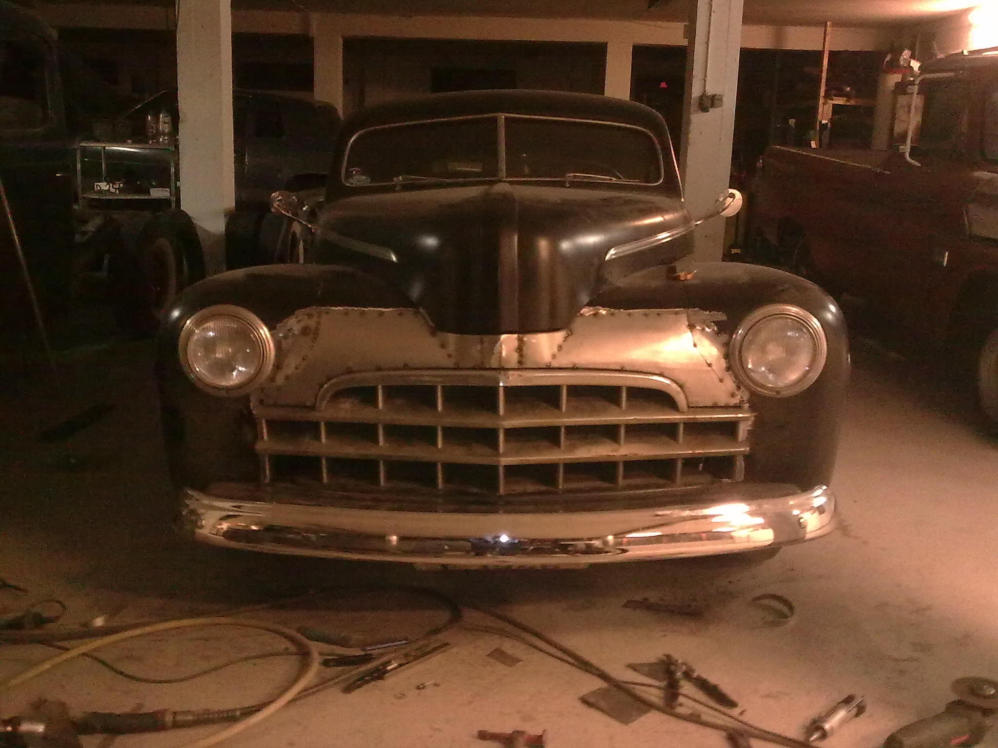

    Not only straighter but also quite a bit wider. Compare the Caddy grille on Jesse's car to how it looks on a '42-'48. Just as you say, a transition model. The fenders are a shape mix of '40 and '42. Borrowed the photo from hotrod-kennys grille thread.

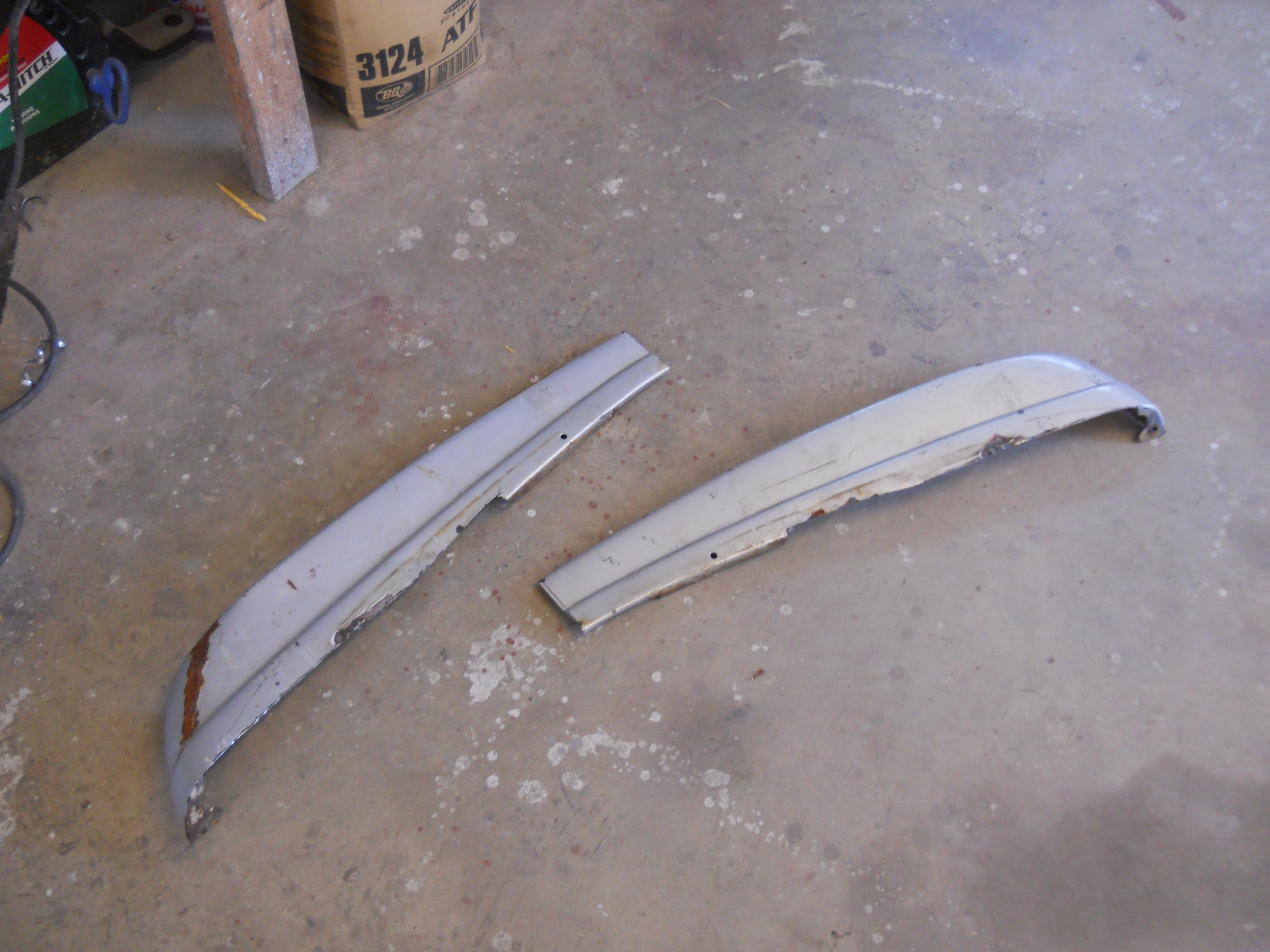

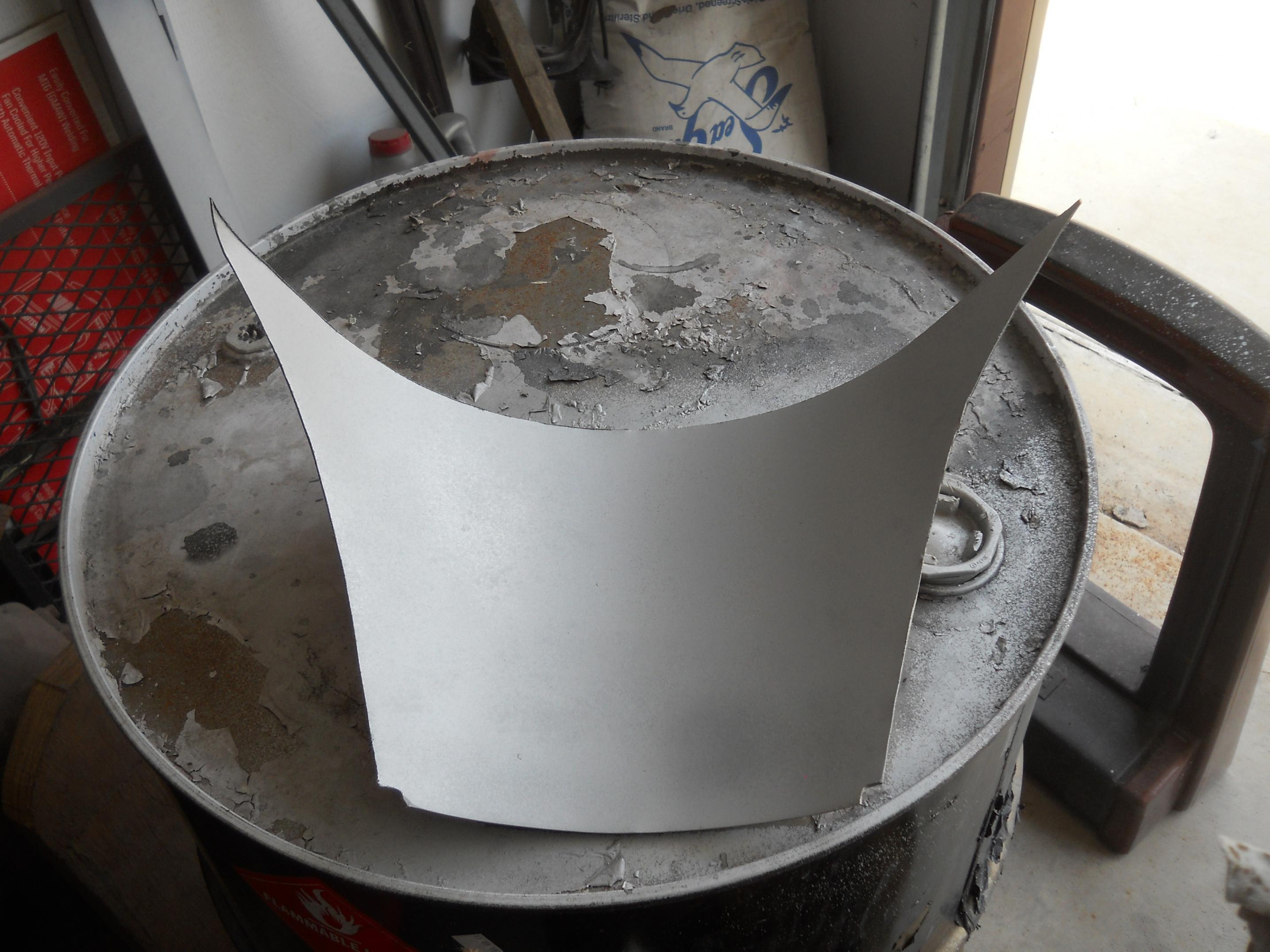

    Jesse had a aftermarket grille insert in the nose of his car. He used the upper portion when he did the grille work. Here is my interpretation of that piece. The last pic shows it with weld thru primer. Ready to be tacked in place once everything is mocked up.

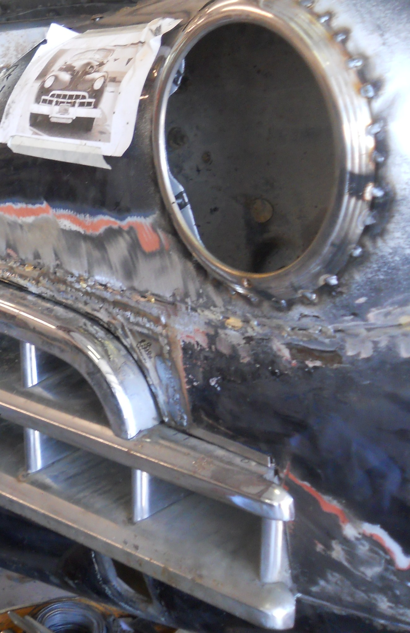

    This looks really good. The lower and center bars have a rounded return on the ends. Are you going to bring the bottom area of the fender out to meet the outer edge of those returns or will the fender run behind them a little. Any side on photos like you have taped to the hood aren't focused enough for me to see. Got the frenching going on too. Your a human dynamo!

    You've got a good eye Karl. This is the first look at a really intense part of this build. If we don't pick up on these subtleties the accuracy and appearance will be at risk. Another big reason why doing this with high tech capabilities is huge. Like Jr's car, I can't get myself in a situation where someone can say Hey! You got that wrong, look at this.
    That did happen on Jr's car with the placement of the spotlights. I caught it myself. I had to tear into the freshly painted A pillar/cowl area to fix it. It was a pain issue. Temporary if I fixed it, forever if I let it go knowing it's not right.
    The fender will run behind AND partially overlap the second bar.

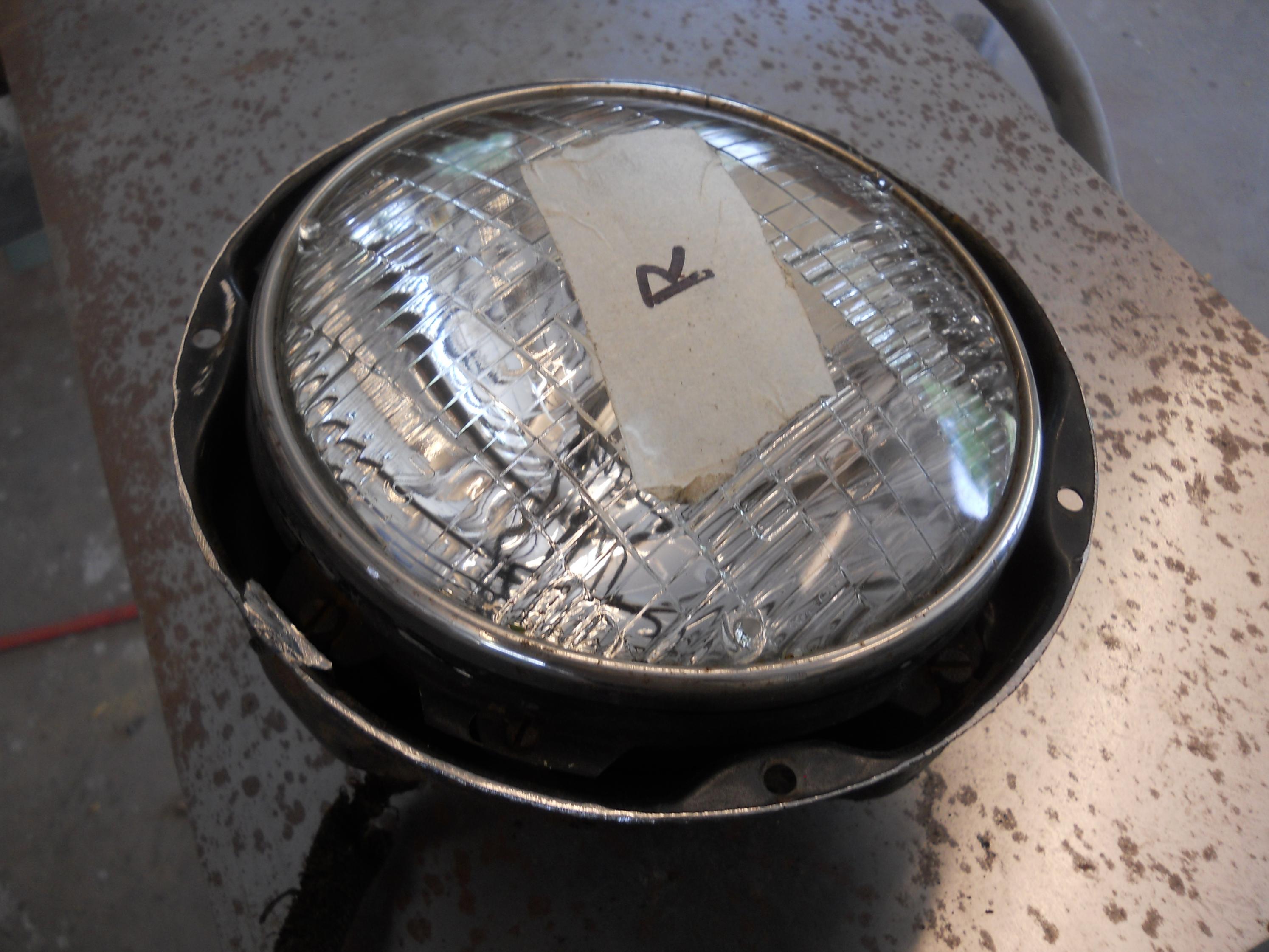

    Did somebody say frenched lights? We start here by removing the flange aroung the edge of the headlight bucket. If it's not removed the headlight sits to far back in the opening.

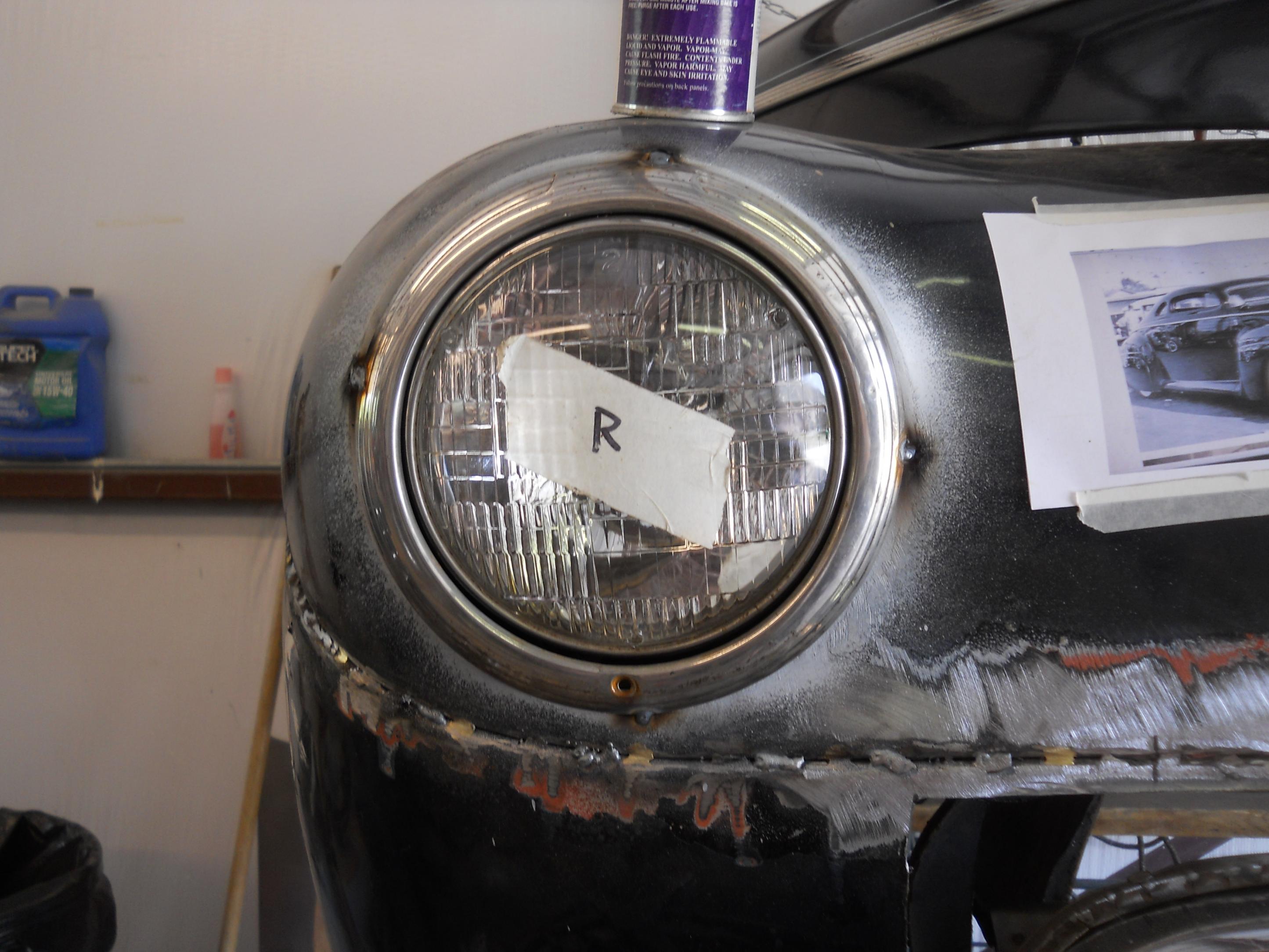

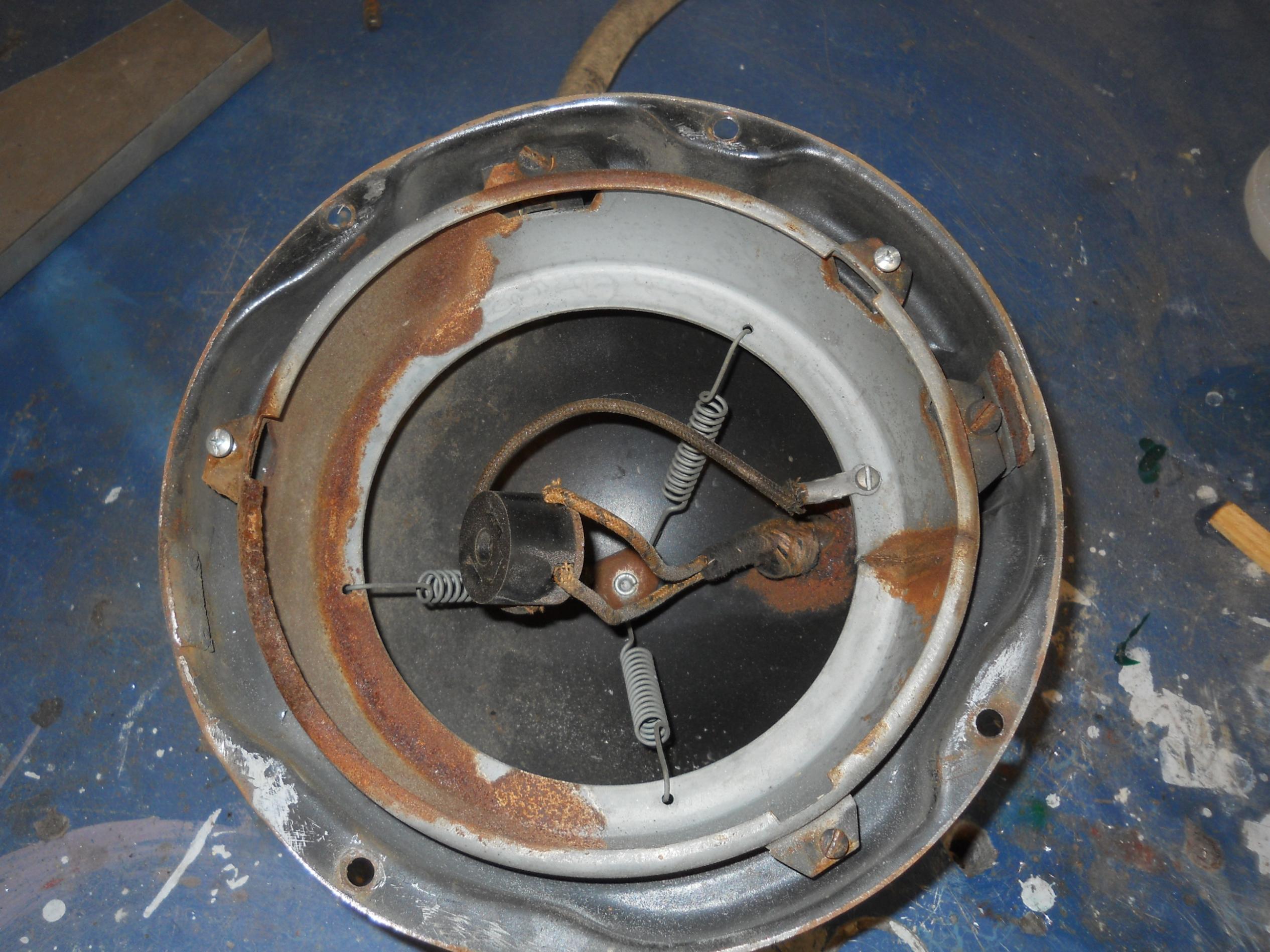

    If your going to weld your headlight rings to the fender you have to do something to the headlight ***embly or you'll never change a headlight bulb again. Here you see I have the ***y attaching from the backside instead of the frontside. Notice that the screw retainers are reversed. If you open up those retainer holes (just a taste) it will give you some wiggle room when matching up the ***y with the ring.

    Headlight ring is carefully aligned with h/l ***y and then tacked in place.

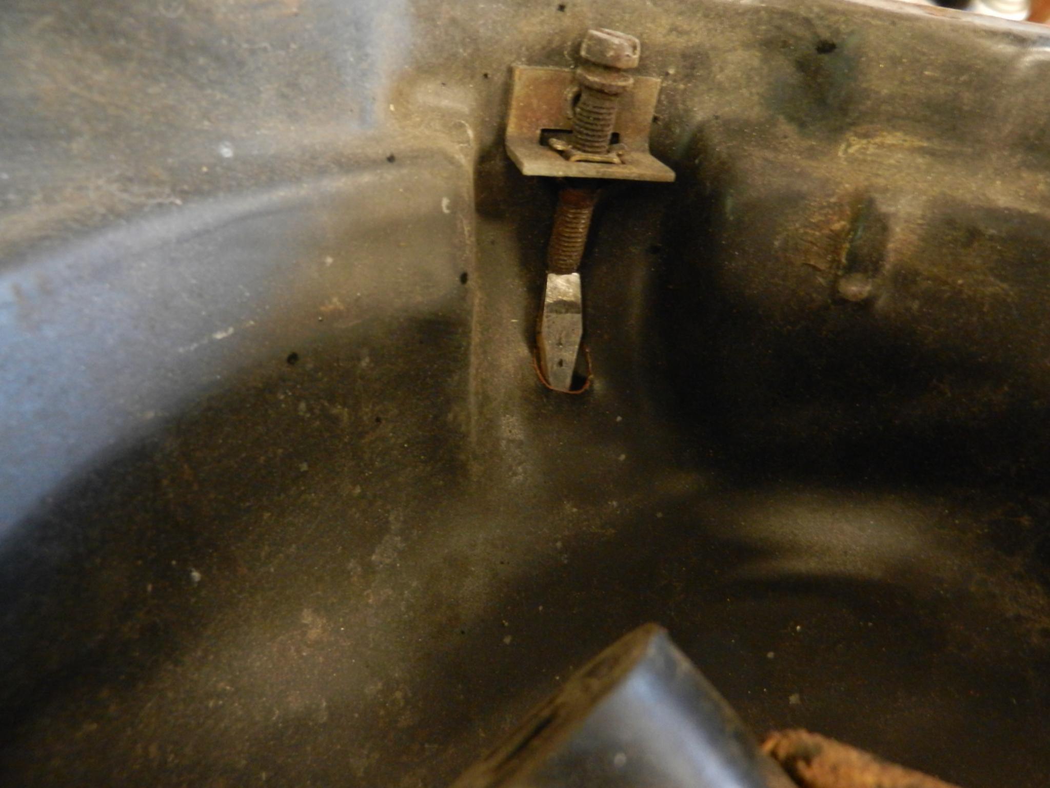

    Kustom orthodoxy (the little mags) has it that you notch the adjuster screws on the back side. Then drill a hole for access to them on the back of the bucket. After doing this you can then adjust those light's. All very difficult because your inside the fender. These screws are a lot stiffer than I remember because of their age (so am I).
    A better solution would be to make sure that your lights are aimed correctly with the car in the stance that it's going to be and then just install the ***y from the back. After this is done you can weld the ring on.
