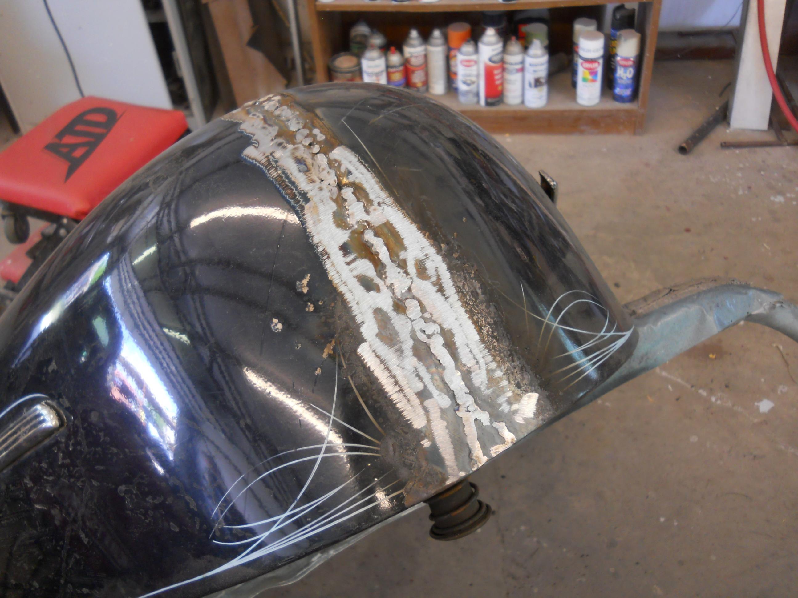

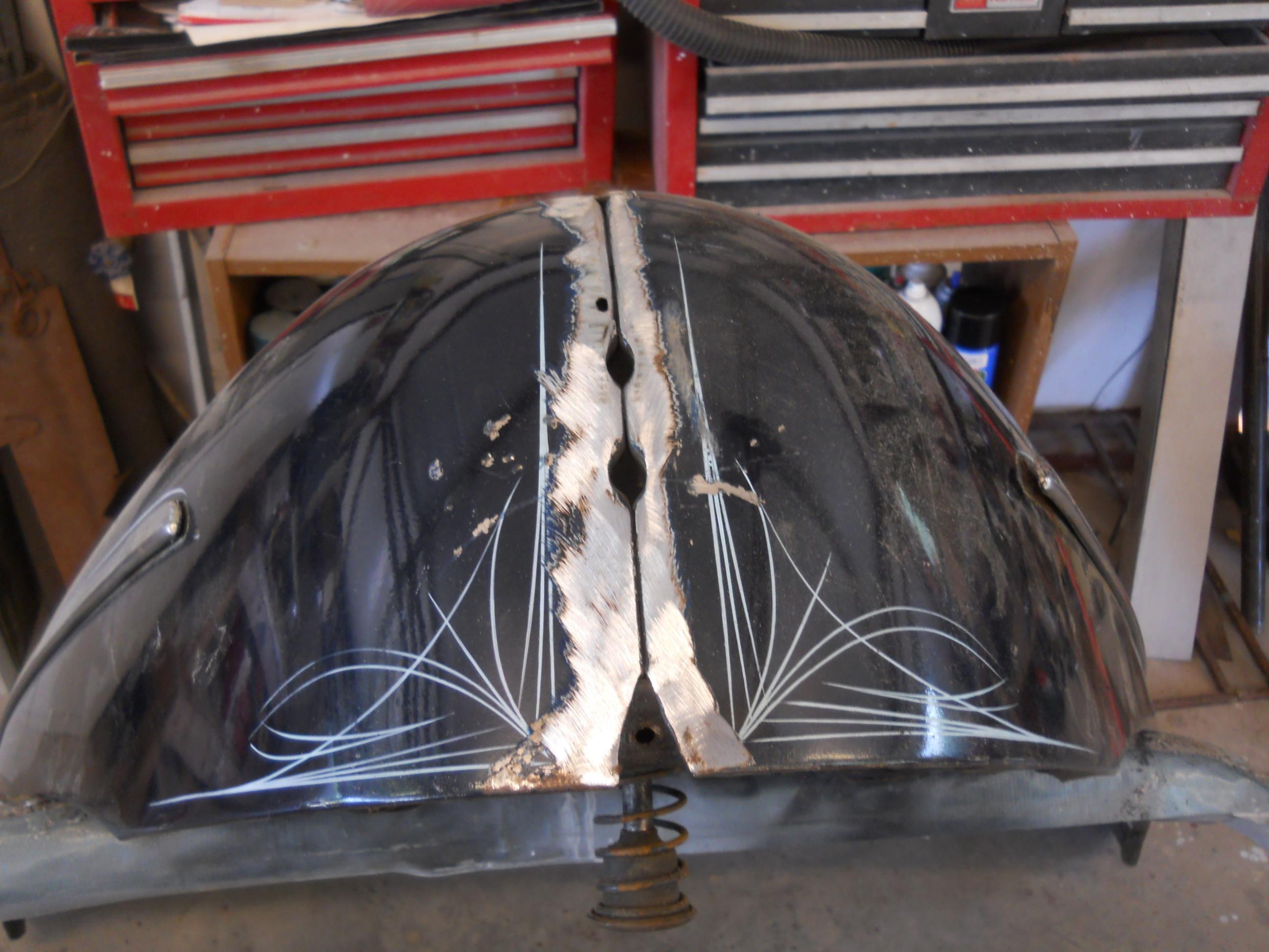

    Jer, I love it when a plan comes together. Your blending of the grille into the fenders and lower bumper valance is perfect. Will you use a little lead to finish the seams both on the grille and fenders. I was reading thru one of my Hot Rod magazines from 1950 and saw that 41 Ford accessory center grille section priced at $9.50. Also, I have done custom woodworking for years and I'm wondering how your going to work that little piece of panel molding on top of the drum into the project.
  3. jivin jer
    Joined: Sep 14, 2008
    Posts: 3,535
    jivin jer
    Hang on with the lead. Right now I'm thinking of using that mldg to poke out one of your eye's. Your causin' too much trouble. Then again, maybe not.

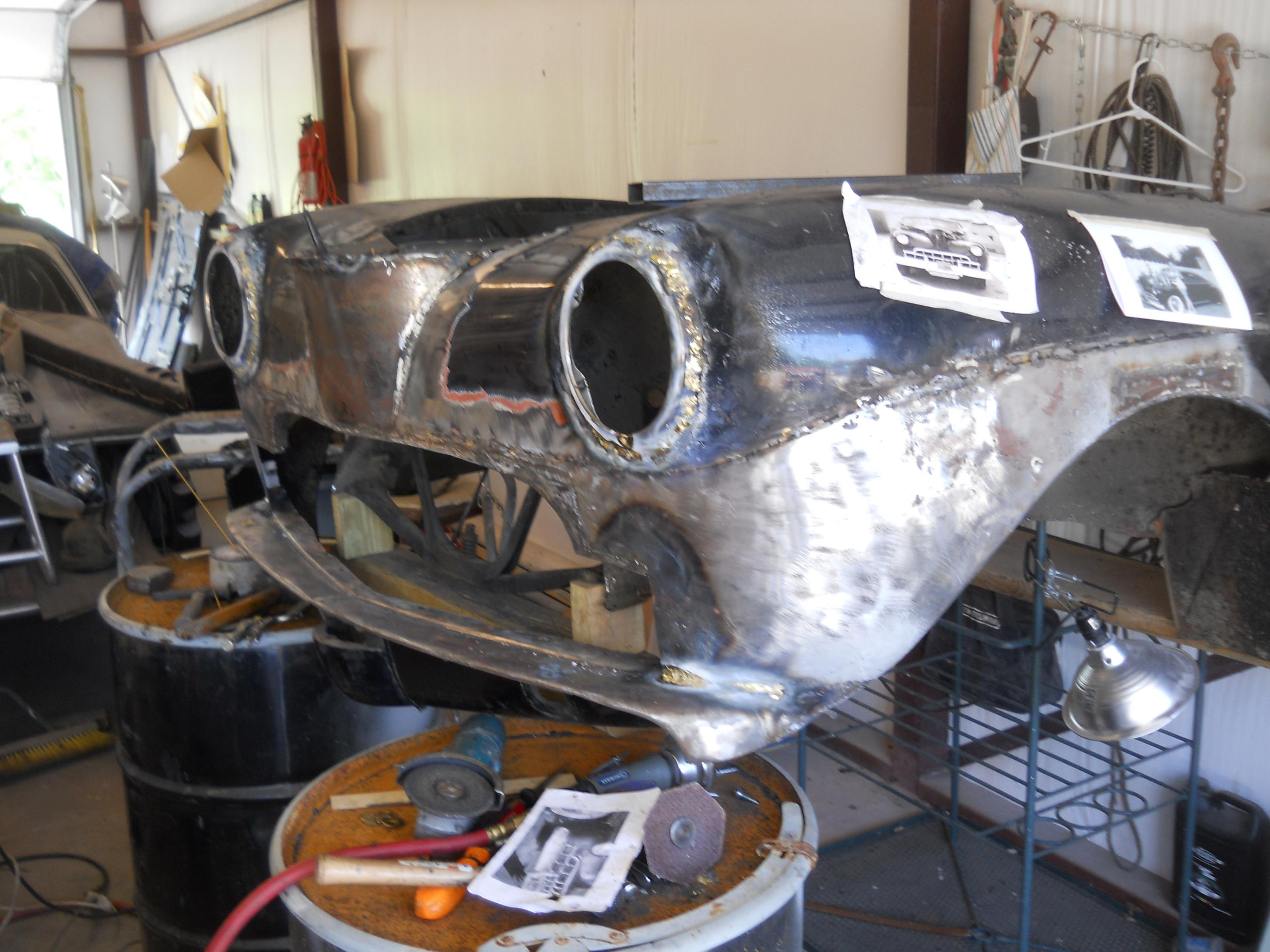

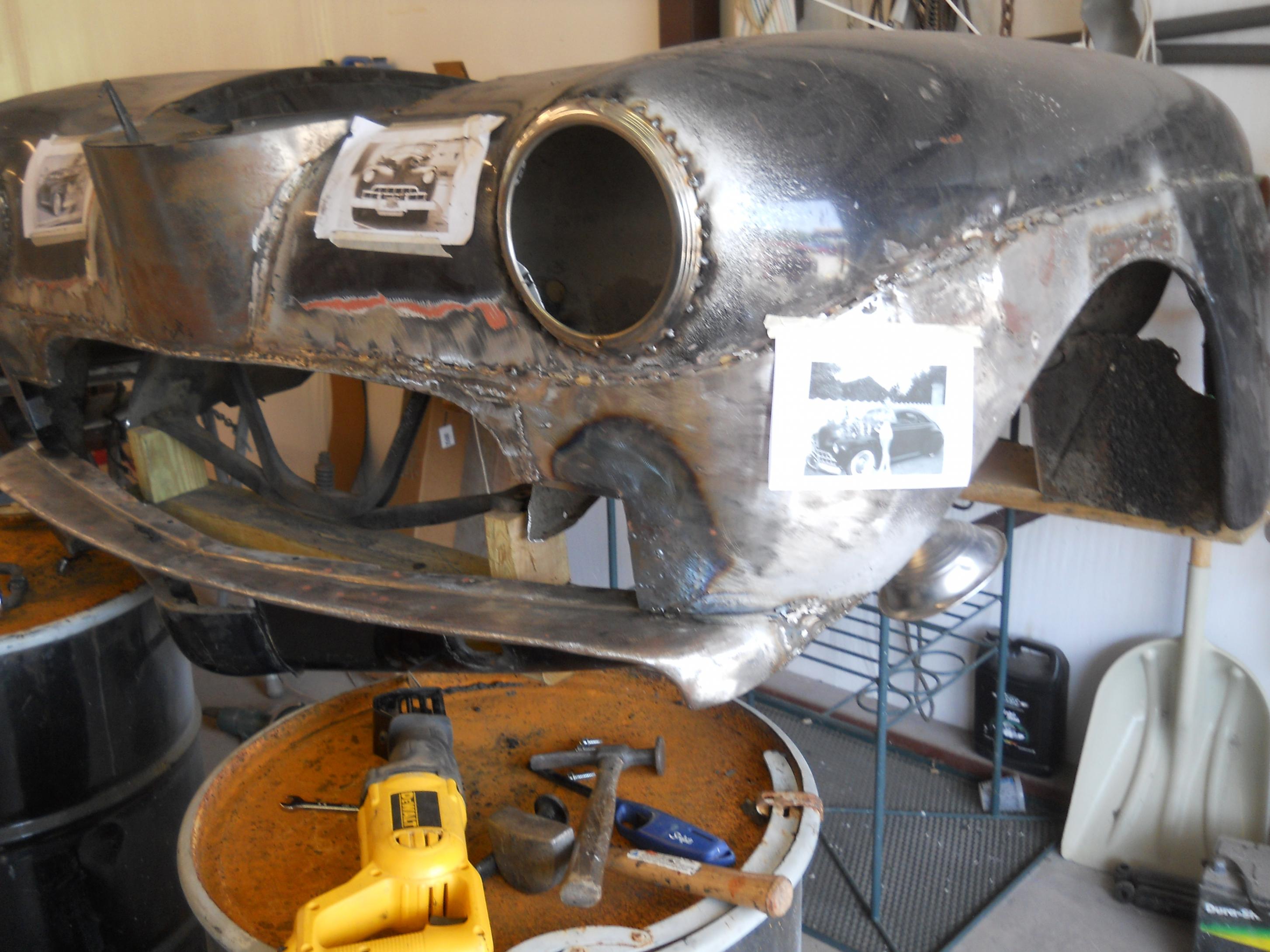

    Jer, just noticed the stock "chin" that fits under the stock grille. Looks like the bumper will hide it, so does it stay or does it go?
  9. jivin jer
    Posts: 3,535
    jivin jer
    Thinking that "the guys" would have left it, it stays.

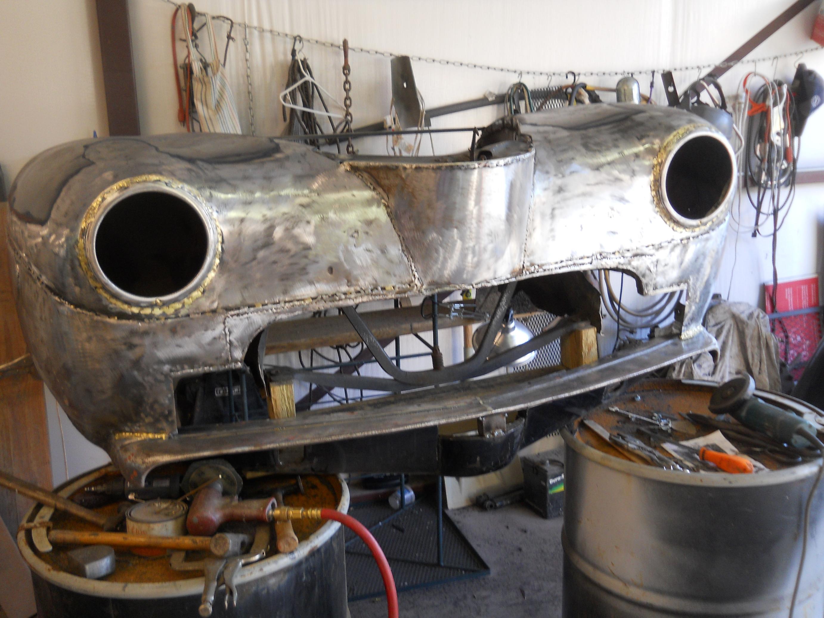

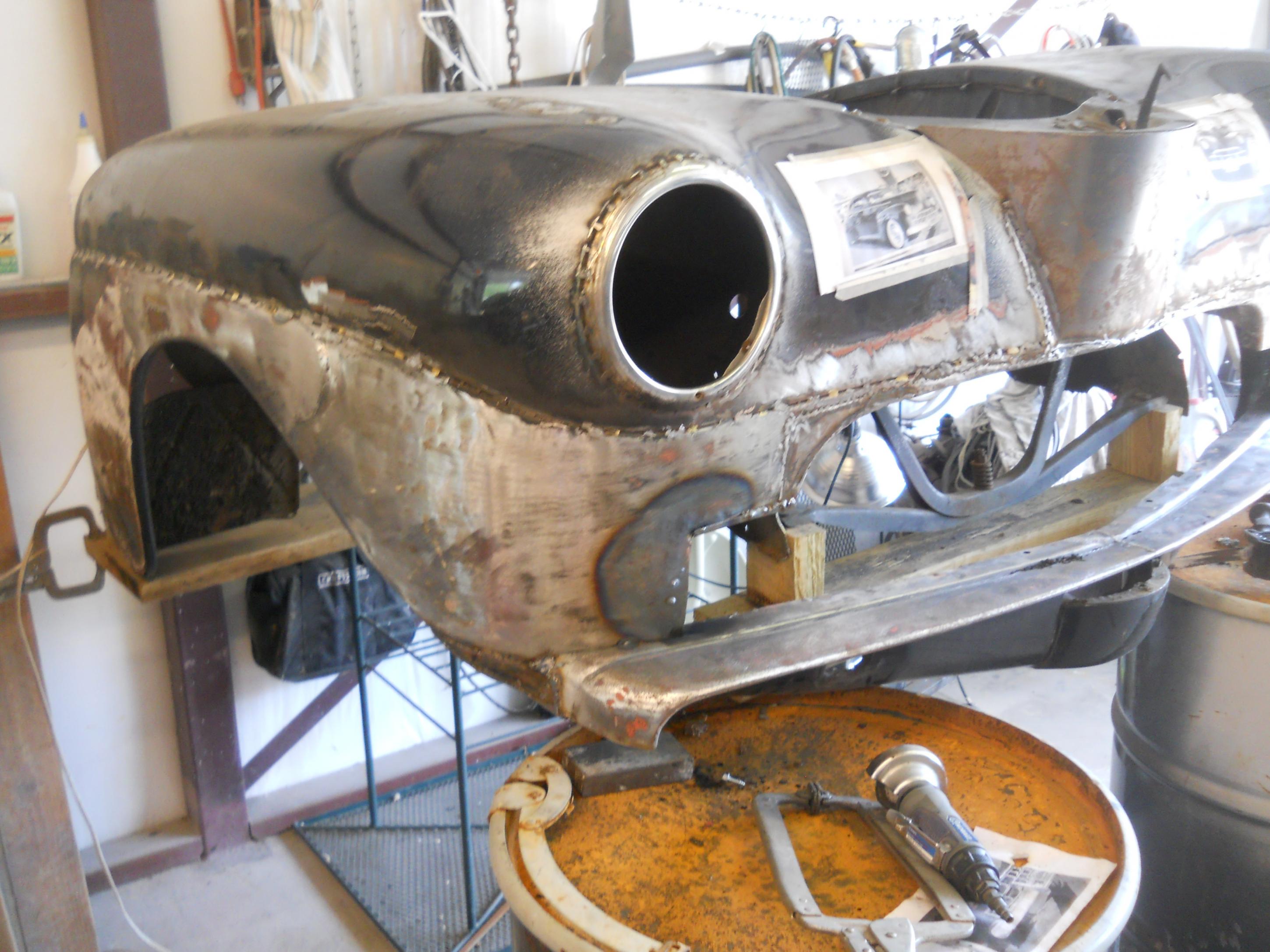

    For the sake of tradition I put a little br*** on it.
  20. Karl stark
    Joined: Nov 12, 2008
    Posts: 166
    Karl stark
    Jer, I too grew up with the little pages, although "grew up" might not be entirely accurate. Seems brazing was used a lot in the era when this car was originally built. Do you think that brazing was used more for areas that were considered cosmetic for lack of a better word, and welding more for strength, like sectioning and chopping. Also is less heat required for brazing so you don't have to waste time pulling your photos off the fenders?
  21. jivin jer
    Posts: 3,535
    jivin jer
    I just got back from an Oklahoma parts run, whoopie.
    The super critical areas were gas welded like the top, and the fenders. The gravel deflectors, headlight rings and stuff like that were brazed. George (Barris) had a rule in the shop regarding brazing/welding. No gaps, everything had to be welded/brazed solid. And no Karl, if I brazed all the grille/fender stuff the "photo's" would have gone ****(!).
