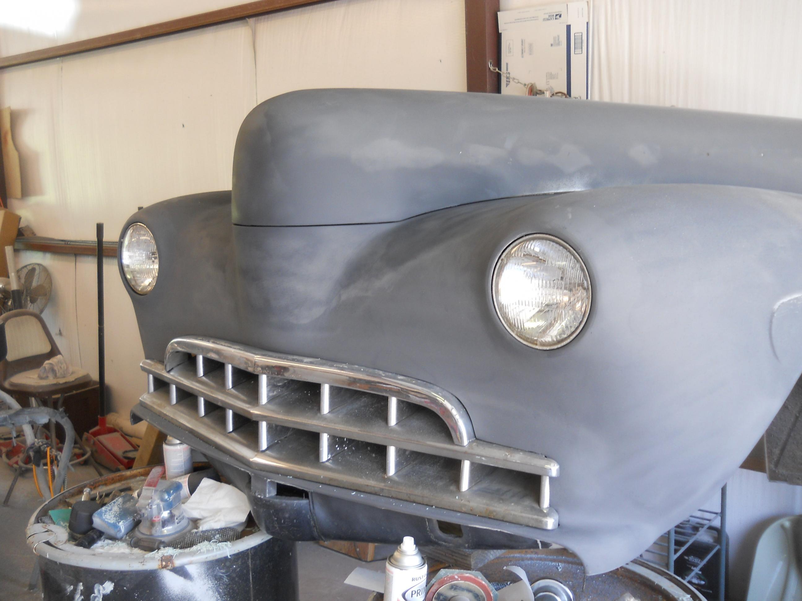

    OK, here it is in K-36. I did put a dark primer on it to simulate what Jesse used and when he saw it he said "Hey, that area above the grille didn't have that droop", WHAAAAT???

    Jer, just my take. The photo you posted showing the darker primer, looks even a little darker where you sanded and is probably what Jesee is referring to. If the section between the headlight to the upper area of the "aftermarket" 41 grille was blended in a gentle curve, it would avoid the "droop" I think Jesee is talking about.The blending wouldn't have to come forward that much so you would still have that distinctive 41 grille profile from a 3/4 view. It is very subtle but would be noticeable. The sun lit highlights of that area in the photo Tnomoldw posted do look to have a little smoother curve to me.

    Jesse is referring to the severe tuck that you see in the profile. I was aware of it as I was doing the put together and, I did ask about whether the front had been repaneled (post# 430 ), as well about the hood being cut (snubbed). His answer was no. So, I sent him some original pics with my marks on them.
    This is a problem that gets dealt with different ways depending on the preference of the owner/builder. I don't have those options with a clone (tyrant).

    You do great work, Jer! There is one thing that got me thinking though, and I hope you don't mind if I ask, but are the two grilles at slightly different heights? I know different perspectives can be deceiving, and i'd happily be proven wrong. :)

    I learned on Juniors car that you can really chase your tail around before you understand a very critical element in using old photo's to see how things look. They are all distorted. You must find an anchor and then build from it. In this case the bumper can only be in one place because of the holes for it in the lower panel. The gravel deflector then can only be one place and, the grille sits on it.
    I felt pretty good regarding the "tuck" when I found this photo. Jesse is OK also.
    This might not be the big drama after all. But I can tell you that the initial shock didn't feel very good. It's all cool now.
