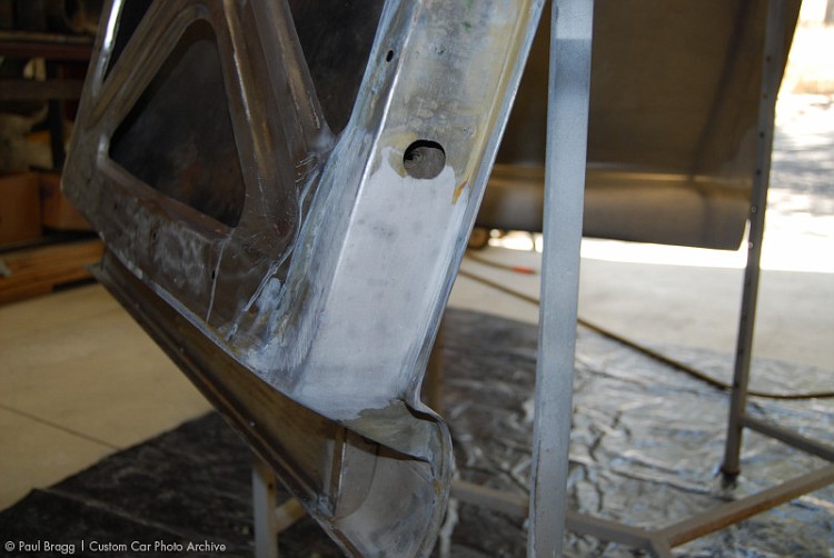

    I saw pics yesterday in a thread by Ric Hoving of detailed removing of the running boards on a 41 Ford. I sure he would be happy to post them for you.

    The 41 Ford that is in question hear is in Rickster's thread on Paul Bragg

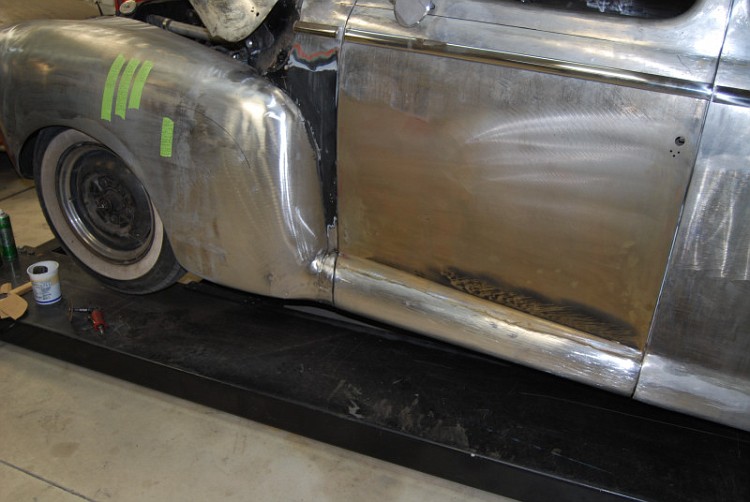

    here is the pics

    Rickster did a thread it includes 41 ford running board removal . Jer wants to know

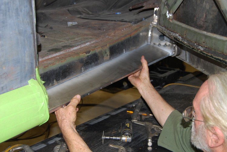

    a few more pics

    :)I my mind's eye I see a length of 1x4 tubing (available?) This looks as tricky as the grill. On down the road! :eek::D

    HOLY SMOKES! Everybody take a deep breath. While Jesse's car was more detailed than Jr's, the one thing that he left unfinished was the hole that was left after the running boards were removed. I guess in SoCal it didn't make a differance with wet streets. With the door shut there isn't a big opening. I could make a abreviated piece that could fill that gap, but it wouldn't be Jesse's car.

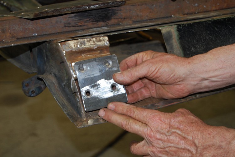

  13. phat rat
    Joined: Mar 18, 2001
    Posts: 5,159
    phat rat
    My 41 with running boards taken off. We built a box out of 16 ga from the front the rear and it's all moulded in. We started with a straight piece under the door then bent another piece to a 90 which was welded to the 1/4 and to the piece under the door. Next it was closed up in the back. Never tried it but could probably lift the car with a jack under it. I have a question. It looks as though the bottom hinge was moved down, is that right? If so why?

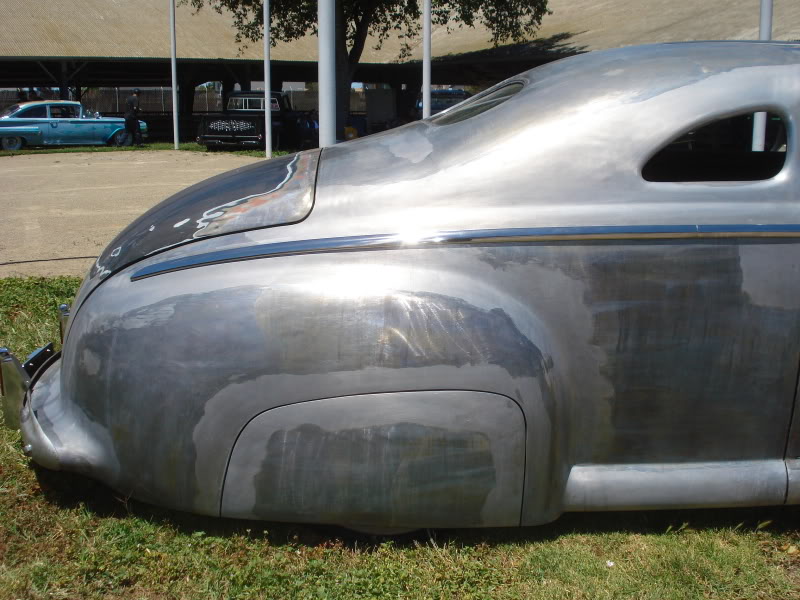

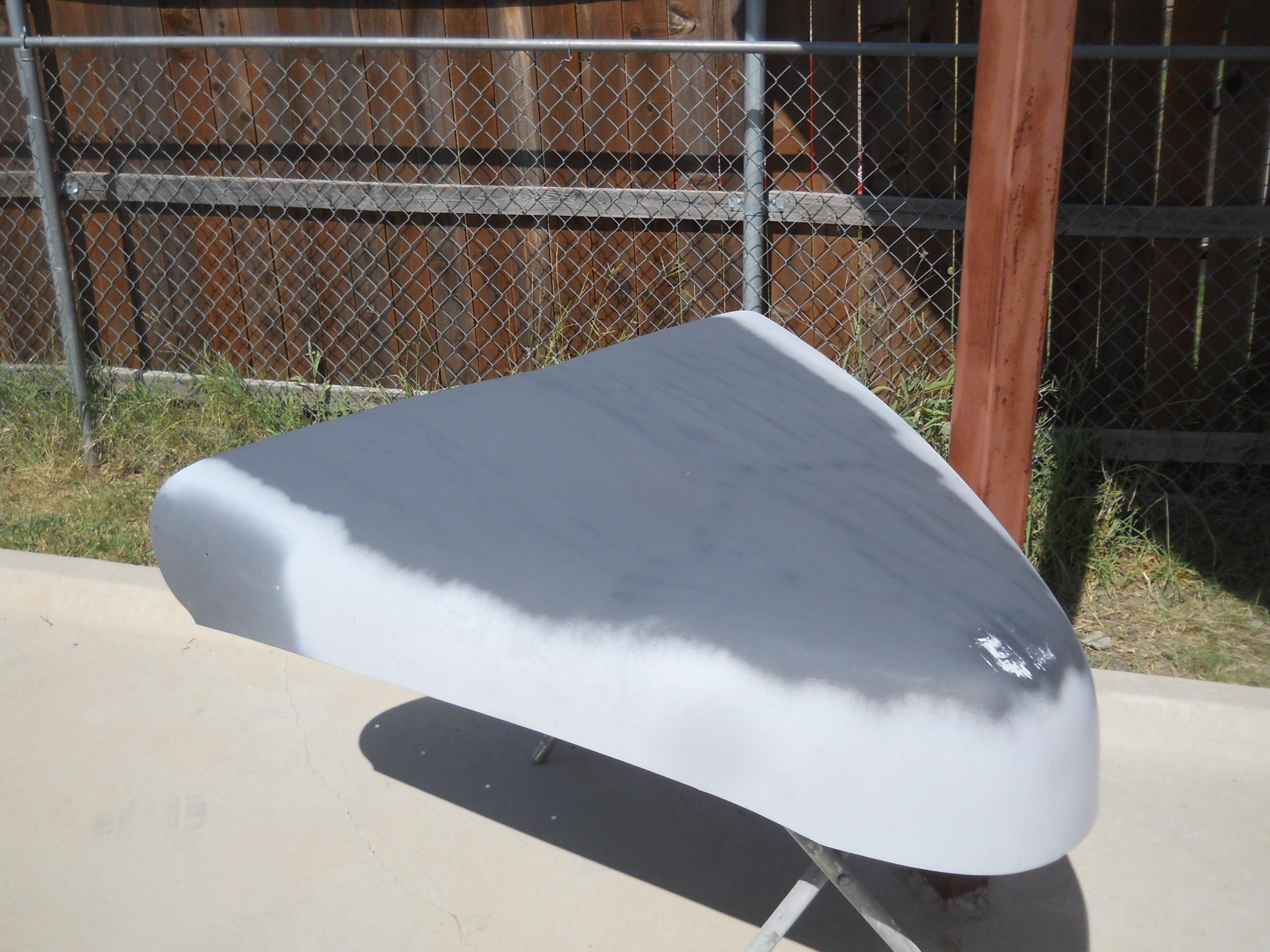

    How do you get a "soft" peak on the hood? You start with a razor sharp one, and soften it.

    :)Weld a rod in the splice grove , then fill with gl*** mix bondo? :cool::eek::D

    Yup, thats one way. In this case with some slight warpage a skim coat solved two problems with one swipe. Build up with multiple coats to get coverage. Cut everything down severley with the 9" grinder. Leaving that build up in the center.

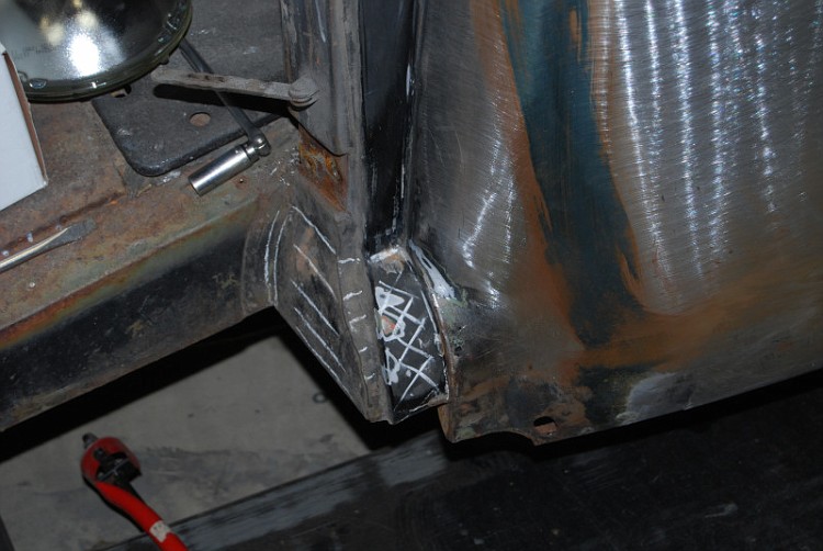

    Like Curly said, there's just one thing (when doing a lot of welding). CORROSION PROTECTION. Sometimes you have to corrosion protect your way out of a hole. That makes a HUGE differance in the longevity of these Kustom's.
