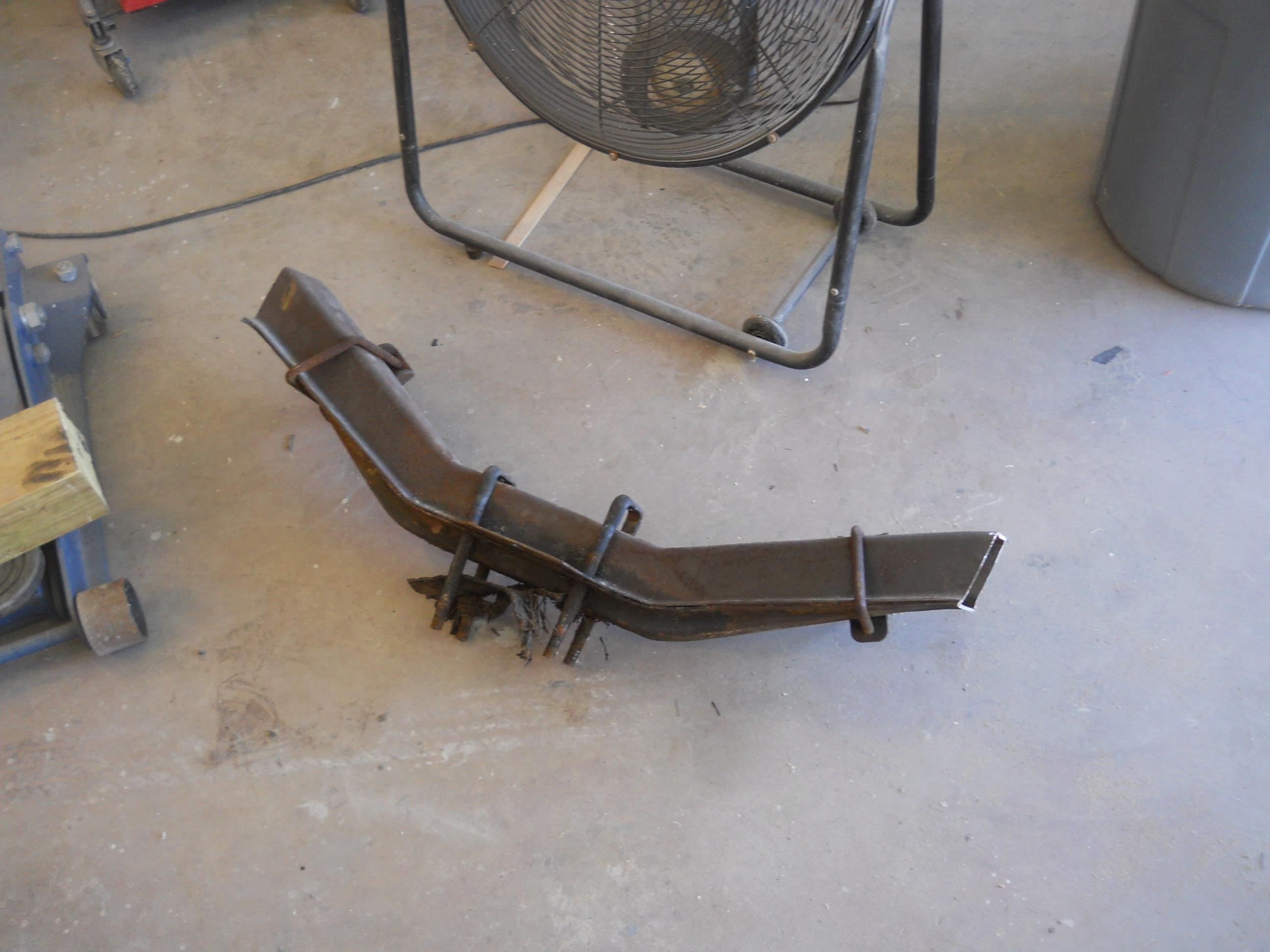

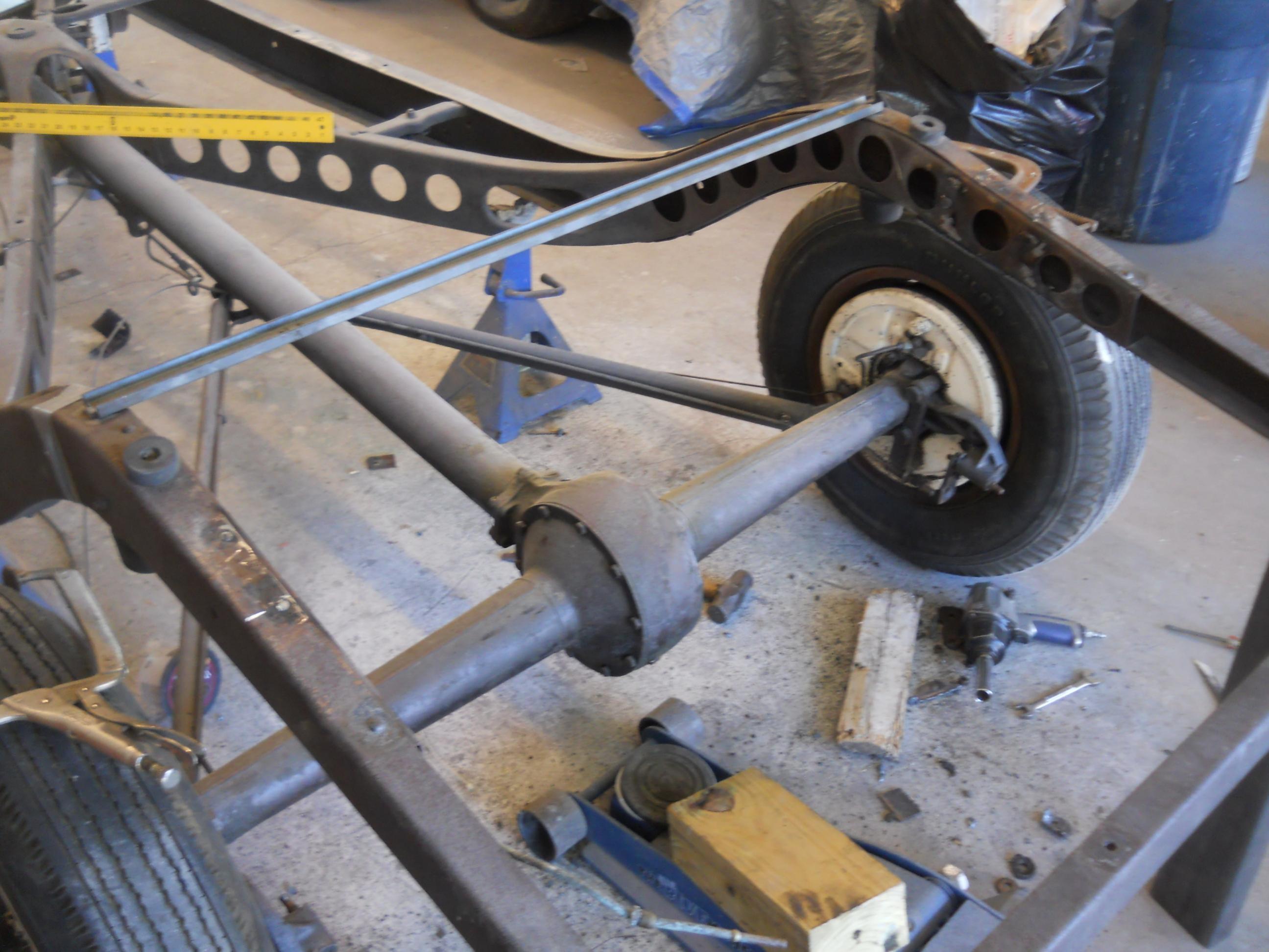

    The frame rails on this car were WAAY out of shape. It looked like floor jacks were shoved under the car without seeing where they were and pumped to the sky. I think this was a "used car lot special" that was rear ended and given a quicky paint job with some striping and hub caps and put on the front line. Look closely at post #575 and you'll see what the R side looked like.

    Truthfully I haven't seen any thing that can't be remedied so far. PITA yes,but not unusual for a car of this age. Worse case is you get a hold of some one with a frame machine to tweak it back into shape.

    The damage to the rails was floor jack related not collision related.

    Floor jack damage is most likely better than a collision:eek:
    As long as the frame hasn't been diamond shaped it should track well.
    You may be able to take some of the twist out of that x-member rail by putting a length pipe thru the holes from the outside of the rail and with some help pulling the top of the pipe towards the center of the frame..

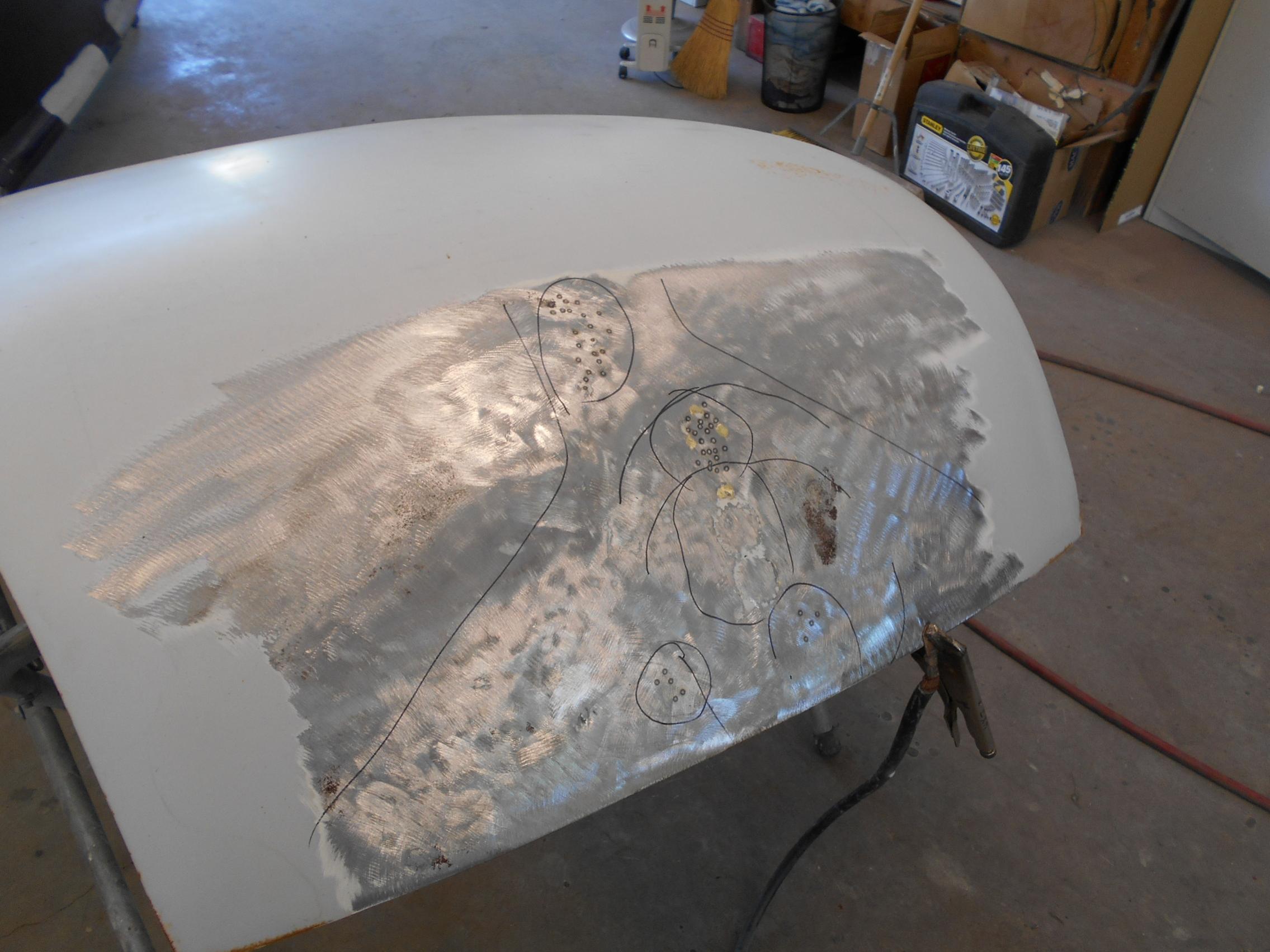

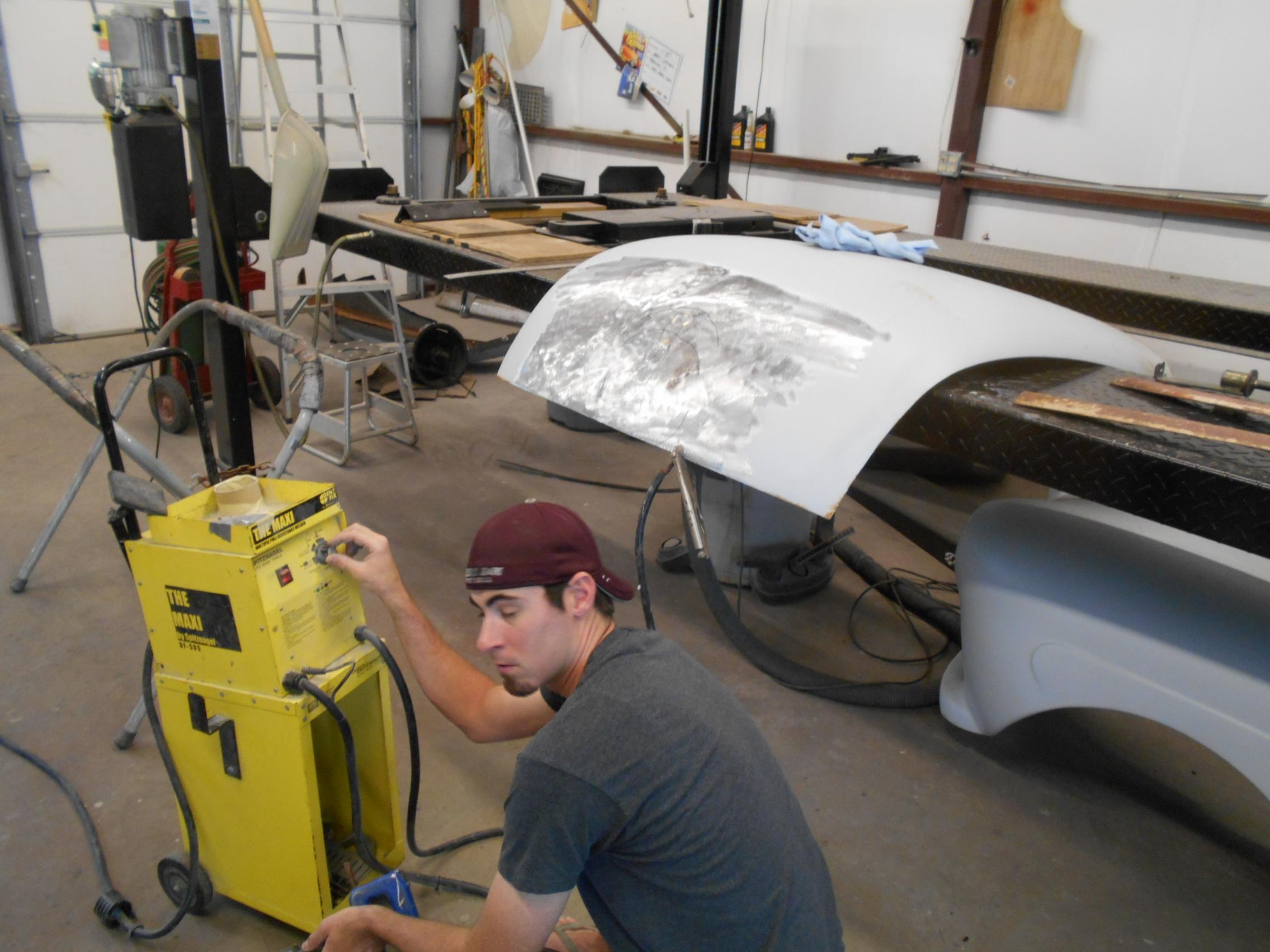

    Speaking of rear ender's. Iv'e discovered that there isn't a deck lid out there thats more solid than mine. So I'm going to have another go at it.
  16. Tnomoldw
    Joined: Dec 5, 2012
    Posts: 1,563
    Tnomoldw
    :)OH ! you got some help!:cool::D
  17. jivin jer
    Joined: Sep 14, 2008
    Posts: 3,535
    jivin jer
    Dan dropped the "dent dog" off from the big shop (Cl***ic Chevrolet) that he works at.

    "Back in the day" we used the old drill a hole, insert the sheetmetal screw on the end of the pull hammer into the hole, then give it a couple really good pulls with the weight on the shaft. Usually wound up distoting the dent even worse not to mention having to fill the holes at the end, just a light skim coat like Torchies photo in post #599. Ah the good old day's!
