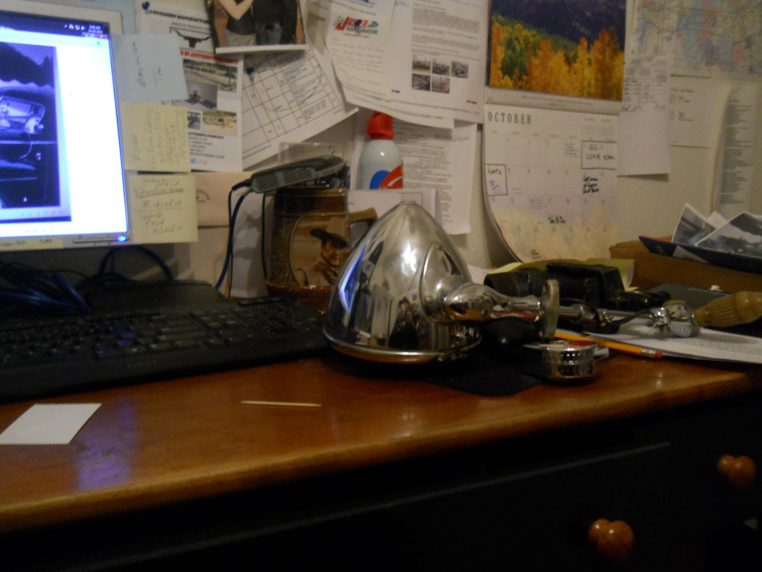

    Bob says that he has an Appleton spotlight that he can hold in position to mimic one of the pics that we have. Bob ADDS 2" to the A pillar for another look! We enter into a time of experimentation with the w/s height to try and reconcile their problem with me insisting that we follow Jesses description about what was done. We go back to the 7" w/s and Bob takes out the upper B pillars with a CHUNK OF THE ROOF with it. I tell Bob that we cant show that piece out of the roof when picture time comes.

    I'm a little bit reluctant to buy into this because of the distortion issue that I've been talking about and, that headlight is too far away from the windshield to be able to use like that. Hey, wait a minute, I do have a close up shot of the windshield and an Appleton spotlight that's right next to it. I happen to have an Appleton spotlight on one of the shelves in this room.
    All right, that settles it for me. I don't care where your'e coming from, there it is. MUCHUS GRACIAS AMIGO.
