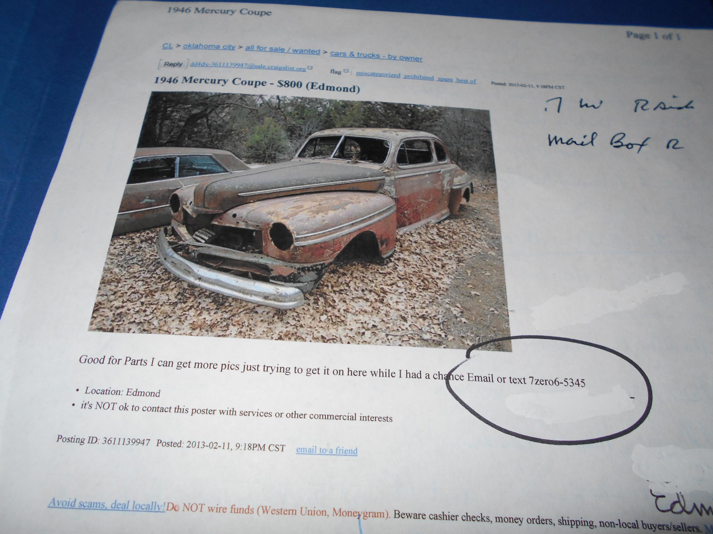

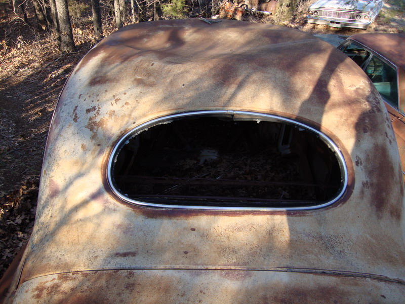

    Ok, son Dan and I are headin' for Oklahoma this AM. I can get this cheaper than the asking price. It doesn't have any suspension in it, front or rear. There's a lot of good parts. I can see that the kids have jumped on the roof. Iv'e had experience dealing with damaged roofs before. They have a "memory", so if you start easing them back into shape they will go, sometimes willingly.

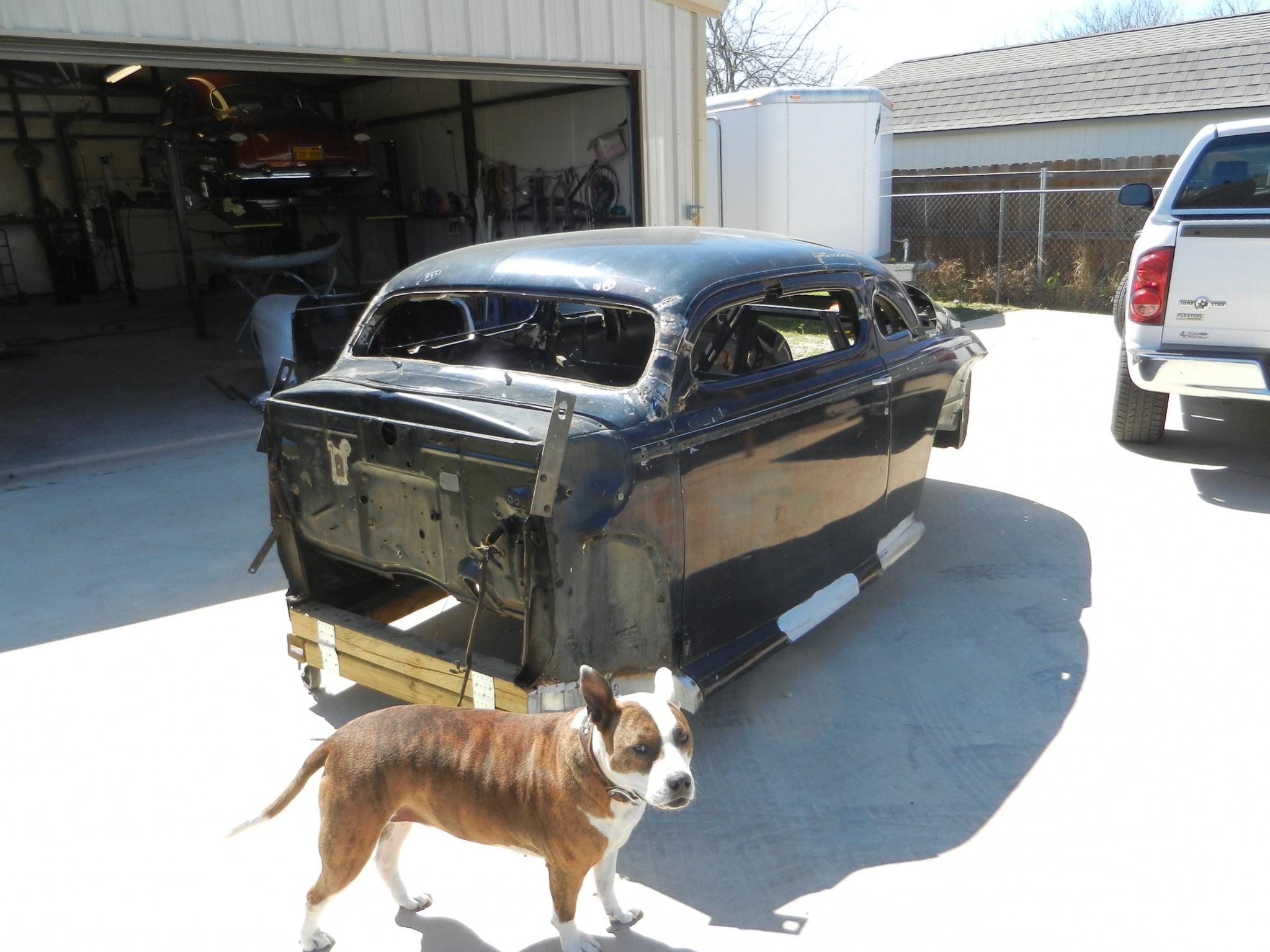

    We got to Oklahoma to find the body up on blocks which made things a little easier. We took the bumpers, top, doors, all the garnish mldgs, it had a beautiful rear gravel deflector that I really needed. The trunk lid was toast. The top...those kids were/are a little bigger than I had hoped. All the way home I was asking myself (?) WHY, WHY.

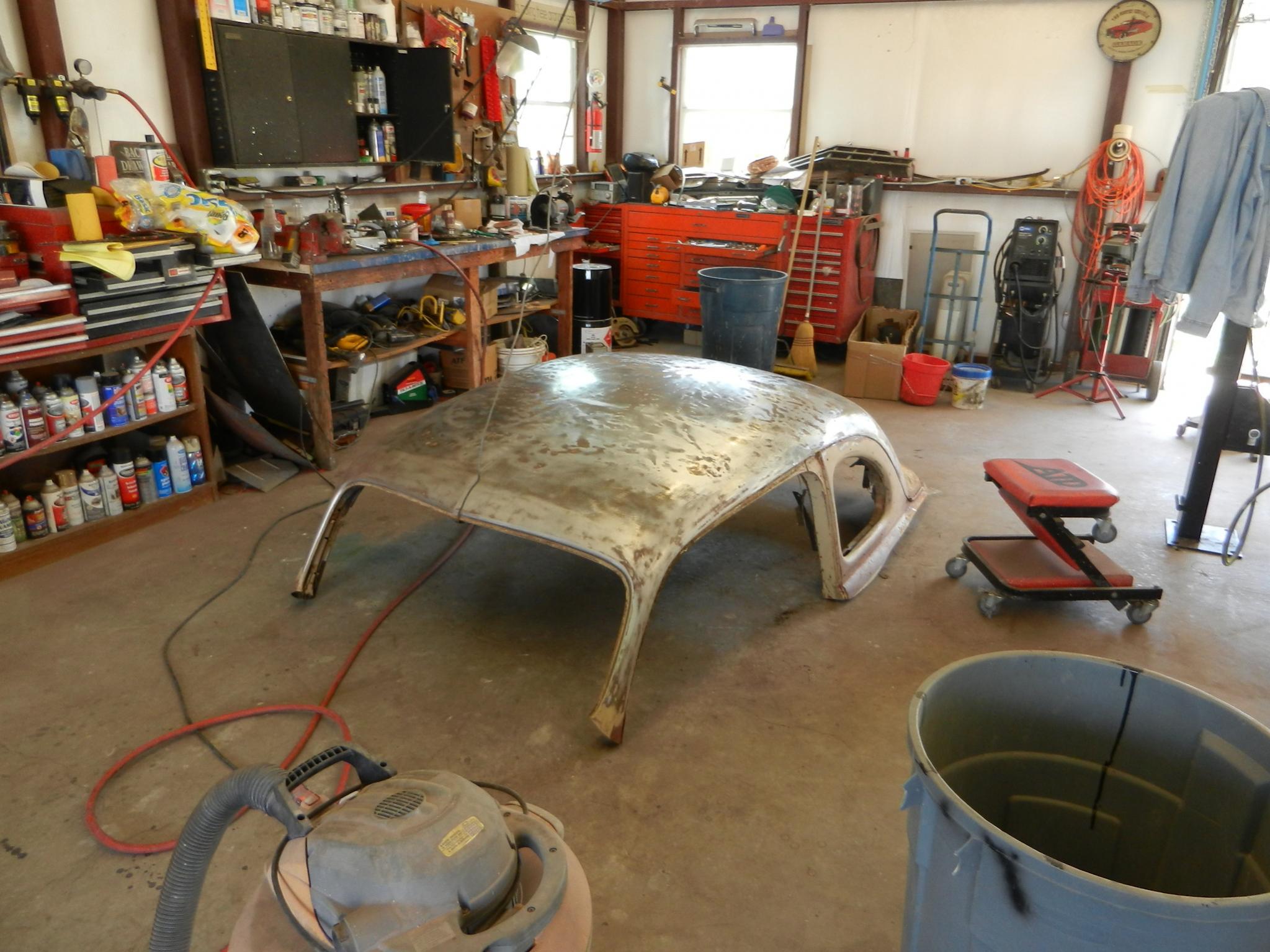

    I spent a restless Saturday night thinking about that roof that I bought. It was sitting just outside my bedroom window. I didn't want to look at it on Sunday. Monday morning as I was waking up I decided that I would go out and put a couple of hours on it to see what it would do.
    I removed the headliner bows and flipped it over onto the lawn in a level spot. I very carefully stepped out onto the roof with my size 13 shoes. It looked (and sounded) like it wanted to cooperate. The large expanse of metal DID want to go back to its original shape. I was encouraged. I got my big rubber hammer out and started to m***age the areas next to the big creases (on the perimeter) back into the shape that they used to be in.
    I took it into the shop and strung it up with my winch that's in the rafters. Man, talk about handy. It gives me access to both sides of the roof as it stands up and, because it has the lower rear still attached, its super stable. I hammer and dolly out the creases. Now we're getting down to the fine detail stuff. I put my body file on my straight line sander and start to pick and file the damaged areas. I can take my grinder with a 9" 24 grit disc and locate the high and low spots from the back side. I can push down hard out in the middle areas and there's lots of resistance. It's back from the dead.
    I wipe some wax and grease remover on it to get it wet so I can look at it. All it needs is a little more work and it's ready for a skim coat of Bondo and a couple of block sessions and some K-36 primer.
    I've got about 10 hours into it to the primer part. A lot better than losing more time and money getting another top. I paint the back side with a rustoleum oil based semi gloss black paint and look up, as the body arrives from Bob's shop.

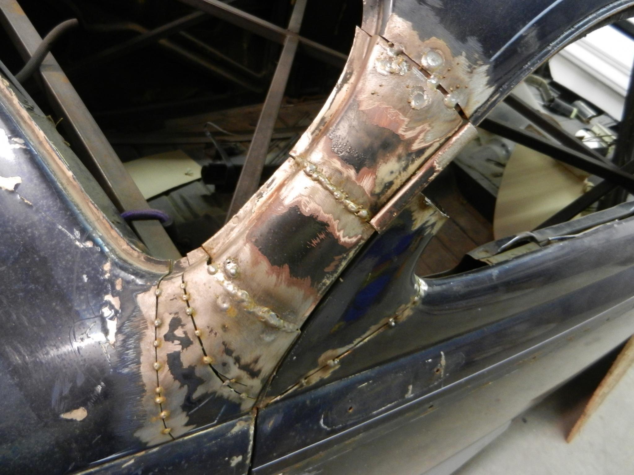

  18. Rather than having that sort of "organic" flow that Jesse's roofline had, it looks a bit "forced" doesn't it? Starting over with the stock piece should prove to be much easier than working with the original as it stands here. :)
    Sorry you had to go through this, but I find this adventure riveting thus far. I admire your perseverance Jer.
    -Dave

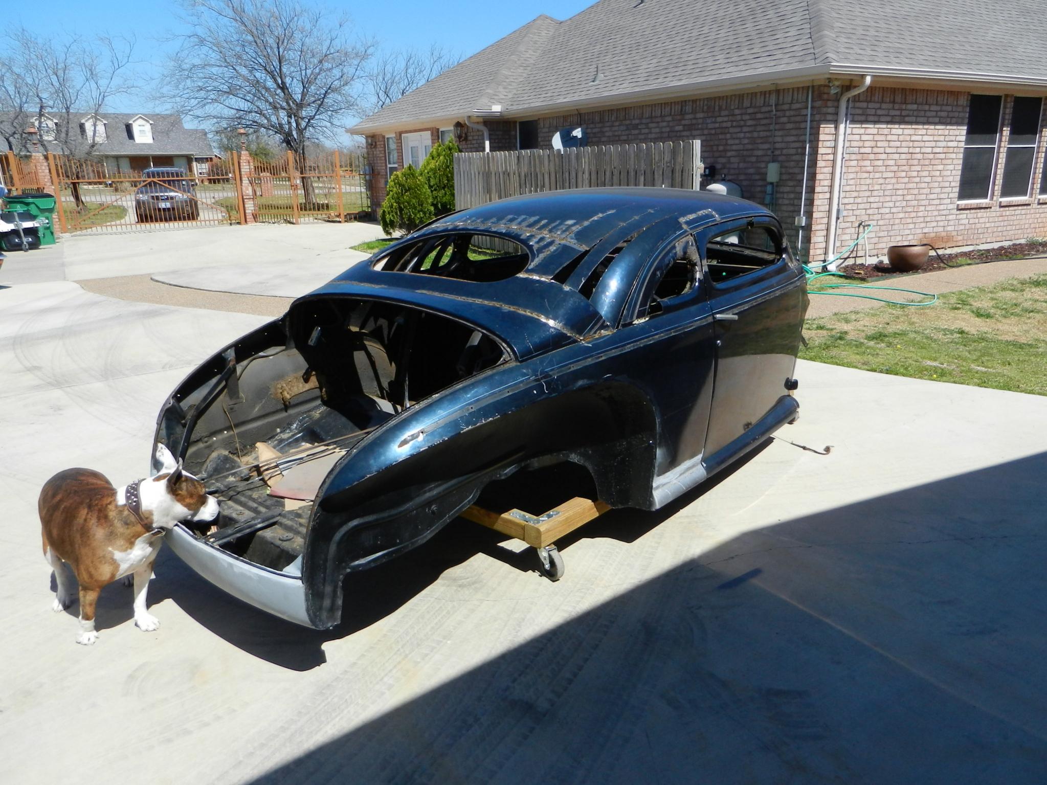

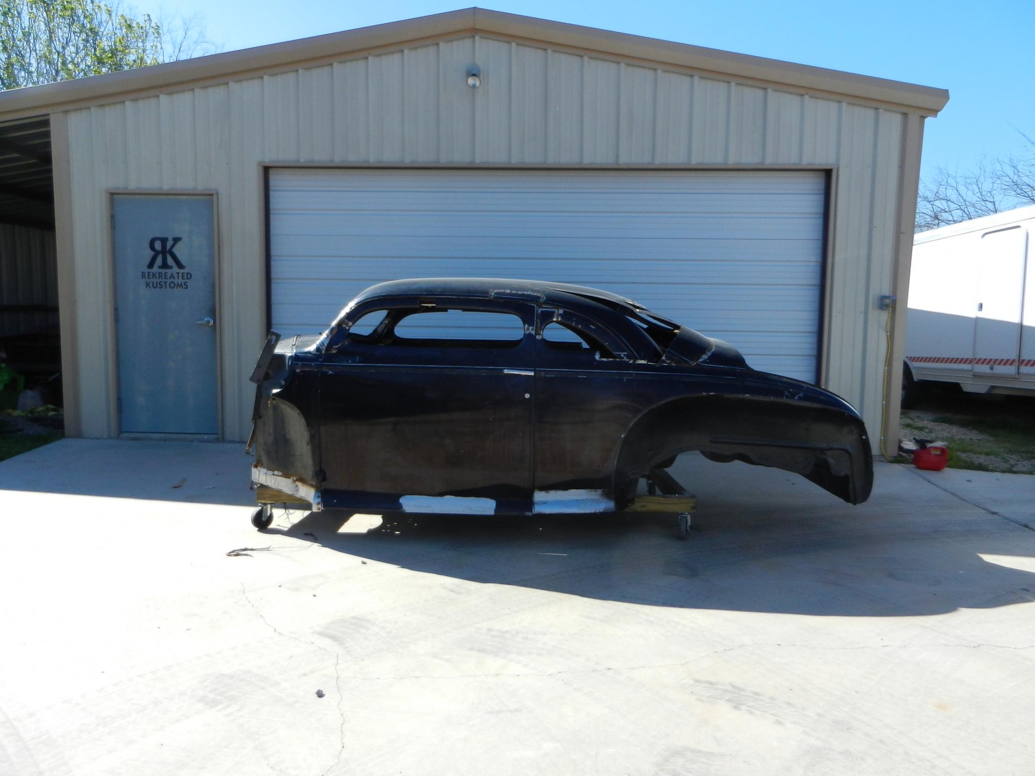

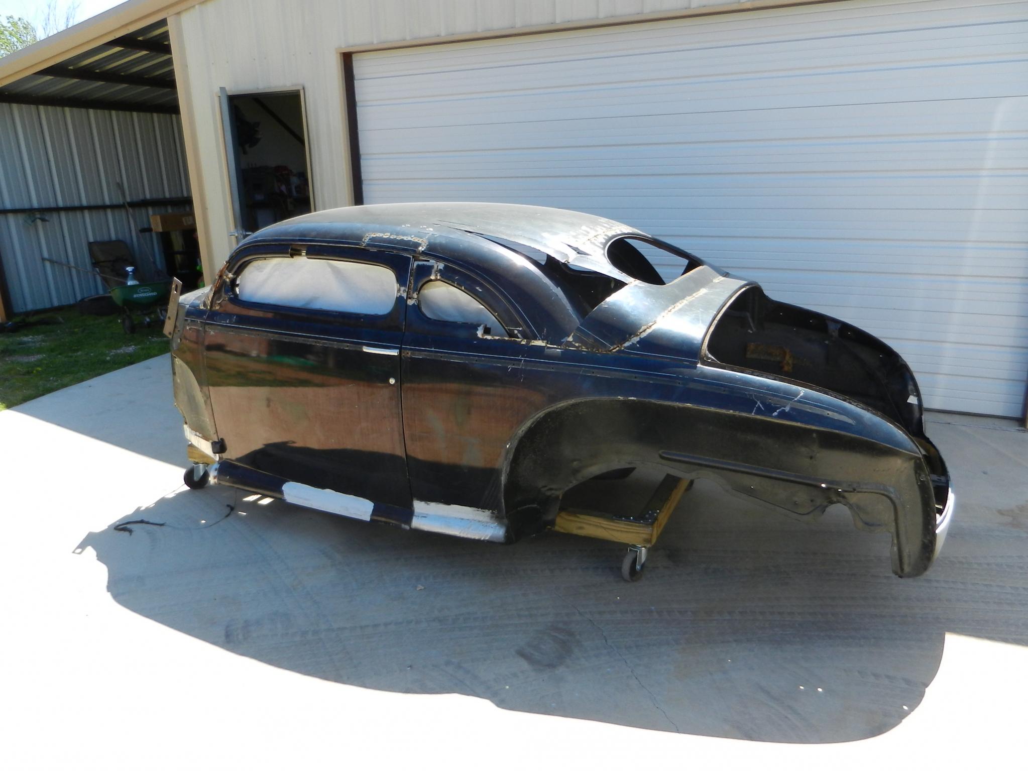

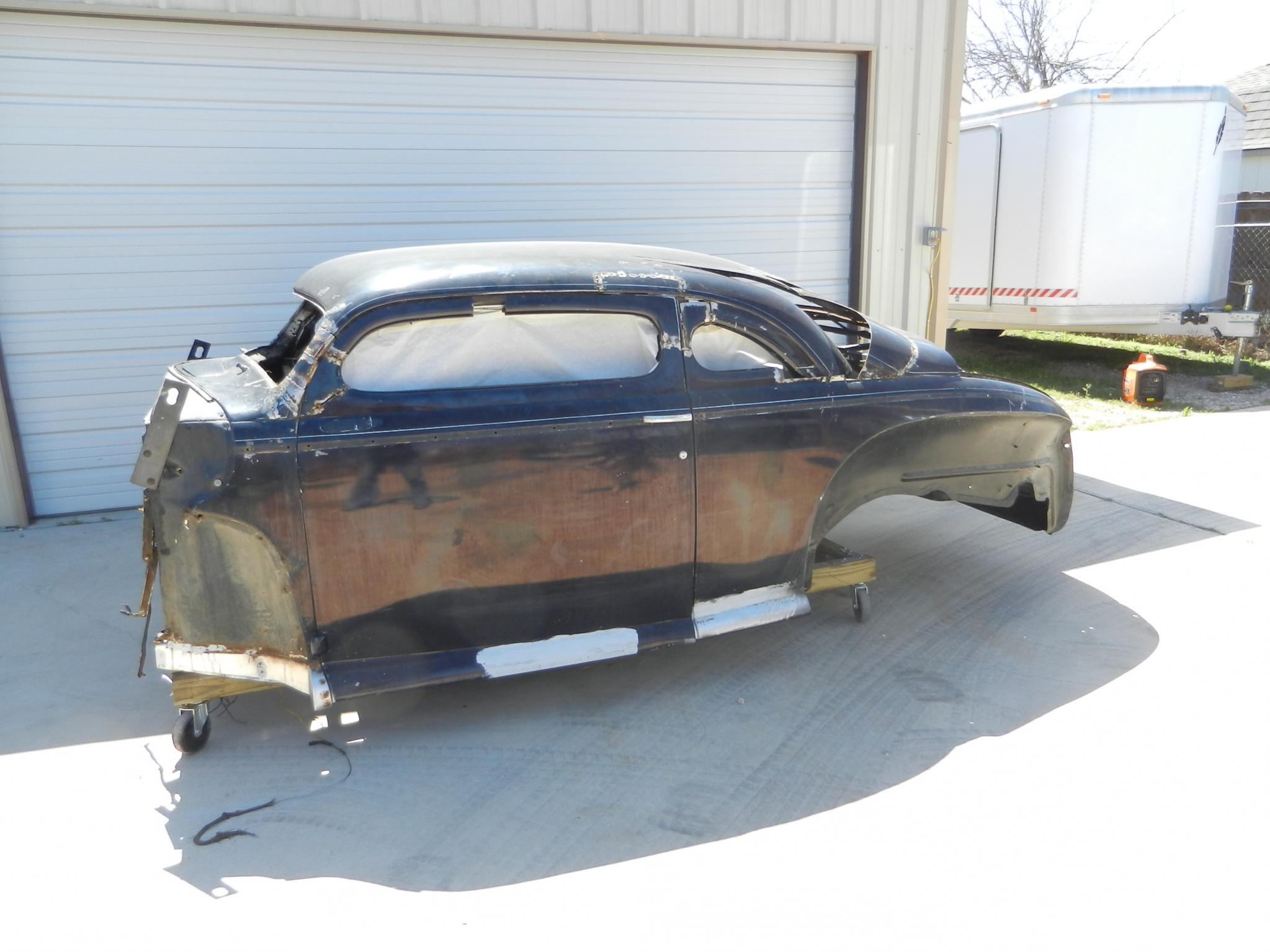

    I tried to put some paper in the window openings to see things a little better.

  22. chrisman
    Joined: Jun 13, 2002
    Posts: 721
    chrisman
    The height of the door window may not be completely off the mark, perhaps a little lower. The front window opening will shrink a bit with rubber in place. The c-pillar (or loft? Sail panels? Not completely sure what's the right terminology here) is too streamlined. Should be easier to see with the trunk lid in place.

    Joined: Jan 30, 2007
    Posts: 5,137
    BrerHair
    As TP would say, Holy Chit! Horrible.

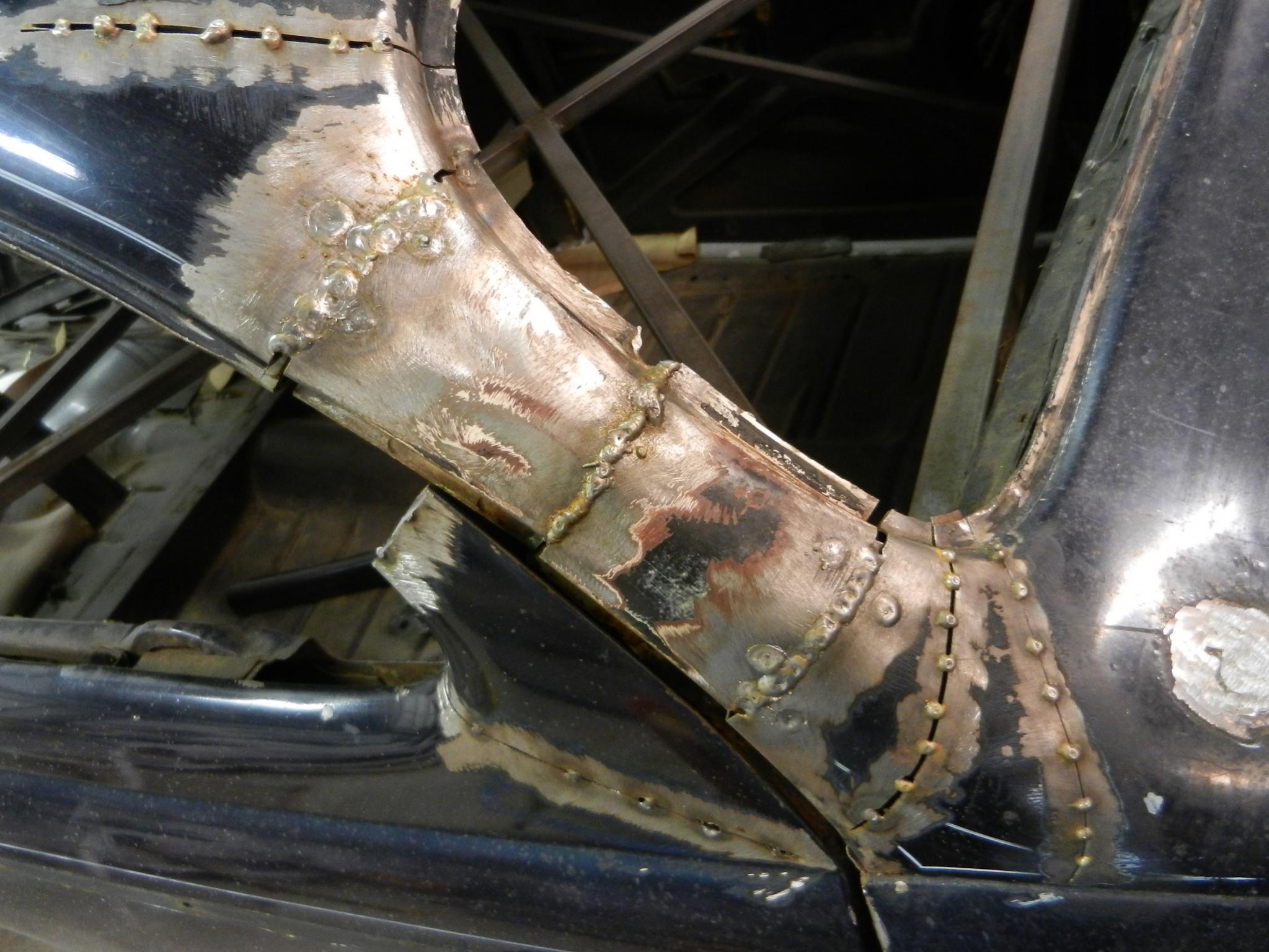

    Pro's eh.......
    These guys must own stock in a grinding wheel and welding supply company.
    Now I can see why you didn't use their real names.......

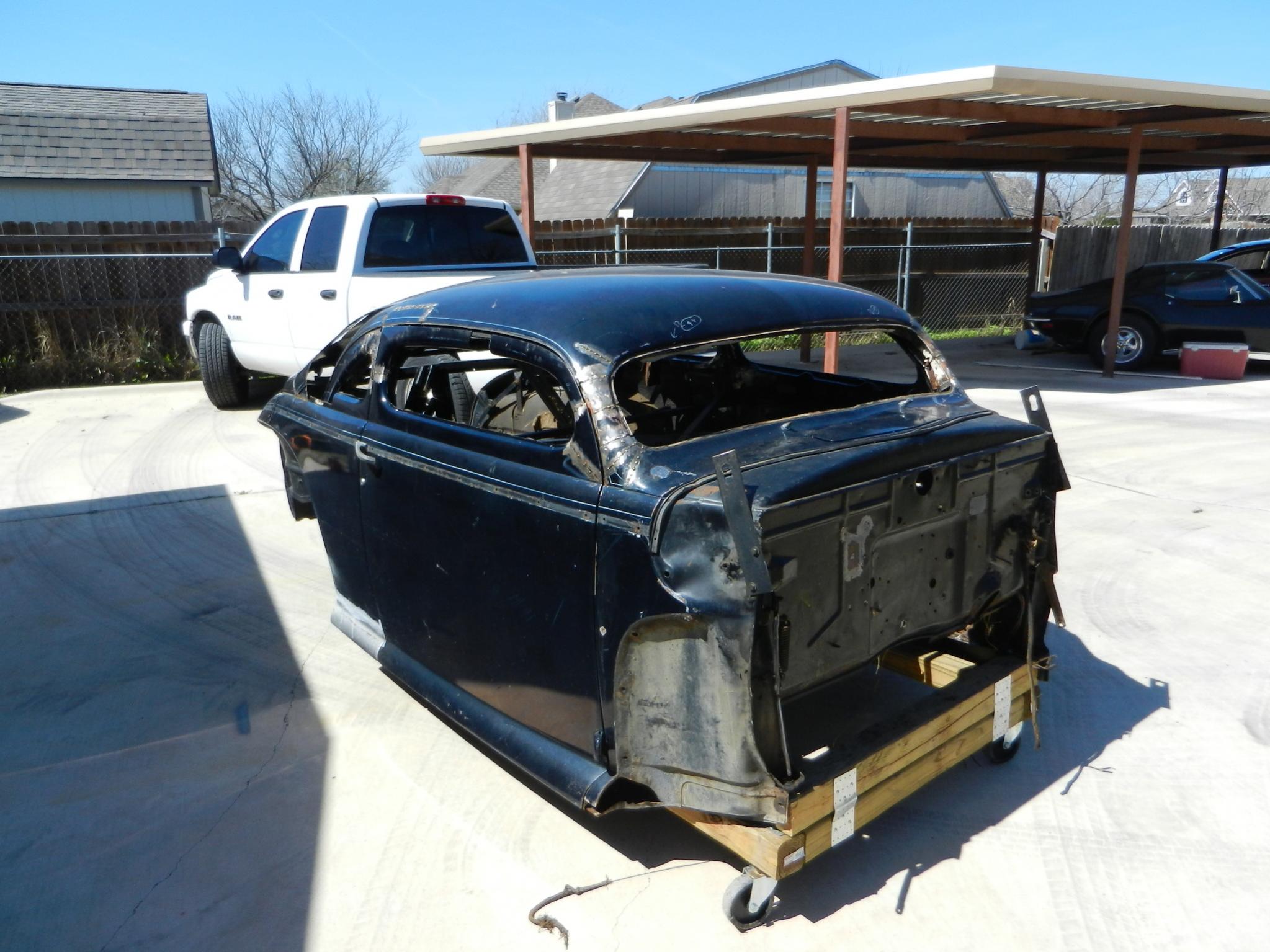

    I spent about a half hour slow walking around and around this wreck, I opened the doors and very carefully looked things over. I was looking at first hand what I had only seen in emails.
    I've changed how I think about this car from when I first saw it. After looking at a lot of '41-'48 Club Coupes I've come to appreciate how nice this car really is. To think what it could have been.
    The more I look the more I see that is VERY interesting. I see the cuts near the beltline to the doors that lets them conform to the new shape of the roof. I see the same for the B pillar. I see how the door tops and ¼ gl*** openings are done and, more important, why. I see the upper b/gl*** opening slide under the lower area. These will change because the top will come down further but, I see and I understand.
    There IS a lot of foundational stuff here that's done right. Something that I now can take and build on. I'm looking past all the thrashin' and see that this IS what I was looking for ultimately. My ignorance regarding what these round top cars need when they're chopped is gone.
    Looking at all this and considering what it represents up to this point in this build, I think to myself, this is the price of admission. I also have a strong sense that the KUSTOM CAR GOD is saying to me You did ask for help, remember? You did want that experienced hand for this part, remember, My son?
