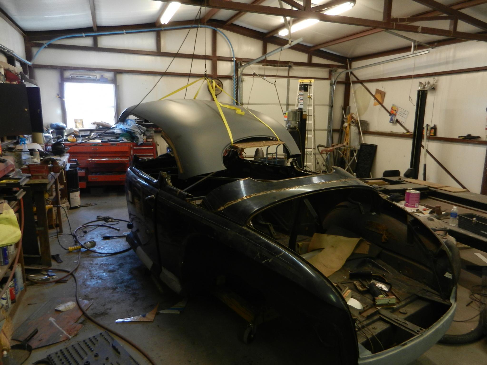

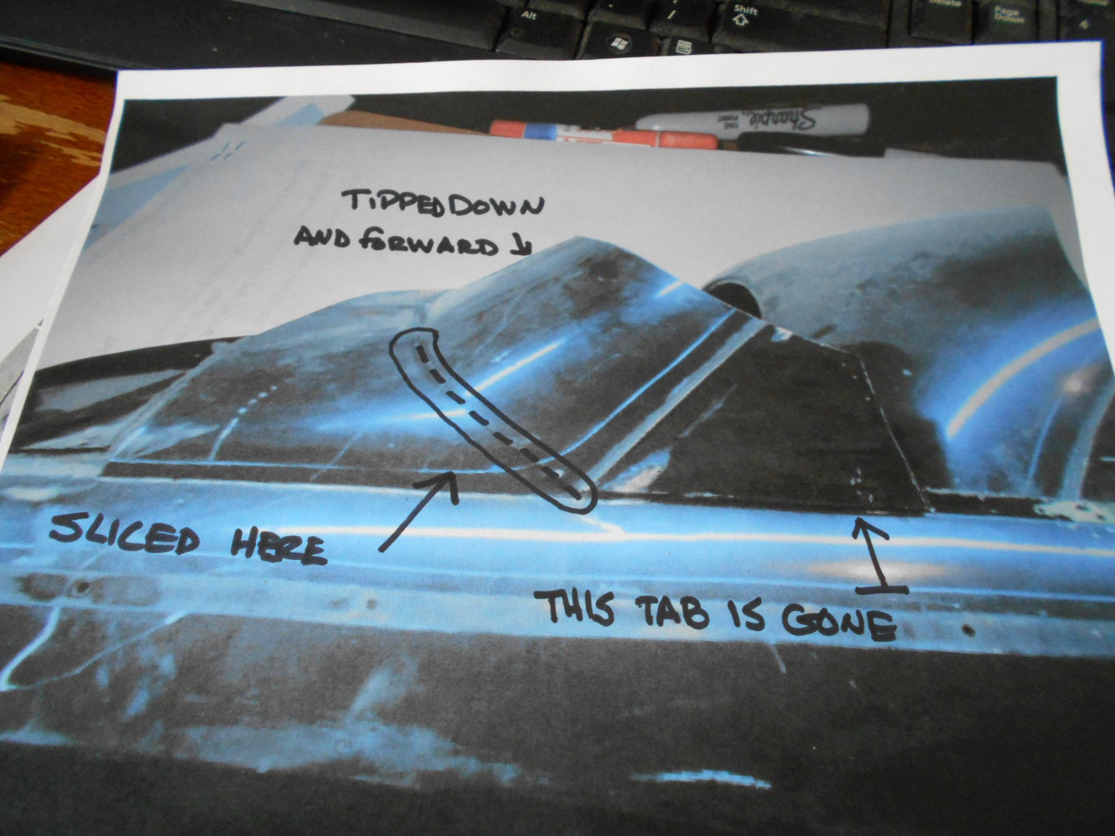

    This is what the back of the roof looked like when Sam and Jesse let the top come down from the 8" w/s. Sam hammered the crease out and sliced the panel to get it to lay down and start the process that would eventually join it to the upper area.
    Compare it to the previous pics that show how Bob dealt with it.. While not authentic, I do like it AND, I'm definitely not going to cut the **** out of everything to change it back.
    This is how I'm callin' this one. LET THE SLICIN' & DICIN' BEGIN'.

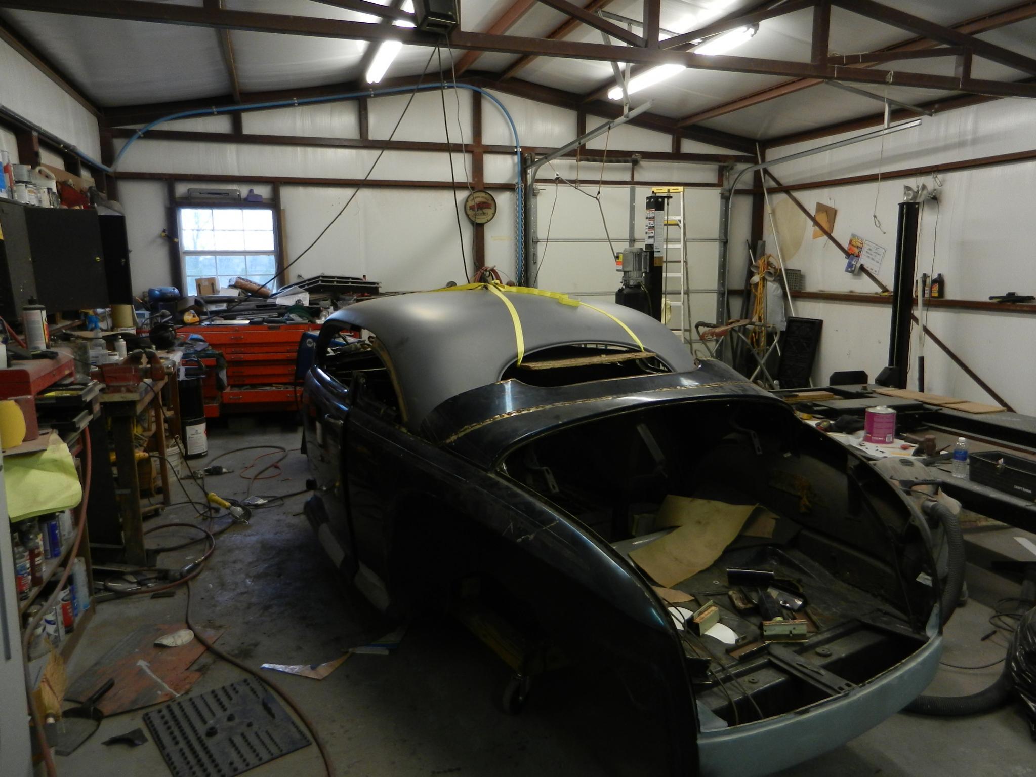

    OK, we're getting ready to install this for the last time after doing all the t******* and "fitment". Notice that there are no drip rails and the B pillars are "set aside" as per Jesse with NO chunk taken out of the top.

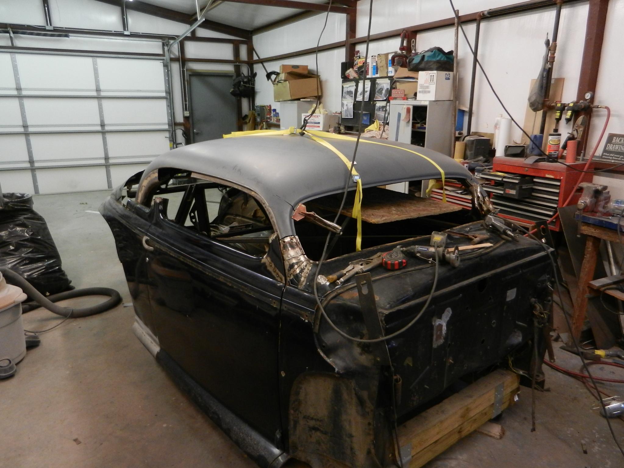

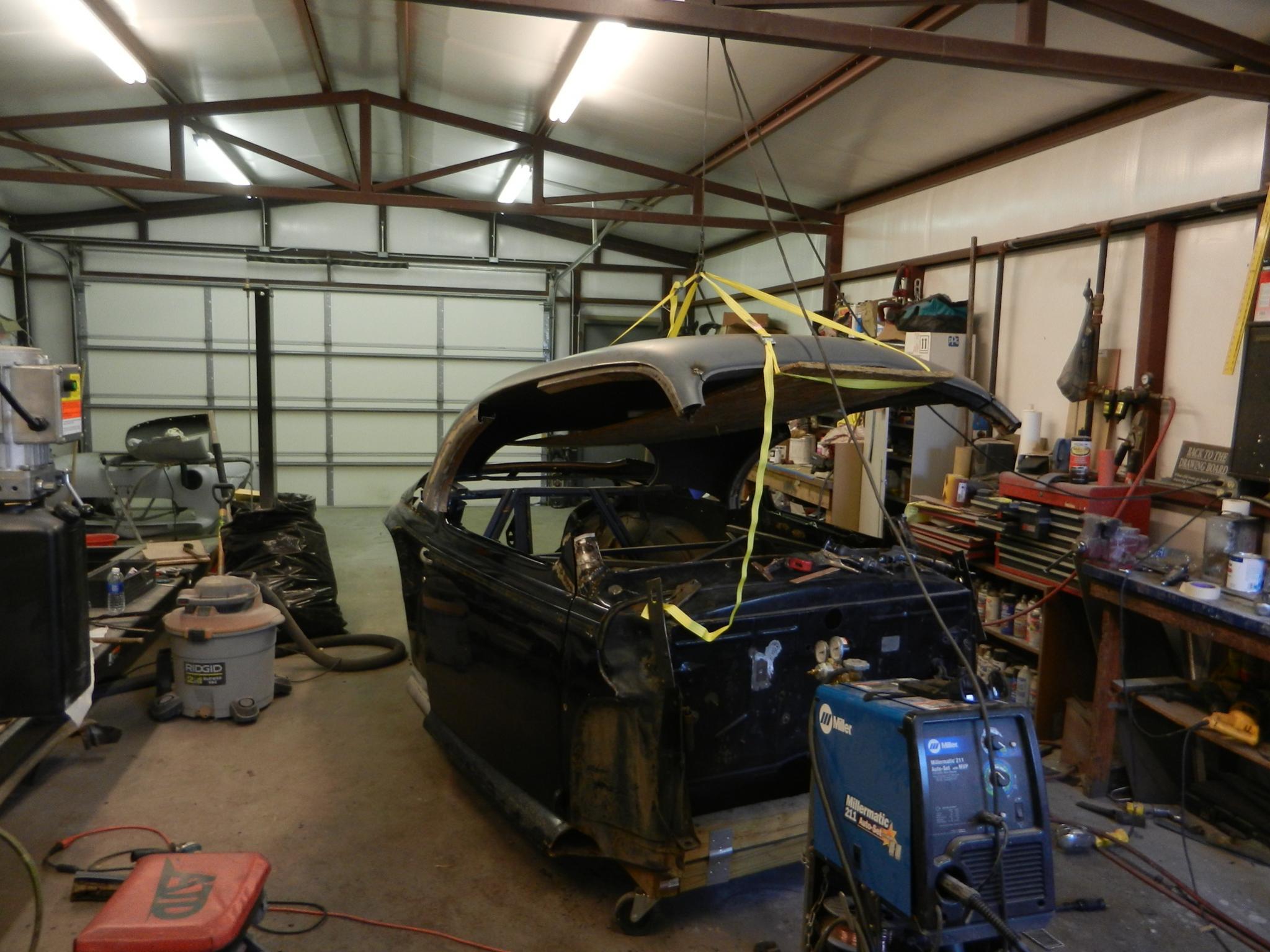

    When its just you by yourself you gotta" get creative.
