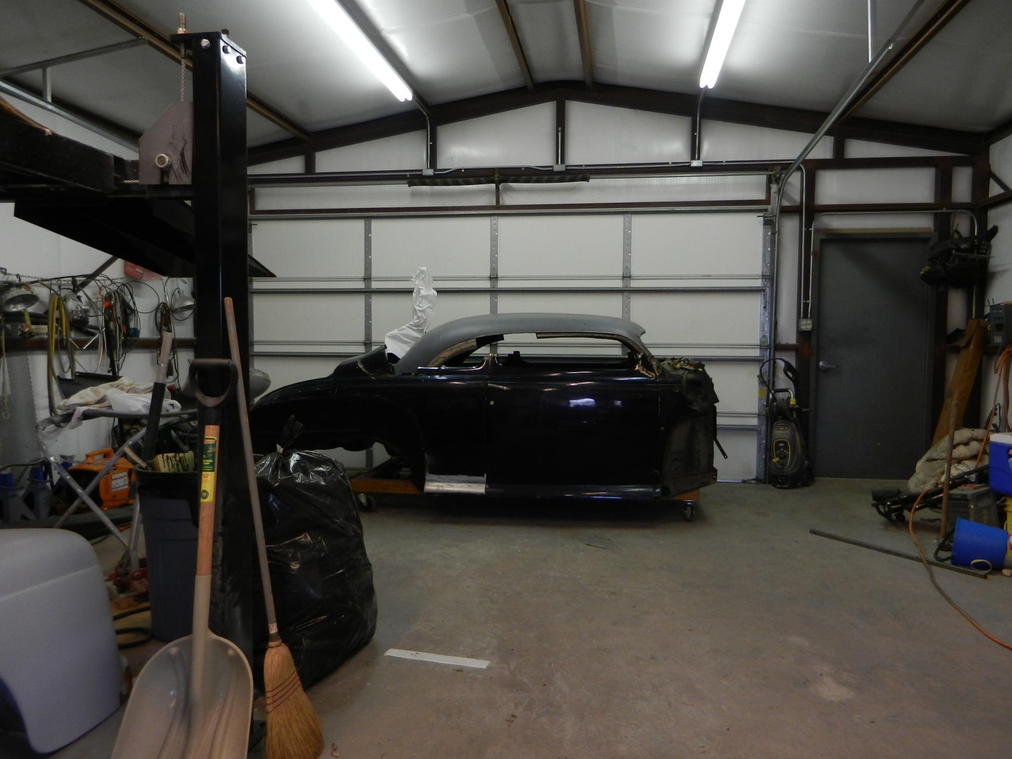

    Here we are checking the profile to see what it looks like. I did have a template shot in the shop that I accidently deleted. I have one for later outside. Making sure (once again) that everything is even side to side.
    If I remember correctly the original feature on Duane Stecks driveway build (Moonglow) showed that the top was cut only at the front and rear pillars. There weren't any bizarre trips out into the sheetmetal part of the top.
    It's the same thing here. No cutting the top in 1/2"s or 1/4"s. None of that stuff. We'll leave that to superman.

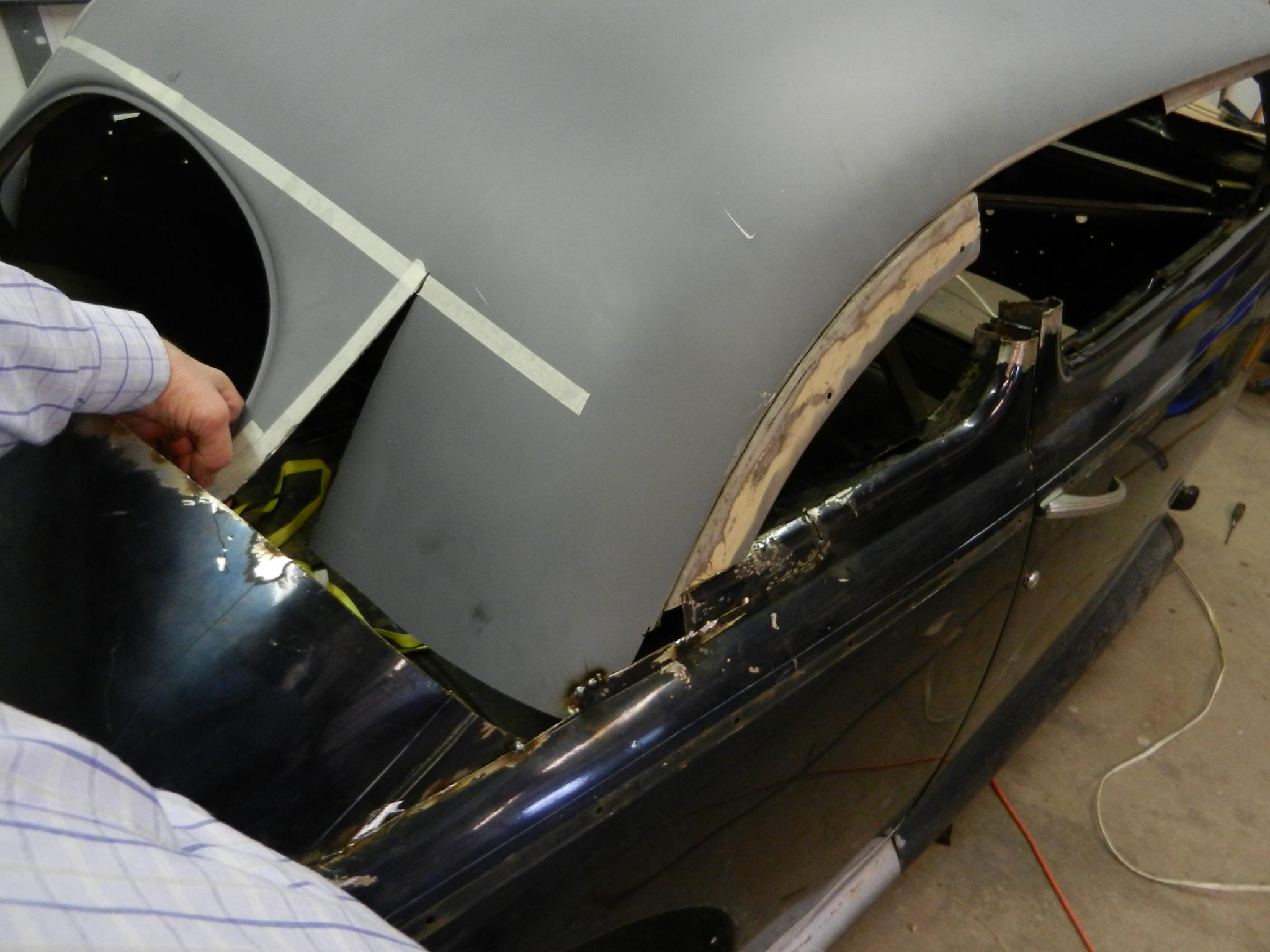

    Well, I was here before you, via email. Jesse has said that the cuts didn't go above the b/gl*** opening. Here we are very carefully trying to see how this will work. It won't work. There's too much resistance against this "slice" too let it conform to where we need it to go.
    We also see the hole that Jesse tried to bridge with the chicken wire.

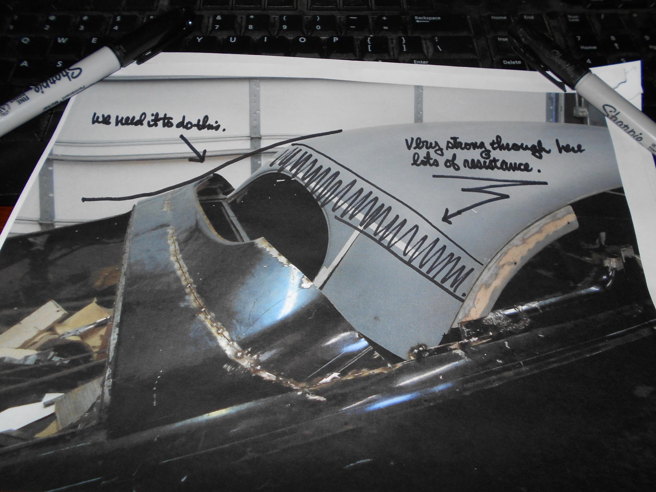

    Here's a better look at the top in the correct position. The rear corners are tacked so they don't move. Another look at that space that Jesse was trying to bridge with chicken wire.
    This is probably close to the "sonofa*****" place he was at. Not quite to the "it will tell you what it wants" place.
    We are trying to get there. We know what we can't do with Jesse's info (about the slice's) at this place and time.

    this is one of the hardest chops I have ever done,( 19) at this point what I see is cut it above the drip rail and take the corner out, leave the back window opening intact, and let it hinge, get the backgl*** where you want it and then go back to the corners after you get one thing where you want it. you might have to cut the roof and add a piece all the way across above backgl*** to make roof longer. and then you can cut up the corners and add filler metal on side between driprail and quarter gl***. and I'm sure you know, but the backgl*** is double curved and tempered so you cant cut it. you will be doing a plexigl*** or have timo build you one which runs about 10 grand for a windshield. no sure on back gl***.. I have really enjoyed your build, can't wait to see it done.

    I couldn't wait for Jesse to get what I had sent him so I could talk to him about it. I realized that I've already talked this thing to death. So I went ahead and slowly crept my way upward with that slice at the b/gl*** opening until I found the sweet spot. When I did, all of a sudden, everything made sense.
    Sooooooo, here we are at that sweet spot where the top says that's it, that's what I want. It's just above the resistance line and, below the crown of the top. When you find that spot everything starts to work.
    Here's Jesse's slices and what Gene Winfield calls **** Deans ribbons (see post #686). I don't know if Sam Barris had a name for it.

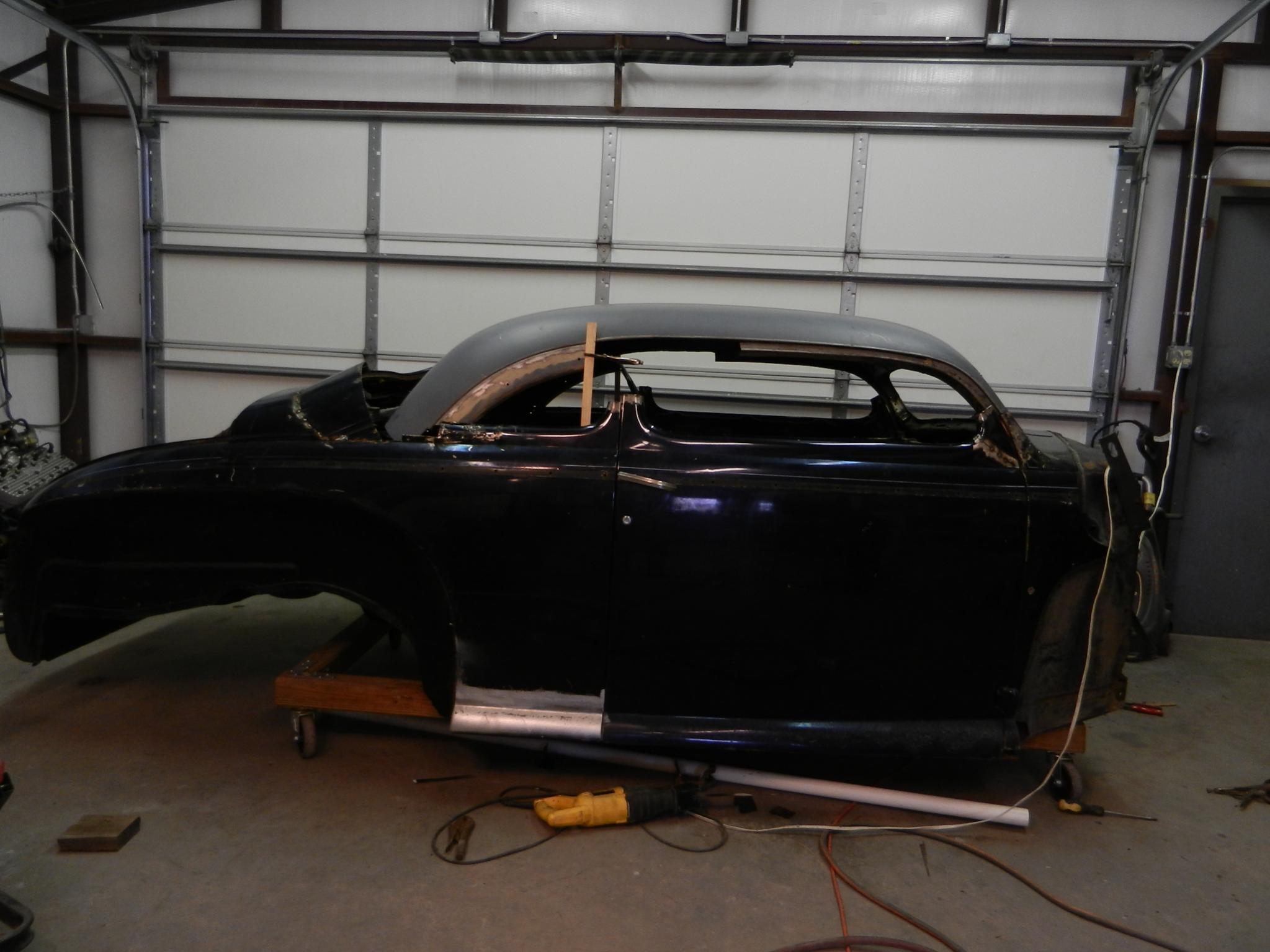

    We have started the fab work.

  29. Looking great Jer as I knew it would! Do you suppose Jesse meant not above the "rear" window (as in 1/4)? Just sayin' that would fit with what you've done..
    -Dave
  30. jivin jer
    Joined: Sep 14, 2008
    Posts: 3,535
    jivin jer
    Well, the actual "hands on" effort is showing that he could have meant that, for sure.
