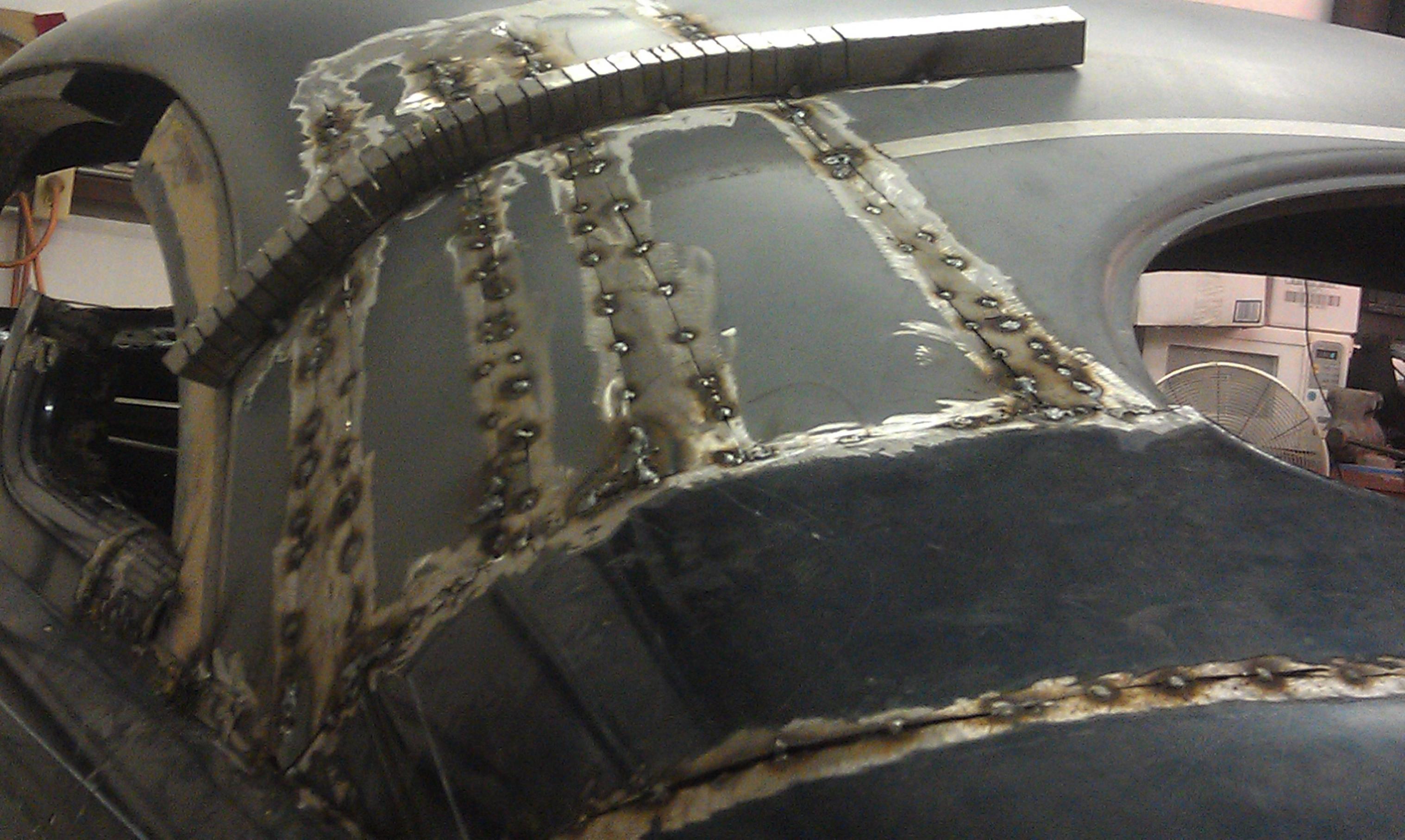

  7. tomkelly88
    Joined: Aug 31, 2010
    Posts: 382
    tomkelly88

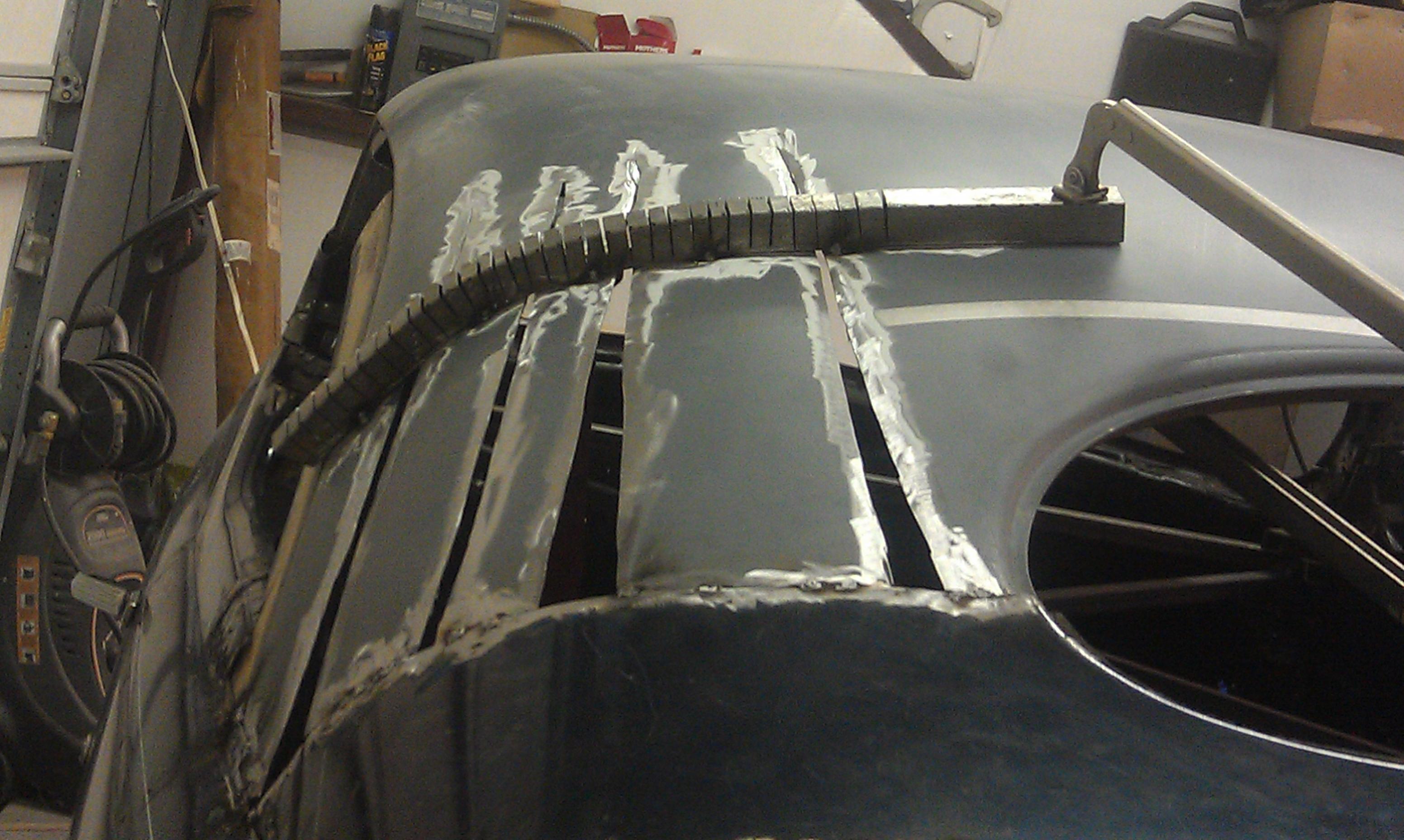

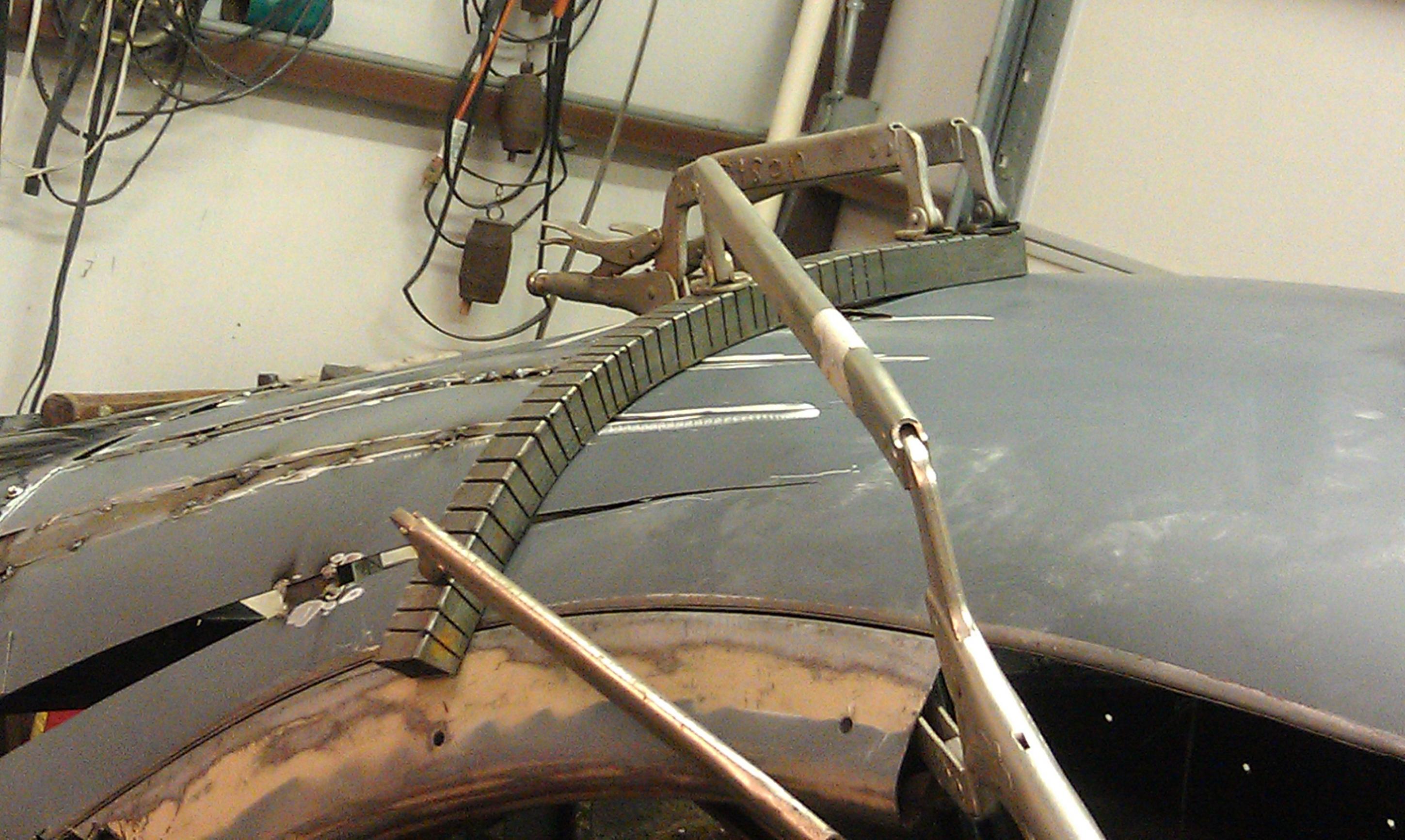

    Whats going on in these photos Jer? Do you use that sliced up bar/tube as a gauge/template to get the same shape on both sides?

  9. jivin jer
    Joined: Sep 14, 2008
    Posts: 3,535
    jivin jer
    Tom- The roof looses its contour when its sliced up. The upper arc shows the original shape that those pieces are in. When they're sliced up they look straight, like the lower arc. The tool I made forces all the pieces back into the original shape so I can weld every thing up.
    Kenny- All my gl*** comments refer to the rear (back) gl***.

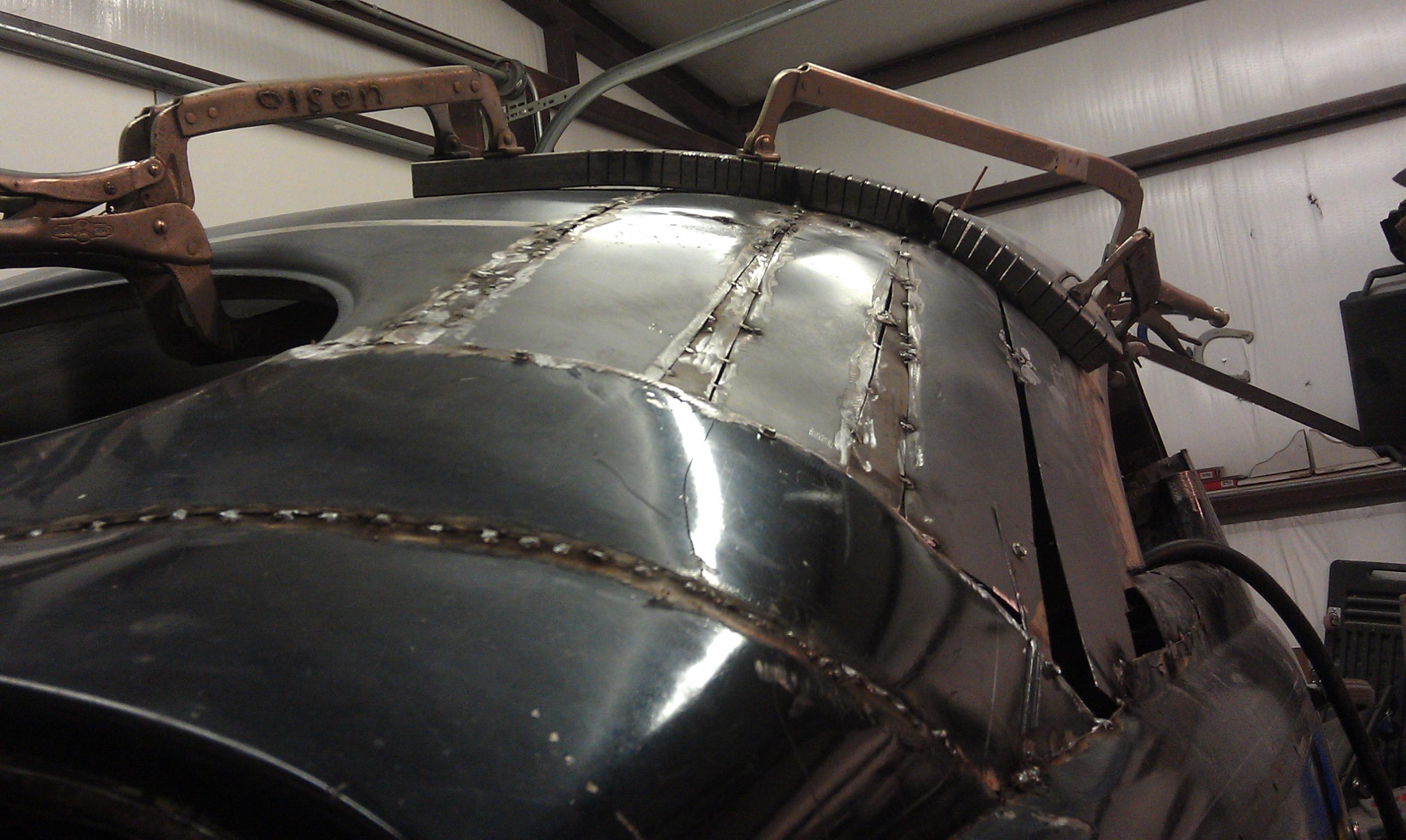

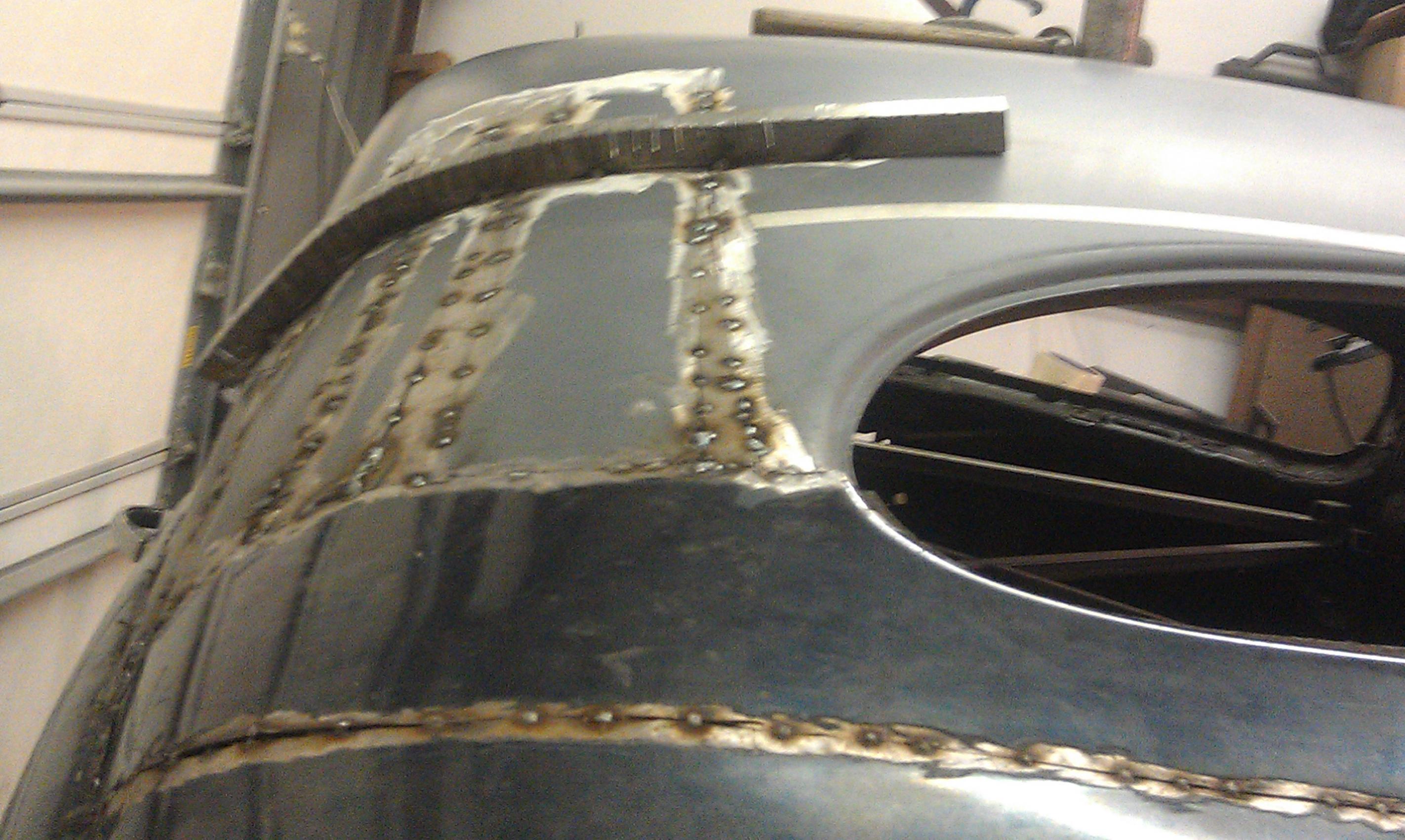

    This is my friend Ron Martynow. Ron and I met at my mens fellowship group. I learned that Ron had some extraordinary fabrication skills when he came down to my shop to help on a project I was doing. This in the Seattle area, mid 90s.
    He came to the Fort Worth area to work at Bell helicopter. He heard that I was in Texas and looked me up. Lo and behold, we lived 20 minutes apart. To shorten this up he came over to see what was going on and he welded up the slices while I was on that cruise awhile back. These are the pics he took as he did the pie cuts and the welding.
    I knew I had to go on that cruise (post #541) and that it would be the one thing that would sink my being able to get to the GNRS. Ron did all the welding and when I came home there was just a little left to do. This is just the sail panels. I could use that as a springboard to propel this project on to the next level. I think it is now well in sight and likely.
    Thanks Ron!
