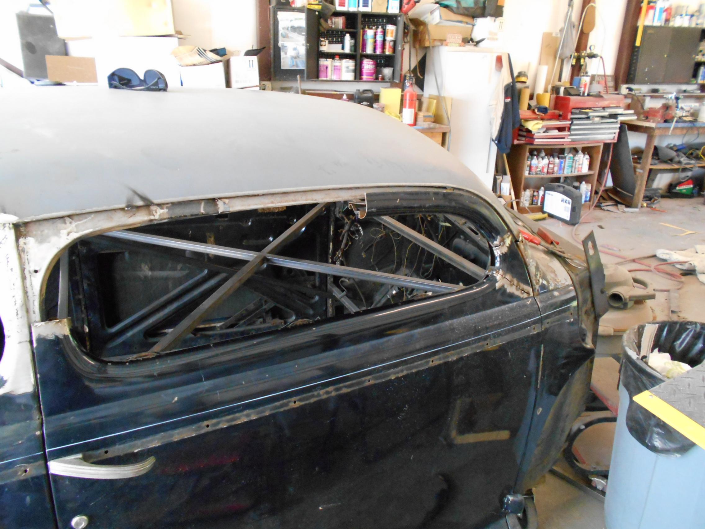

    I'm going to go back and forth (R-L) on the upper door frames. Here's the R with the parts car piece tacked in place.

    Establishing the top of the door opening with 1/4" rod.

    I like the way you are establishing the door openings with the 1/4" rod. I don't think I've seen that done so much on this era build, usually just round the corners and than adjust the gaps with lead. Do you tack and form as you go or pre-form the piece off the car. Also, it looks like you were doing some carpentry work and hit the wrong nail. Ouch!

    I form the rod as I go, it comes straight and is easily manipulated into what you want it to be.

    I kept my drip rails but I've heard of the big gap that shows up when the rail is removed.
    At first I thought the tacked in rod was going to be the new the top edge of the door. (cutaway the tacks, the 1/4 rod stays with the door, leaving a perfect door gap). In hindsight 1/4 is too thick for the door.
    but I see now you are using the rod to get a nice edge on the roof.
    Looks good.
