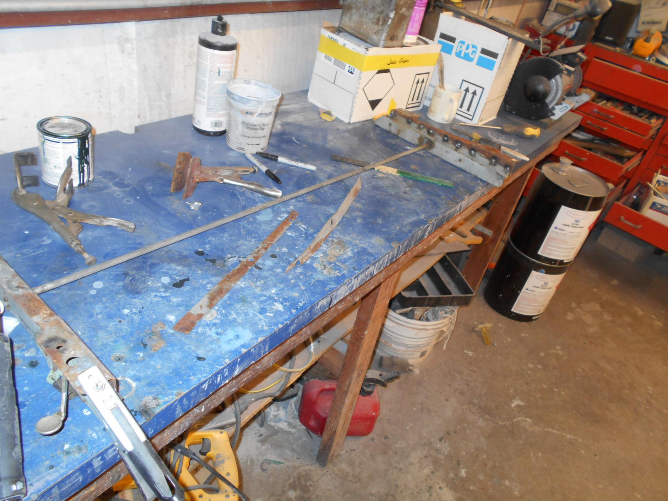

    First pic shows bondo on the floor, there was too much. Second pic shows that I want to see some metal.

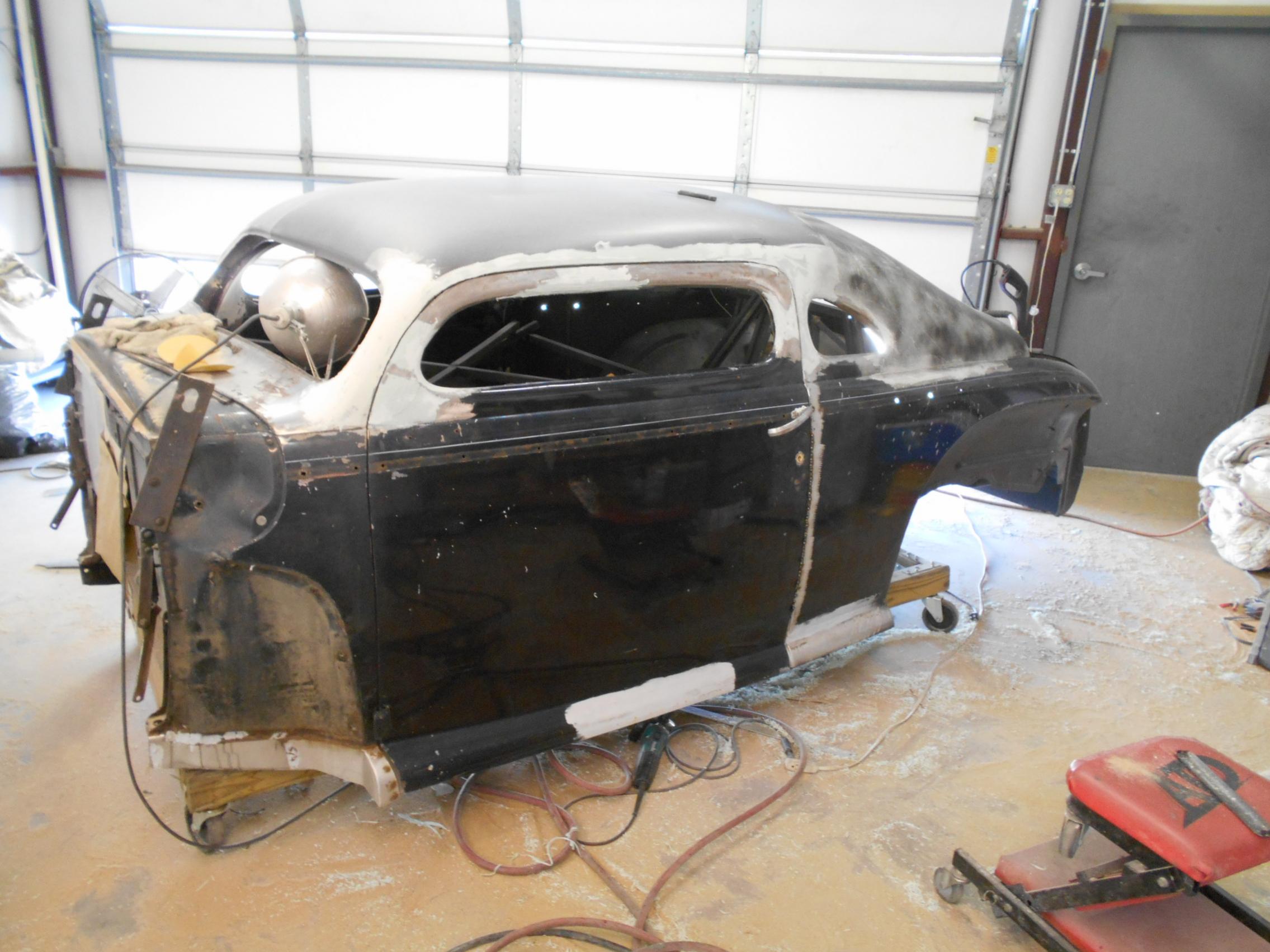

    I want to go past the (small) high spots. That makes them easy to see. I then will carefully cut them (or tap) them down. I follow this with a smear of bondo and we got it.

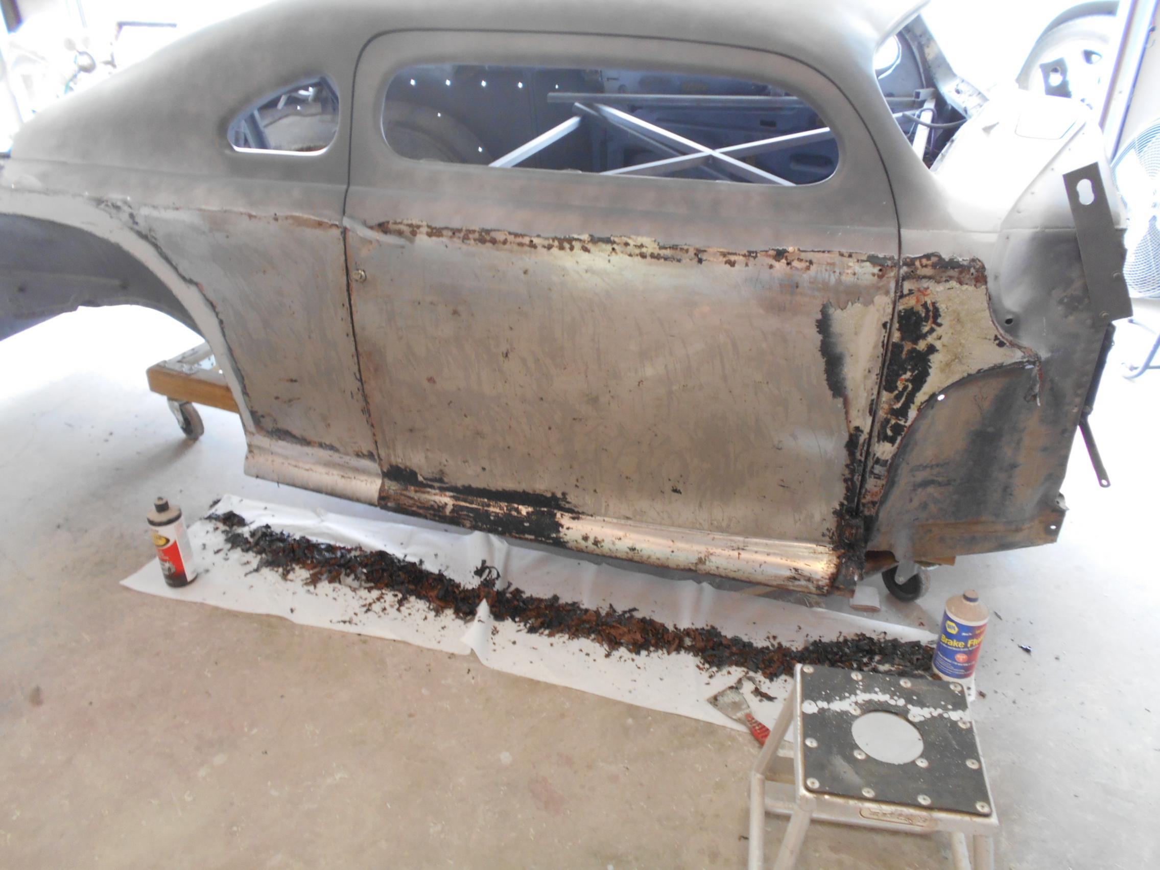

    Here's a look inside. The modification on the door and B pillars were what I was nervous about when approaching this chop. The work that was done was what I needed.
    There will be a Rustoleum coating on all the reworked areas.

    Nice work, I see you rotated the B pillar at the crease where the straight B pillar meets the rounded top of the main door. Nice and flat B pillar. Nothing worse looking than those B pillars with a bow in the middle.
    Speaking of creases (photo 2), question on where the B pillar and connecting window frame meets the round top of the main door panel. Did Lopez fill that in with lead, like did many others, to make a smooth inside radius/fillet?

    Well Mike, my friend, if you say that's what I did, then I agree, that's what I did. The one thing that I did watch out for was a curved B pillar. That wouldn't have fit the pics I'm seeing.
    When asked about the volumn of lead used Jesse hedges his reply and answers which gives me the impression that it was a wheel barrow load.

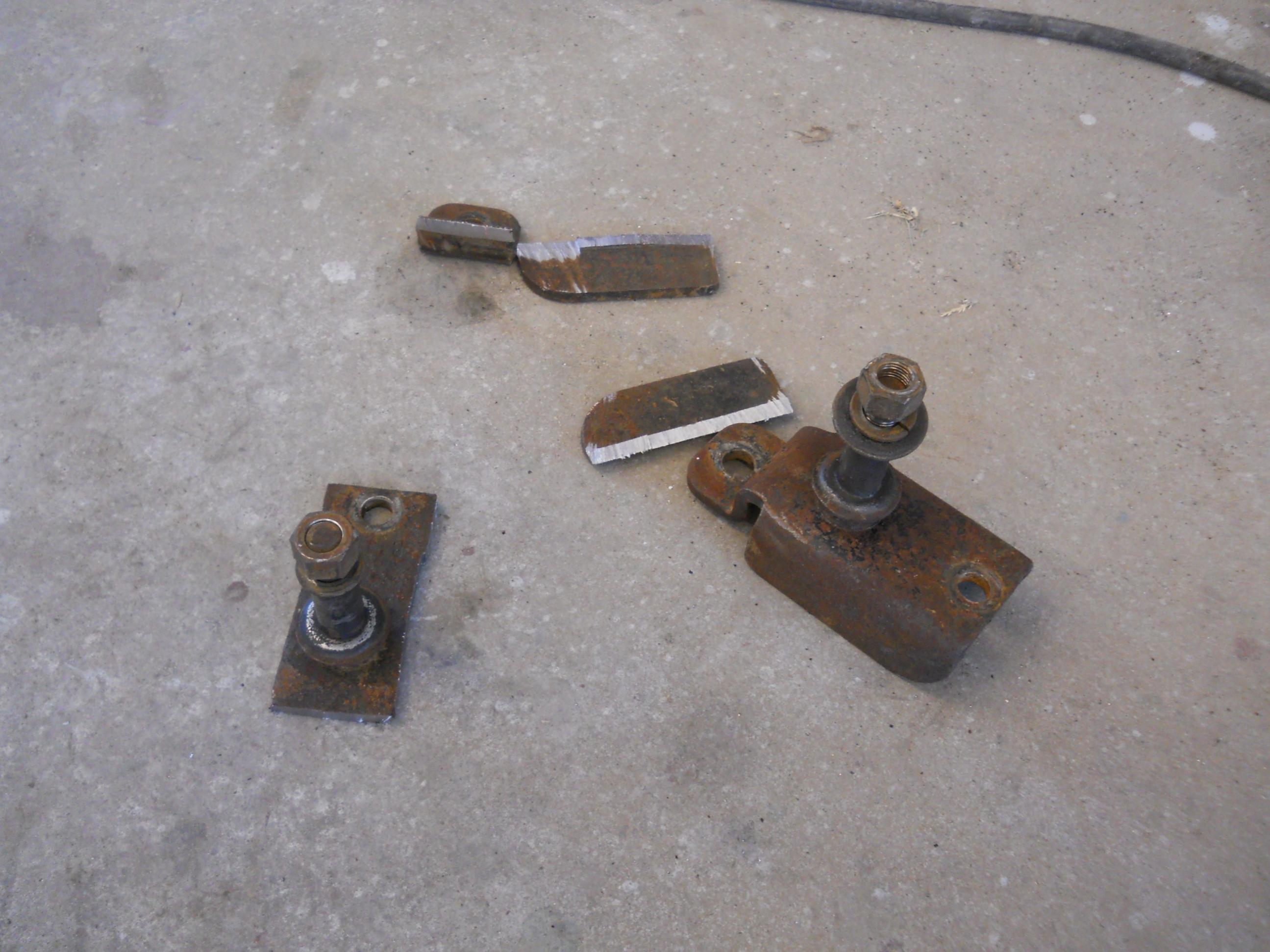

    OK, we've avoided this as long as we can. We have to go back and pick up where we left off with the ch***is (post #629).
    Here is the stock rear X member setup and the replacement. Jesse actually told me that this was all done while the body/frame was intact. It never was separated. I'm glad I don't have to try and do that. He used an old style cutting torch.
