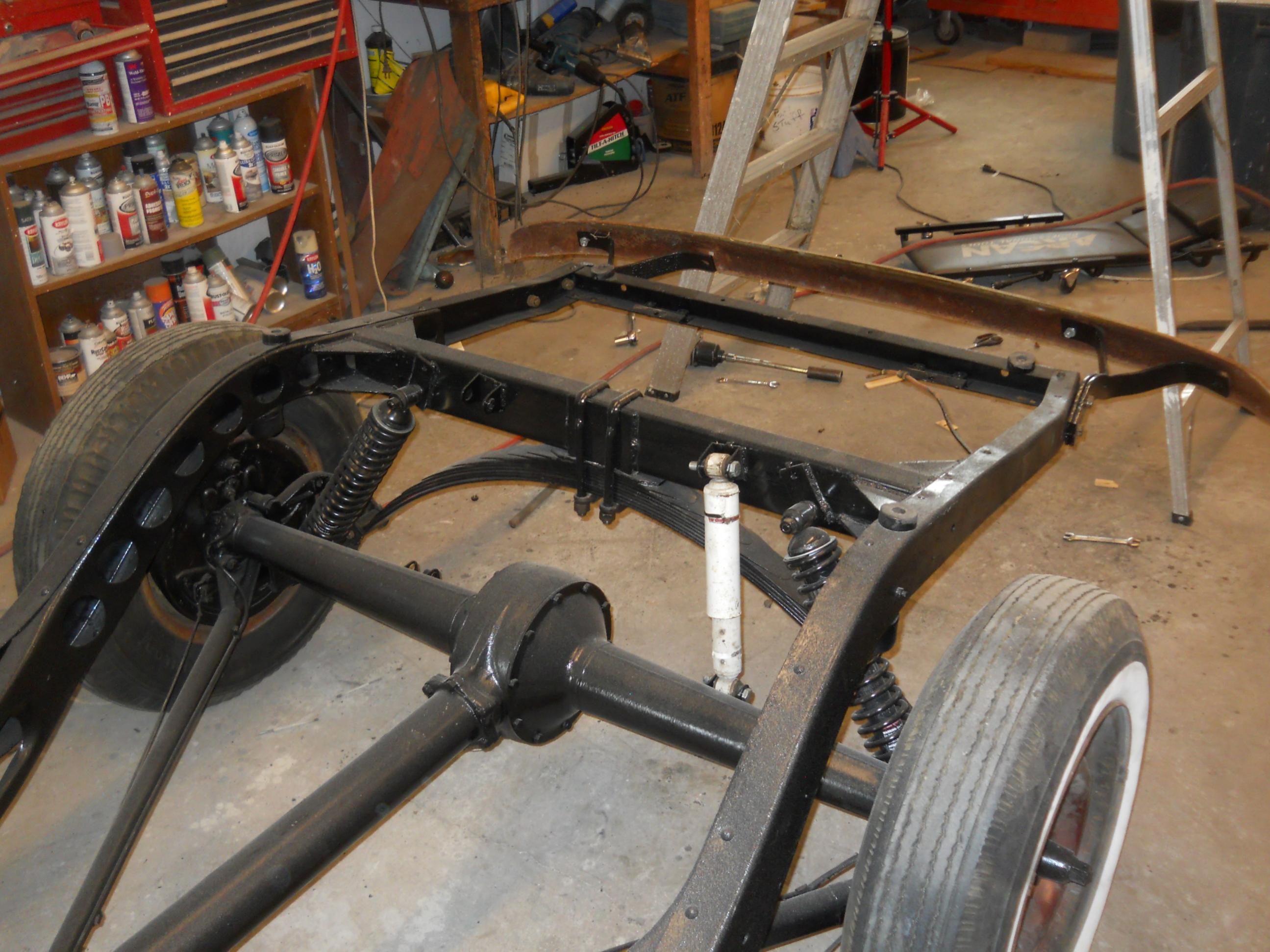

    Jesse said that he had two different type's of shocks on that rear axle. A stock set and a set of coilover's. There was a big struggle to ID these things until hotroddon (post #98) said that they were overload shocks. Thanks much Don.

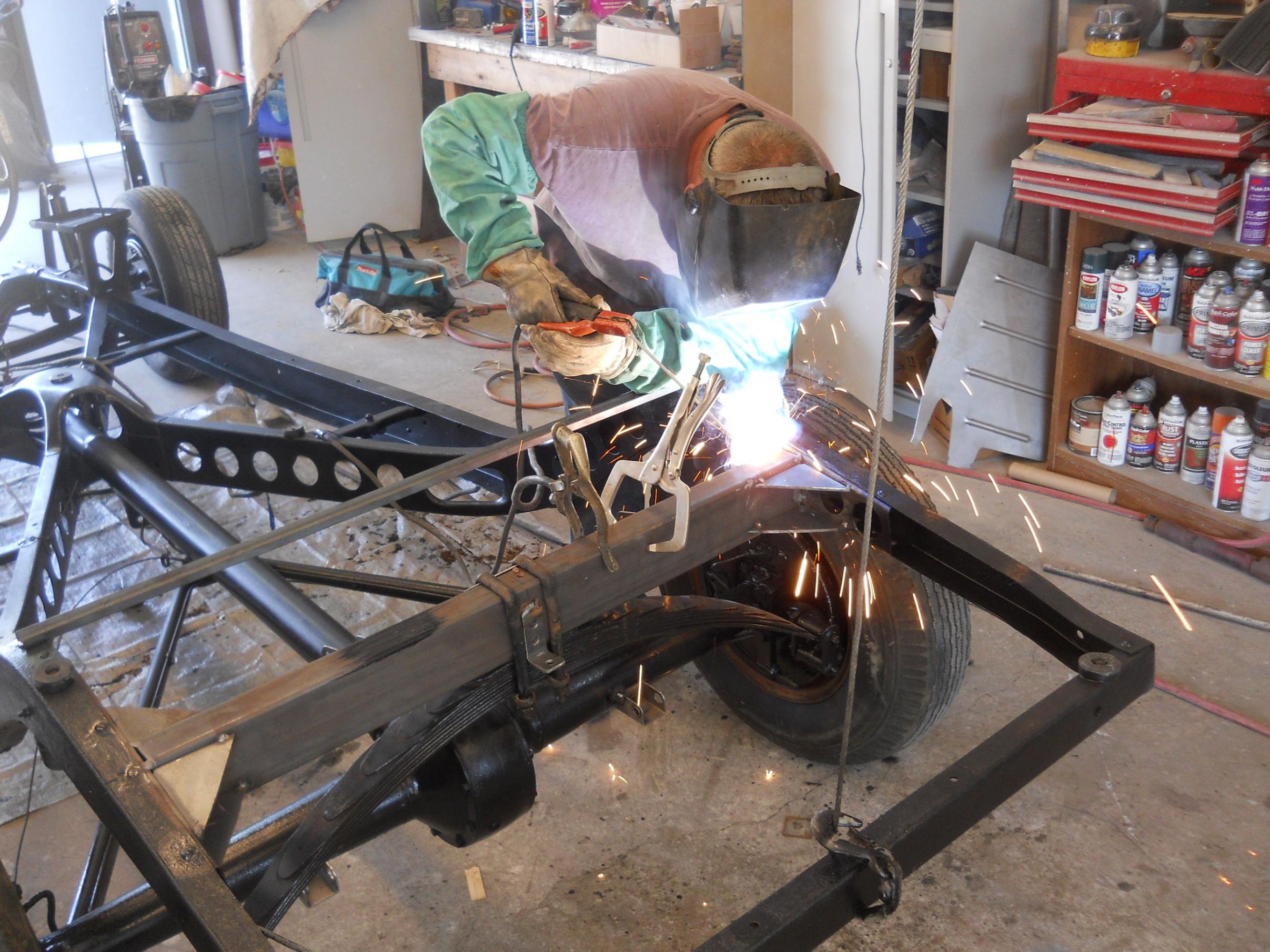

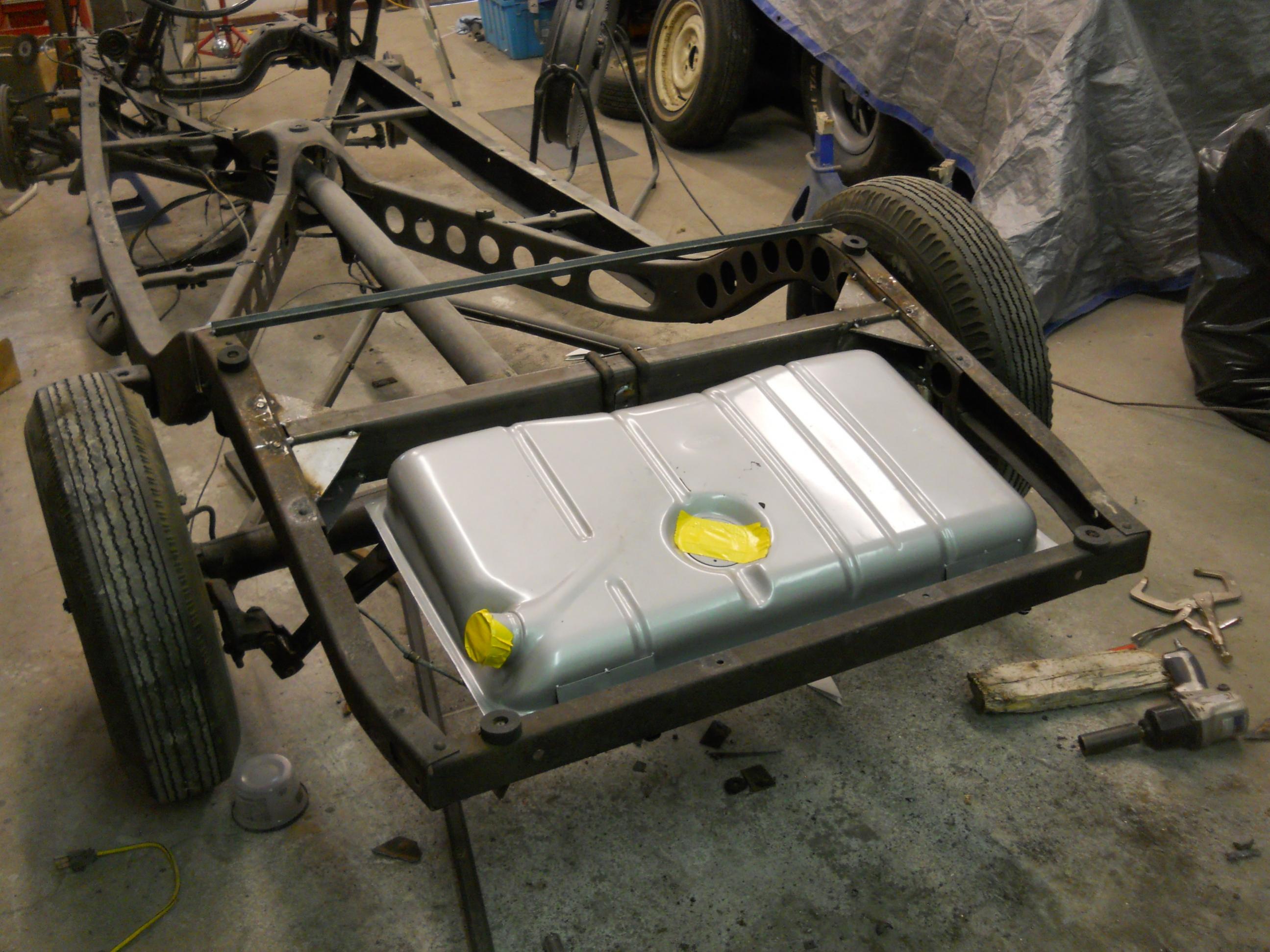

    I learned on Jr's car that with cars this age its best to just replace those gas tanks.
    We move to the other end.

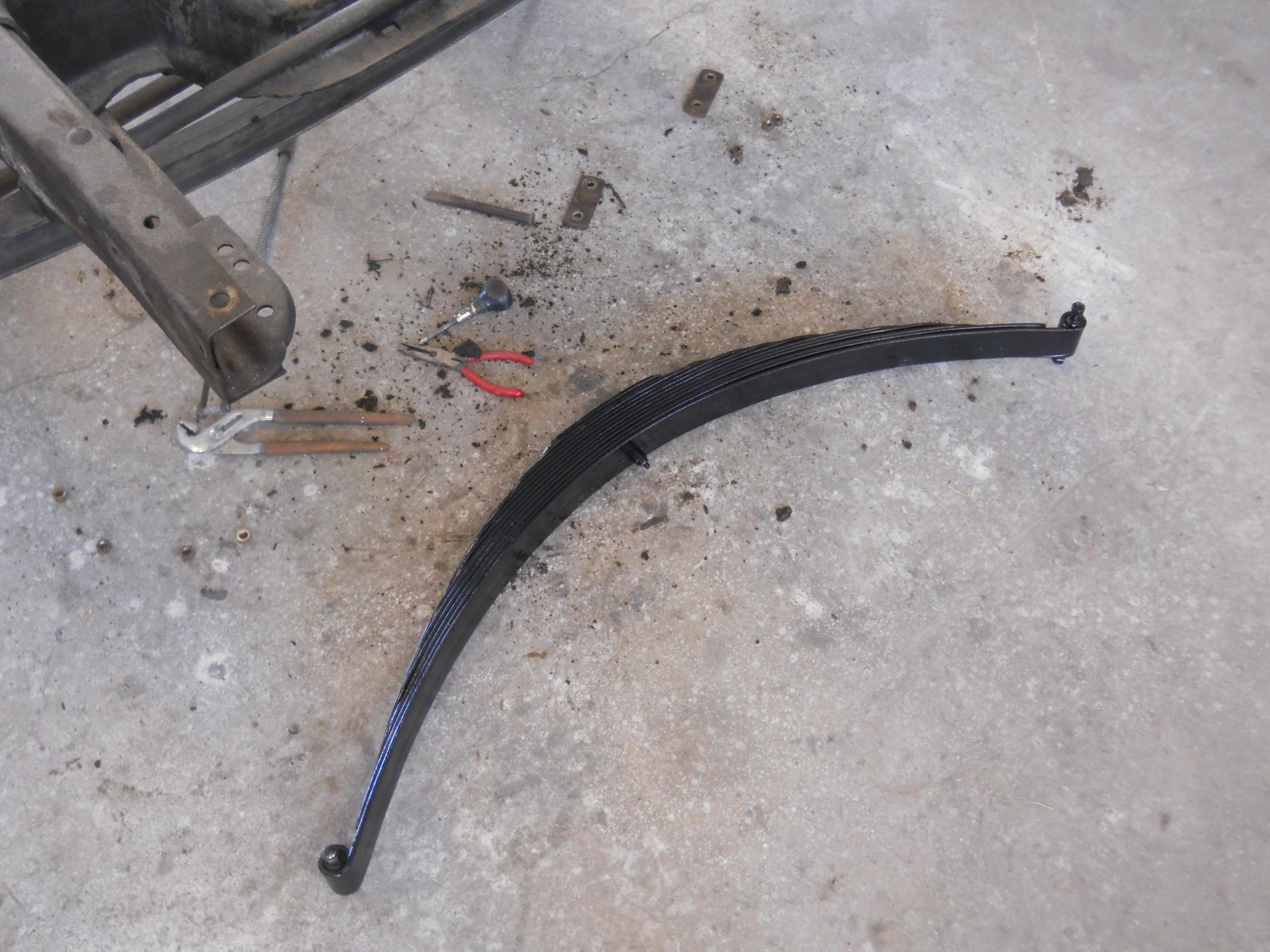

    Reversed spring eye's for front axle.
    Ch***is at Norm's for axle ***y and brakes. Norm saved my life on Jr's car. He's in the neighborhood at the end of my street. A true (and talented) friend.

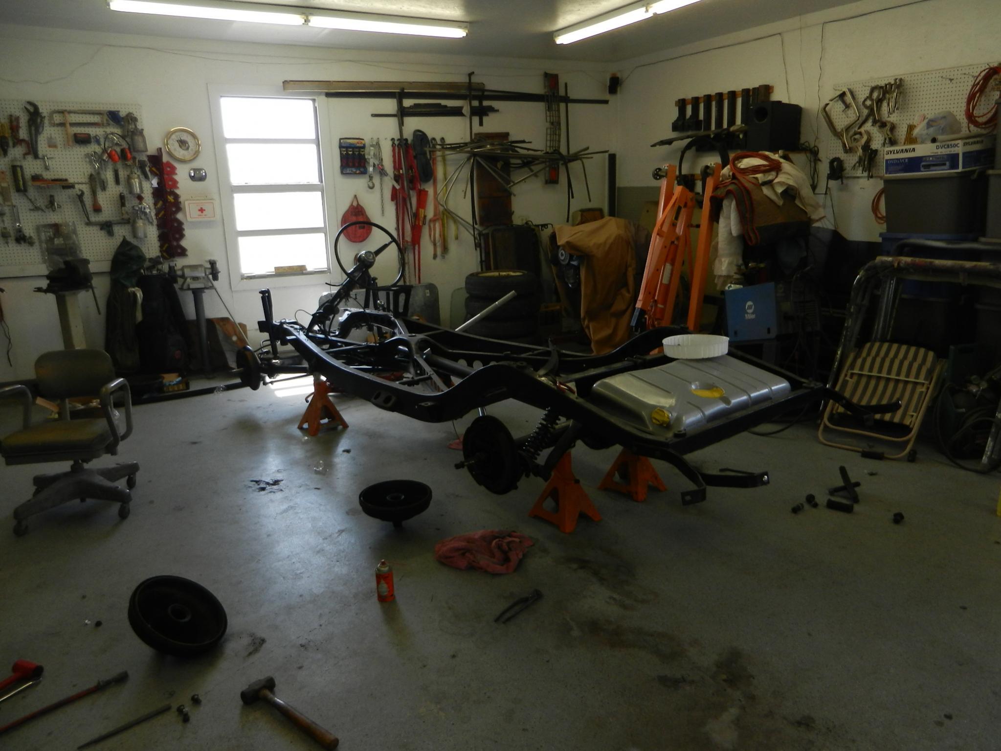

    Along with the gas tank we replace all the brake cylinders. It turns out we have big Lincoln brake cylinders on the back. It took a long time to find these things. Thanks **** Spadaro.

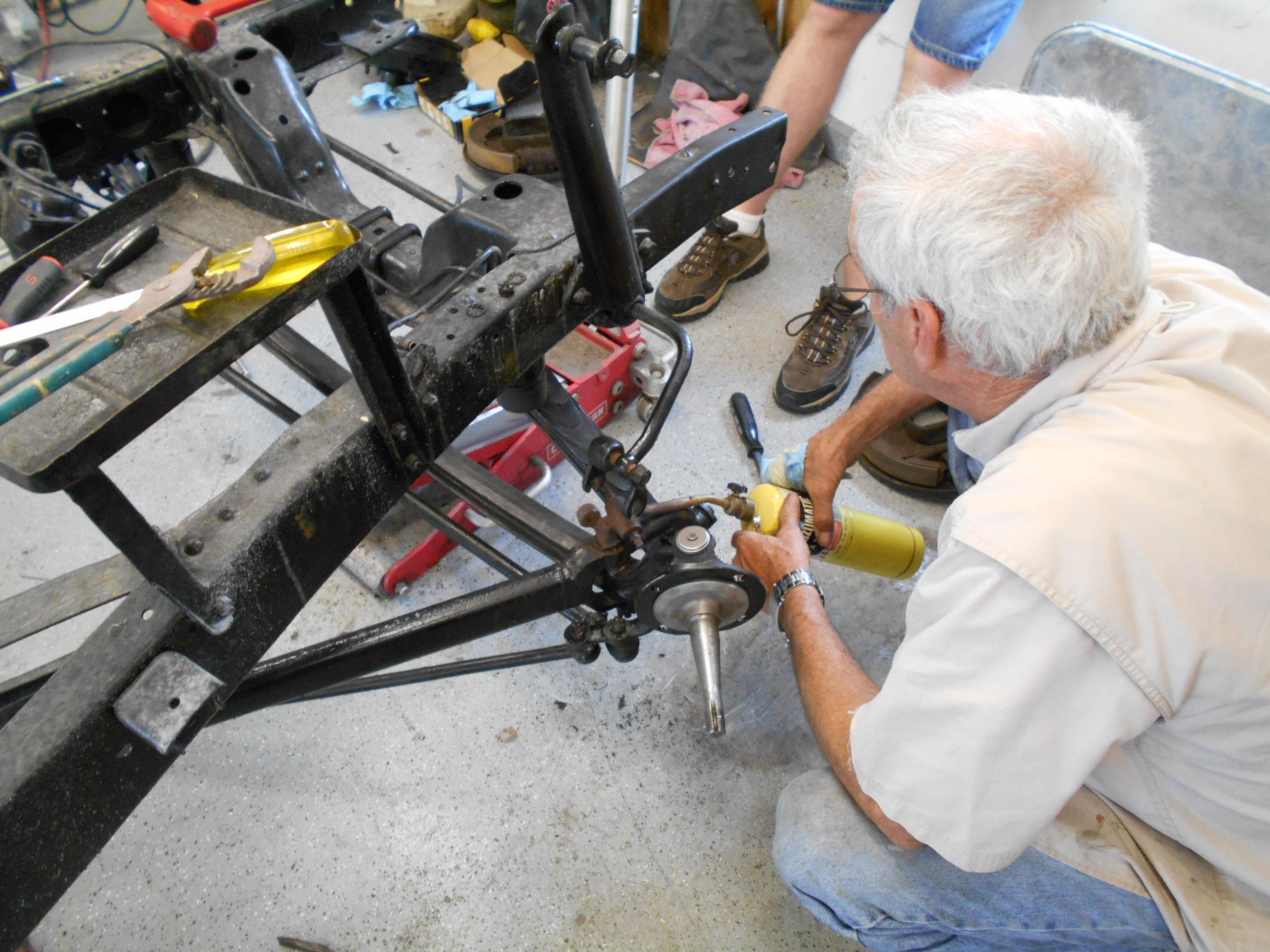

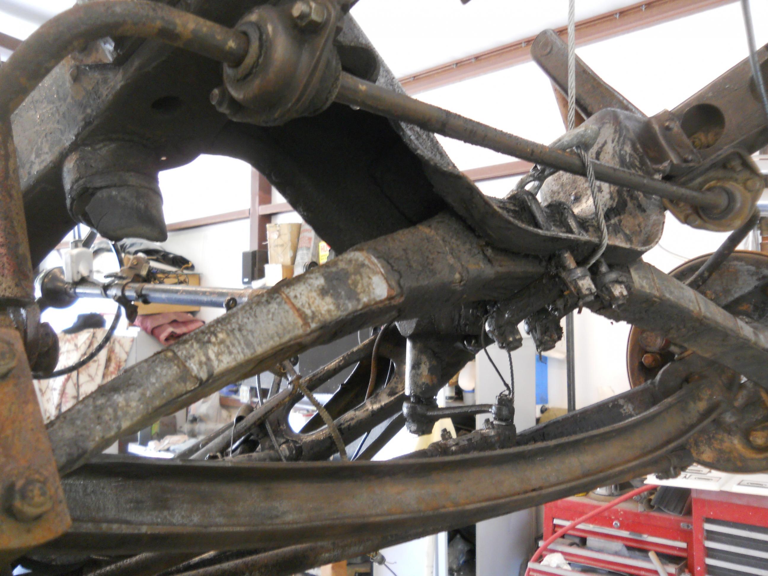

    Norm dealing with frozen perch bolts. Oh, what fun. Just one of the reasons that I didn't want any part of this.

    Got to love the frozen perch bolt's.
    Dealt with those my self before. Torch and a BFH.

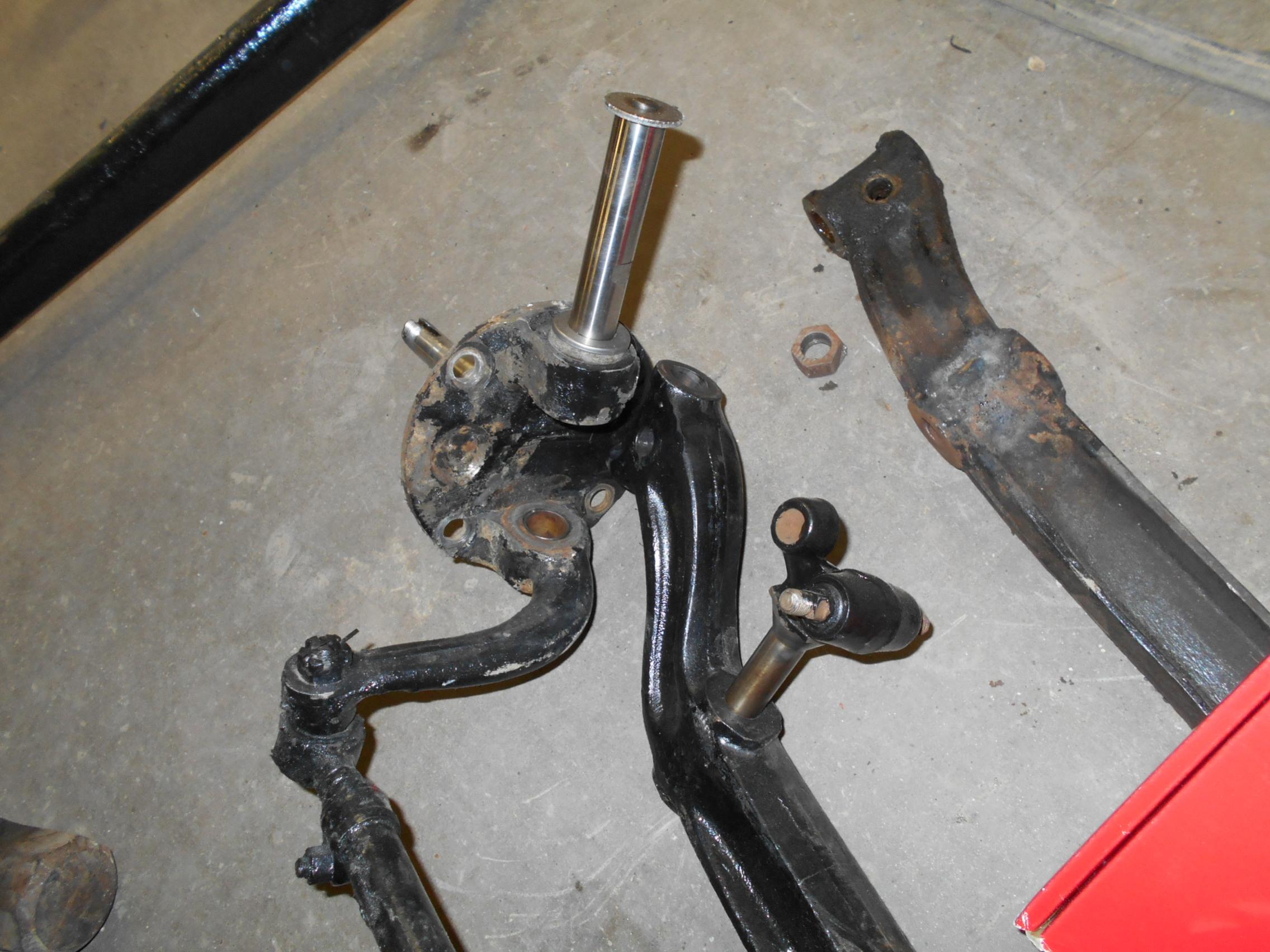

    We don't have the tools to take this frozen ***y (king pins/spring perch's) apart. There's an old time automotive business here in town that does these things.

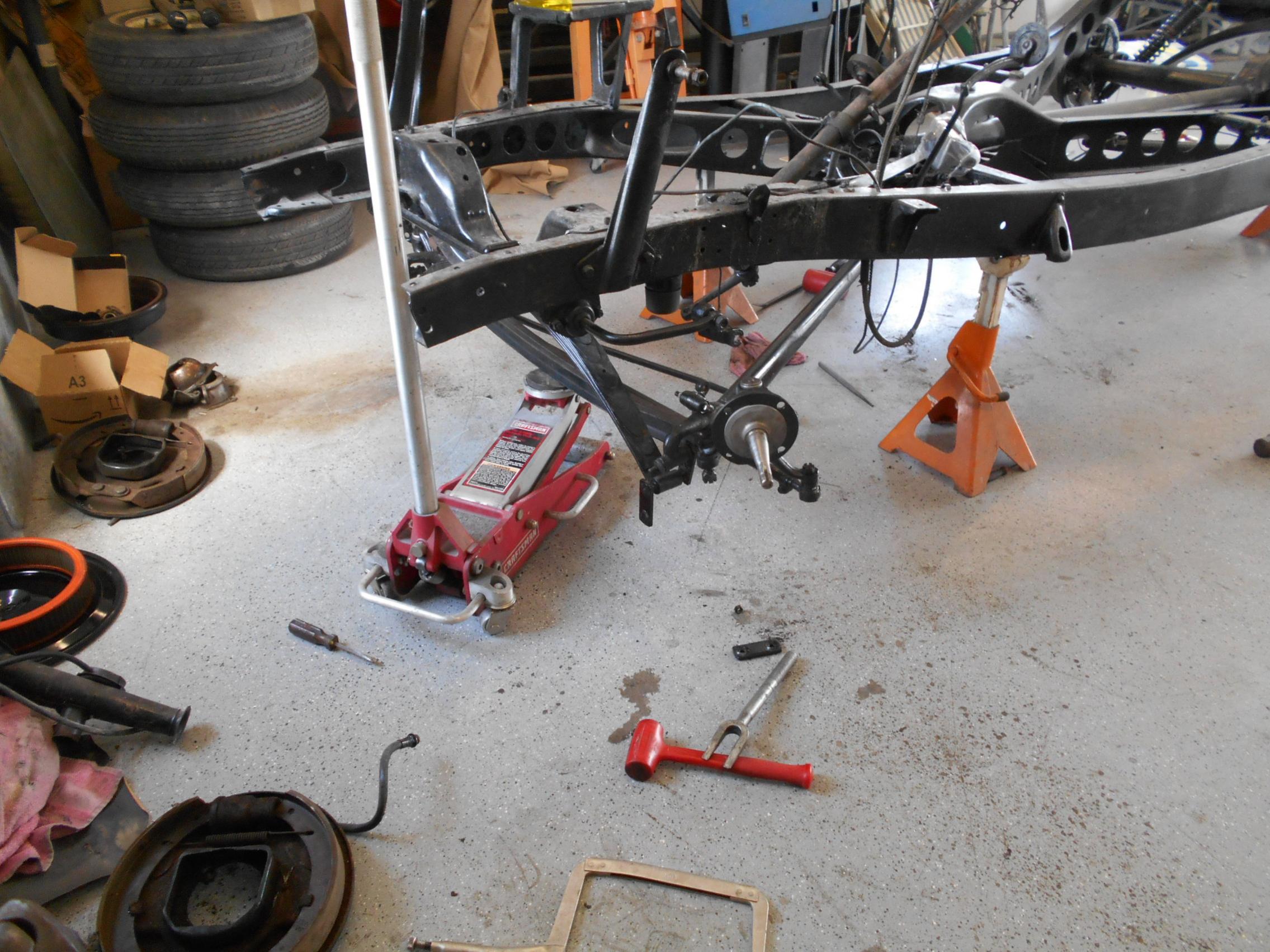

    OK, now we got it together and the steering arms hit the axle. Oh yeah, this is fun.

    I had to go back to Nostalgia Sid's (droppedaxle.com) for the dropped steering arm's. Sid helped with the perch bolts as well as with the axle. Just up the road in Oklahoma. A life saver and very quick on the trigger (service).
    Comin' back to Norm's.

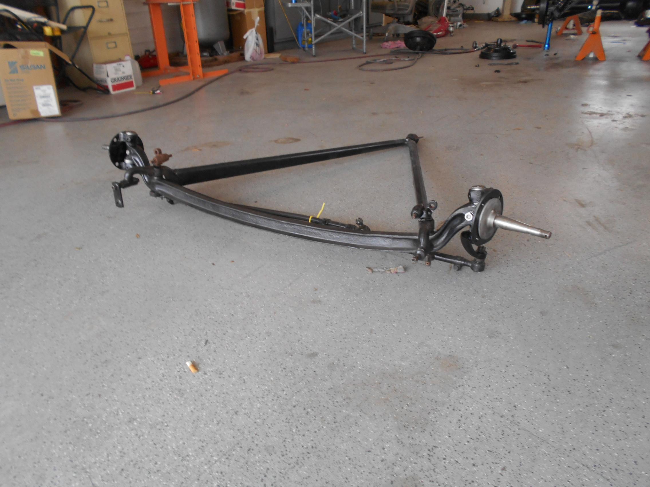

    The axle is a 2" drop. The 8" was the rear. When everything goes together we'll be looking to see how it all works out compared to the pics.

    Norm is back at it installing the front axle ***y.
